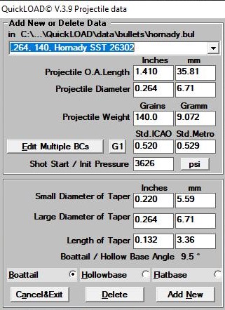

Other than taking measurement yourself, the QuickLoad app as this:
Reactions: yo-yo

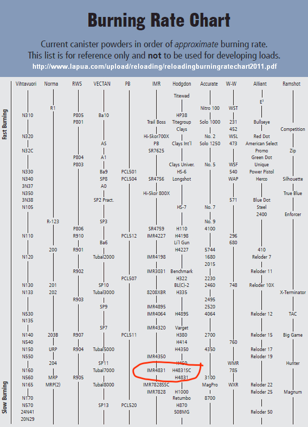

Yeah, I don't understand what those numbers are ahow they are meaningful. You can imagine why a rookie would be confused though, based on charts like this that suggest the burn rates of all of these are about the same. Why are they apples and oranges?
That's just a chart that shows the "general" comparison of burn rates. As @ma smith showed on post #52, the actual load data is quite different; with the low level load for one powder being more than the max load for the other. Always, always start with a known load from a manufacturer of either the powder or the bullet (and I mean the EXACT powder or bullet, not "something similar")
I ran combination of the bullets and powders you mentioned in your first post through Quickload....they are all overfilled, with the 4831/ELD combination at 111%. All of them are indicated to be over maximum pressure. You would have to drop the charge weight down to 43.7 or less to be within indicated safe pressure, and even then you're overfilled so it will be a compressed load.
By comparison, the indicated max safe load with 4350 is just under 100% fill.
This is the reason I spent the money to buy Quickload, so if I'm attempting something not " in the books", I won't be putting myself at too much risk. That and tools to measure depth to lands, base to ogive etc.

The burn charts are counter-intuitive if you don't undestand what you are doing. Slower powders are deisgned for (and thus "need") bigger cases/heavier bullets/etc. IMR version 4831 works in 6.5 bore diameter but not in small volume cases. You typically only in LARGER cases like 6.5x55 sweede and even in 260 rem I believe you migh see it, which have large h20 capacity for it.

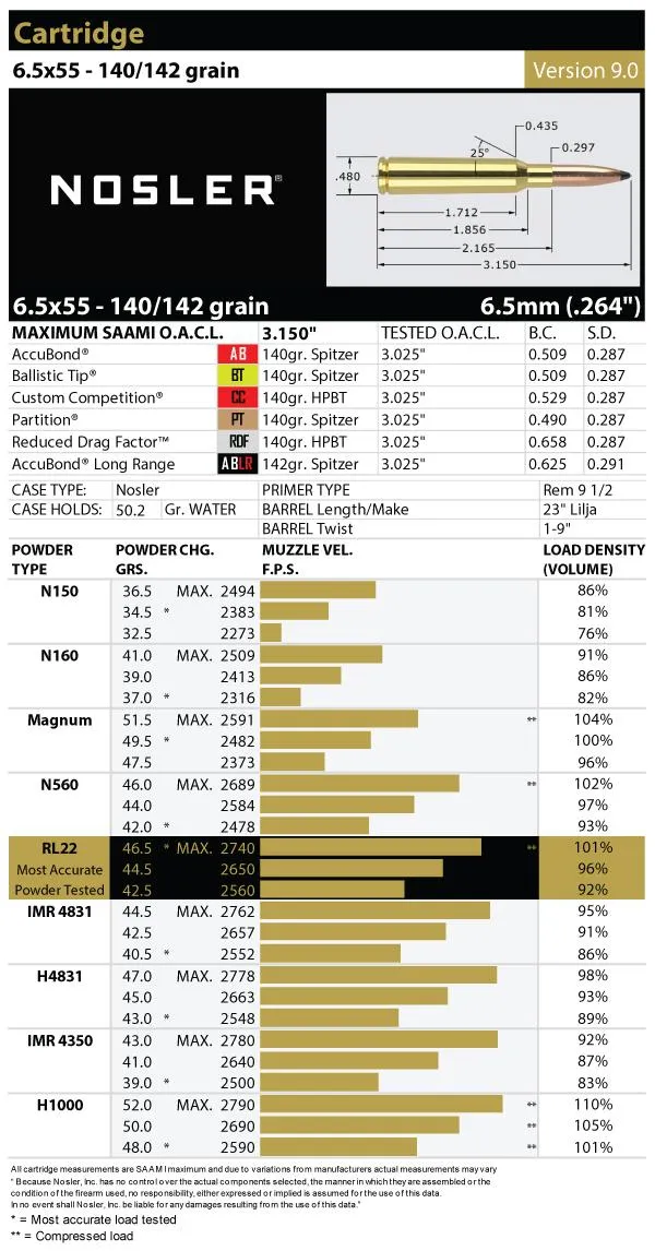

Below is a "by the book" example of how to use IMR 4831 and H4831 with a 142gr bullet...(y)
Hodgdon has data for a couple 140s and heavier bullets with h4831 in the 6.5 creed. Says 46.3g with a 143eld is 61500psi. All the top end loads are compressed.
