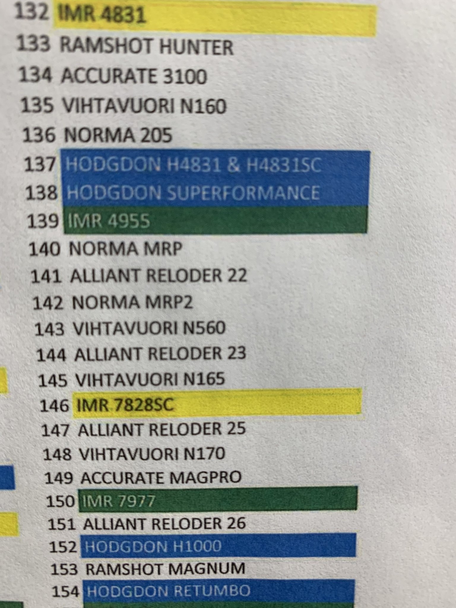

I can't find any load data for Hodgdon Superperformance in a 25-06. Looked at the 25 WSSM data, but that seems a little low, and the case quite a bit smaller.
Looking at burn rate, this looks a lot like H4831. How interchangeable it it?
I have 85 BT and 100 TSX to load in my Tikka 25-06.
Ideas?

Currently I am having very good velocity and accuracy with IMR7977 shooting bullets in the 115 to 120 grain class. I am a fan of Superformance. Considering where it fits on the burn rate charts, its lack of usefulness in the big 25 is something of a mystery. Could be it is very dense and leaves lots of space. Anyway, Works great in the 6.5 Creedmoor, but jsut does not seem to be a good fit for the .25-06.

I shoot a 6.5-06 AI which has the same relative capacity ratio as the 25-06. H4831SC has performed well, 7828SSC is what I’d use of the powders you’ve listed. For absolute top performance with the heavies you need double based slow stuff- RL 25, 26, 33- Ramshot magnum, N570, etc.
