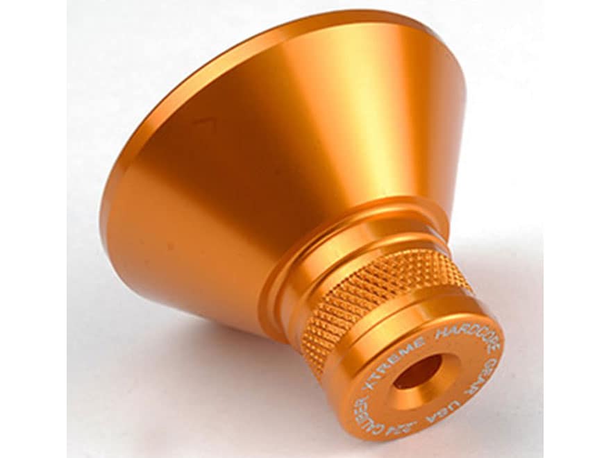

I use these funnels and they just don't get any better (no problem with static either and CFE223 does not stick to it). You won't have that issue with these:
I have these as well and have never had an issue of powder sticking nor spillage, they're a real top notch product, I went ahead and bought for the other calibers I load for.
