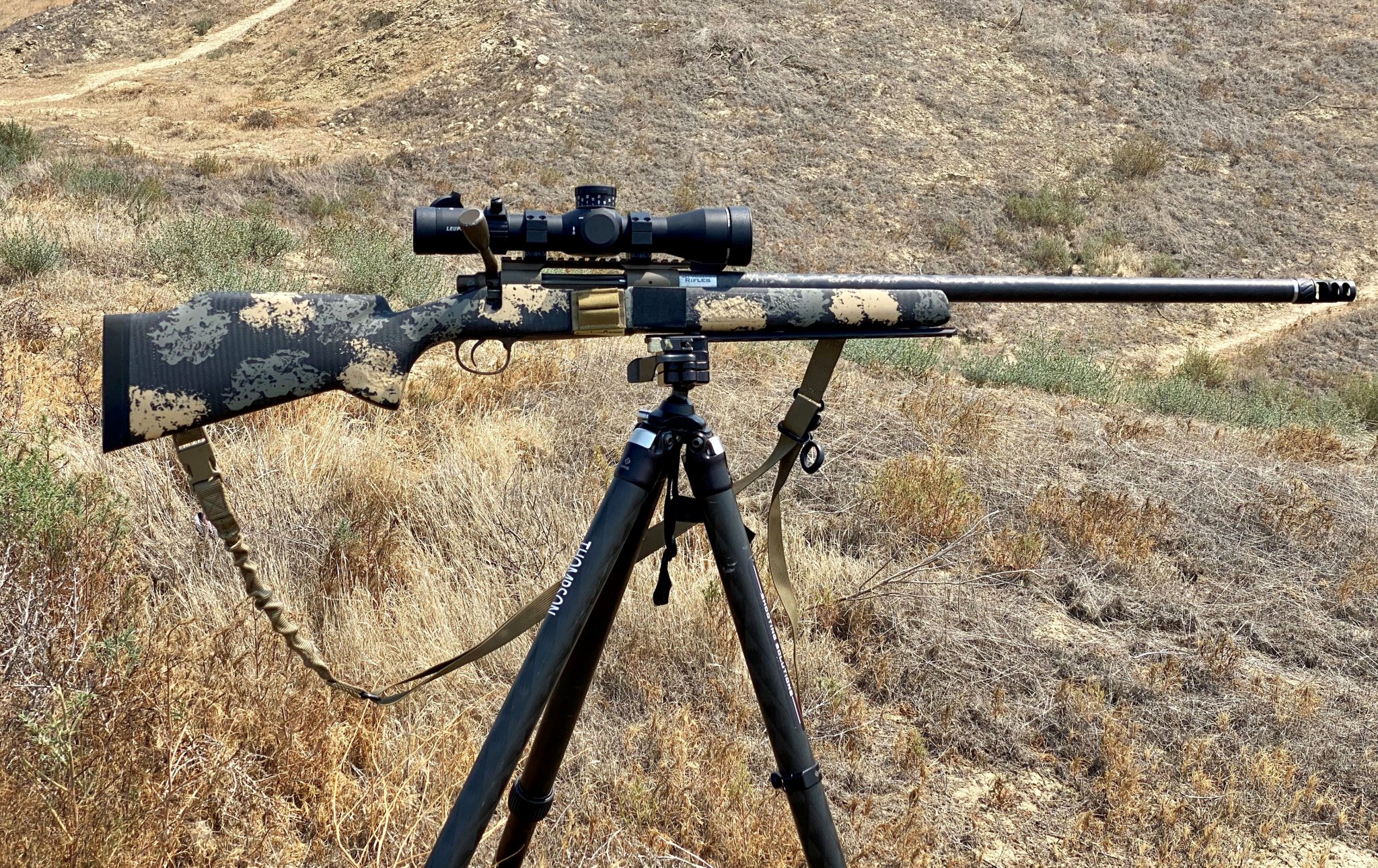

I want to get a tripod set up. Mostly for hunting. I could go with the Hog clamp or install quick release plats directly to the underside of the stock just in front of the mag well. The down side to the Hog as I see it is weight , one more piece of equipment to keep track of, and cost. The up side is that it is a simple solution. The down side of the quick release plate is it is a pain in ass to mount securely, epoxy in, tap and tread inserts. The up side is cost, nothing to carry around just pop spotting scope out, pop in rifle. What am I missing ? Real world experience would be appreciate. X

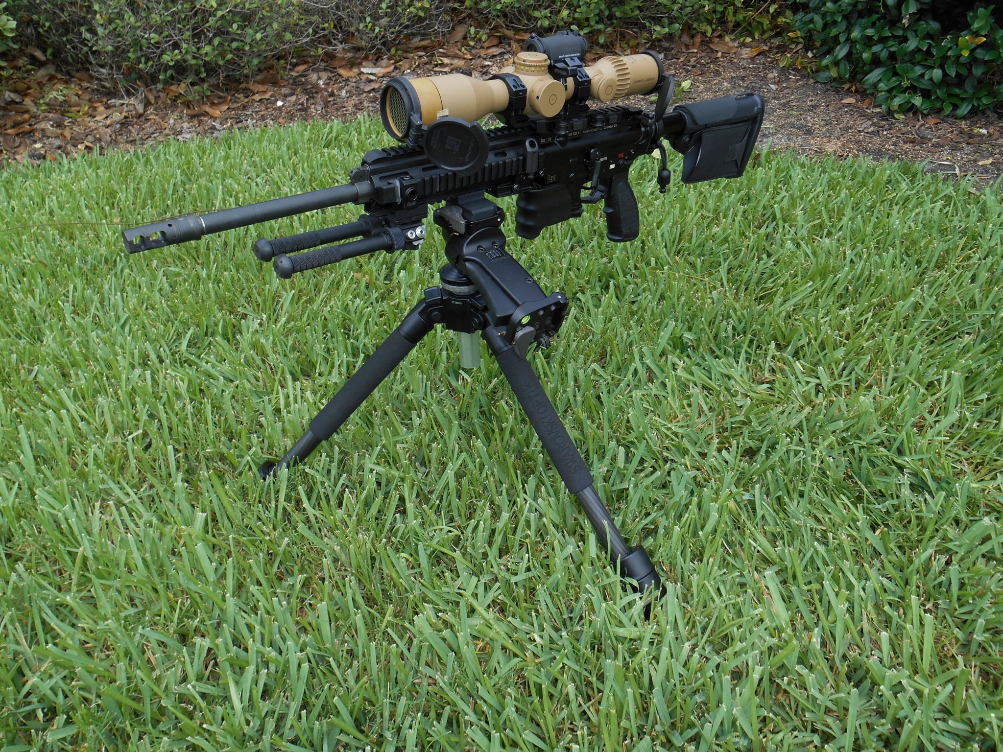

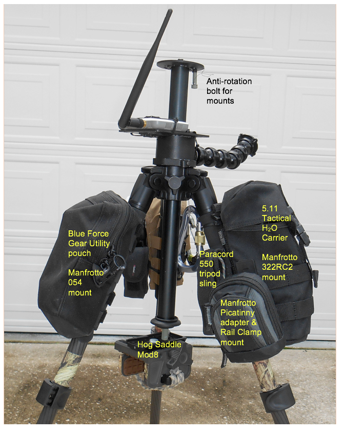

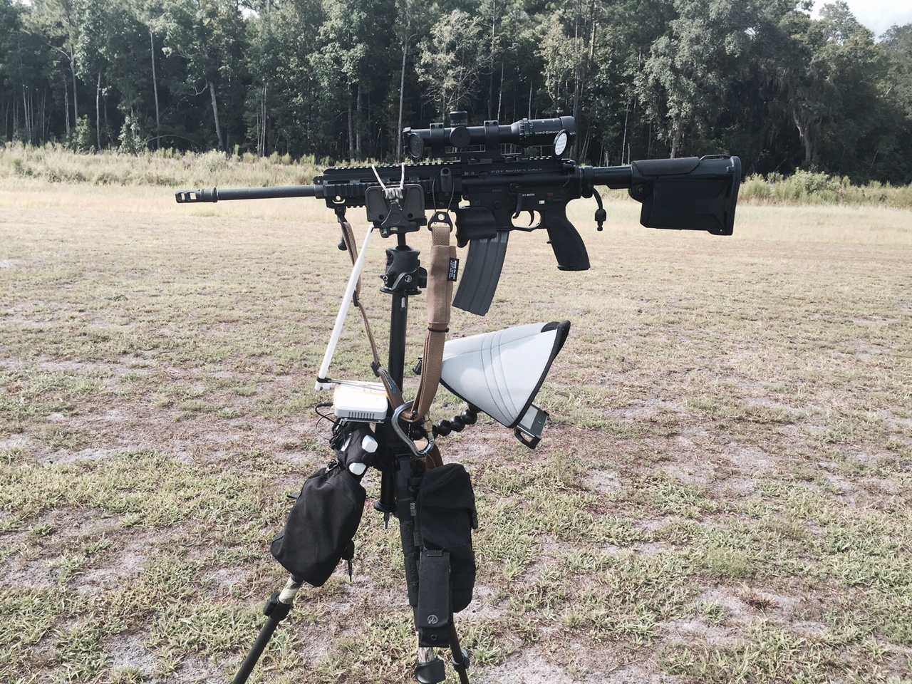

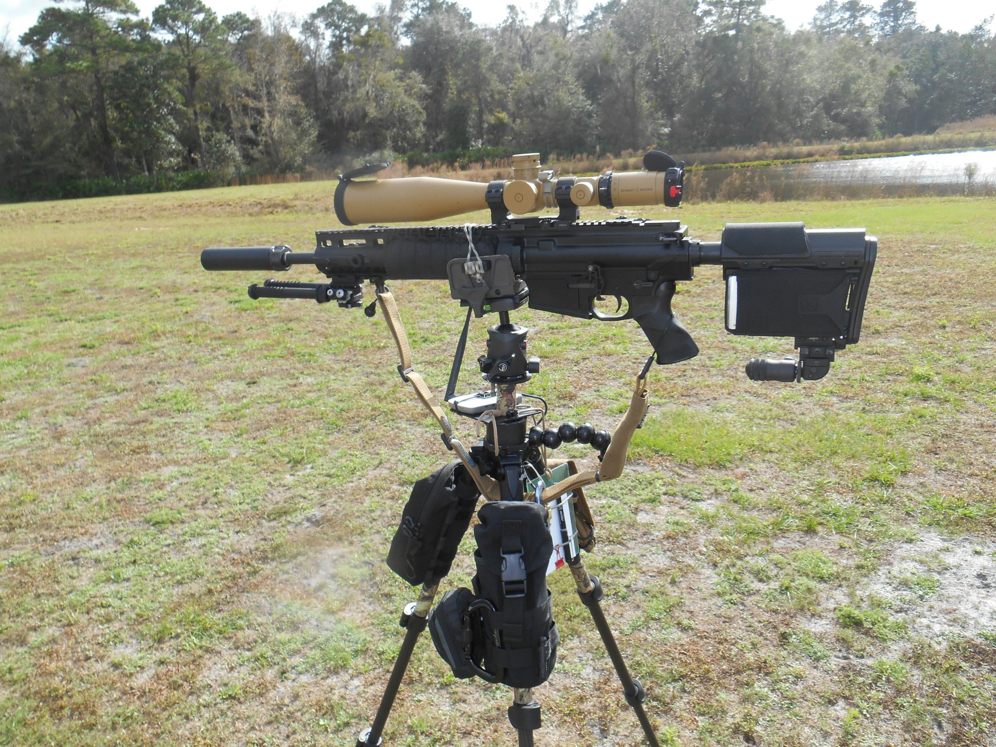

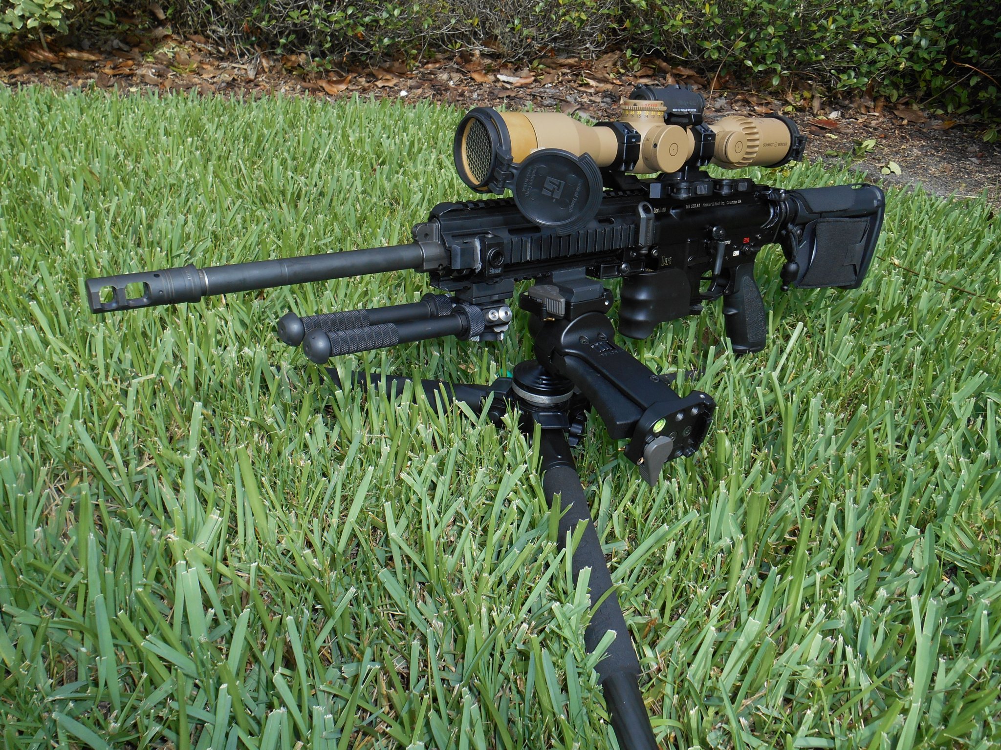

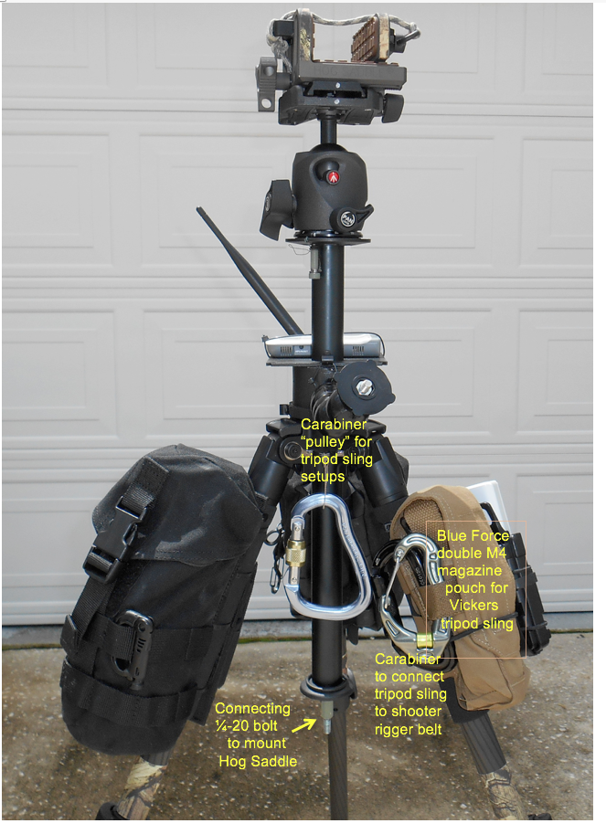

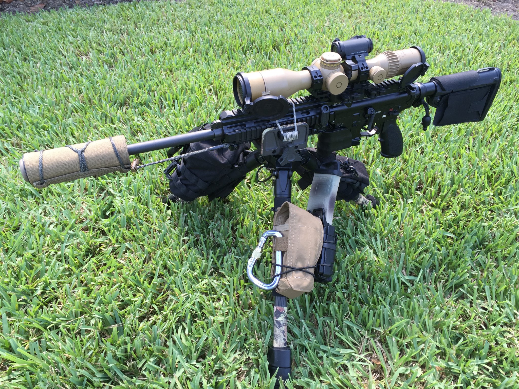

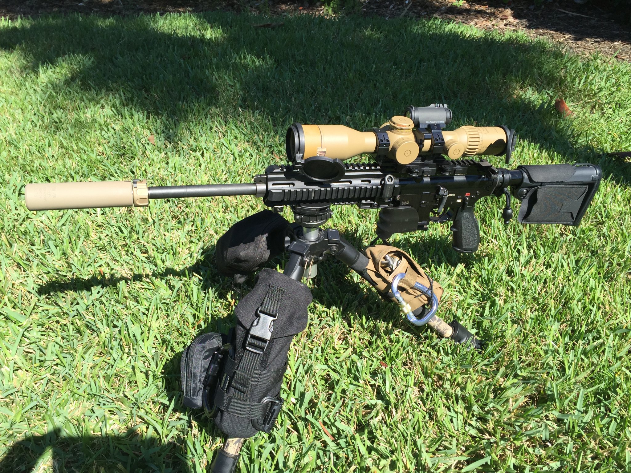

I prefer the tripod-picatinny rail adapter-rifle situation that can be assembled with a LaRue QD mount or Rogers Rail QD polymer mount both result in a solid situation. The Hog saddle with my Mod-8 variation (secured rifle to mount with paracord tensioning to prevent the rifle from slipping out of the mount when unattended) works pretty well, but weight / bulky profile can be an issue. I setup a Swarovski carbon fiber tripod that allows for packing along every variant mount option for the intended use that day.

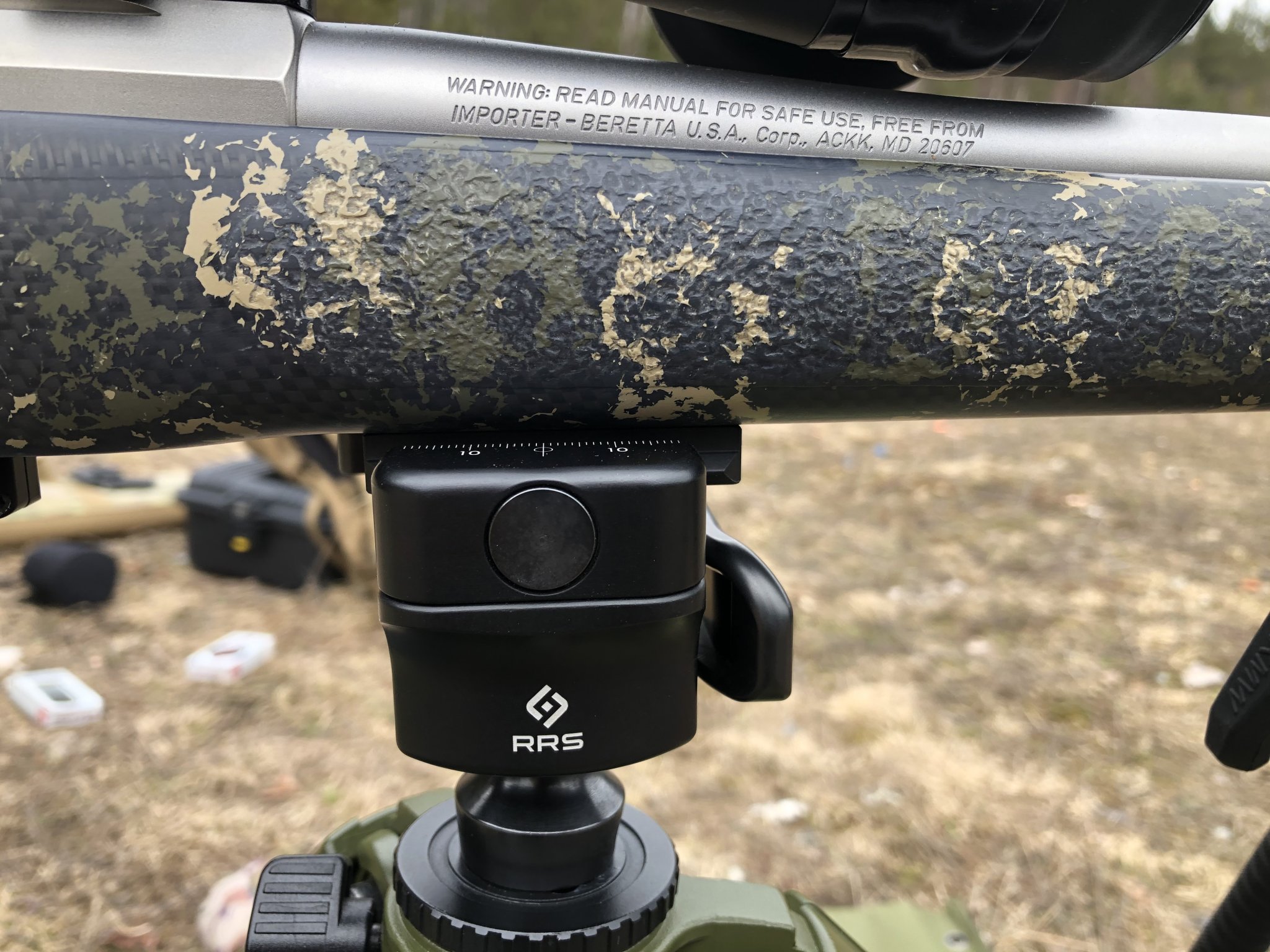

After using it both ways (and also trying the RRS Vyce) I put arca plates on my hunting rifles. Easier to connect/disconnect quickly, lighter and more stable. A small plate just in front of the mag well works great. i used JB Weld Steelstik moldable epoxy on the back of the plate to conform it to the shape of the stock.
Even more friendly on a skinnier stock is a small section of picatinny rail if your head will take it. Like noted above, for actual hunting use it’s just way faster to have one less thing the fumble with.
As soon as I went direct to the rifle the saddle was sold. It’s a lot more hassle than it’s worth if you can clamp right on.

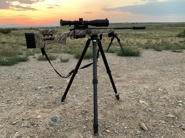

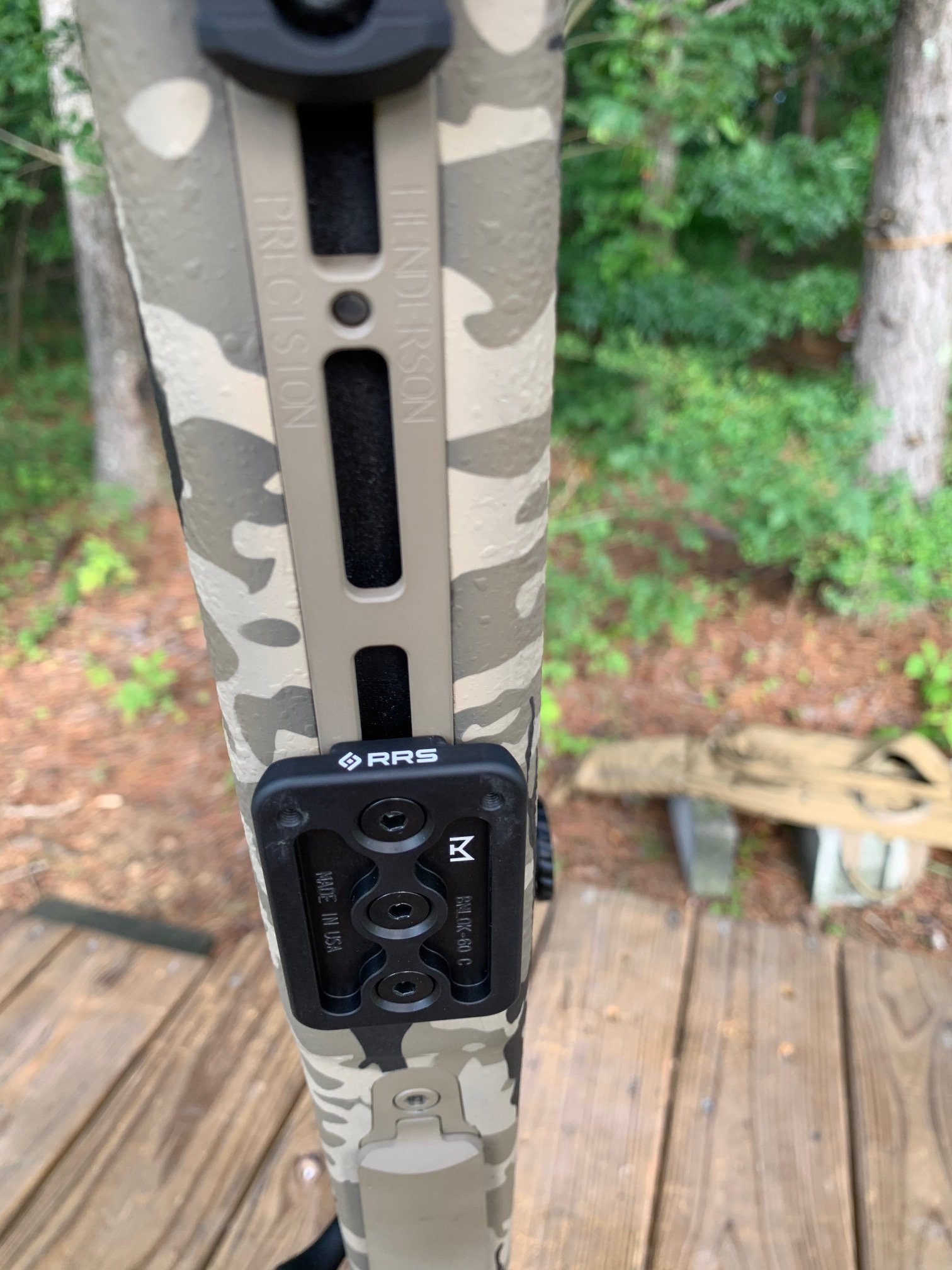

Painless300 I have one of the Henderson inserts like on your rig on one of my hunting guns. Superslick, but most of my Henderson Rails are just direct mounted, I even have one on a stock Tikka superlight (5.8lbs without scope) mounted directly to the round plastic stock. It actually looks fine and works well. That said that is about the nicest RRS paint job I have ever seen!

Thanks Diver! Travis at TS Customs inset the rail for me as I just wanted it flush mounted. Daniel at Primal Finish in TN. Cerakote everything for me, he does outstanding work! My stock is a McMillian A3A w/ Edge so the forearm is not as rounded as a normal hunting stock and it sits on my pack fairly flat. That was a good point on the full length Henderson making a flatter stock.
Thats a nice rig you got there, what round is it chambered for and what break is that?
Oh, ya @orkan -- I've seen his but not as up close as your picture. I have to admit I am kinda lusting after that a bit.
7mm running 168HuntVLDs at 3050fps, (although I had a one 7mmN with 180s at 3175) as pictured its coming in a 10lbs (with the mag- as I went back to the BDL). The break is a Heathen, fairly light, almost as effective as match gun breaks but doesn't toss as much muzzle blast backward ( a bit nicer when hunting). Obviously not a nice as your quieter ;)
Just got back this week from another successful Elk hunt with it and filled a couple of tags; a lot of damn hiking and the first part of the week, it sure looked bleak; glad it turned around at the end.

Zback - think twice about using the tiny rail section. Yes, it works, but it could work better.
In the field sometimes you'll have to set up where the vegetation or angles dictate the tripod legs go. Especially when shooting up or down the ability to slide in the clamp for the final adjustment is really nice. It is also really nice if you have a prone shot and want to use your tripod to be able to slide it to the front.
Other than that, as mentioned it is faster to insert, especially when you're looking at the animal, shoots great off a backpack (more stable than the bare stock and doesn't get hung up under recoil like a bunch of small plates), and easier if you're setting up in the dark for a NV hunt.
If you're anywhere near Central CA this weekend, come and help RO our UKD Team Feild Match, you'll see how much faster guys are under pressure with full rails vs. stubbies. The match is much like the images above in that I set up the FFPs to challenge the team's field awareness and skill in situations bipods will not work.
BTW here is a link to tripod field tips and tricks I did for the match shooters, some of it might be interesting if you're setting your hunting rifle to use a tripod/

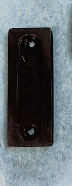

Will you post a close up photo of the " rail " you made out of the 1.5 " aluminum? Thanks
ive made various lengths.... the one in the picture I posted was a 12 rail but most of the ones I've made are about 3".... I even learned to anodize them, a fun project for sure.
here's a pic of the short rails I've made...

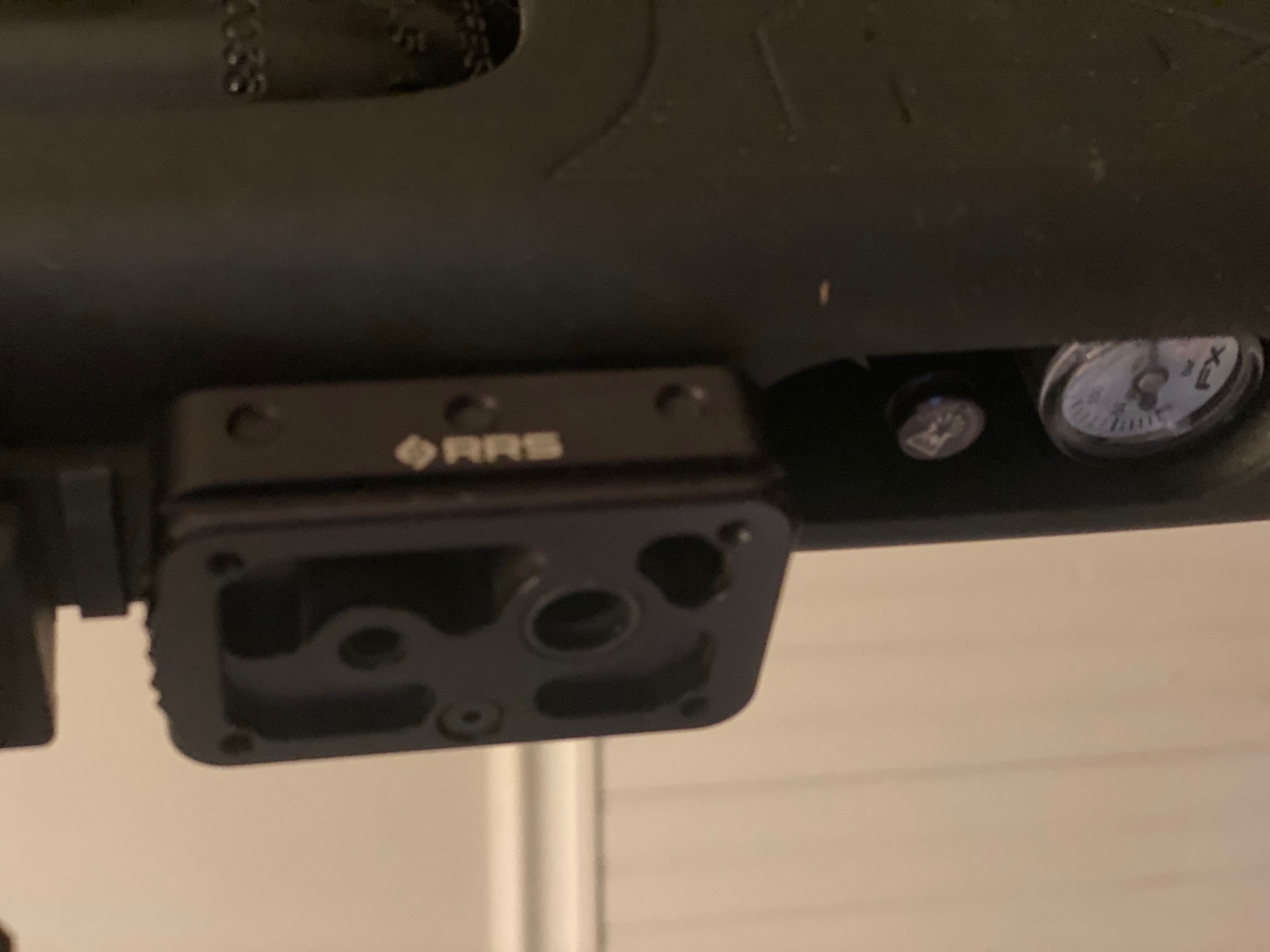

Makes sense - thanks got the reply. I also use a thin pair of KUIU Merino wool liners as gloves. But down mittens when glassing etc and will use gloves when hiking and packing. I however find the full rail somehow more comfortable carrying as I do with a BDL for long hikes, no bumps or hard angles. I ended up going back to a BDL on my Elk gun, but my Pig gun is Mag feed.
The thing that is great here is that almost everyone on the site, hunter or not shoots many times what an average hunter might shoot, so process and products get well used and tested. We often split hairs of what "might" be better, easier, or more accurate. We tend to take what we learn from shooting an enormous amount and from learning from others and push past traditional practices; just as we might pass on the 14 oz traditional SFP duplex and take a 26oz scope miles into the mountains for our long-range hunt possibilities, so that we have FFP for accurate wind holds, illumination to make our low power reticles pop like a duplex, exposed but locking turrets for the vetted drop.
Having these dialogs are great, there is no one way for everyone, and the differences are so small. I know this weekend as we run our Feild match I see something that I'll probably want to emulate, I'll see others that I won't. I did however set up the FFPs to lure teams into making the wrong decisions in initial tripod heights. Will see how many teams read the tips and tricks pages :)
BTW I still have a small rail on a couple of guns.
My PCP (FX500 Royal) can not run anything longer, I shoot it almost nightly at night using NV to control rats.. it's kinda fun practice. Even though I am well practiced I still need to be more controlled in how I clamp it in.

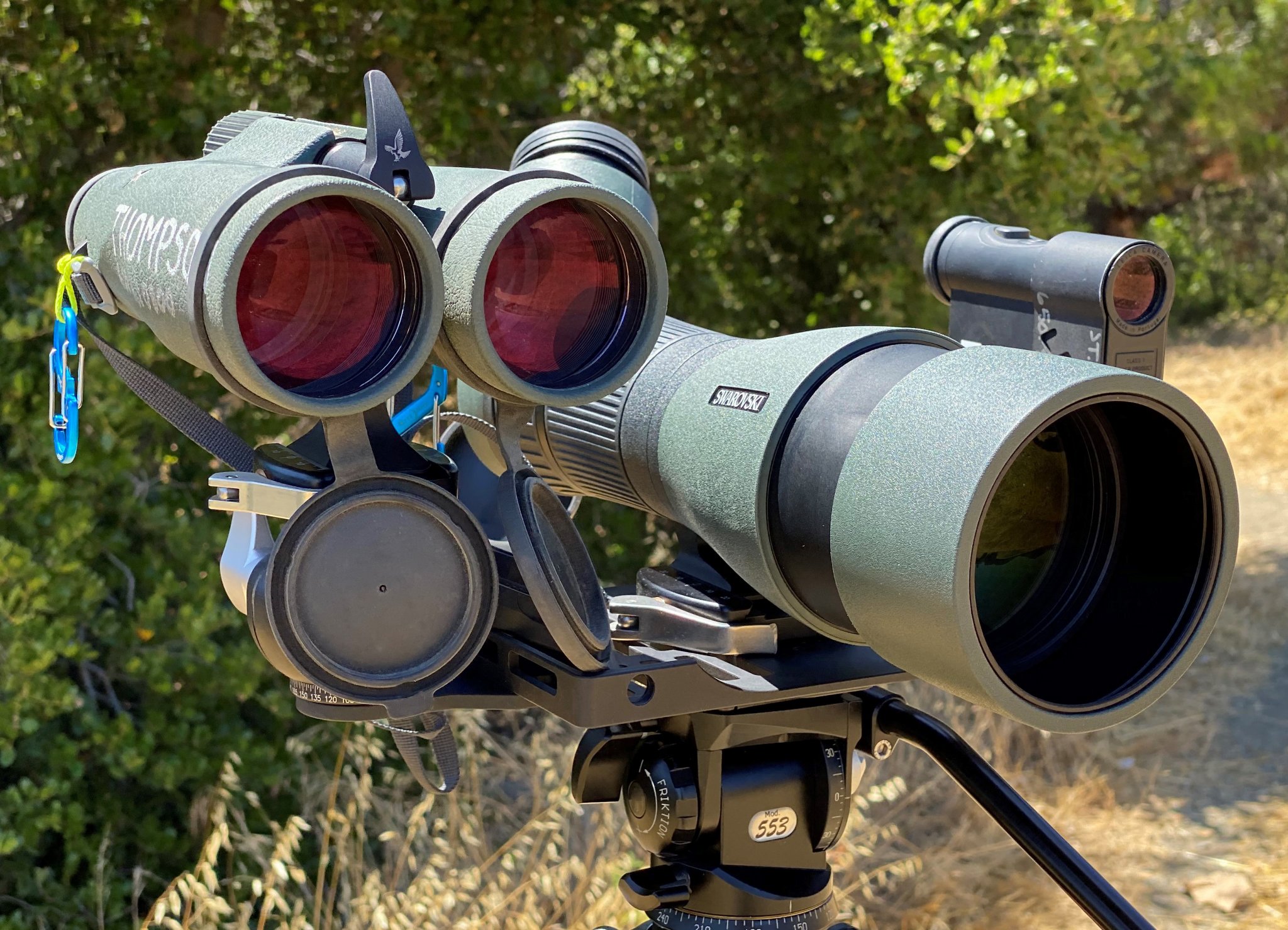

you can see the 553 on my tripod on the left. vs. my Anvil next to it.

How much of a step up is the 553 over my Jim White or the Bogen fluid head ? The problem is any thing good for grid work is only 2 axis and I want 3 axis for the shot would you / can you mount the pan head on top of a ball head? Keep the ball tight when gridding using the panhead, then when you switch to the rifle use the ball to get the 3rd axis? FYI you should get rid of that swarovski pin mount and get the outdoorsman.

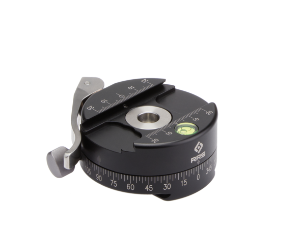

As an option, you could go with the anvil 30, for shooting, and then add a panning clamp for grid glassing. It's a compromise, but if you are primarily shooting with glassing as a secondary function, it might work for you.
Something like this maybe:
https://www.reallyrightstuff.com/pc-lr
We glass 99.9 % of the time, you got to find them to shoot them, I would rather have the best glassing set up and a rusty open site 30 30 that could only group 5 moa, than the best shooting tripod set up, my mental problem is I want both in one package , a good mother for my children that fucks like a porn star.
Reactions: Diver160651
The Outdoorsman 2.0 correct? That what I had 1.0 Jim White same as the 2.0 but not 1.5" compatible and replaced it with the 553. Mine was pretty bouncy with a rifle. I am still deciding if I like the 553 enough to ditch the Anvil. It shoots about the same, but dang is grid glassing nice. For me, even though it is light for what it is it is still 8oz+ heavier than the Anvil. I've spent thousands to get my gun and packs as light as they can be, so I am still undecided. I spend way more hours glassing than shooting it seems on a hunt so I keep going back and forth, one is far better for glassing and the other lighter and simplier. I do not have any problem getting in target with the 553, especially if you don't keep it locked.
Swaro vs Outdoorsman; I have 3 outdoorsmans, my Swaro I can 1 hand even with gloves, the Outdoorsmen also fail to lock up sometimes. If you don't believe me contact @sfogold and ask him about his smashed Swaro 15x56s and his buddies 2 sets (giving him a hard time). The swaro base doesn't need an adapter to lock into my RRS clamps, while my outdoorsmans do. Why do you suggest they are better?
No, I would not. More weight, more height above the lock point will equal more shake, especially when windy and the barrel is hanging out into the wind and sending vibration back. The biggest reason though is if that panning clamp is on "top" of a ball head losses its horizontal plan once the ball head is loosened for it a vertical adjustment.

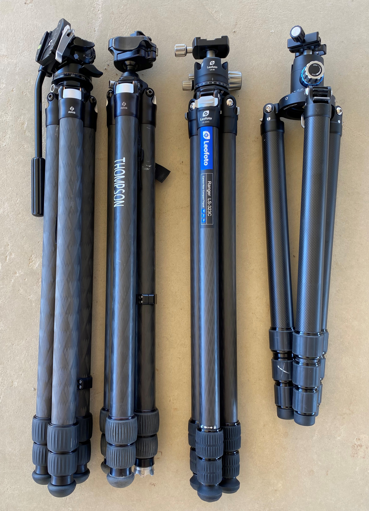

People are going to shoot me for sounding so opinionated, but I am trying to help save people over a decade of very costly experimentation.
Stay with me for a minute. Many PRS shooters are lusting for the TVC-22i, it's two legs deploy much faster than the 4 legs a lot of people bought. However, these are a poor choice for shooting in the wild on steep slopes because they just do not get small enough. The standard 3 legs blend the best of both worlds. Much easier and faster in the wild to set than the 4 leg sections. Ya, in the PRS world standing tall and glassing big guys need the 4 legs or long options when using binos; but how often do we stand tall like that when hunting?
I guess I am saying everything is a series of compromises, the goal, at least mine is to stack as much I'm my favor as possible to get the most flexibility in height, speed of deployment, and most importantly, stability to weight ratio.
The RRS TFC-33 looks much bigger with its fat legs and shoot with more stability than the TFC-24L Both are great tripods. How much heavier do you think the TFC-33 is than the thinner legged TFC-24L?
Wait for it...... about 13-30grams, not ounces. 13 GRAMS less than a 1/2oz
Having owned both the 24 and 33 and the equivalents in the Feisol products 3342 and 3372; no way would I have attempted some of the shots on animals we've taken from the larger units. Do smaller legs work? Absolutely, but my wobble zoon grows uncomfortable large on a long-range shot and a prized life. That said, I've been next to guys flinging lead off sticks and they seem to have no issue missing or with the possibility of missing. I am not saying that you'll miss with a 24 vs a 33 just that there is a noticeable difference in stability.
