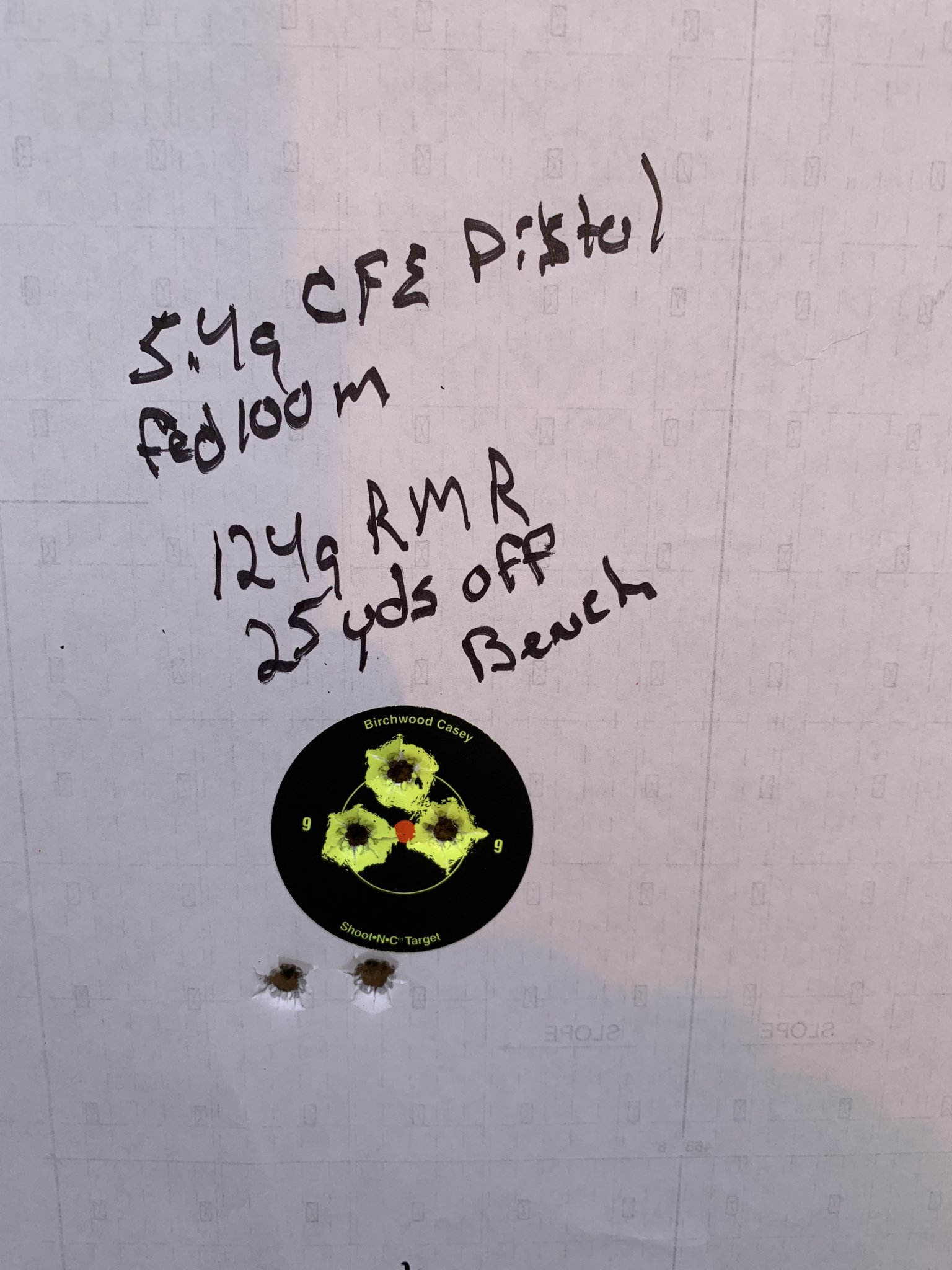

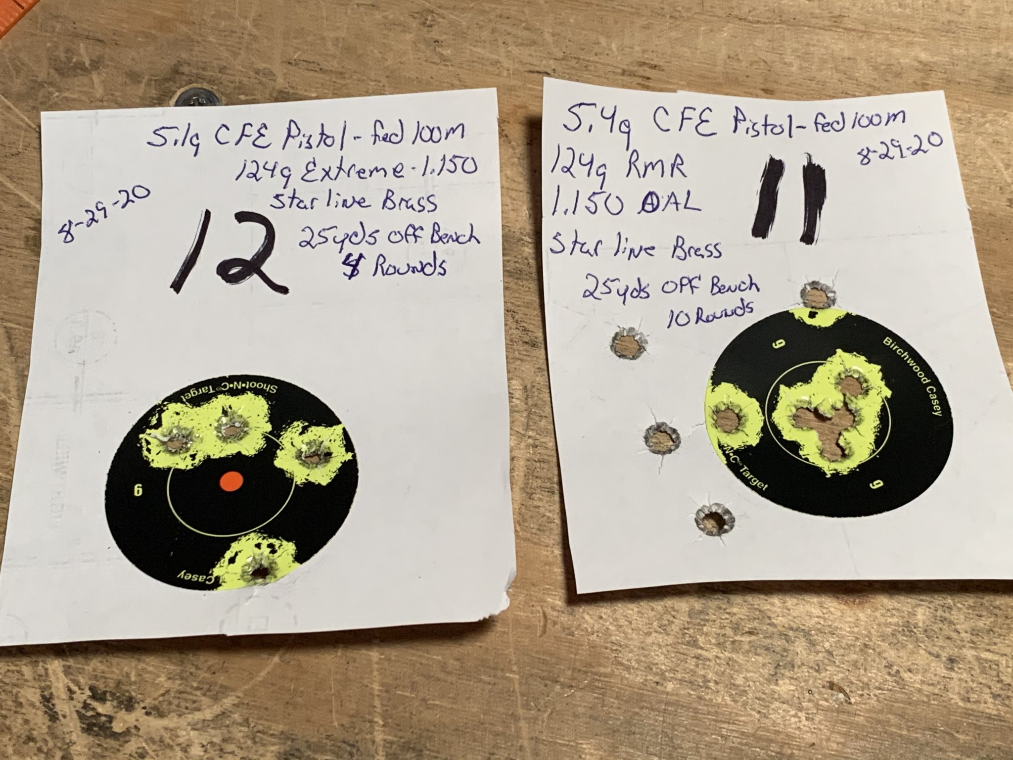

armscorp 124g bulk JRN
124g RMR JHP
124g extreme JRN
124g east coast reloading JHP
147g east coast reloading JHP

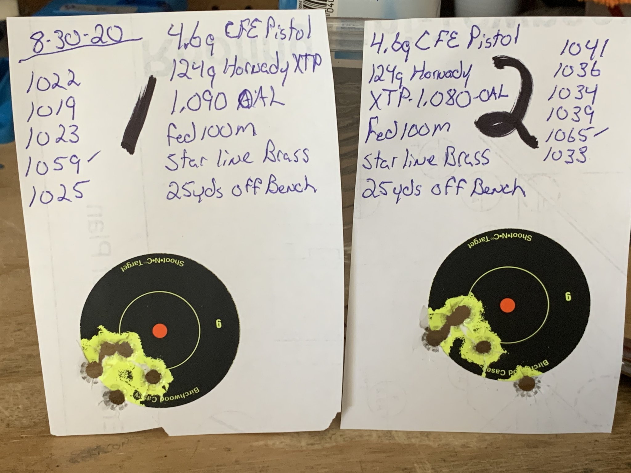

124g hornady XTP

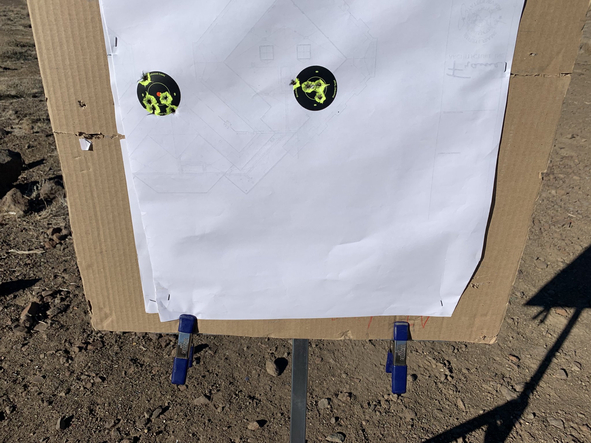

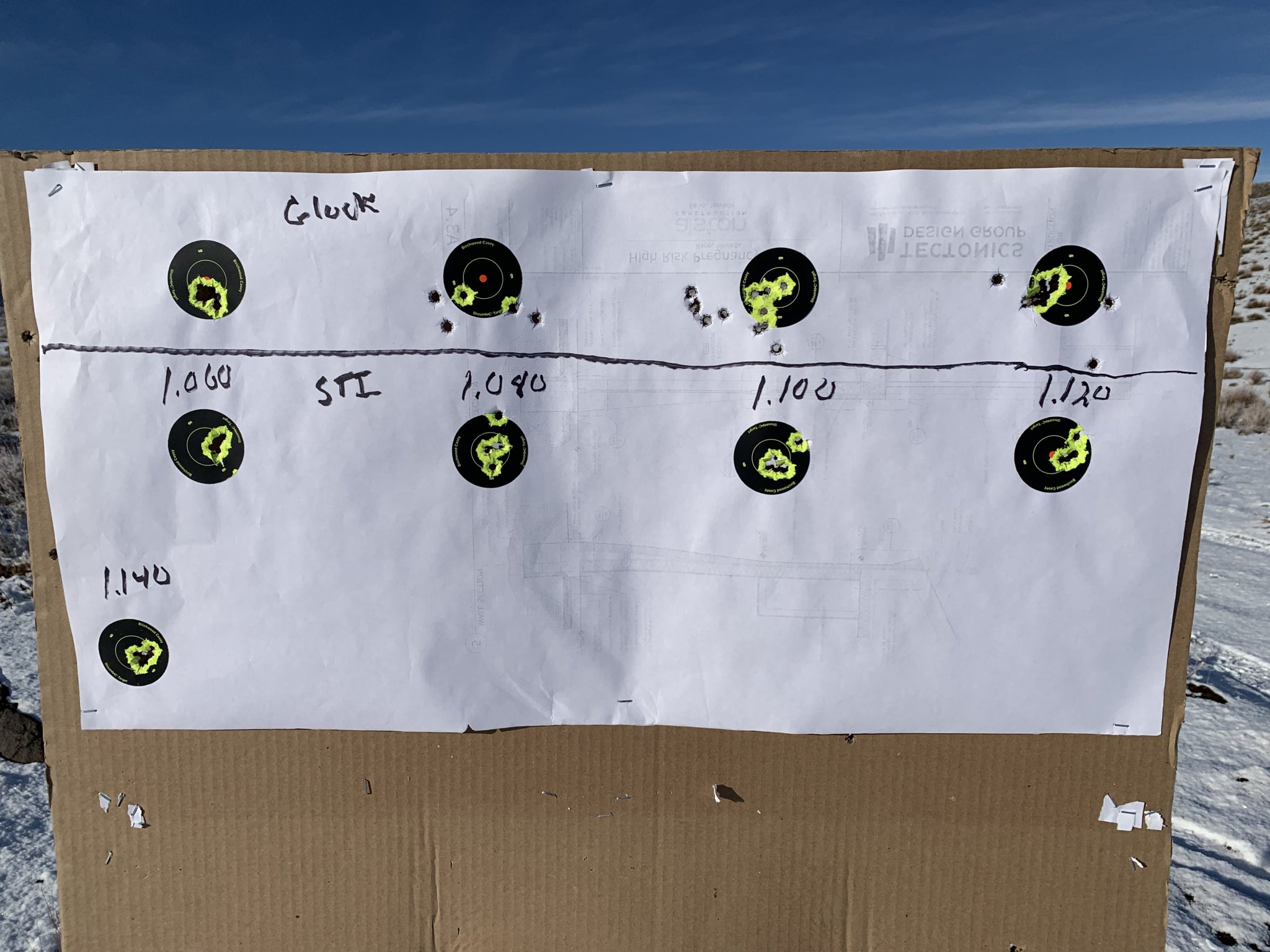

this is the same load doing a seating test glock 34 top staccoto P on the bottom 15yds off a bench...these are all 2" dots...
same load as above 124g extreme JRN 10yds off hand

hornady XTPs would be great for what your looking for....and yes changing seating....like with rifle...will change pressures but as long as your not on the ragged edge shouldnt be a problem as long as your not compressing the crap outta the powder.
