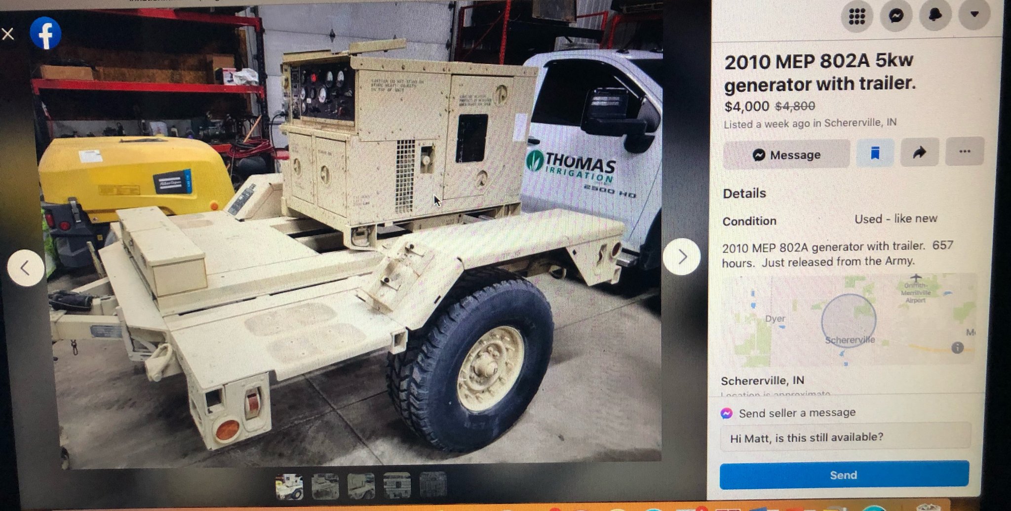

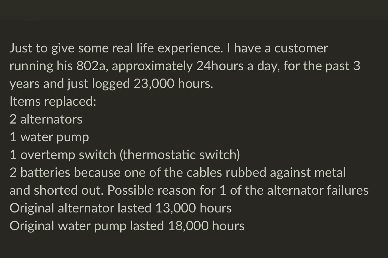

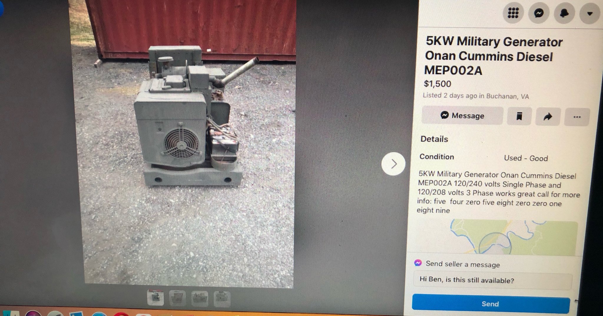

Look for a Diesel military generator 5k or 10k. They are underrated power wise and can handle a couple of extra 2k or 3k spikes no problem. Make sure you size it properly. You want to run diesel generators around 80% load to avoid wet stacking. If you have wood heat I would buy a 5k, they are cheaper and easier to find. MEP802a is the newer 5k and is quieter. The MEP002a is the older less electronics old school diesel engine. They are cheaper but parts might be a little bit harder to find. If you buy one get a spare parts stash for everything you think you might need. Parts will be more expensive and harder to find down the road. Another plus on diesel fuel is that it can be stored for a few years. Another plus about the military generators are they are pure sign wave so they won’t damage your electronics.
Research on military generators can be done here: https://www.steelsoldiers.com/forums/generators.55/
Look for a Diesel military generator 5k or 10k. They are underrated power wise and can handle a couple of extra 2k or 3k spikes no problem. Make sure you size it properly. If you have wood heat I would buy a 5k. They are cheaper and easier to find. MEP802a is the newer 5k and is quieter. The MEP002a is the older less electronics old school Diesel engine. They are cheaper but parts might be a little but harder to find. If you buy one get a spare parts stash for everything you think you might need. Parts will be more expensive and harder to find down the road.
That's my holy grail! 🤩

These newer generators are much harder to work on and require special diagnostic equipment I believe. I would do my research before I purchased one. The military still has a bunch of the old generators and the units don’t want to get rid of them from what I hear. That says something.....
You can tell what a generator was designed to do by looking at the fuel system. Most civilian units are designed to be ran for a few hours before they’re out of fuel. A military generator can be hooked up to a fuel farm and run 24/7 365. That is exactly what they do with them in the sand box. They run them month after month and stop them to do oil / filter changes. I like knowing my generator can do that if it needs to and doesn’t have plastic bearings and components.
The attached picture was a comment by one of the experts over on steel soldiers talking about his experience with them.
