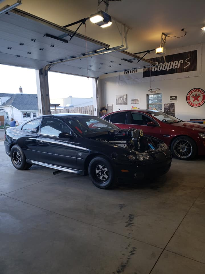

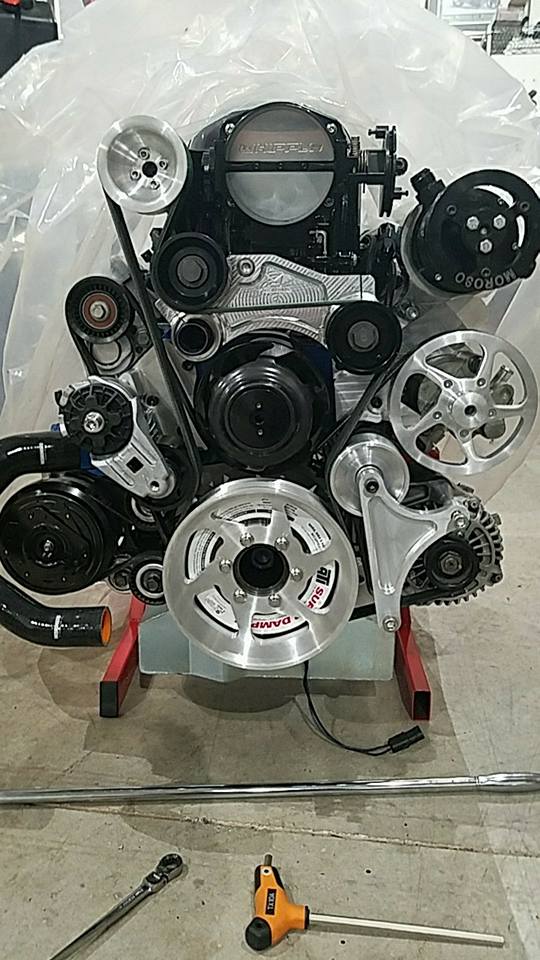

    My 2 year long project can see the light in the tunnel...
    8.3L Whipple Supercharger@15% underdrive
    5.3L LS. +.01" on the holes, stock stroke
    PRC heads
    A bunch of widgets that I made
    All the methanol...
    Hunting for around 1400 with motor. A Dart LS Next and Billet crank lie in wait for the 2.0 version.
    Fired it last night for the first time. This thing is going to be a riot on a 275 tire with an IRS rear end. A few little things to do before we can see how it goes.

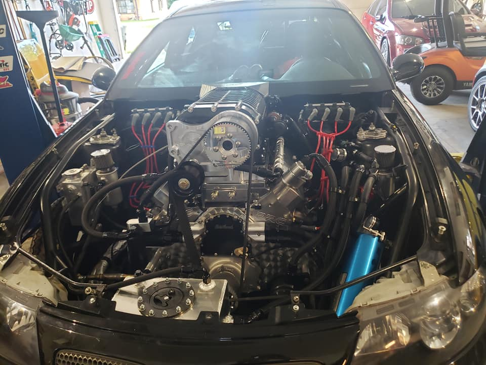

    Is that a dry sump system I see?

    Centrifugals are turbos with an identity crisis. :) Turbos? What ISN'T turbo'd at a drag strip in 2020? It's just so normal now and gets to be pretty boring watching guys incinerate tranny fluid as they bump into a set of staging lights.
    I've always had blower cars. For the last 20 years or so. I just like them.
    Last, Whipples are PD blowers. They are not roots. There's a big difference there.
    I've done a few things here for torque management. Things I'm not quite ready to divulge as the setup is not yet vetted/tested and some of it is new. Stuff I conjured up on my own.
    The car is an IRS. A Strange Engineering 3rd member on a fabbed center section with G Force 3500hp rated outlaw axles. 25.3 cert on the car. The entire rear section is one of a kind. All tubes, all fabbed. AFCO's that have been revalved, the works.
    I've also played with the injection some. This engine is GROSSLY over injected to the point of being absurd. There's a reason for it and I'm pretty confident it'll work to expectation. Chambers have been softened and the quench ring is down around -.110" from the deck height. Block is hard filled. K1 crank and rods from Callies. Athena gaskets with CA625 studs from ARP.
    9.2:1. I could have gone more on the CR, but there's really no reason to with alchohol and this much headroom on the blower.
    It'll just be easier this way as the motor is truly just to see what a top heavy blower will do in this setup. I made the entire blower drive from scratch. Pulleys, idler brackets, the works.
    We stopped counting at 43 pieces that I made for this thing. -winters are long in S. Dakota, lol.
    The car belonged to Chris Nichols. Chris was the founder and lead engineer at G Force Engineering. This car was his mule for exploring and vetting all of their track products. We became friends a few years back and he offered to sell the car last fall. The opportunity fast tracked the whole project by leaps and bounds.
    It sputtered to life for the 1st time Thursday night. Just a few things left before we start testing.
    Hoping for low 5's in the 8th mile and it should run low 8's in the quarter. Traction management will certainly be a real thing with this which is kind of the point with a small tire car. FWIW guys tonight were hitting 5.30's@around 135mph tonight at the track. Big tire cars were knocking down 4's.
    Fingers crossed.

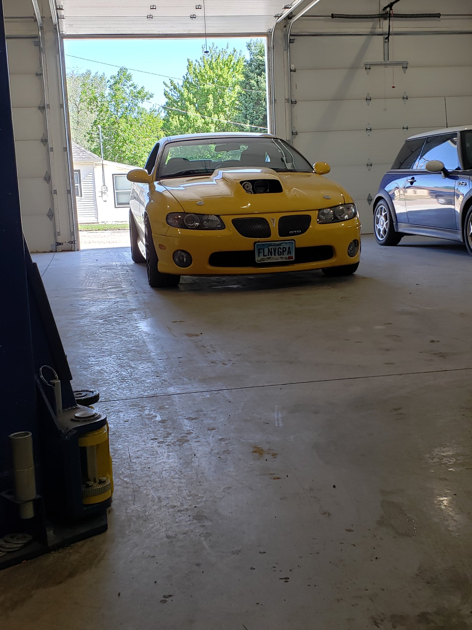

    He is in Sturgis South Dakota.
    That's my other car. My street car is a yellow 2004 GTO with a 421 LS "7-ish" kind of format. I made the 10 rib serp drive from scratch along with some other pieces.
    That engine has a 2.9L Whipple. Car is heavy at 4,400 lbs but routinely sees 6.40's in the 8th mile with good track prep and a 28x10.5 radial. My best to date is a 6.48@109mph. It 60's like a fat kid trying to run, but it rolls pretty good on top. I really want a 5.99 so soon as Whipple cuts the 3.8L loose for the LS platform I'm selling the 2.9 and ordering one.
    Self tuned, its never been on a dyno.
    Should be damn quick. Get it on drag slicks and get us a video at the track. Then you can break the drivetrain and figure out how to strengthen all that up.
    It's a wet motor with a vac pump. Dry sumping a 5.3LS is a bit silly. The 2.0 version on the Dart block will have it though. That one is gonna be a killer.
    Trans is good for well over 2k and the rear end will tolerate 3500. It also has a carbon DS from PST.
