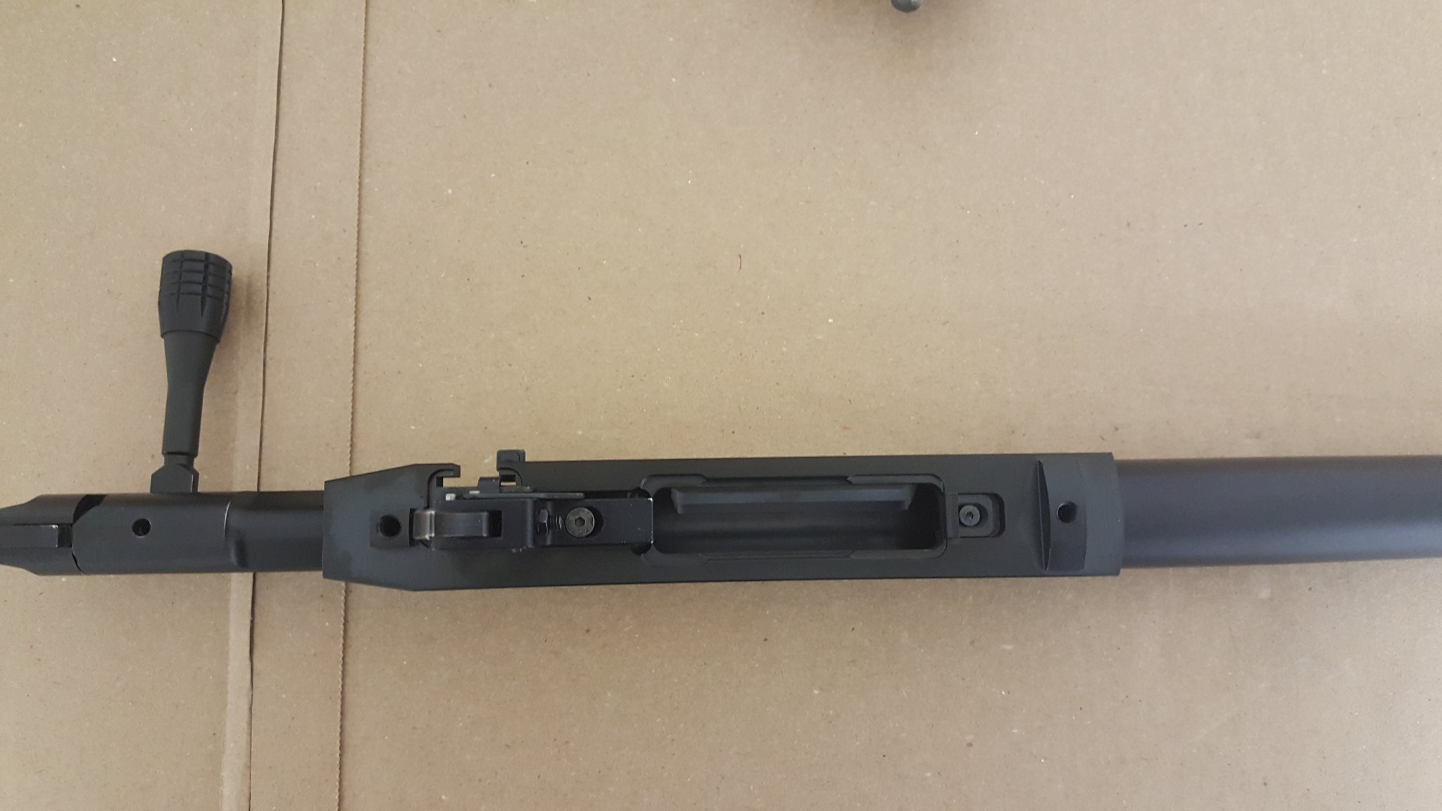

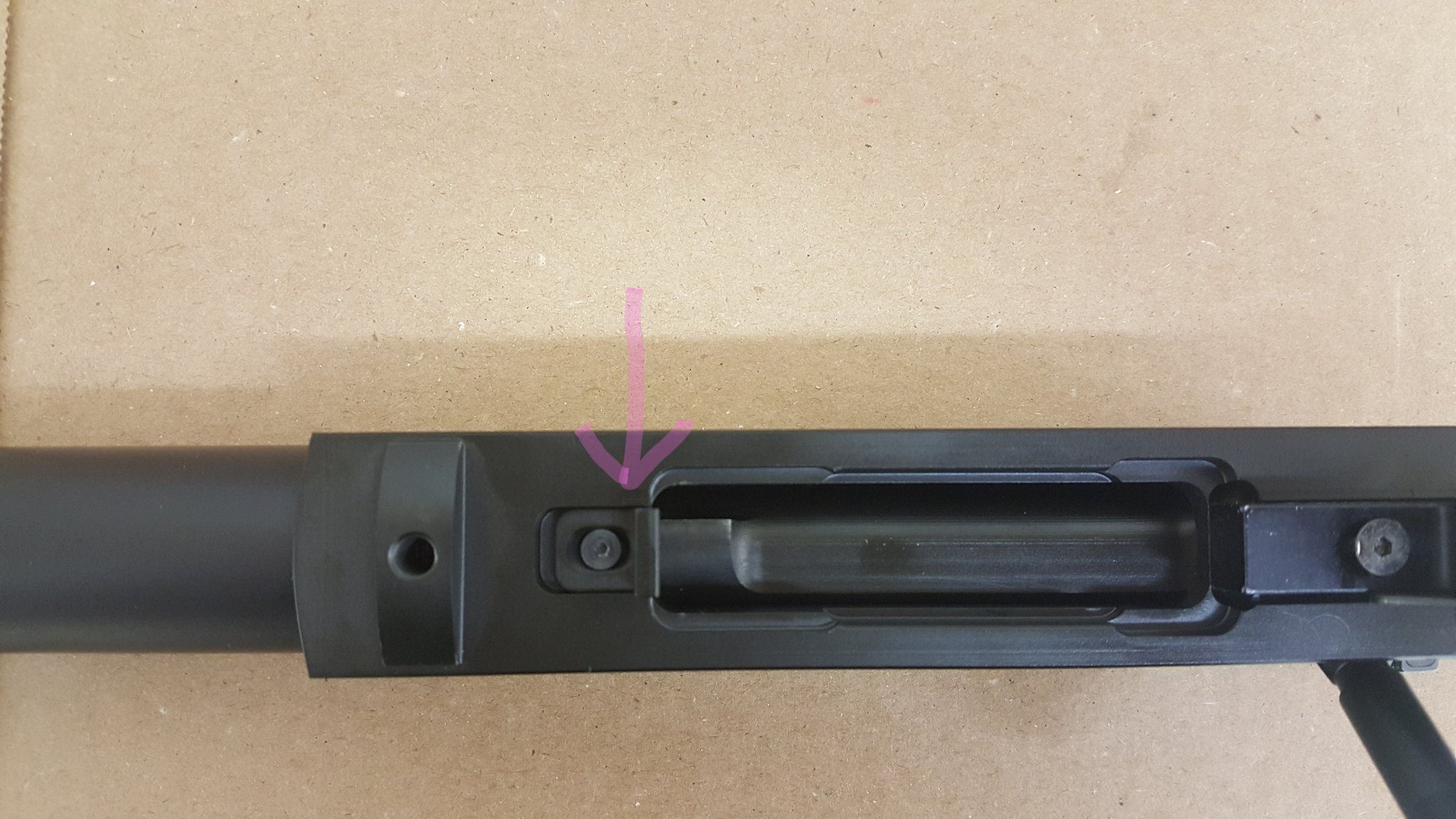

Hi,
Here is another design feature that is utilized yet probably will be unseen by some.
This feature allows us to account for magazine variations but more importantly it allows us to tune the magazine fit/feel.
You want super tight fit or loose fit....we figured if that option was allowed in jeans then why is it not an option in precision rifles...
Sincerely,
Theis
Brilliant! Devils in the details.

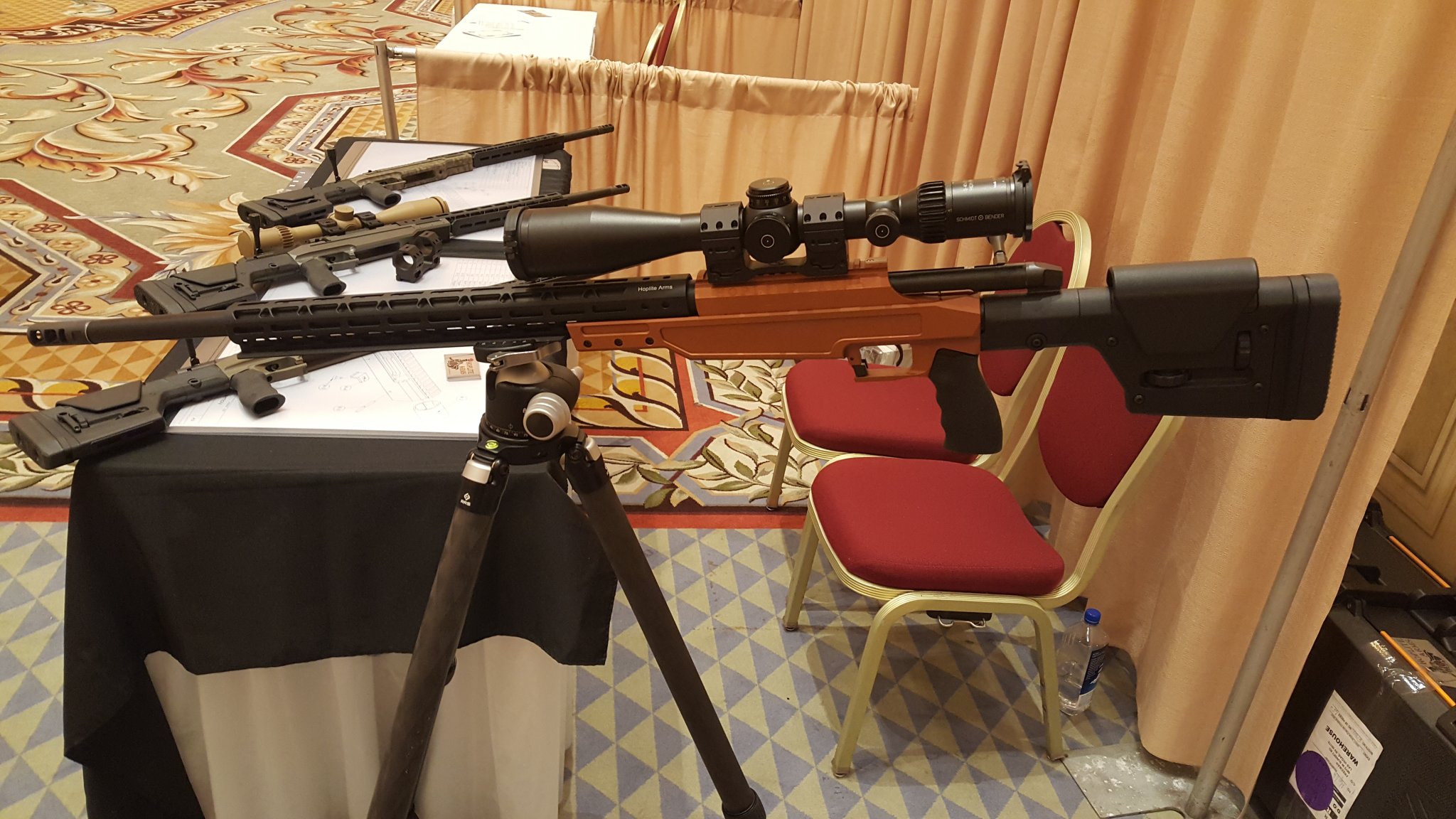

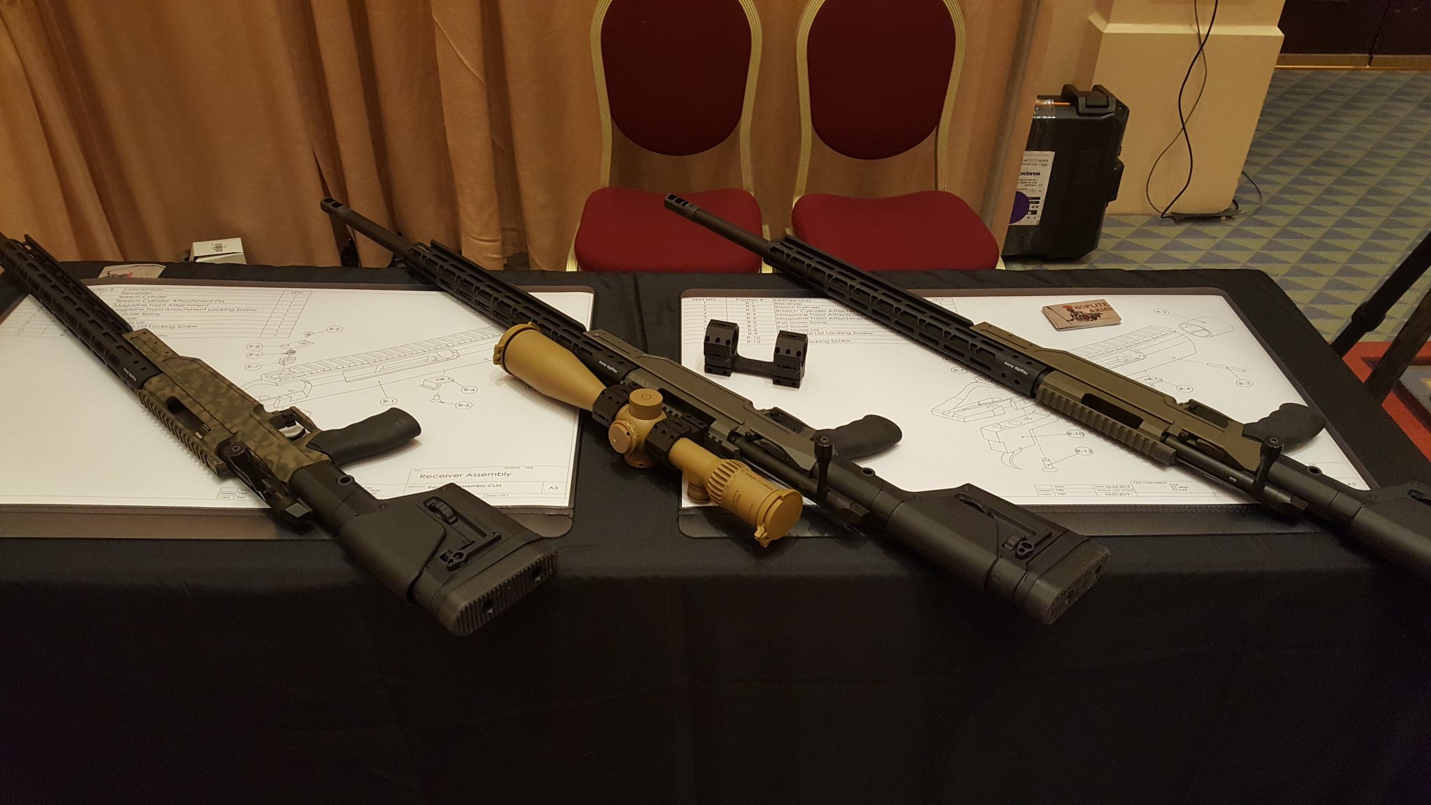

Hi,
So the pop-up preview booth day is over and so ends Hoplite Arms first exhibition.
I will be back at the shop Saturday to sit in peace and quiet to digest the questions, comments and responses we received during the show.
It was a great day today for us and on behalf of myself and the entire Hoplite Arms company I would like to thank some SH members for taking the time from their day to come by and visit with us.
I apologize if I forget to include anyone by name (it is not intentional):
@lowlight
@DAVETOOLEY
@Dthomas3523
@koshkin
@trophyhunter
@steve123 (I think that was you)
@TBACRAY and the rest of the TBAC crew with him
@ELR researcher
@samb300
You T&E guys... give me a little time to get things organized and we will confirm everything for the shipments.
Additions and/or changes to the T&E guys....
Frank getting a 338LM
Ray getting the 18" barrel 308 with handguard cut to only have 1 Mlok slot on bottom for bipod :)
Thomas getting the 260 just to start his torture..then transitioning to the 6GT in Sentinel.
Sincerely,
Theis

During Shot Show we got a few questions in regards to some of the receiver features/design; so just in case any of those same questions were wondered but not asked here I figured would be great place to put them.
Q. How loose/tight is the magazine to insert, is the magazine drop free?
A. Completely dependent on what you as the end user wants it to be. We have designed and incorporated a feature that allows you to set the magazine "tension" per say. See tension piece in picture below..

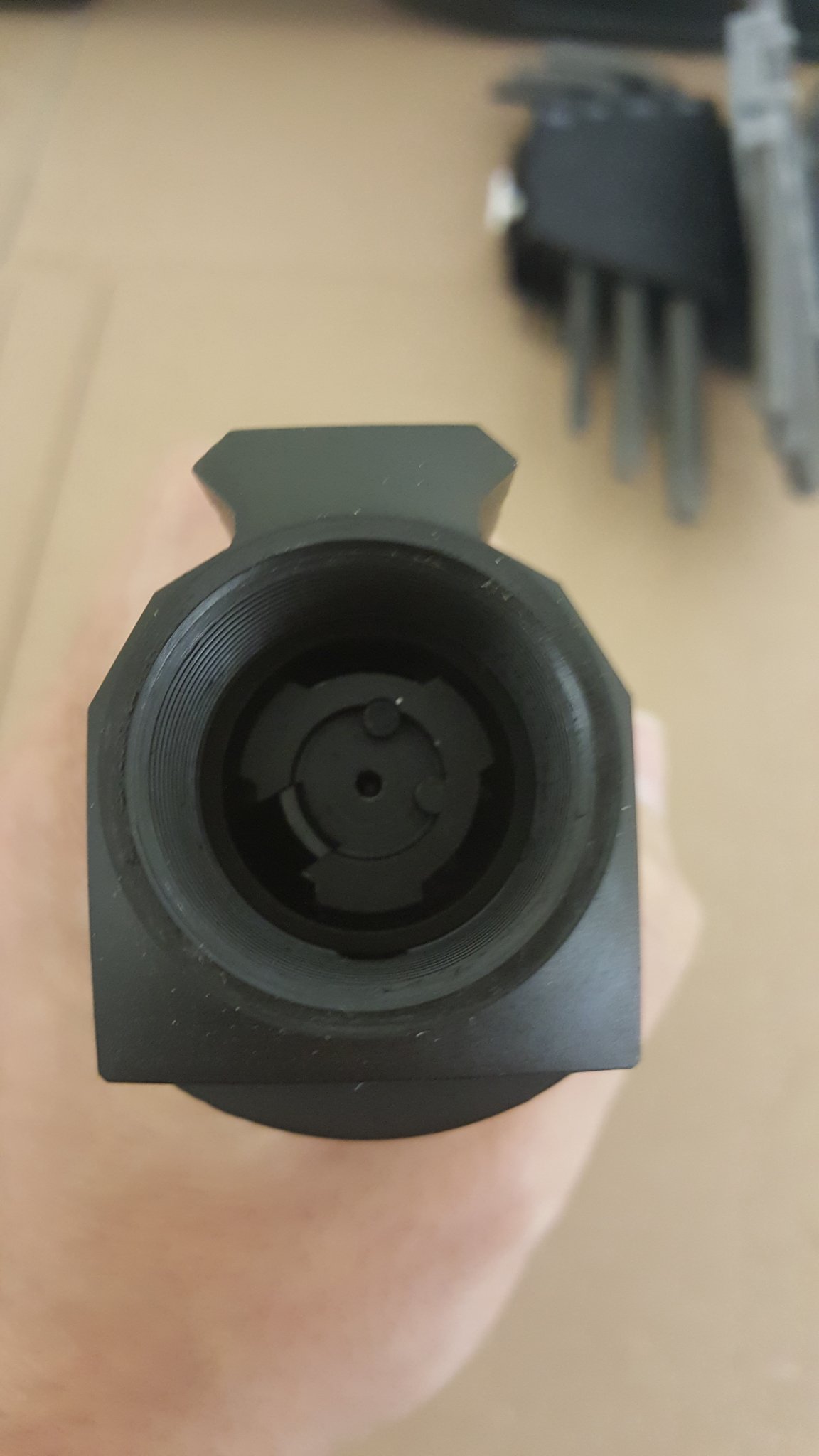

Q. How "close" is the breech cylinder fit into the receiver and what color is it?
A. CLOSE!!! The breech cylinder is inserted past the threads then pinned into place. And we have the Birdsong coated black for this batch.

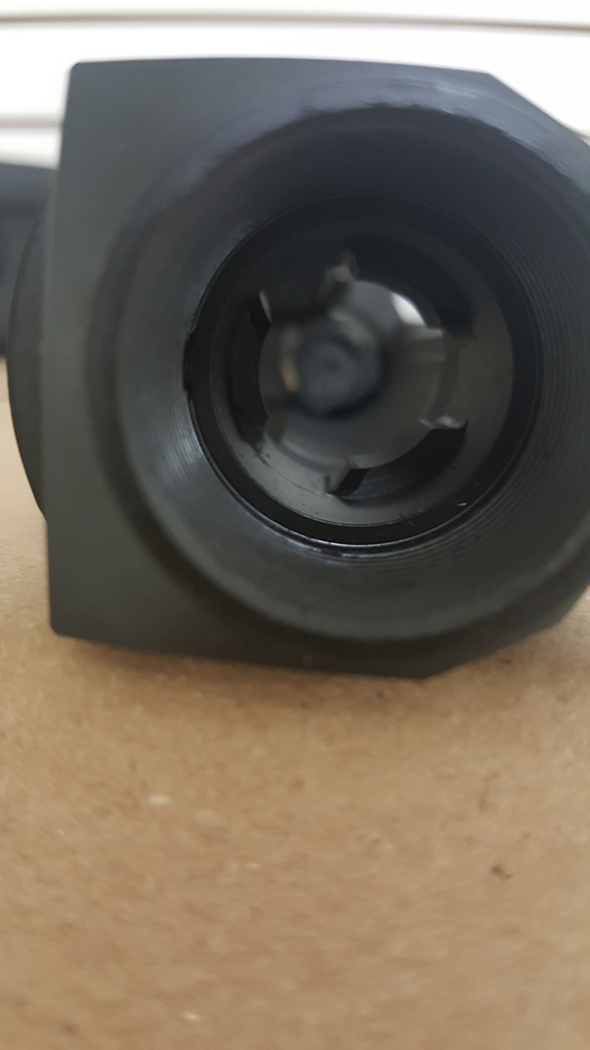

Q. What do the bolt lugs look like in relation to breech cylinder lugs?
A. Please see below image from my cell phone, lol.

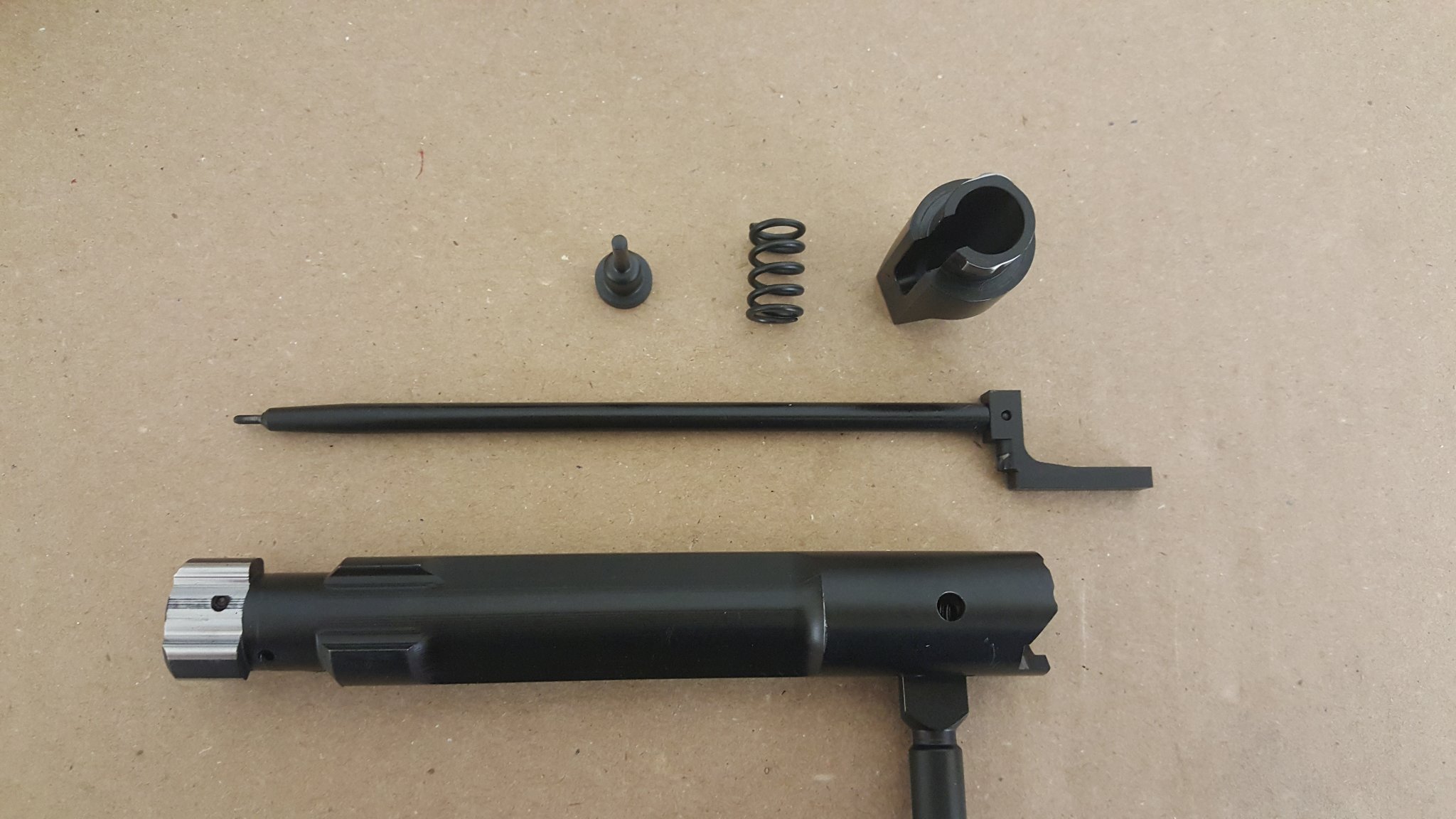

Q. What do the bolt internals look like? How hard is it to remove bolt internals?
A. Please see below picture of the entire fire control system and the bolt assembly/disassembly is done by hand with absolutely no tools. (Maybe some of the guys that seen it at Shot Show will provide 3rd party insight on that)

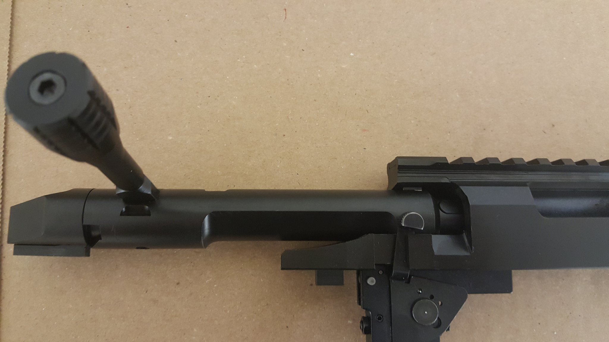

Q. Where is the bolt stop?
A. It is built in as part of the bolt guide. That little spring loaded tab at the very back/top underside of the receiver body is the auto/manual bolt stop.

Quick question
Have you tested to see if the bolt stop is strong enough to stop the bolt coming out of the receiver if for example someone opens the bolt after a hang fire, just in time for one of those huge high pressure rounds to go off?
Somewhere in the future, that might save someone a trip to the hospital, or at least make their trip a bit less expensive.
