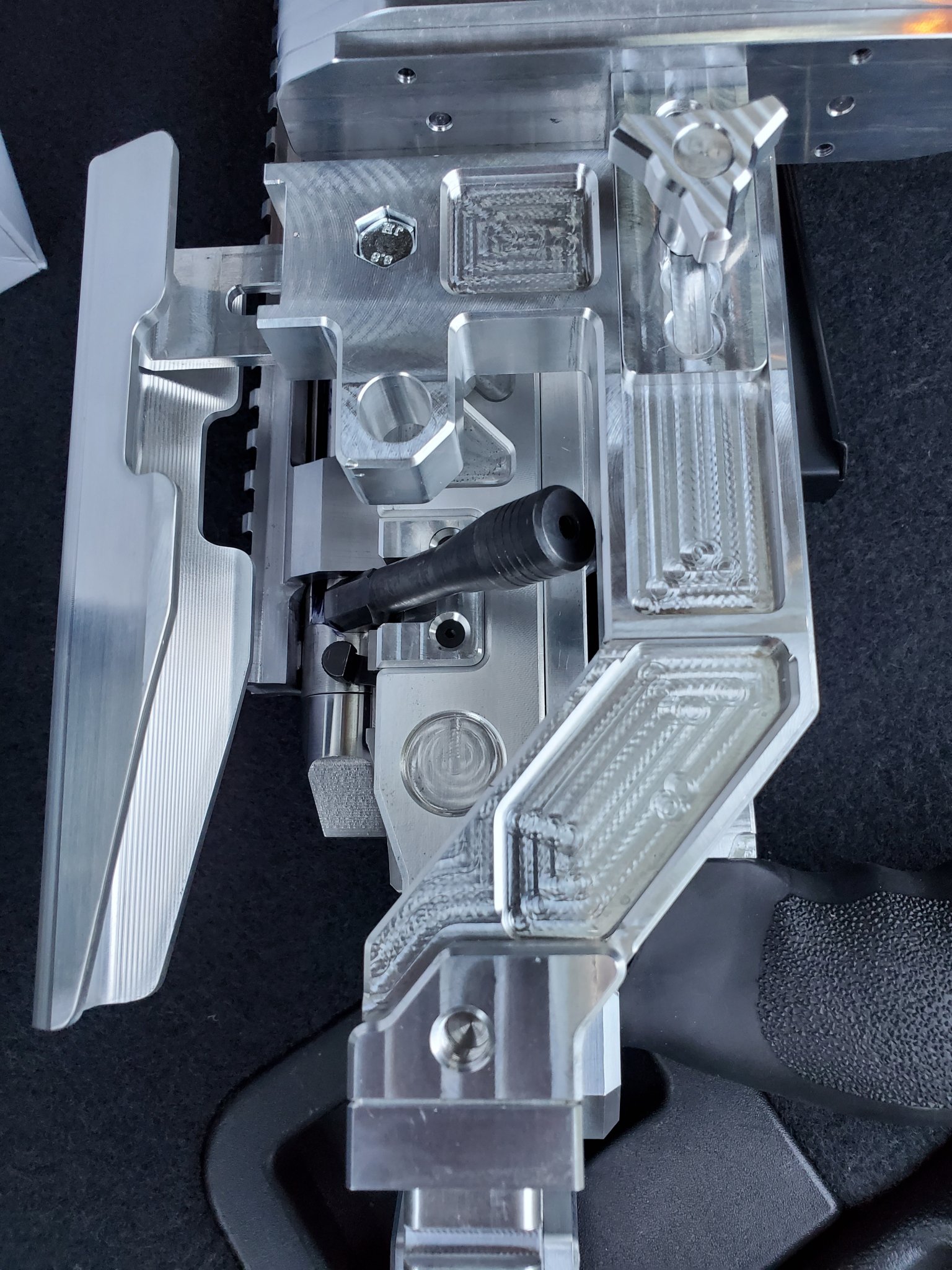

I know what I consider capture the bolt but
When guys say capture the bolt
do they mean:
Right hand action right side folder
when folded the bolt can not be manipulated
When folded it locks in place
I’ve seen all of the above quoted when talking about folding stocks
Think Remington xm2010. I want the folder to capture the bolt. This will make for a more compact package when transporting. The bolt knob doesn’t stick out past the folded stock

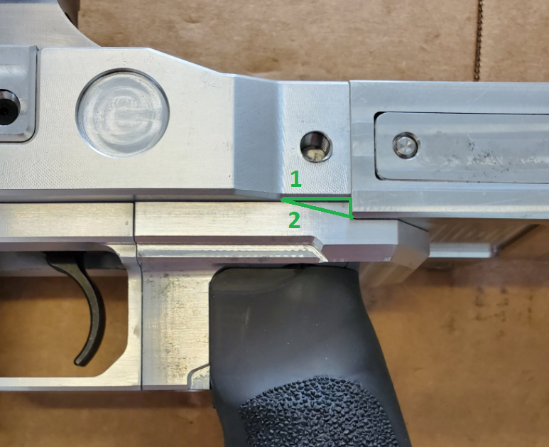

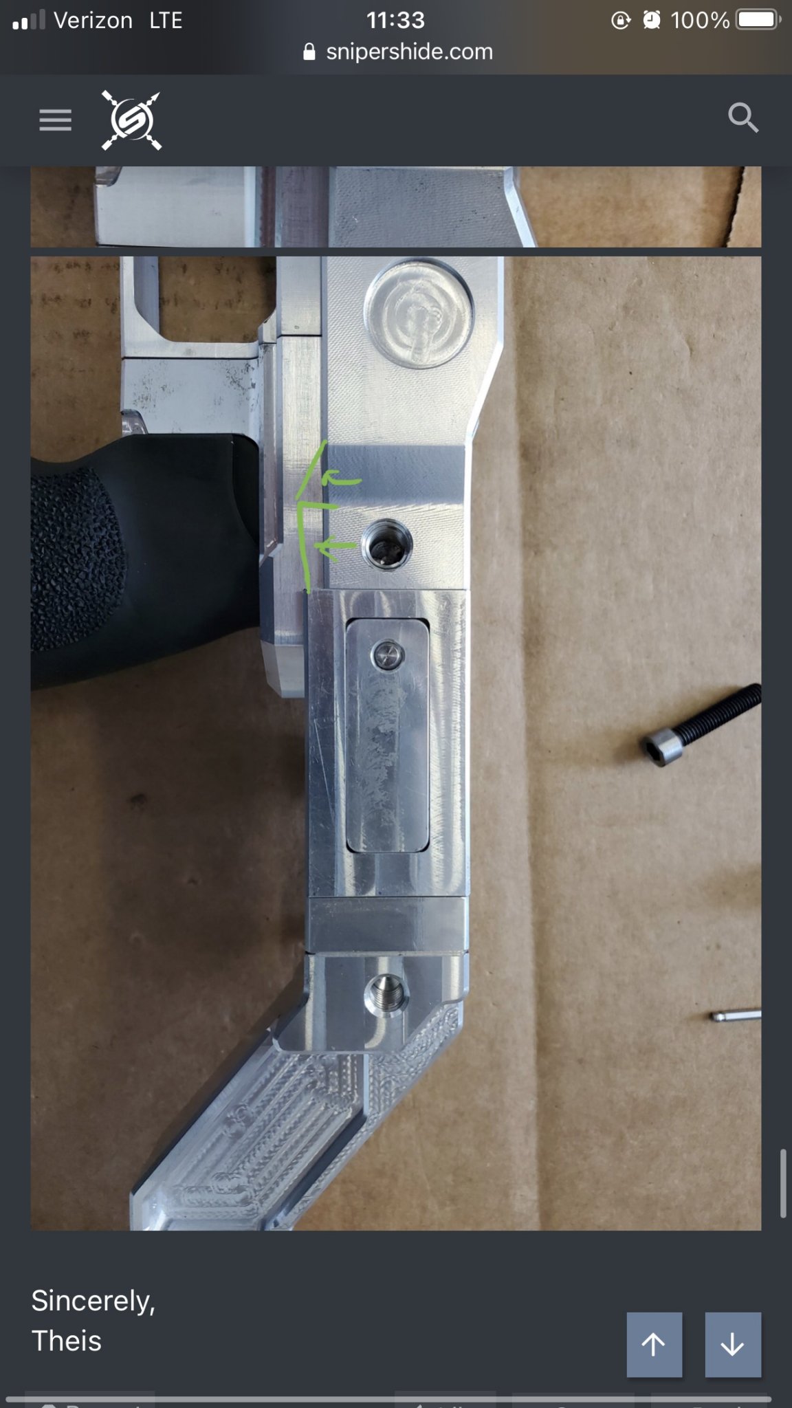

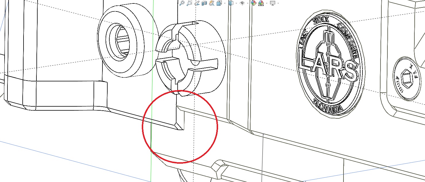

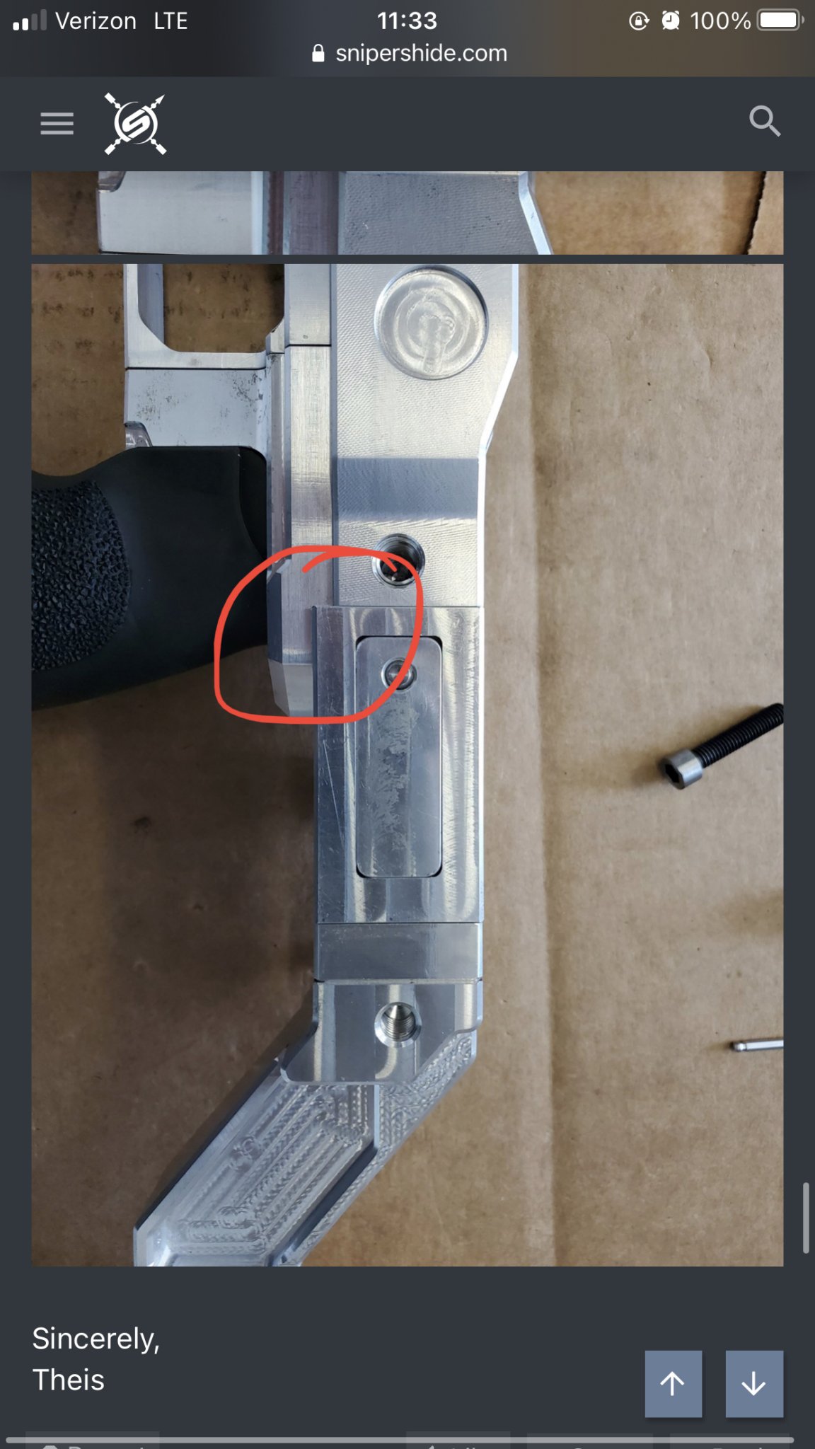

Anything that can be done about this corner? It looks like it could be annoyingly stabby at the most irksome times. Also it pains my visual design sense worse than the misaligned lines between the KRG chassis blocks and forends...
Potential thought: where the chassis bumps out just above this as shown, have the chassis blend down towards that line.
It is sufficient to chamfer the edge

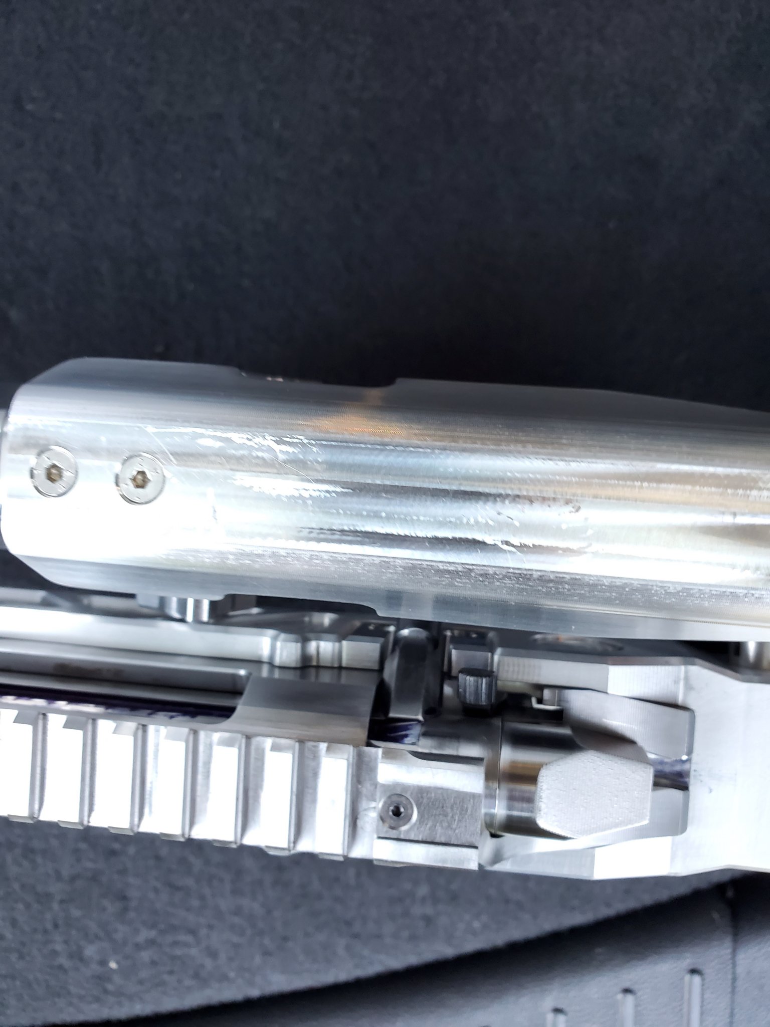

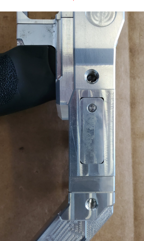

Hi,
Got a couple messages about how does the buttstock fold, lock and unfold.
A flush spring loaded push button operates the latching mechanism that allows the buttstock to swing on its' hinge.
It locks and unlocks by manual push/pull.
Sincerely,
Theis
Holysmokes, that lockup looks tighter than an AI, or a new door on a bank vault.
Reactions: THEIS

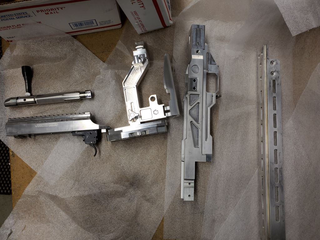

Hi,
@brianf
First one is:
Chassis-Type III Hard Anodized Black
Complete bolt assembly (Interior, springs, etc), receiver interior and trigger-Special metal treatment (Not nitride either, lol) rather than coating...Black
Exterior receiver-PVD DLC, probably black but honestly if coating company calls today and says can get in next PVD DLC batch but color is orange...well it will be orange.
@Lapuapalooza
Press release is in the works right now. Really pushing to announce at New Years celebration but that is dependent on getting this one from coating to Tooley for new alloy LH Gain from Bartlein put on and sent out for independent testing.
Edited To Add:
Production department at coating/treatment has unboxed my stuff :)
Sincerely,
Theis
