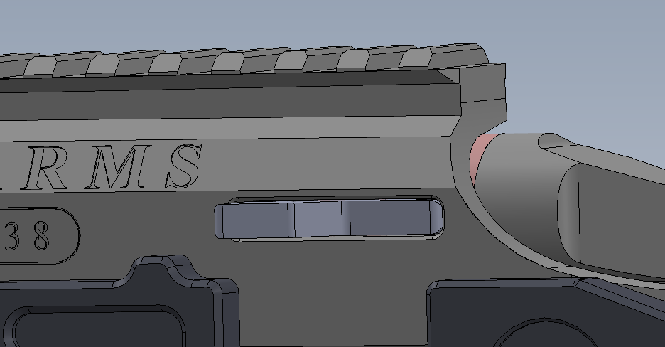

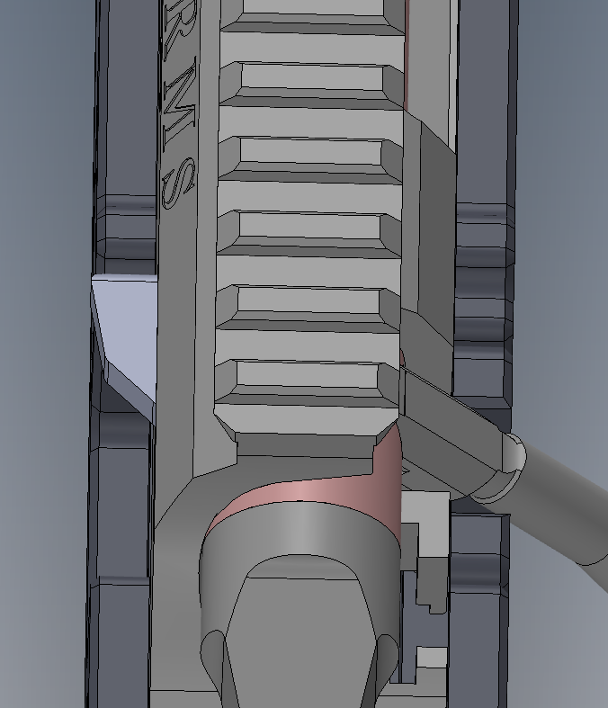

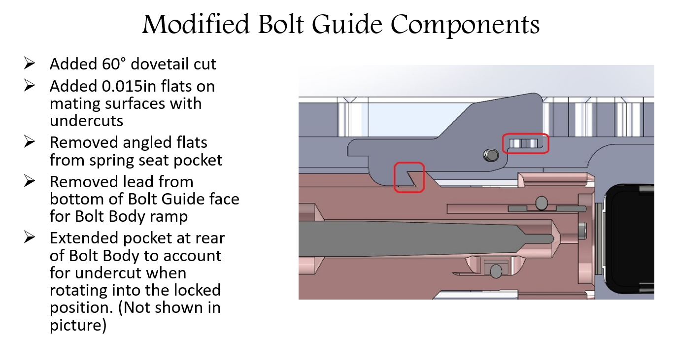

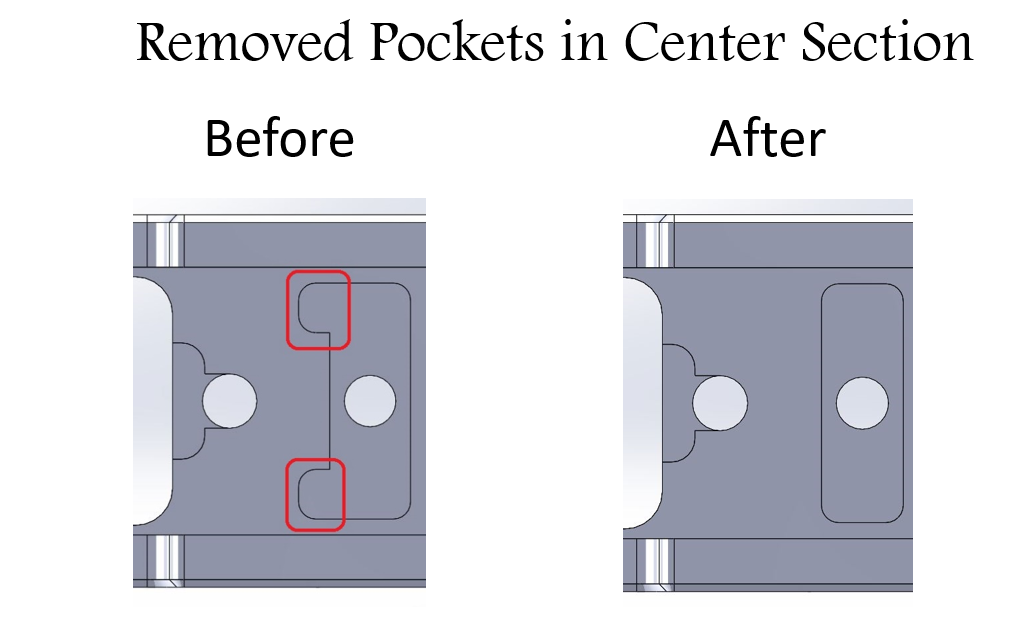

Hi,
So going through the 3D models once again...NOW with the sole purpose of checking viability to bond the receiver to the chassis just in case it is requested by any legal departments for agency utilization or any international gov solicitation/tender.
So X marks the spot, lolol.....hole has to be machined through here in order to access the magazine adjustment catch. We will be able to not only remove/replace the adjustment catch but also adjust it without removing the receiver from the chassis.
Just drop the bottom center section off (Action screws are not touched in doing that) and have easy access to the screw hole.
Same concept for the bolt stop/bolt guide screw....
Sincerely,
Theis

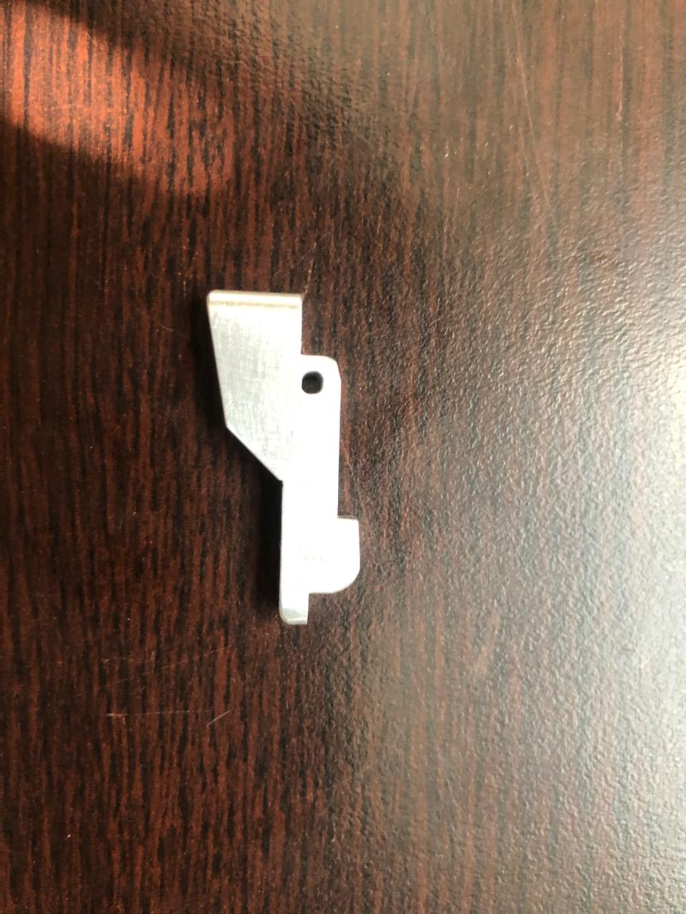

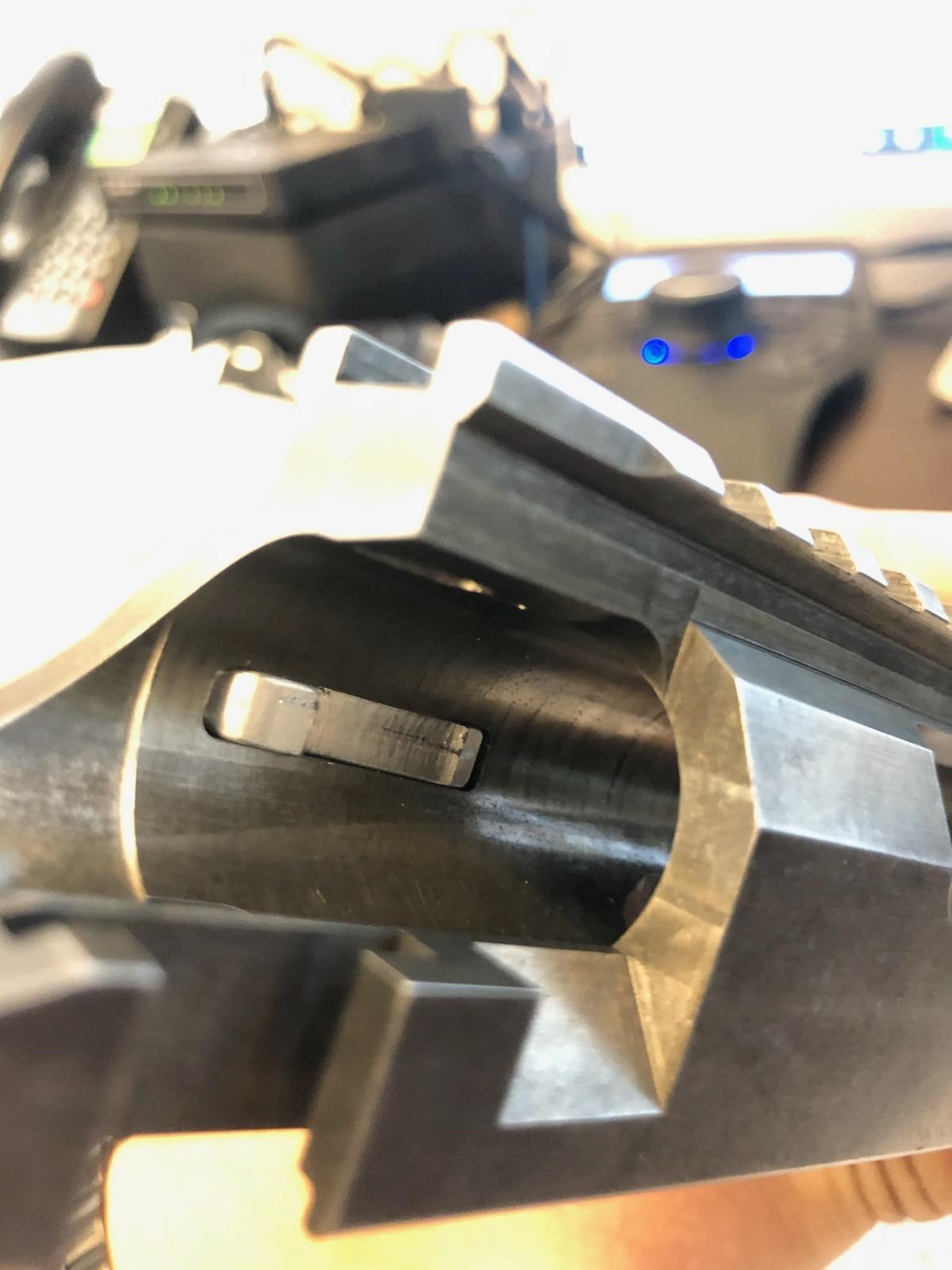

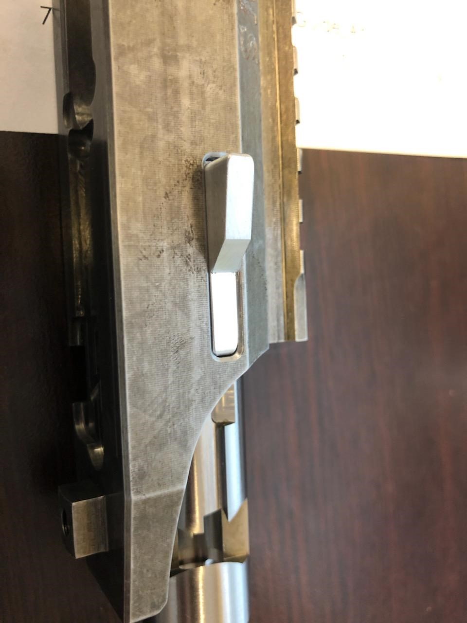

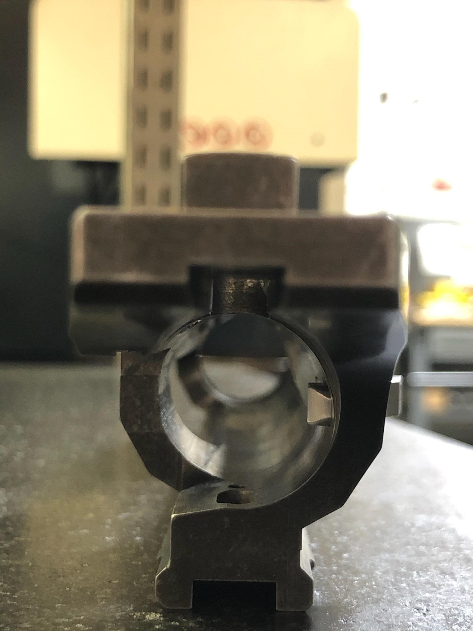

Hi,
Scrap receiver body machined this morning to check raw function of the new bolt stop/bolt guide design.
Bolt stop/bolt guide piece is a pure aluminum mockup that is missing a few radii and such lol, but still allows us to "feel" the bolt come to a stop against it.
All impact force is transmitted into the receiver body without ever touching the pivot screw pin thanks to the oval shaped hole recommendation from @Terry Cross .
It looks like it is super wide but it does not stick out further than the side of the chassis itself.
Sincerely,
Theis

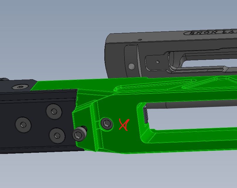

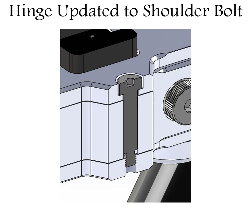

Hi,
So one of the things that has come up over the past few weeks of testing is the folding mechanism in regards to how to make it user adjustable tension on the hinge pivot without the use of any sort of spring.
This shoulder bolt method will allow the user to to decide how much if any tension they would like in the hinge itself once the unlock button is pressed to fold the rear piece. Just turn the allen head shoulder bolt to loosen or tighten the outside hinge to the inside block.
ALSO---- @Dthomas3523 Took it out to the 1 mile today. I will let him fill that information in, lol....as I was eating mexican food while he was handling that.
Sincerely,
Theis
