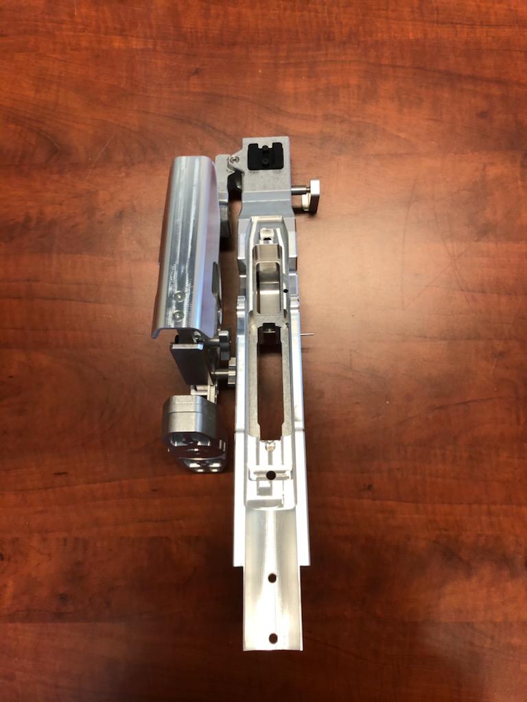

Hi,

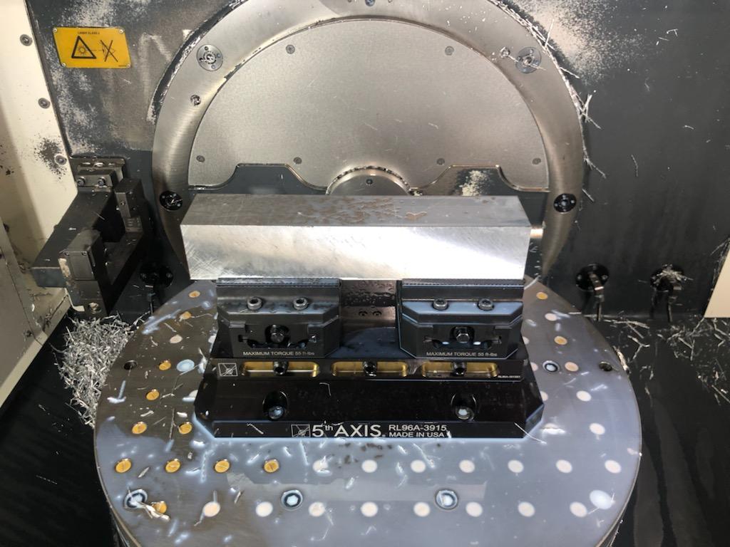

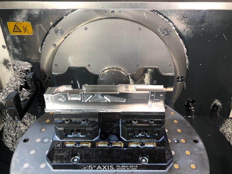

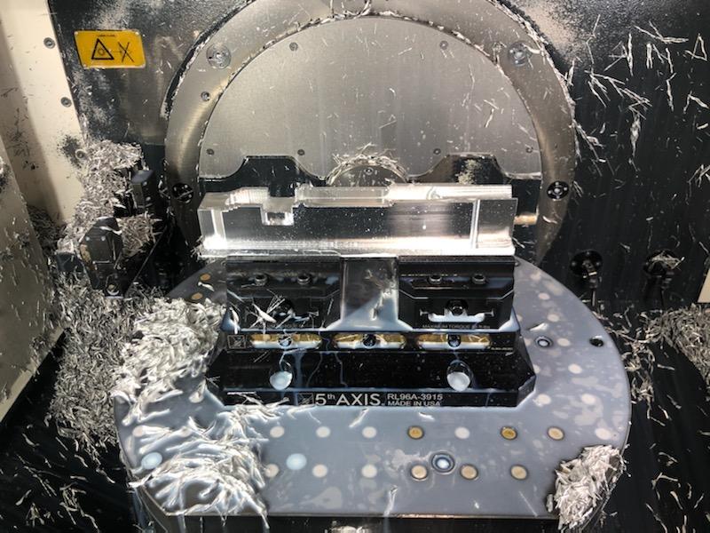

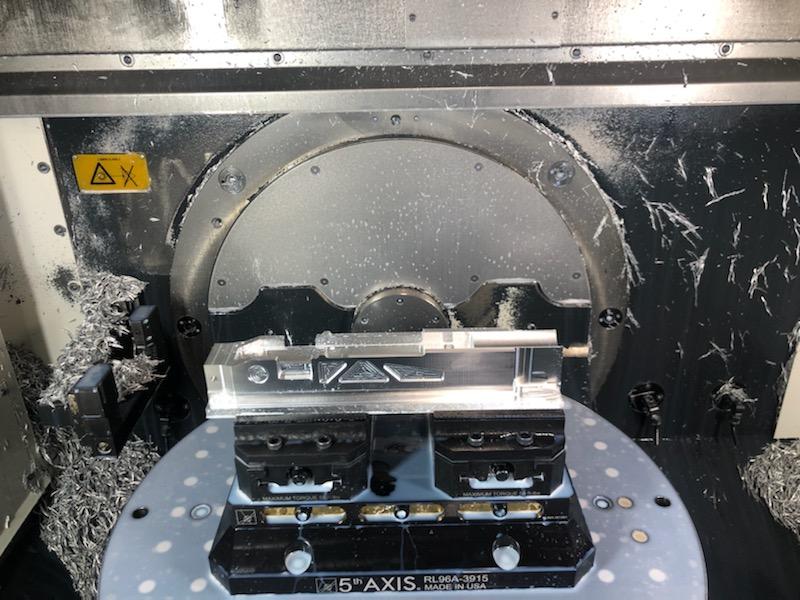

QA/QC doing a quick fitment and function check of the bolt stop/guide piece before completing the machining operations on it.
Back onto machine to finish its shape.
Production receivers do not have that opening on the end of pic rail..that was for the old bolt stop/guide design.
Sincerely,
Theis

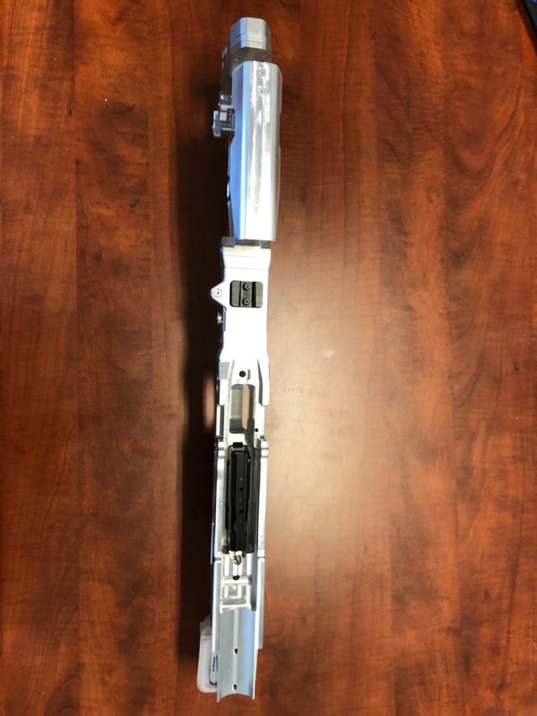

Hi,

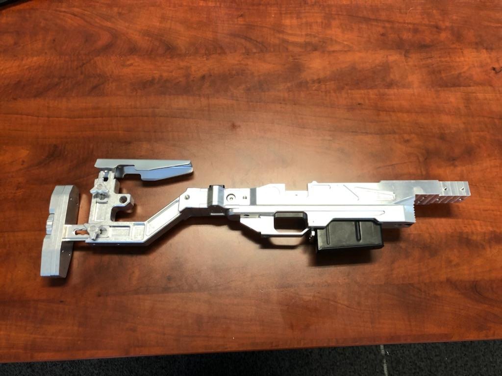

Center section of the chassis is in works today.
Sincerely,
Theis

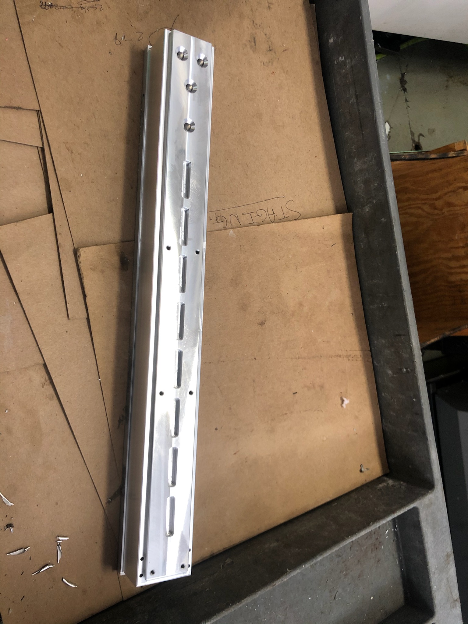

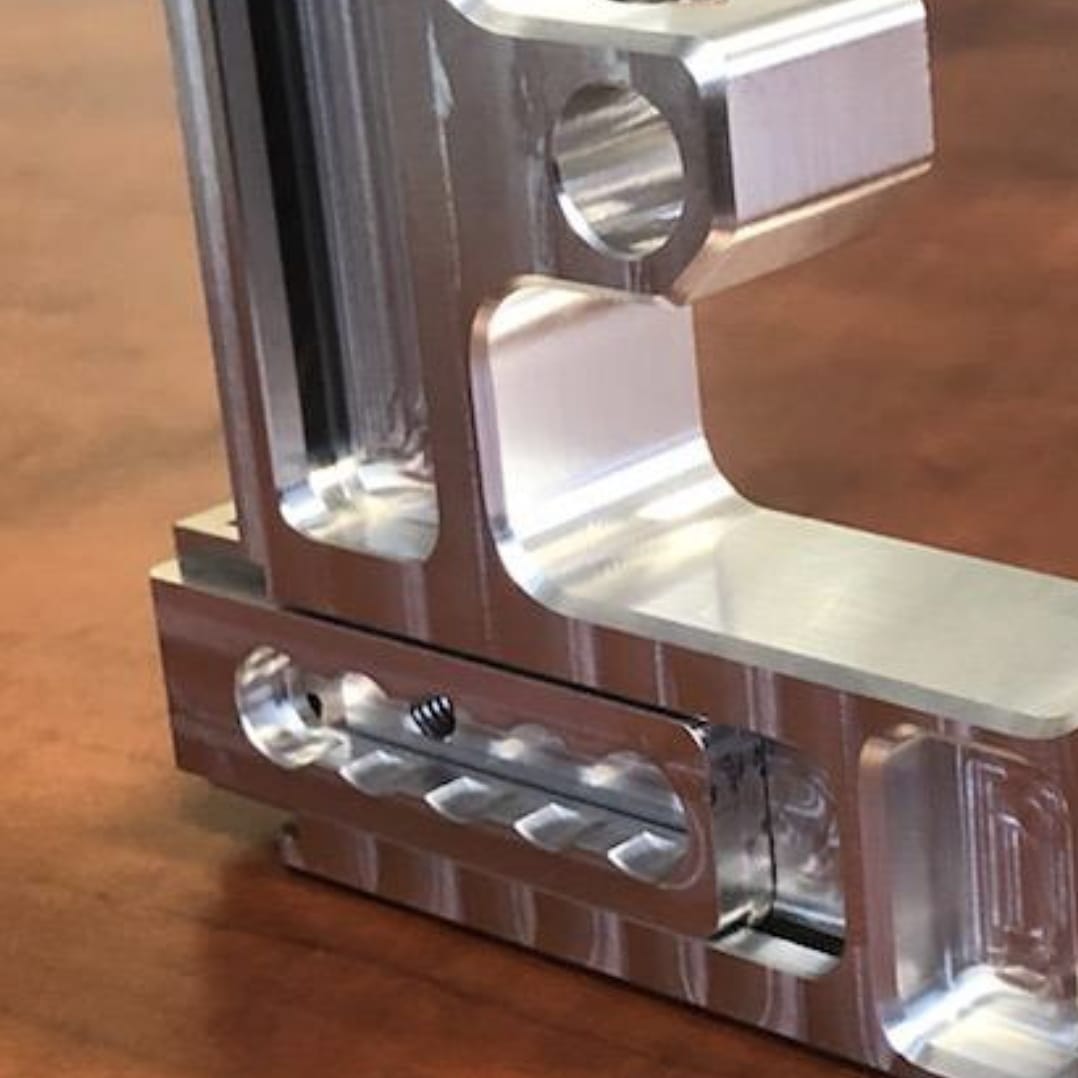

Hi,
Up close look at the LOP and Cheek piece bracket channels.
Now with "trapped" enclosure tracks so the bracket itself does not remove itself from the channel when loosening the adjustment knob.
Significant improvement for the user, user experience and functionality aspects.
Sincerely,
Theis

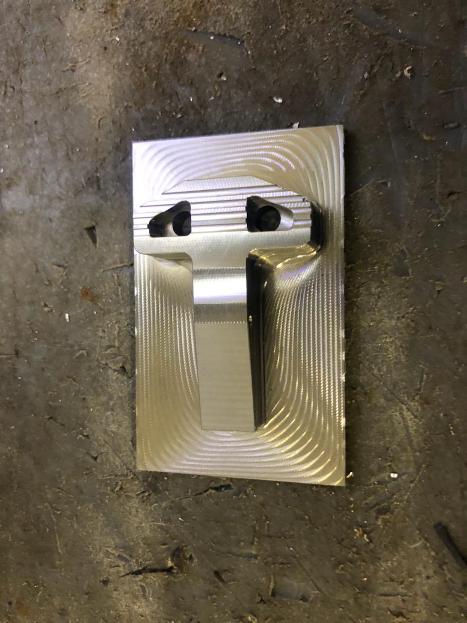

Color looks different unless it’s my phone, what material is that doesn’t look like aluminum?
Hi,
LOLOLOLOL, your phone is not losing its' color calibration, haha.
So the production model rifles will have the magazine release made from 303 stainless instead of the 7075 aluminum.
We spent a fair amount of time going back and forth in regards to why vs why not vs does it matter vs does it not matter......
Ultimately we decided on 303 stainless because after the trigger functioning and the bolt cycling.....magazine release is the most utilized functional operation that we do with a bolt action rifle system.
So might as well make sure the pivot pin doesn't enlarge the pin hole if it gets gritty shit in it.
More than likely the 7075 aluminum would never have been an issue, BUT that 5% chance was just not worth us taking.
Like the Israeli security companies like to say.."Take care of the small things and the big things never happen"...........

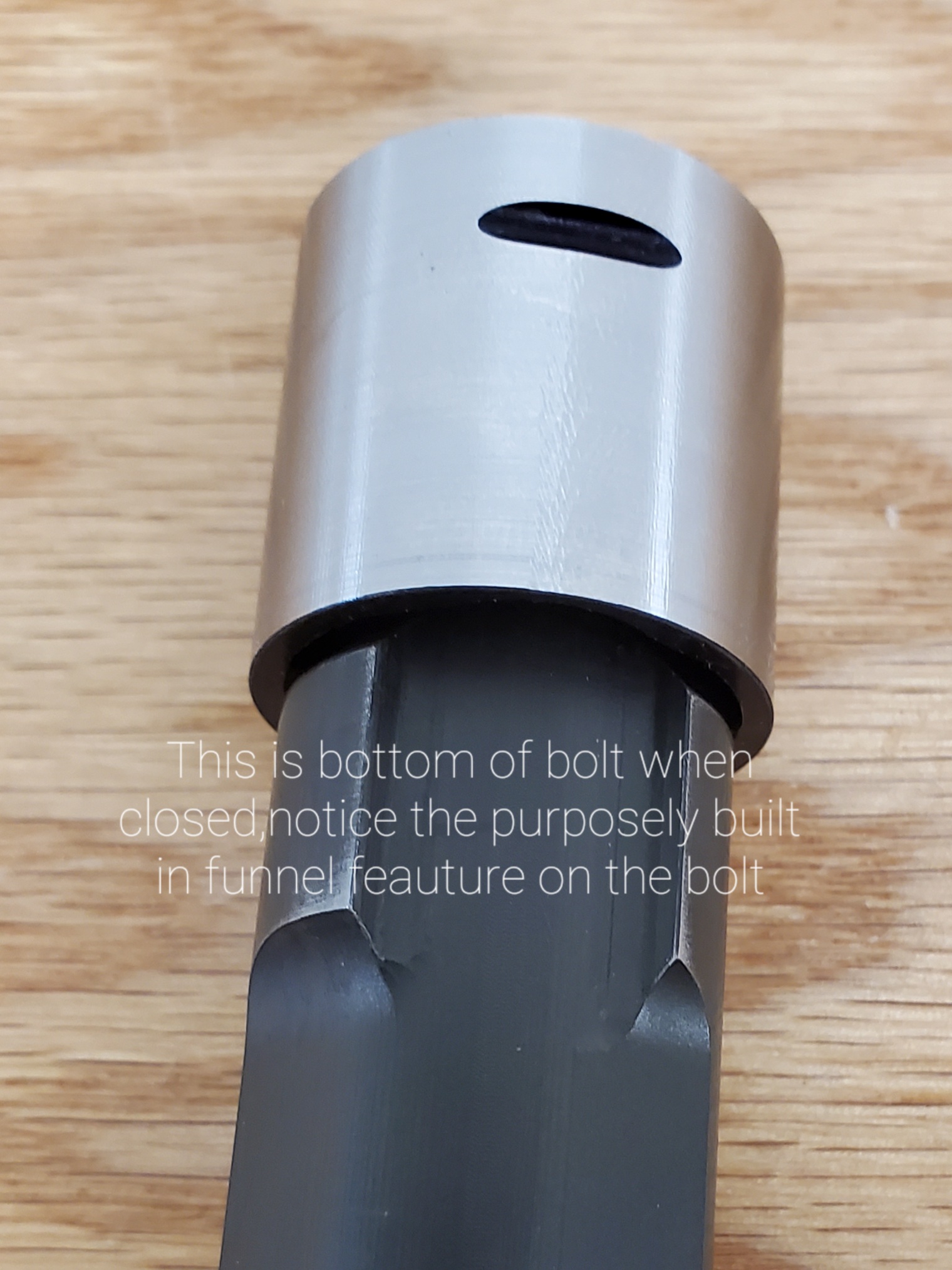

OK everyone; by now most have seen the recent circulating video of a youtuber blowing up his Serbu BMG and all the in's/out's of that discussion.
So I wanted to take a moment to show/highlight a design feature (Other than the Aermet 100 for the bolt and breech cylinder) that deals with and handles an overpressure situation while keeping the shooter better protected.

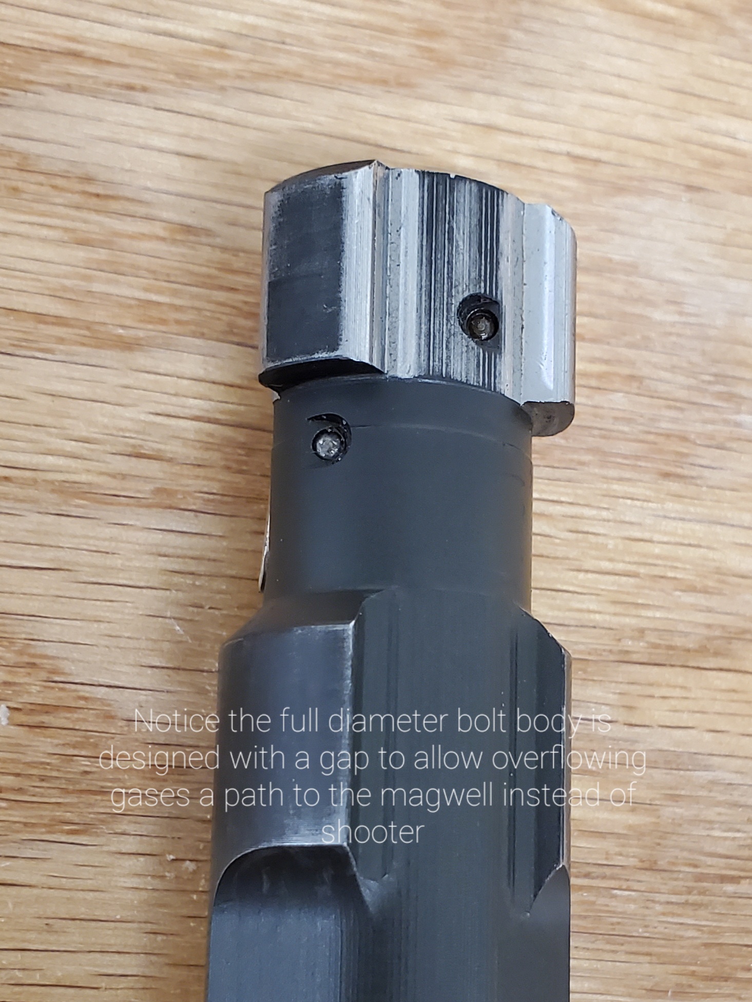

As some of you may or may not have noticed; we do not have a gas port on our receivers.
That is because we have designed/utilize a different safety mechanism into the rifle.

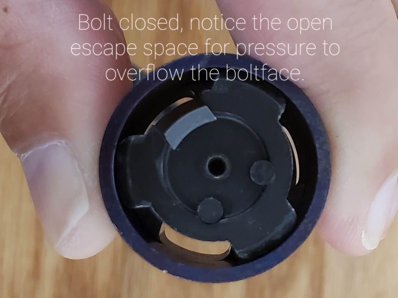

Here is a picture of a closed bolt. Notice the bolt lugs are secured onto the breech cylinder lugs. (T&E RIFLE...production model has way smaller firing pin and firing pin hole along with how the bolt looks, lol)
Notice at that point since the action does not have raceways; that there is 3 openings (each a bolt lug width) for overgas to flow after escaping from the boltface. That flow will go rearward past the breech cylinder area.
Here is picture showing what the bolt looks like when closed in the breech cylinder (bottom view).
Notice the full diameter bolt body has an "interruption" by design. That interruption is a purposely designed gap that acts as an overflow gas channel.
Here is a picture of the bolt with breech cylinder removed so that you can once again see the shape/angle of the full diameter bolt body when in the breech cylinder will act as a gas deflection feature.
All this to direct and dump any overflow gas to and down the magazine well instead of following the receiver raceways to the shooter or needing to have gas ports in the receiver body itself.
Sincerely,
Theis
