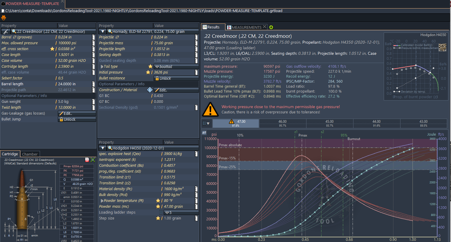

I will respectfully provide some simulation data to help with your estimation. A 75ELDM jammed 60 thousandths, with a case full to the mouth of H4350, (approx. 47gr) with a velocity of 3935fps from a 22 creed is, at minimum, two times the pressure you mention. I'm not quite skilled enough with the software to create exactly that scenario.
For reference, the case head after that 3935fps shot:
However, I can create the scenario in which the case was fired 26 times. 46gr of H4350 behind a 75ELDM with about 10 thousandths jump. At this case fill, the powder was roughly 1/3 to half way up the case neck after being dumped from my Prometheus.
As you can see, the predicted pressure for those 26 shots, which maintained an average velocity of 3790fps... was well over 68kpsi. I've only just started working with gordons tool, so even if I'm off by a fair margin on my setup... I submit that the pressures would well exceed the 68k you mentioned.
For reference, the case head after those 26 firings:

Thanks for your direct insight. You definitely know more of what you done that I do and as I mentioned I am not the guy to discuss the guessed pressures via any of the simulation software programs. I leave that to the guys that know more than I do.
Can you look at the snippet from GRT that I put up and advise as to what data needs to be changed to match your actual loads?
ETA: Nevermind, lol...Your at 47gr. That goes back in line with my previous statement of needing to be more at 46gr instead of what was previously discussed in the videos.
Here is what I have at the 47gr load..
Either way that is awesome good brass from Alpha. I just spoke with KGM Tech suppressors yesterday about the exact same of that new Alpha brass!! It is definitely something we want to link up with Alpha on.

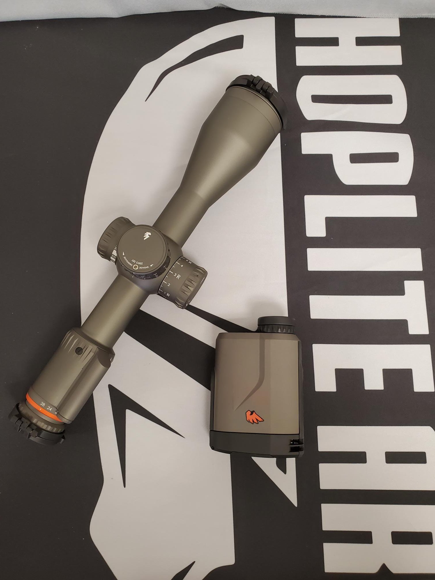

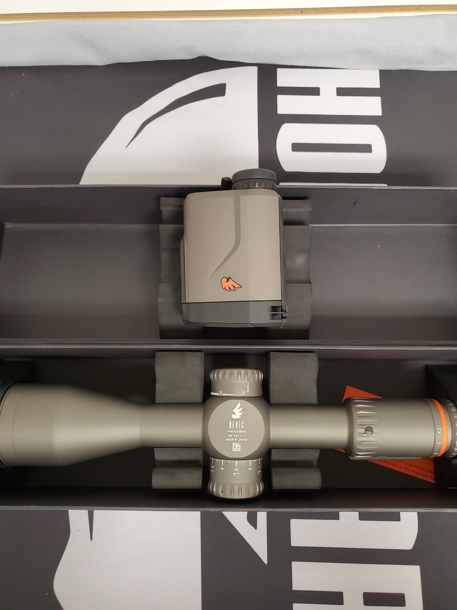

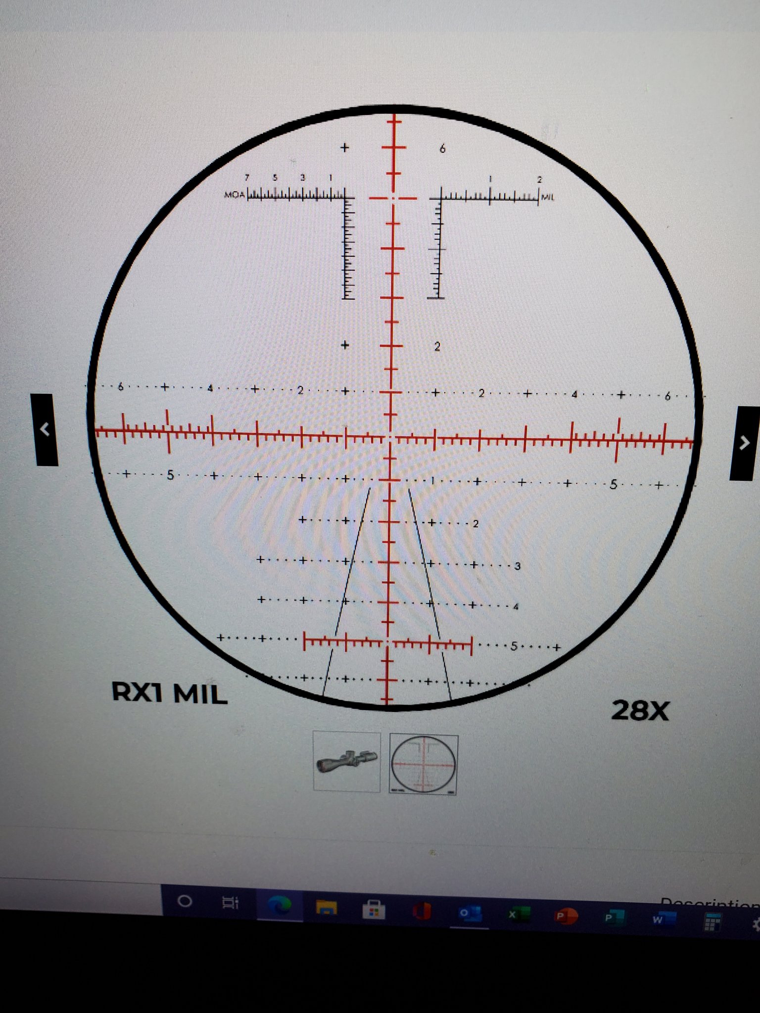

Pictures of the Reticle and hud are in that ad….
