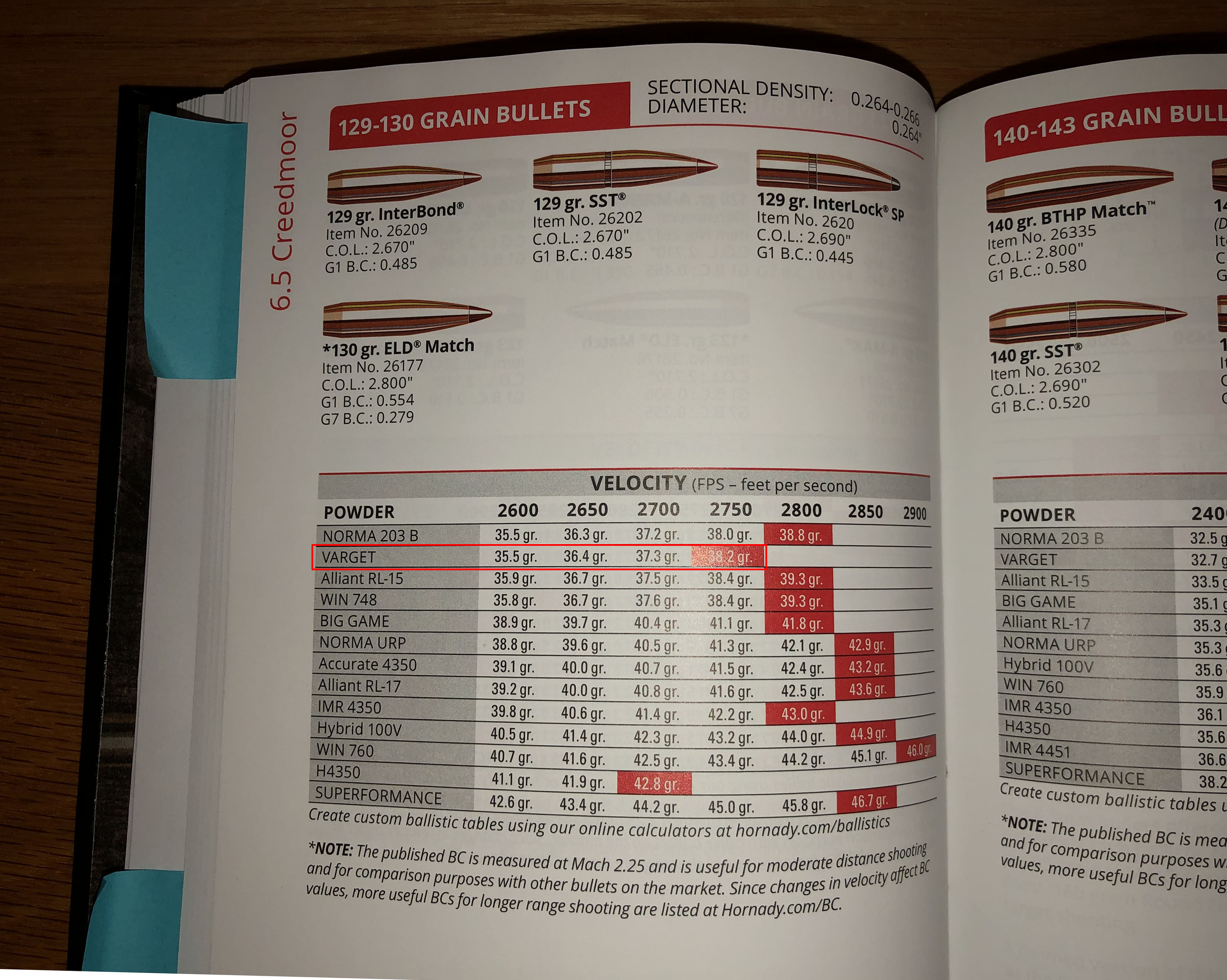

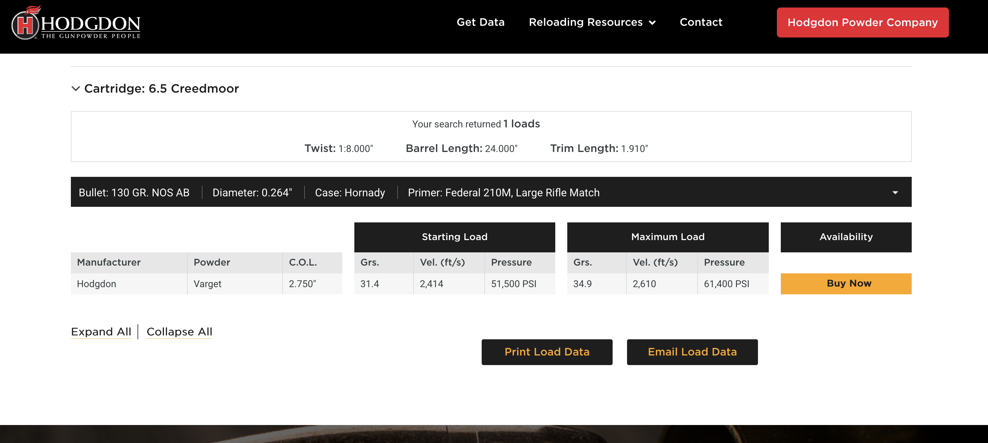

I used Hornady’s 10th Edition for all my load data, but was very surprised today to see Hodgdon’s maximum load for a 130 gr bullet with Varget was below Hornady’s minimum load for the same combination. Could this be right?

Always. You absolutely have to pay attention to the components used in the data as well as the coal.
I always do when I reload, but I thought the Hodgdon data was generic because they did not ask about the specific bullet manufacture. Personally I would never use generic information. I always call the manufacturer if I can't find the information I am looking for. Recently I called the Sierra tech because there was no published data on their 6.5CM 130 gr SMK. The tech told it would be acceptable to use the published data for another Sierra 130 gr bullet.
