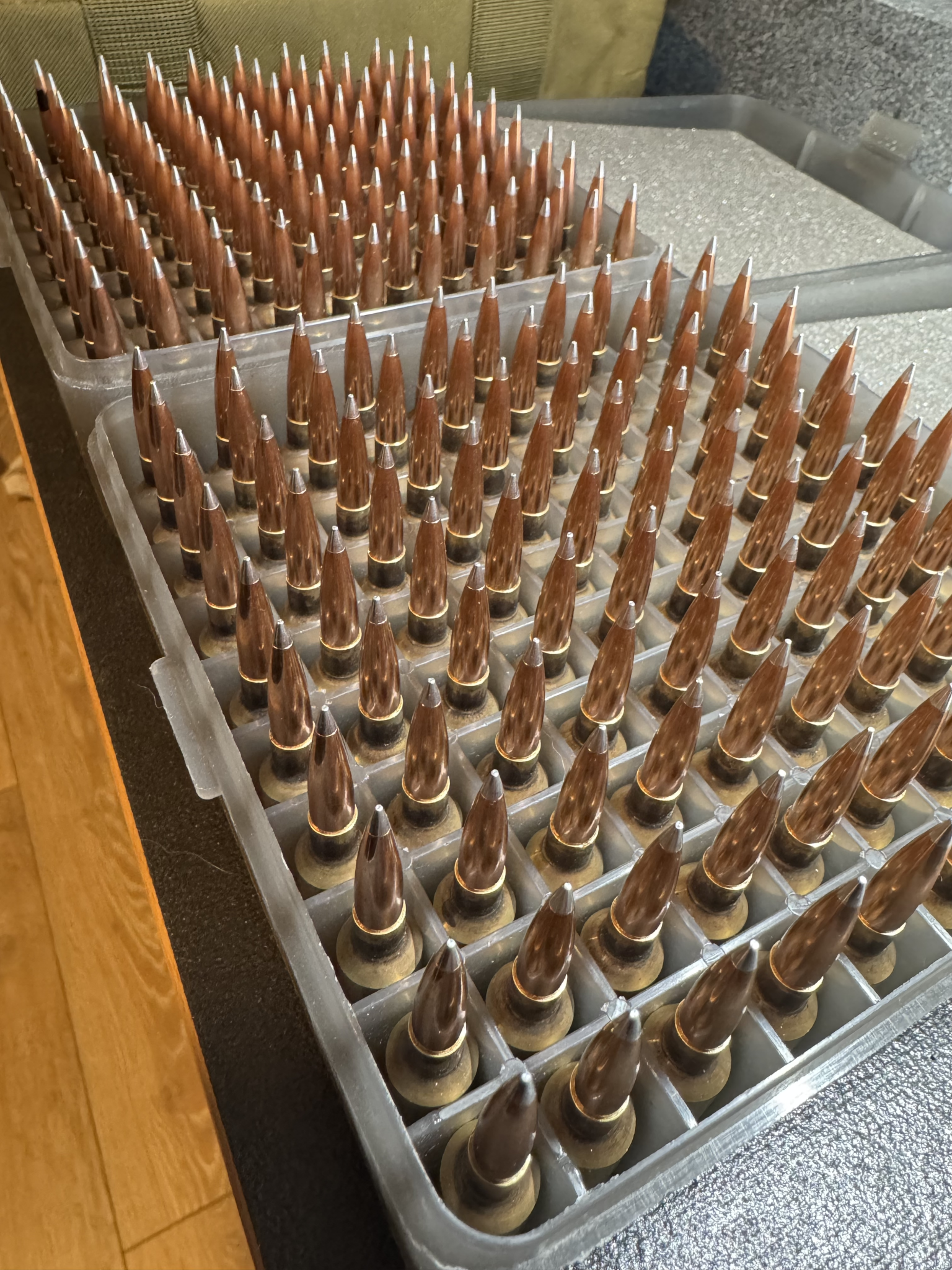

I've shot 800 of them at his point and I still can not figure out why they're called "seconds" or how they are any different from any other A-Tips I've shot (besides them coming in a boring brown box).
So far they've been very consistent and impressive at the speeds I've tried them (~2800-2900fps).

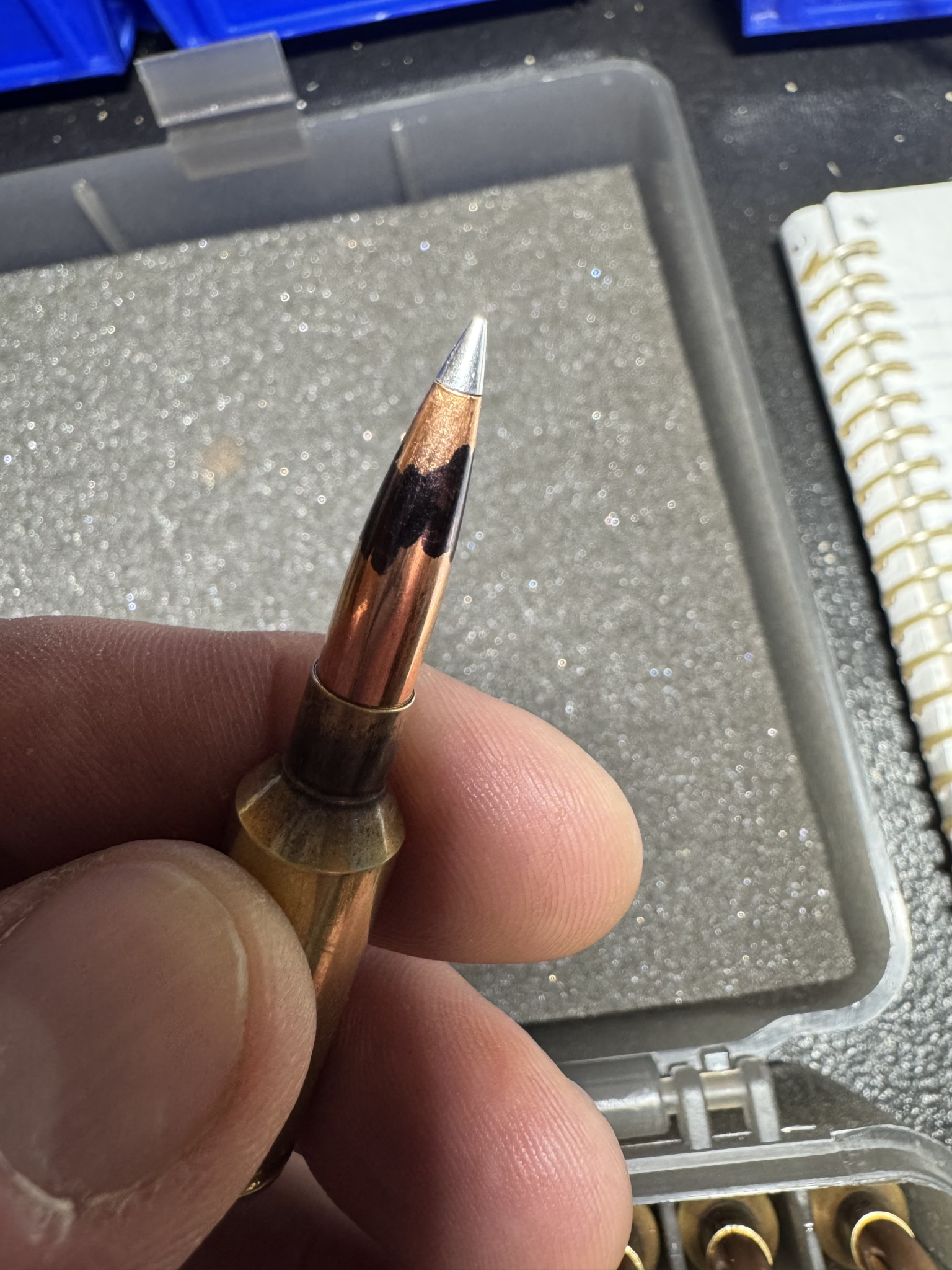

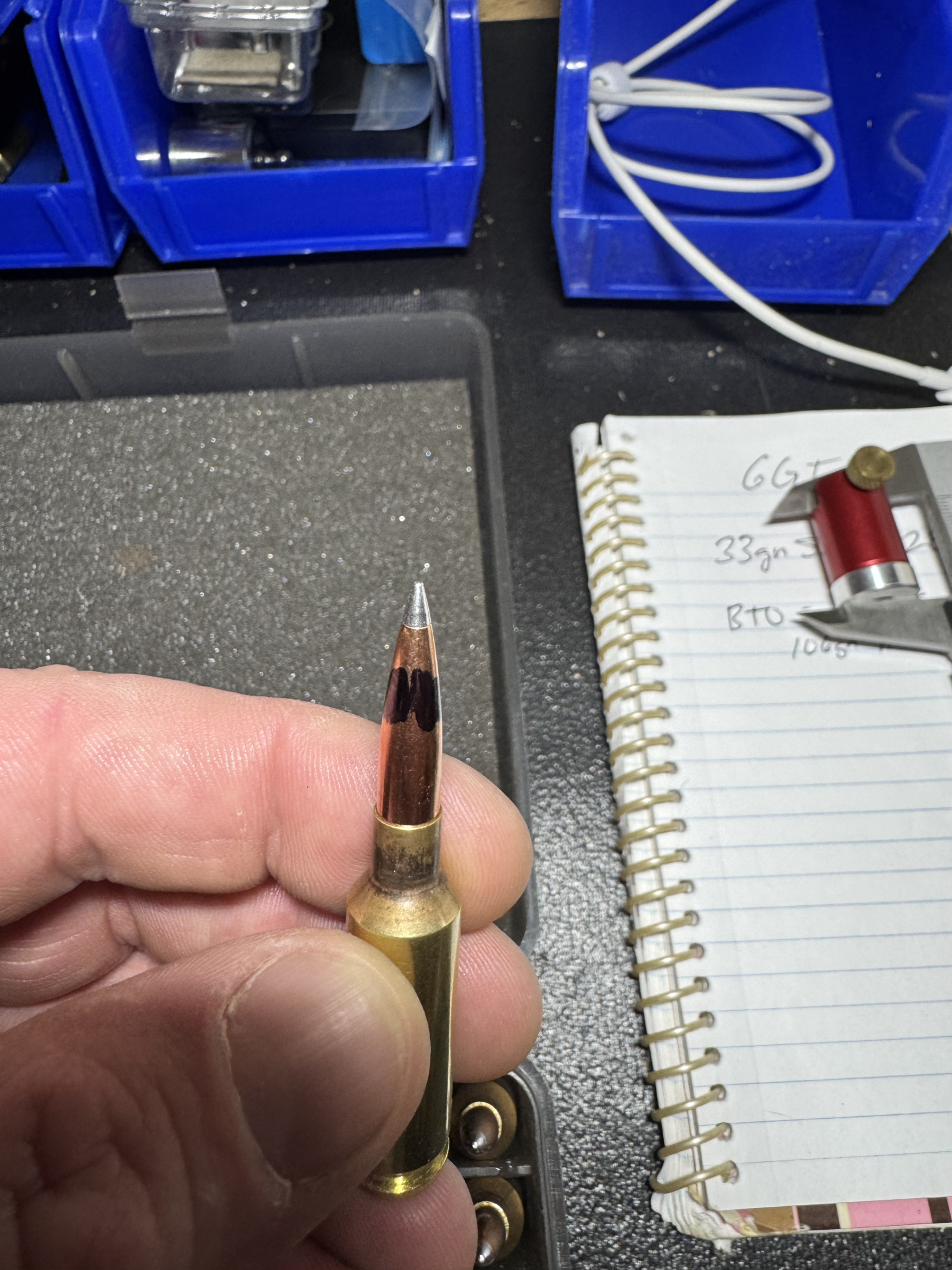

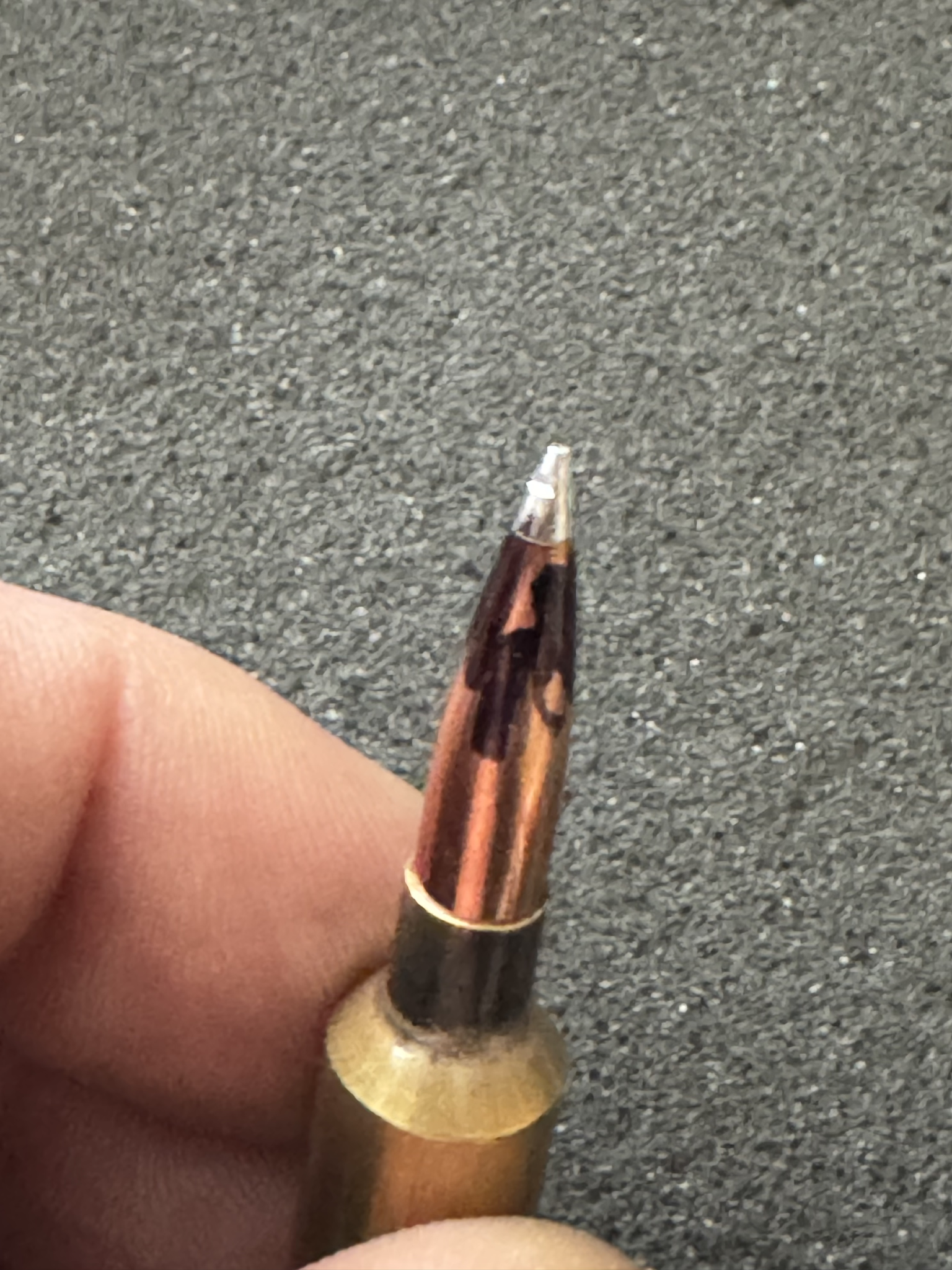

Yea I wish I would have bought more my 6ARC gas gun loves them. I’d like to try them in a 6 creed or a 6 dasherFWIW/BOLO, I've now shot 1000 of the factory second 106gn .243 A-Tips with awesome results and with no signs of why they're "seconds", until today when I was loading 300 more (rounds 1001-1300), when I found one (1) with a f'ed up nose/tip in the first 100ct box, and then two (2) 135gn .264 bullets in the other boxes (1 in each 100ct box).
Not a big deal, but maybe it is something to be on the lookout for. Both 135gn .264 ones wouldn't make it into my seating die, so they were easy to discover, and I found the 1 with the messed up nose/tip when just looking over the whole batch and case gauging a few here and there as a final quality control step I do where I look for anything wonky (and admire my work lol) when I'm done with a batch.
I wonder how the one with the messed up nose would have shot.FWIW/BOLO, I've now shot 1000 of the factory second 106gn .243 A-Tips with awesome results and with no signs of why they're "seconds", until today when I was loading 300 more (rounds 1001-1300), when I found one (1) with a f'ed up nose/tip in the first 100ct box, and then two (2) 135gn .264 bullets in the other boxes (1 in each 100ct box).
I had 2 123 gr eld-ms break tips while loading into the chamber of my 6.5 Grendel during a match. On the clock, if it fits it ships. Both hit a 2 moa plate from a solid prop at 4-500 yards. Not a real feat of accuracy, but good enough in the moment.I wonder how the one with the messed up nose would have shot.
