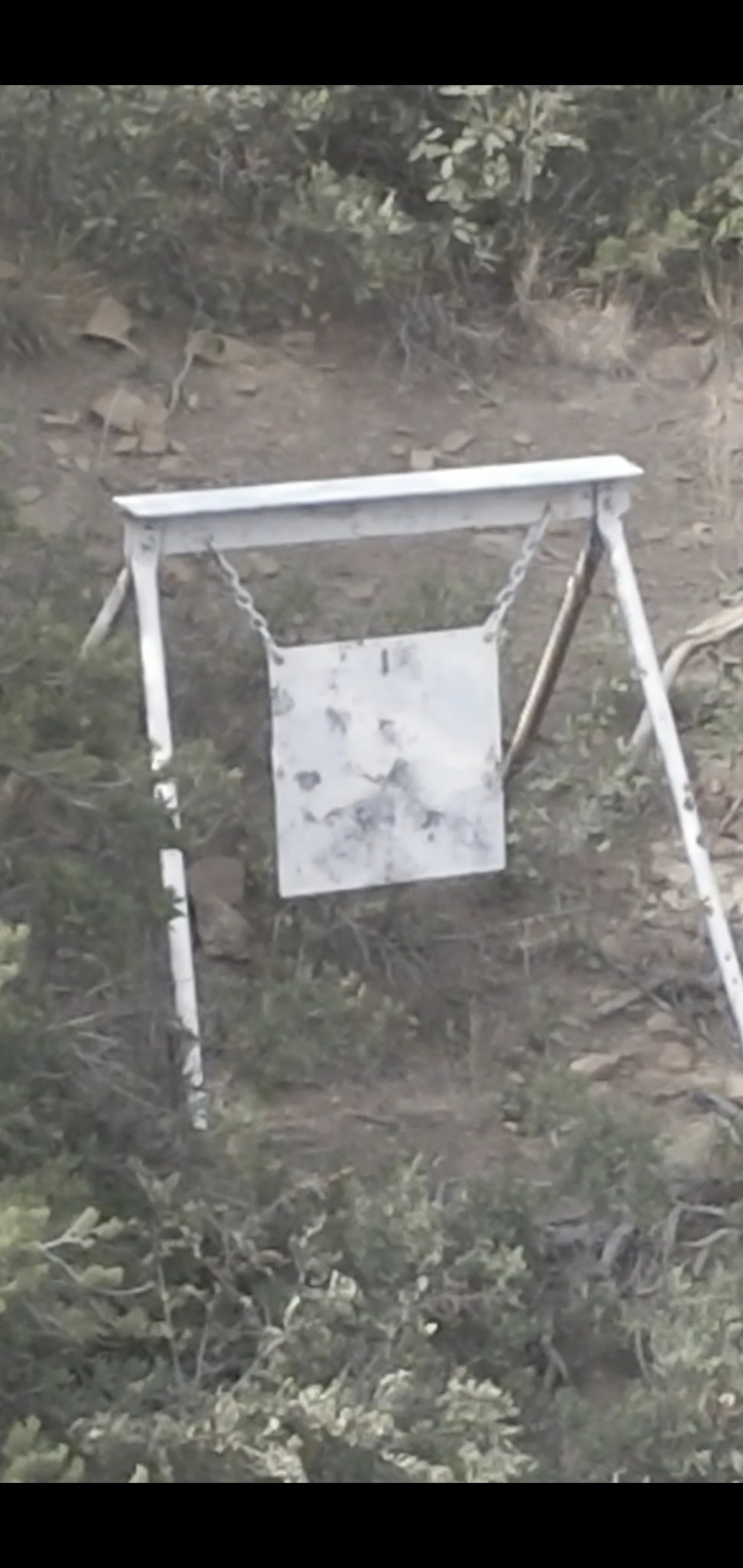

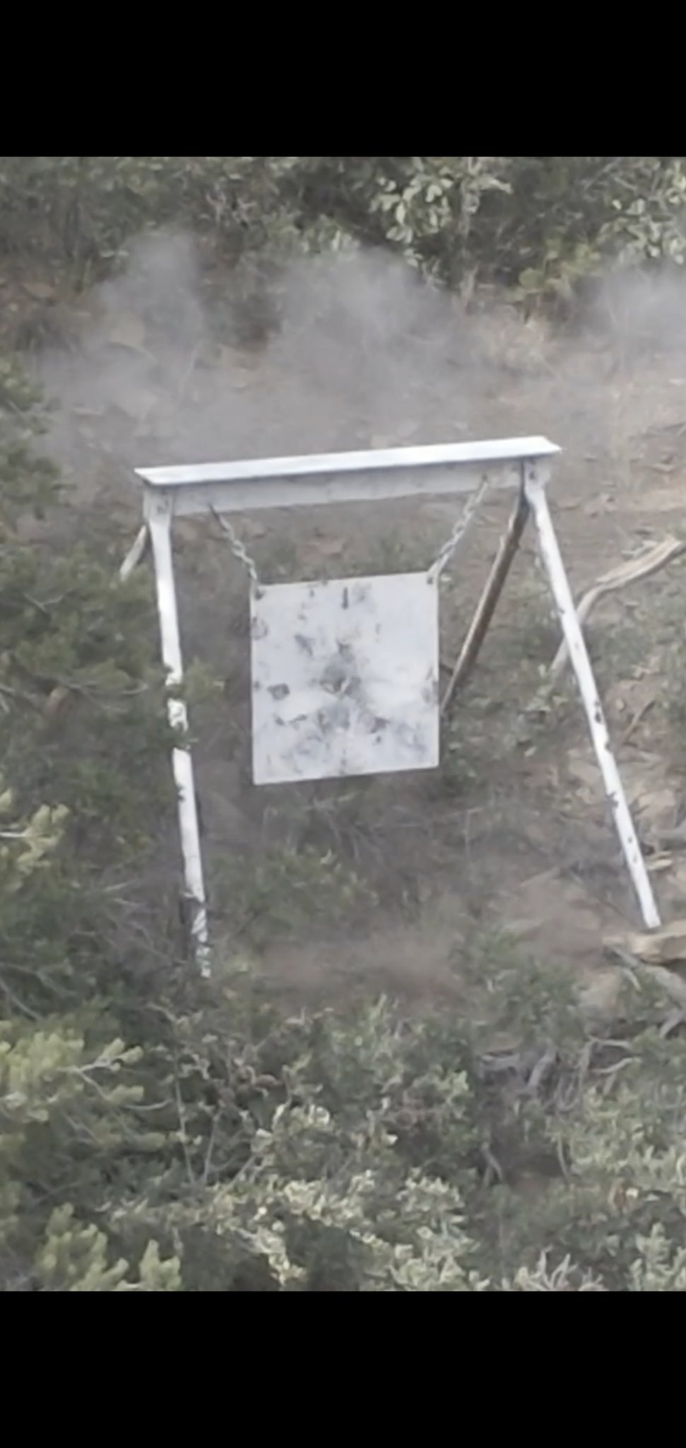

Hornady 338 300 grain A-Tip
This is only a 100 yards but it’s through a factory 700p. But here is this old school load I put together.

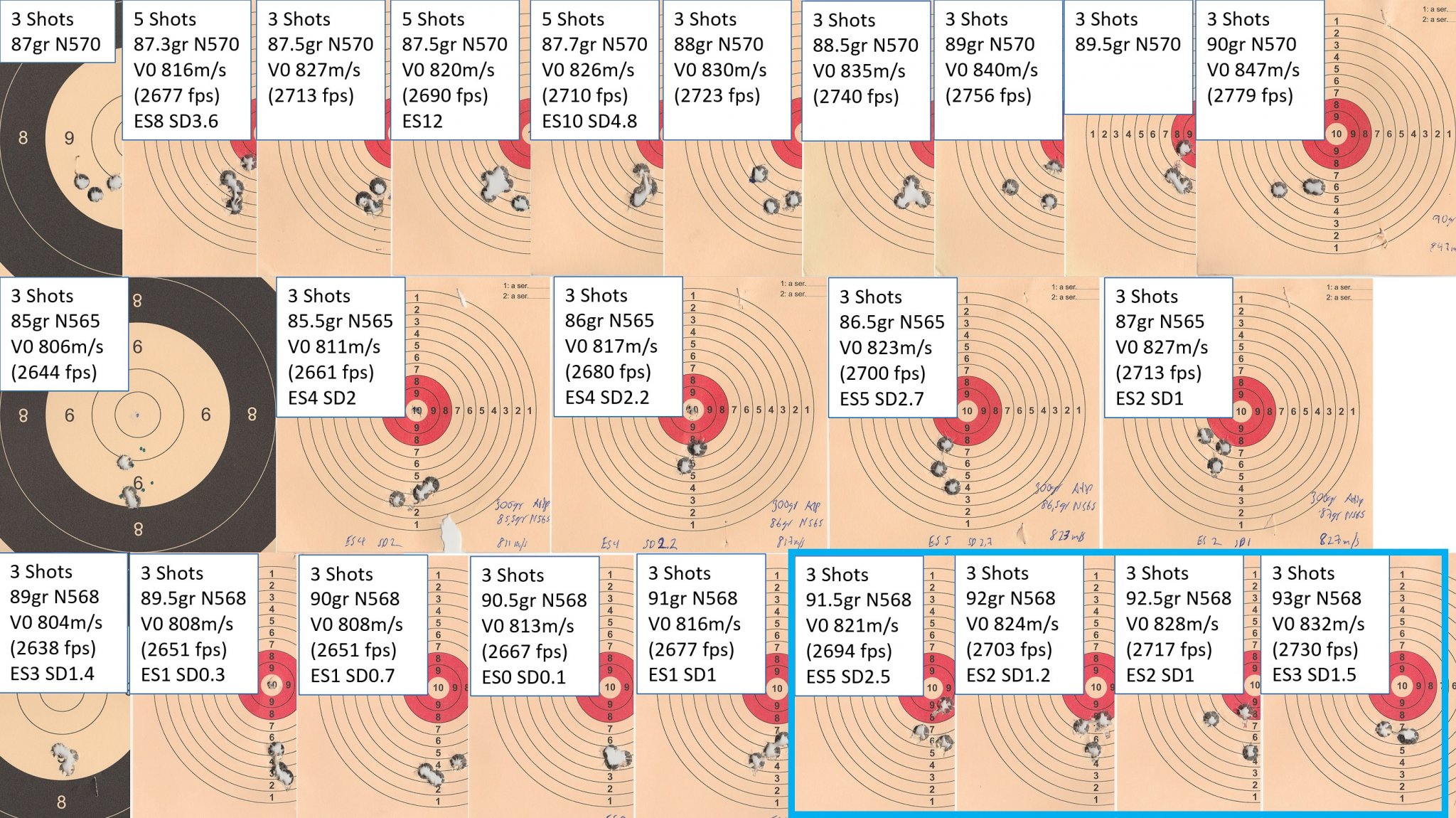

I did some tests with vihtavuoris N565, N568 and N570 powders.
DISCLAMER: These loads are up to Vihtavuoris published max loads for a different 300gr bullet. Start low and work up.
My coal is 3.845 inch (single feed) 0.025 jump , Hornadys coal says 3.681 Inch.
Loaded in Lapua brass with CCI magnum primers.
Rifle is a Sako TRG42 in 338 Lapua with 690mm (27inch) barrel 1:10
velocities are measured with a Labradar and the range is 100m.
Second disclaimer, im not the worlds best shooter so dont takes these groups too seriously of what this bullet can do :giggle:
Also i know 3 shot groups arnt great statistically but i feel you can still see some patterns (5 shot groups in 338 is expensive...).
Starting with the N570. Firstly the 3shot grps and 5 shot grps where shot at different days. One sunny and one cloudy so i guess thats why there is a 7m/s deferens on the same load. Also the powder was 10 years old when bought, which is vihtavouris stated max shelf life. So that might explain the horrible ES , btw thats in m/s not fps! ( take it x3 for fps). So im going to have to test this more with a newer powder. But getting N570 is like finding a unicorn..
But still i thought the grps were really good and velocities high, no pressure signs. will try more at 87,6gr ~823m/s but i guess the bad ES will open up the grps at longer ranges.
Next N565. These were all shot at the same day. powder was 2 years old. Better ES than N570 but not great ( remember its in m/s).
No pressure signs. Going to try going abit higher on charge to see if it tightens up.
Lastly N568. I was hesitant to buy this as ive read that N570 is velocity KING. But as N570 is a ghost i thought ill try it.
Got very surprised over the ES and SD. ES of 1 and even 0 makes me believe this is a very even burning powder. was made this year.
To clarify, all brass are from the same lot and sized and worked in the same way. So the different ES should only be the powders.
interesting that 89.5gr and 90gr had the same velocity (808m/s) and shot quite well. Have to check that some more.
Sadly its the slowest powder of them all and i really would like to get up to around 830m/s on this bullet. Had no pressure signs so i think ill try going up in charge a little.
Hope this information was helpful for someone !
Wow, great work sir. That 90.5 load of 568 definitely deserves a second confirmation test, incredible precision and es!
btw your english and grammar is fantastic, i’ve seen worse on here from native english speakers 🤣

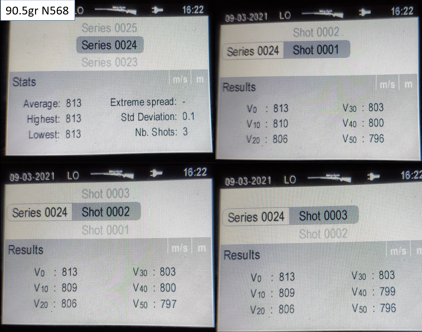

If you aren't the world's best shooter, then you are definitely the world's best reloader. Those ES numbers across all loads are incredible. Would love to hear your process.
I'll 2nd that request. Even if the numbers are in m/s some of those are hard to believe.
But thanks for the work and posting the numbers.
Would be curious for more results in n568 too! In my Lapua it’s just a play/ELr rifle and load consistency is what I’m after! Would be open to trying this powder if you have good results.
Haha thanks for the praise :giggle:
But do remember that ES and SD is in m/s so you have to 3x it to get fps.
Still 3fps in general for the N568 is impressive for the powder. And a 0 ES is fantastic ( though just on a 3 shots sample)
A downside of both N570 and N568 is that they are really dirty. Looks like a wet beaver have crawled into the barrel and died :LOL:
N565 is very clean compared.
Had to dubbel check if it had recorded all shots, but looks like it tracked em all.

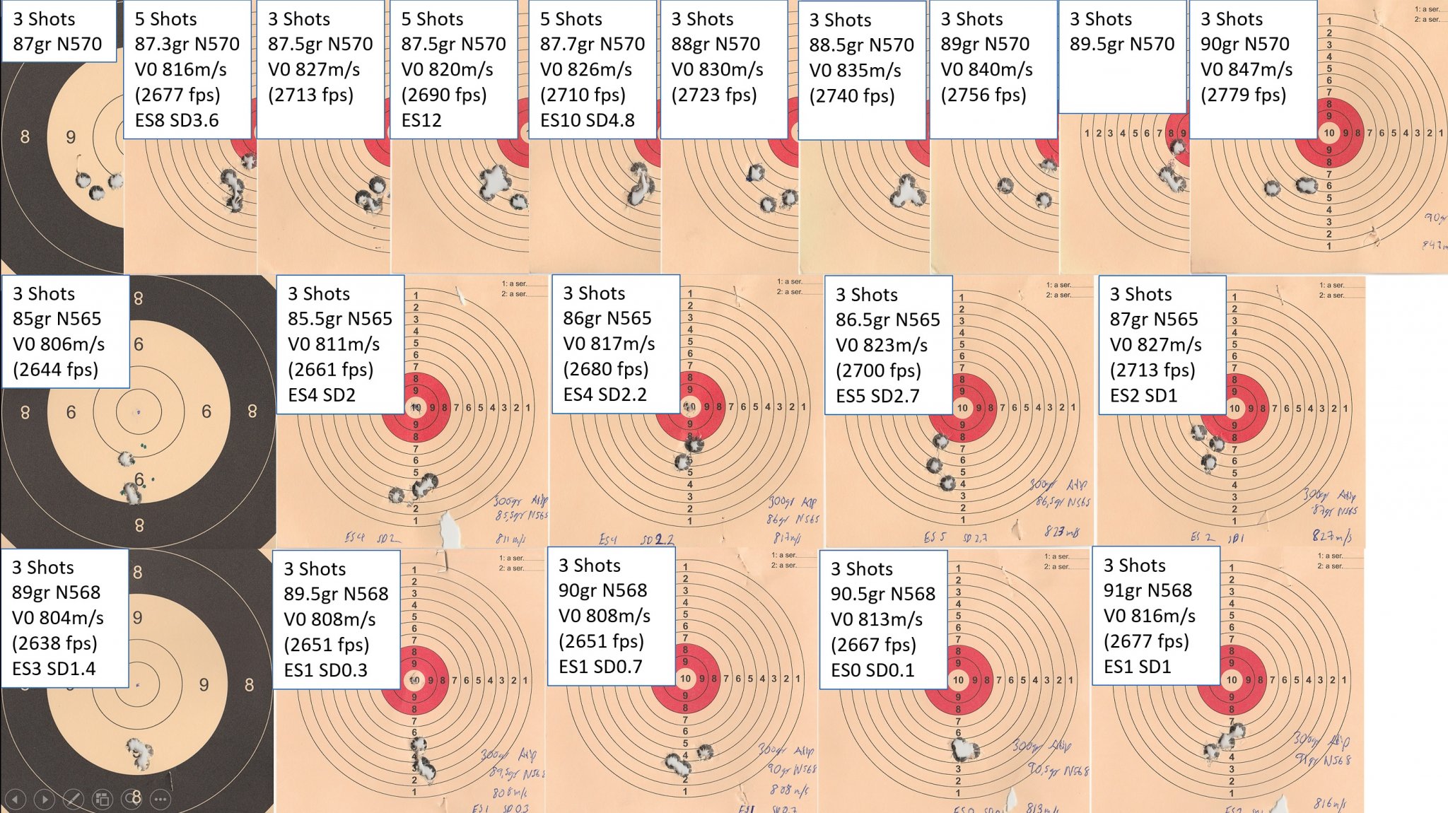

went out again today to try some higher charges of the N568. The ones in the blue box.
These are getting over max load by vithavouri and case are starting to be full to little compressed with my 3.845 coal.
Sadly it seem i left the node behind so kinda waste of bullets.. :confused:
Started to think my scope had came loose until last series.
Last one.. Oh NO! Seems i need to do one more step to see whats at the end of the rainbow.. :ROFLMAO:
Didnt have any ejector marks or flat primers but might have a heavier bolt lift so guess im at max for my rifle.
ES are still quite good, the cold bore shot messed up the first one jumping to 823m/s.
N568 seems very even burning. Like 4 m/s per 0.5gr over the board.

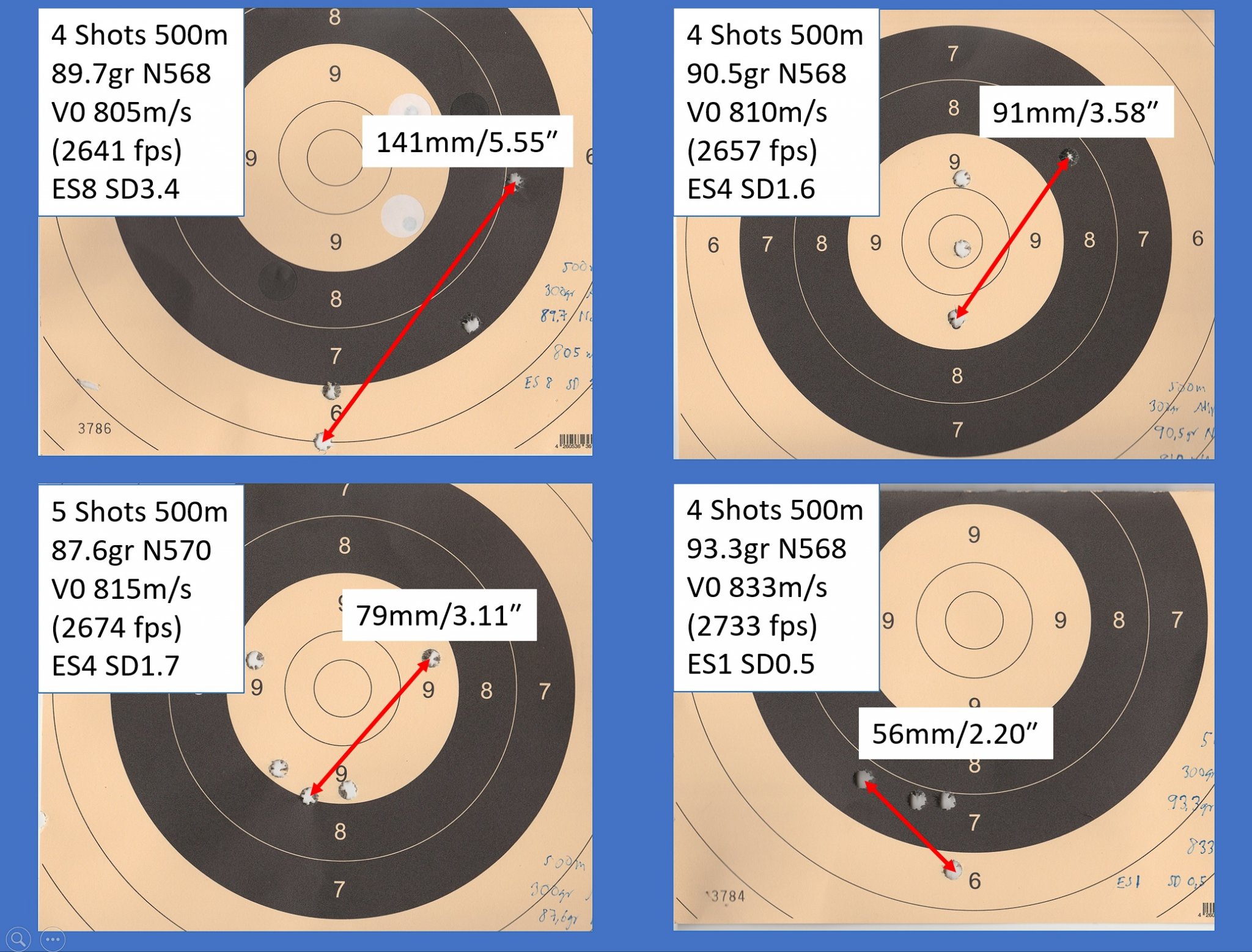

Went out and shot my last of 300gr Atips today at 500m.
Choose the most promising loads from before.
Reason grps are all over the place is that i just SWAGed the elevation.
Shooter error sure is a factor at 500m..
First series (89.7gr N568) had one real flyer.
Not sure if that was all me, had one shot at 800m/s ruining the ES.
The real surprise was the last grp (93.3gr N568).
Guess i need to validate the consistency of this when i get more bullets.
just hope it doesnt ruin my brass... is a kinda hot load. ( over vithavouris max load)

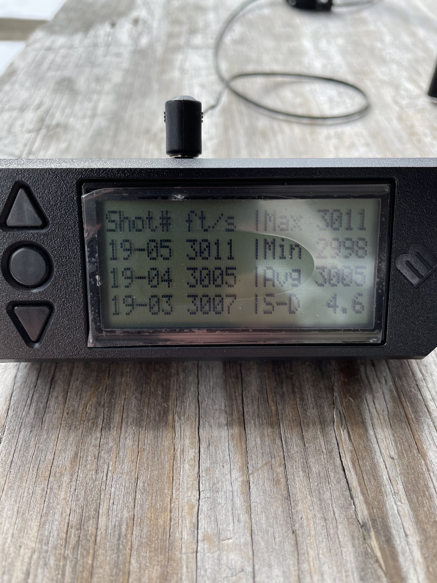

If this helps anyone... I'm running 300atips at 3209fps average (30" 1:9.3T) with about a 3.5sd average over about 10 different 5 round strings. The atips have not been picky to seating depth between 0.002" off to 0.020" off. I'm not a great shooter at 100y, honestly I'm better at grouping at distance than 100y and I shoot a ragged hole at 100y. The atips simply go where you point them. I use to be hesitant to shoot them because 300gr bergers were so much less expensive, but now that 300gr bergers are running over 100 per box, atips are the go to. They freaking explode on targets and leave a giant mark. So much easier to see than solids. I'll try to attach recent pictures of the 1425y target before and after my first shot with the 33xc on it. It squared it up dead center, and even with the heavy mirage that we were experiencing, the atip was easy to see where it hit.

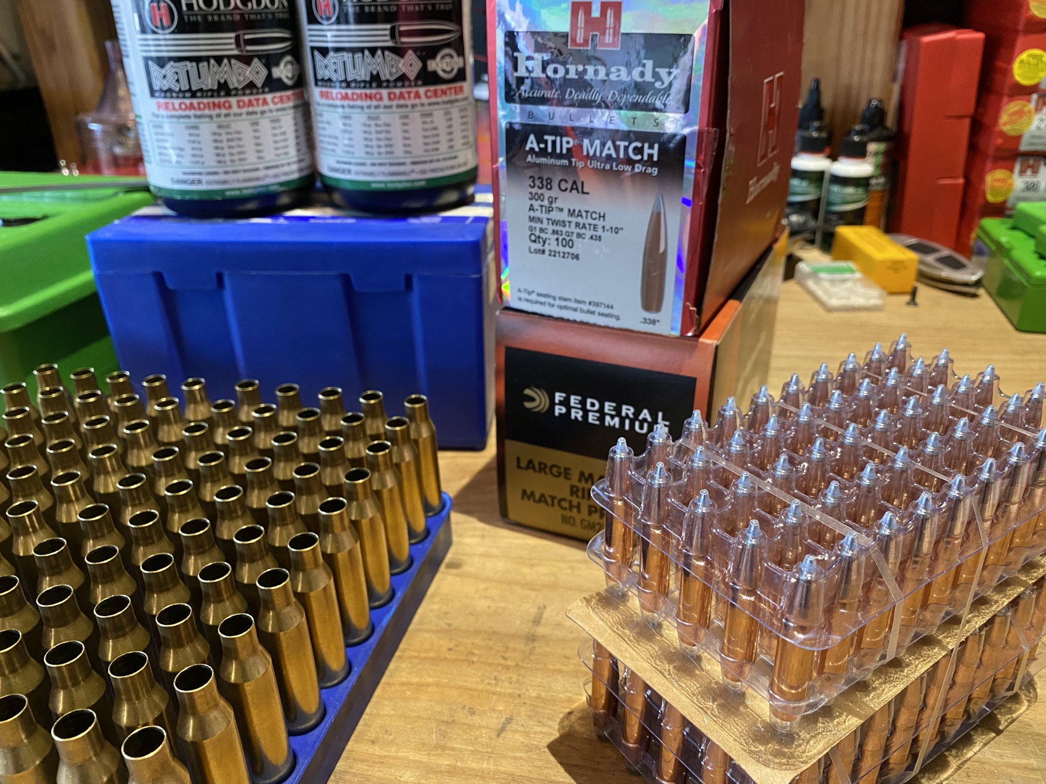

Anyone given this a shot with Retumbo? Ive got about 10 lbs laying around and would really like to find a good load for this projectile? Would starting around my load for 300OTMs be a good place to start?
Half the battle is getting bullets. I'm running low on .30cal 245gr bergers and can't find any more. I ordered up a bunch of 250gr A-tips. I was curious about them so I loaded 5 with the same powder charge and BTO measurement as the 245 Bergers I am shooting. They shot 3/8" at 100 yards.
I'm waiting for some warmer weather to do some more testing and actual load development but they look to be really promising.

Starting a ladder work up today. Will test this afternoon. Im just hoping for reliability. The 300 bergers are a Bi#%!% to find these days. So a reliable, similar bc, and affordable option is what I’m hoping for.
Running em in a custom GAP 338LM w/ a 28” Bartlein barrel with 1-9.5”
Reactions: BCX
Sounds like a .338SnipeTac
I take that back, 100gr of Retumbo sounds like a .338LM Improved, but I only get those velocities with a 36" barrel. I have no idea how you do that with a 27".
Reactions: TopTeerPrecision
