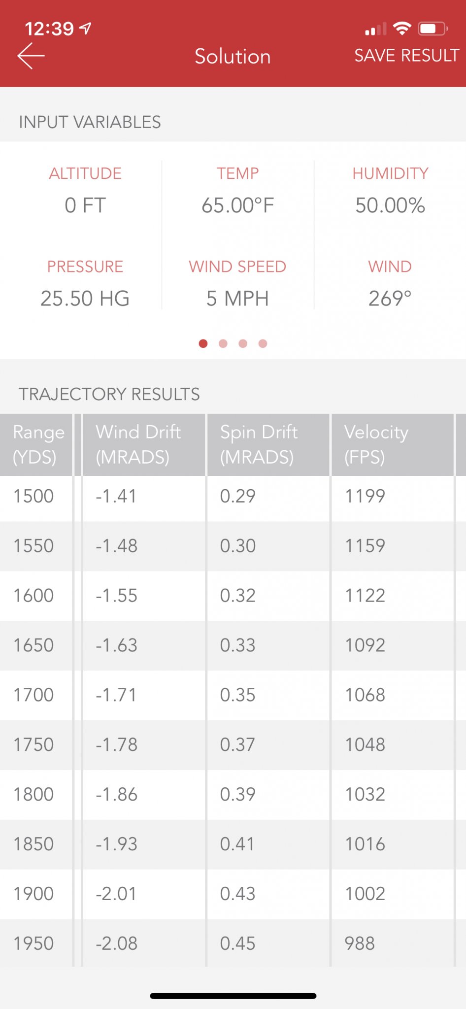

Here is my 260GT Barrel, 7.75 Twist Rate, (It's actually a 8.25 - 7.75 you only input 7.775) with a MV of 2850fps with a 136gr Scenar
I have my current conditions in there, and read it, then add this same information
7086047
You have 1 MOA or .3 Mils of SD at 1550 yards, so do you think I even need to worry aobut, hence the lack of discussion in this area with the Hornady App.
If you compare it, other apps will be much larger by comparison so we say to turn it off. If you listened to the podcast I said the other Apps were giving the user .6 to .8 at these same distances, and I said the right answer for me was .3 mils at the distances discussed.
You can easily see why I said turn it off. especially when it put me on the wrong side of the wind call.
