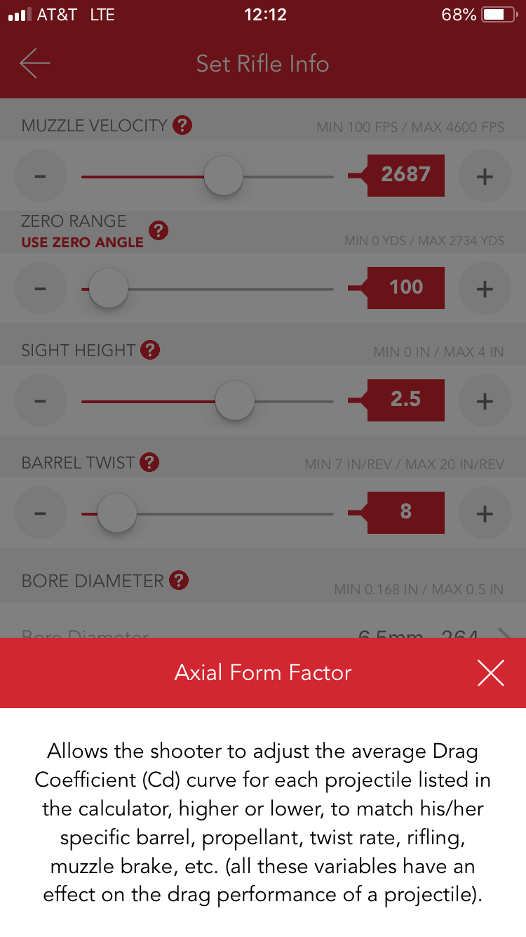

Just started reading this thread so maybe it's been covered. Where does the axial form factor come in while truing data? MV is for 500 and in, BC is 800+. I don't fully understand what the form factor is either. Maybe I have a thick skull but I've watched the video and it didn't make a whole lot of sense.
In a nutshell, the 4 DOF doesn’t use BC. It uses form factor to determine the drag coefficient of the projectile.
Reactions: Jackomason

Has anyone messed with the axial form factor to get the data to more closely match your actual dope?
Yes. Once I was sure about my velocity I tweaked the ff for the 105 bthp to make it line up. The Hornady app is more accurate than ballistic ae in my experience. Dead on to 1000. Not bad at all for a free app using 20 cent bullets.
Reactions: JC0352
Yep- I had to with a 140 eld bullet out of a button barreled 6.5 CM.. Had to bring her up to 1.08 and everything lined up afterward. but all other projectiles and even that 140 bullet in other guns had been spot on for me. So I chalked it up to something with the bore itself.
Reactions: JC0352
I found that at 500 I had to true the MV to get hits then tweak the axial form factor.
