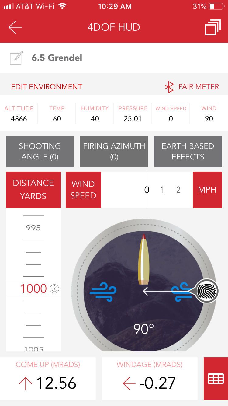

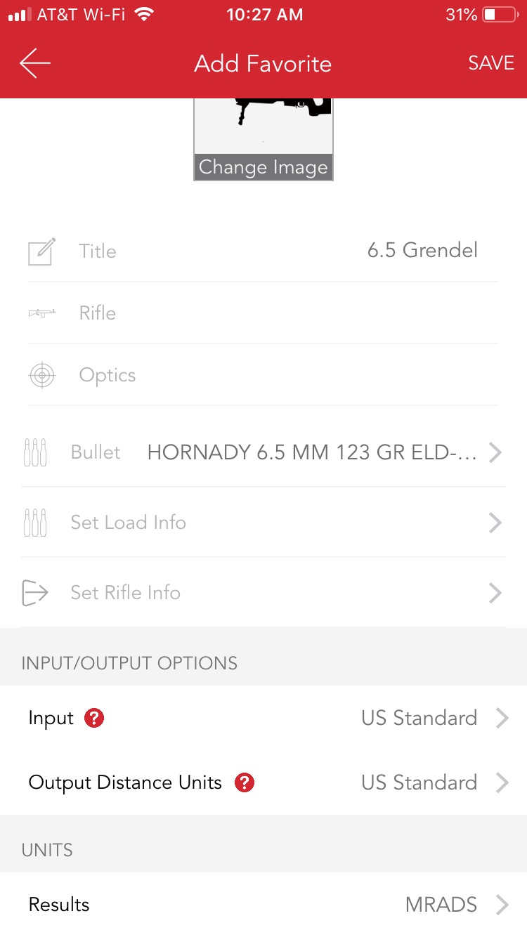

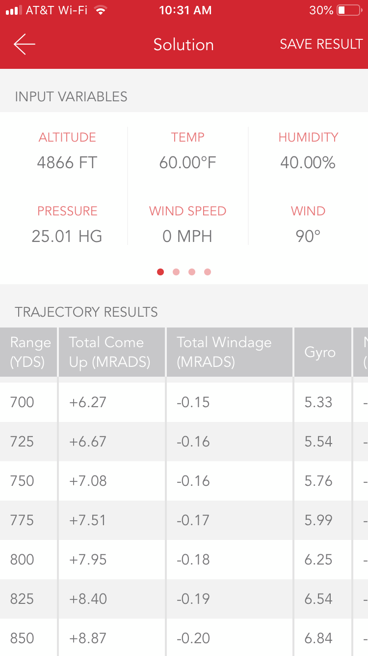

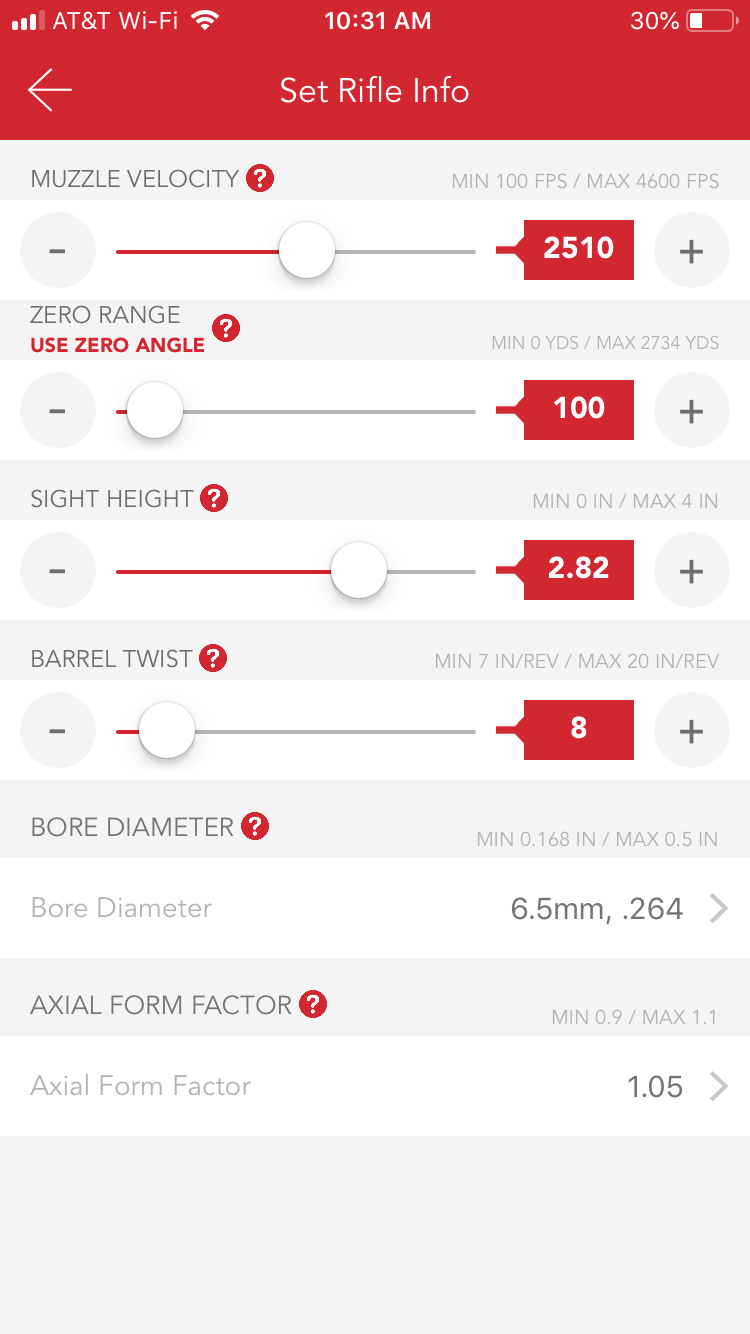

I would start at the very beginning and go thru the app step by step. I entered your data for the 6.5 Grendel and it came out to 7.1 mils at 750 yards (which is what I understand you are trying to get to). I've attached screen shots in hopes it will be helpful. The 4DOF doesn't have a method to address the error in your turrets so you will have to play with the muzzle velocity and form factor (or BC in the regular 3DOF version) to try to adjust the numbers until they line up with your real world data. You show .1028 mils per click so your actual drop should be more than you are dialing (lets just round to 3%) So if you are needing 7.1 your turrets are actually moving 7.3 mils. It sounds like your BC and MV both need to be backed down. What is your actual drop from 100 yards to 750 yards?
