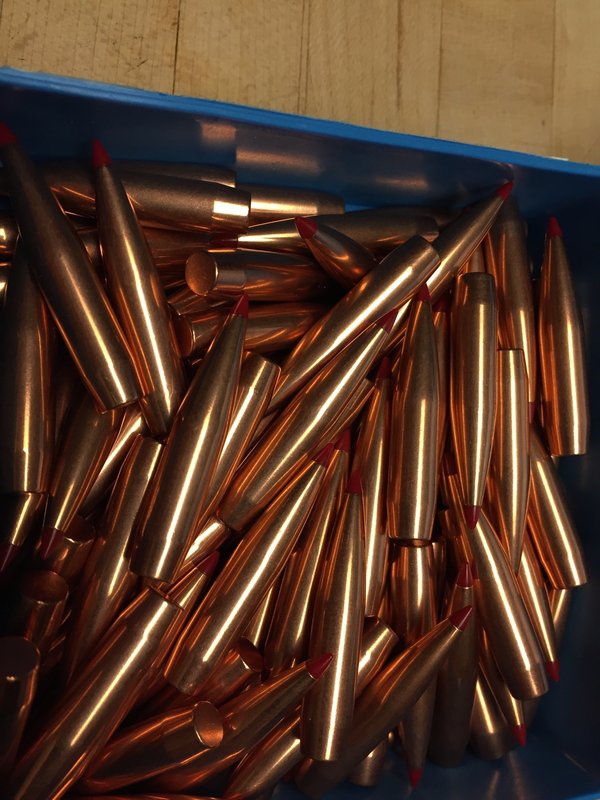

Does anyone know if these are out yet? Midway has blems that look like they might be close, not sure who else makes a 180 grain with red plastic tips, maybe they're pre-production runs that they ran while setting up the tooling... I'm not sure? I'm pretty anxious to see how these shoot, the BC they're advertising is crazy, it will be fun to see how they stack up against the bergers.

Tracking this as well and curious how they compare to the pre-release "factory seconds" Midway has available:
https://www.midwayusa.com/product/46...-bulk-packaged
I tested the Midway version out to 800 and 1000 last weekend and BC is much lower than lowest advertised of 0.368 G7. I'm hoping the production version is completely different.
