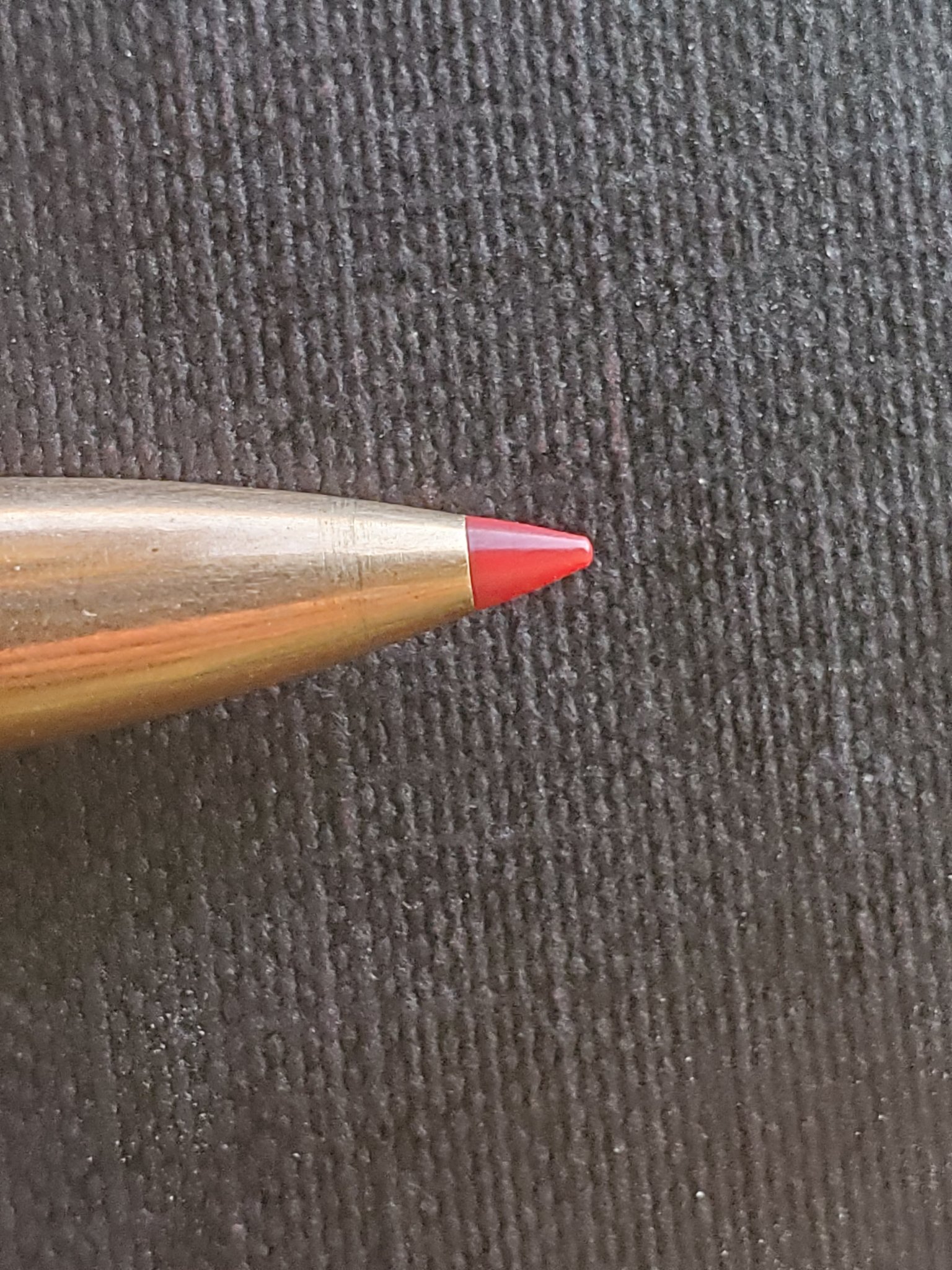

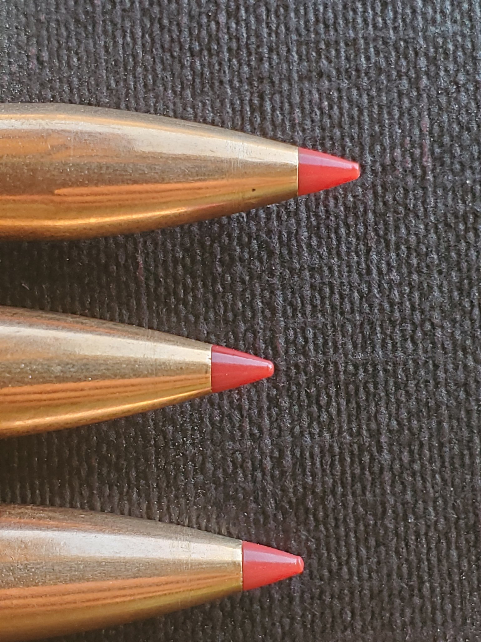

So I was loading my last batch of 308 and noticed a bunch of the tips on my 178 eld-ms were kinda weird, sorta smushed, and some off center. They still shot acceptably well Out to 870 yards. Just wondering if other people noticed the same thing? I guess I'm wondering what's the big deal with the "perfect" meplats if it doesnt seem to make a difference anyway? Having them kinda weird didn't negatively influence accuracy... maybe out in the trans sonic range? I dunno. What are your thoughts fellas?

Yea they were like that when new unloaded. But that is a good point about the stem. I'm at the range today so I'll take some of the unloaded ones at home. But as you can see the first 3 in that picture are kinda weird. And the single down there is another random one out of my box is totally fine. None are that bad. And it hasn't negatively effected accuracy as of yet... I sure have though lol... squeeze harley, just squeeze.

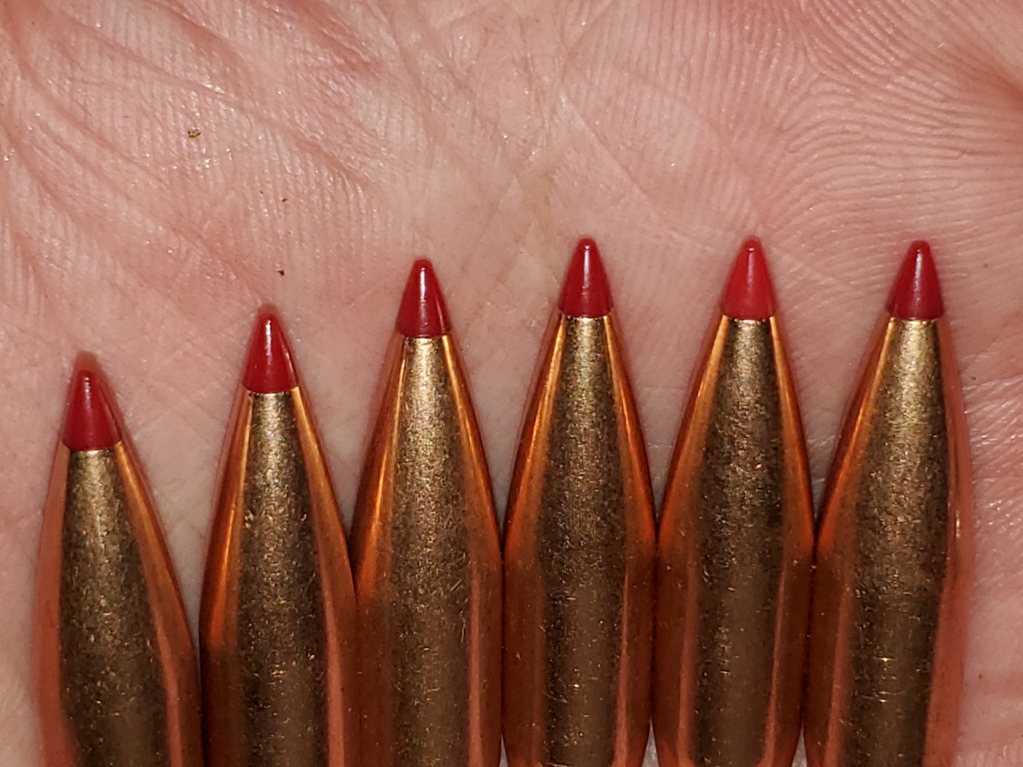

So this next pic is not yet loaded bullets. Again, it's not that bad, and didnt negatively affect accuracy, as far as I could tell. It's almost like just the veeeery tip is smushed over on some. You can see a slight ridge around the very tip. I dunno, I'm just knit picking

That is nothing at all to be concerned with. Standard HPBT bullets have much worse meplats and all shoot great. Shoot the rest and have fun.

Already shot em all yesterday, except for the couple I have extra at the bench, but only a couple. Not enough to do a whole batch. I had good results with them, so I'm not complaining. My question was mostly academic regarding what impact they would have at longer ranges. I only have access to 872 yards, unless I go an hour or so away, but I also dont have my own steel targets yet. And shooting paper at 1k+ would be a bitch.
That will have no effect at longer ranges. Have shot HPBT bullets with more messed up meplats to almost a mile and have shot the ELDs and AMAX before to around 1400 yards in matches and no issues. So if you find more for cheaper in the future then don't hesitate due to the tip.
