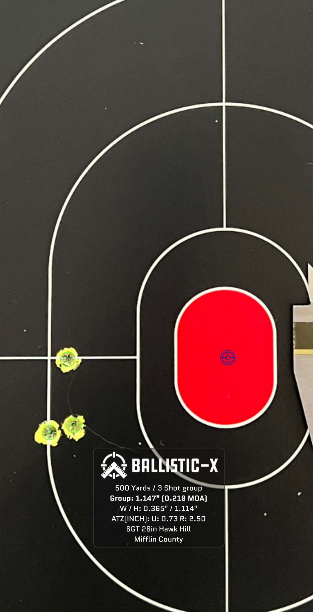

Ballistic-X-Export-2023-04-18 16:12:57.479493.jpg
0.8 moa 10-shot groups at 400 out of my Proof steel prefit. Chrono is ugly though, SD’s in the high 30’s and ES near 100. Makes decent groups though, so I’m continuing with it.
Update: latest lots are shooting 1-1.5 MOA groups @ 100 yards. I’m bailing and going to try 6C.
