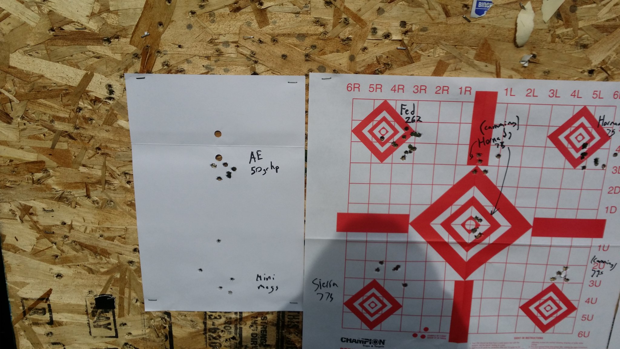

I shoot the 75 gr stuff alot, it's cheaper than Hornady Black, run the 75 great in my home defense AR. Keep in mind it's 5.56 so I'm not sure how it would do in a 223 bolt gun. I started reloading and haven't shot much of it since. I do keep it stock piled. I would recommend running some of the Hornady Black as well as the Frontier to see how each perform. The black is 223 with the 2nd version of Hornadys 75 gr bthp, the Frontier has what's called the T2 75gr bthp which is also used in the TAP stuff. Different ogive profiles. What are the specs of the rifle your looking to shoot? The frontier is consistently 1.5 moa out of my 18" SPR and my 16" with a Ballistic Advantage Premium series SPR profile
It's consistently 1.2-1.5 MOA so at least it's consistent. I've laid down and wailed on a IPSC at 700 with my SPR with the frontier. Just not sure the accuracy is tight enough for serious competition.
