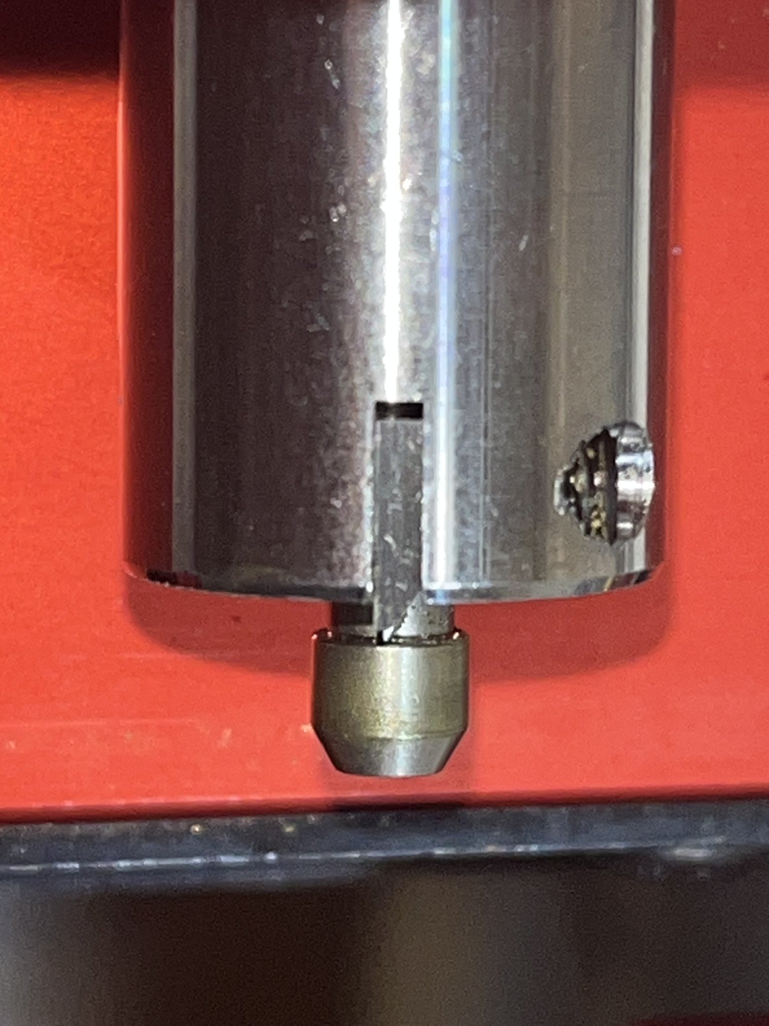

Yep, no adjustment necessary. Just switch out pilots. I’m still having issues with my inside cutter blades not fully seating in the cutter housing. Hornady has been great to send me replacements but still having that issue. One would assume the issue would be the cutter housing slot but both my outside cutter blades drop in on both sides the way they should. Think I’m just gonna work the thicker blades on some 80/220 grit sandpaper take off .001 and should drop in fine. Anyone else experienced this issue?
Yes it comes with pilots, originally just .22, .24, .26, .30. Hornady is also providing .2, .25, .28, .338 either in the newer boxes or on request.

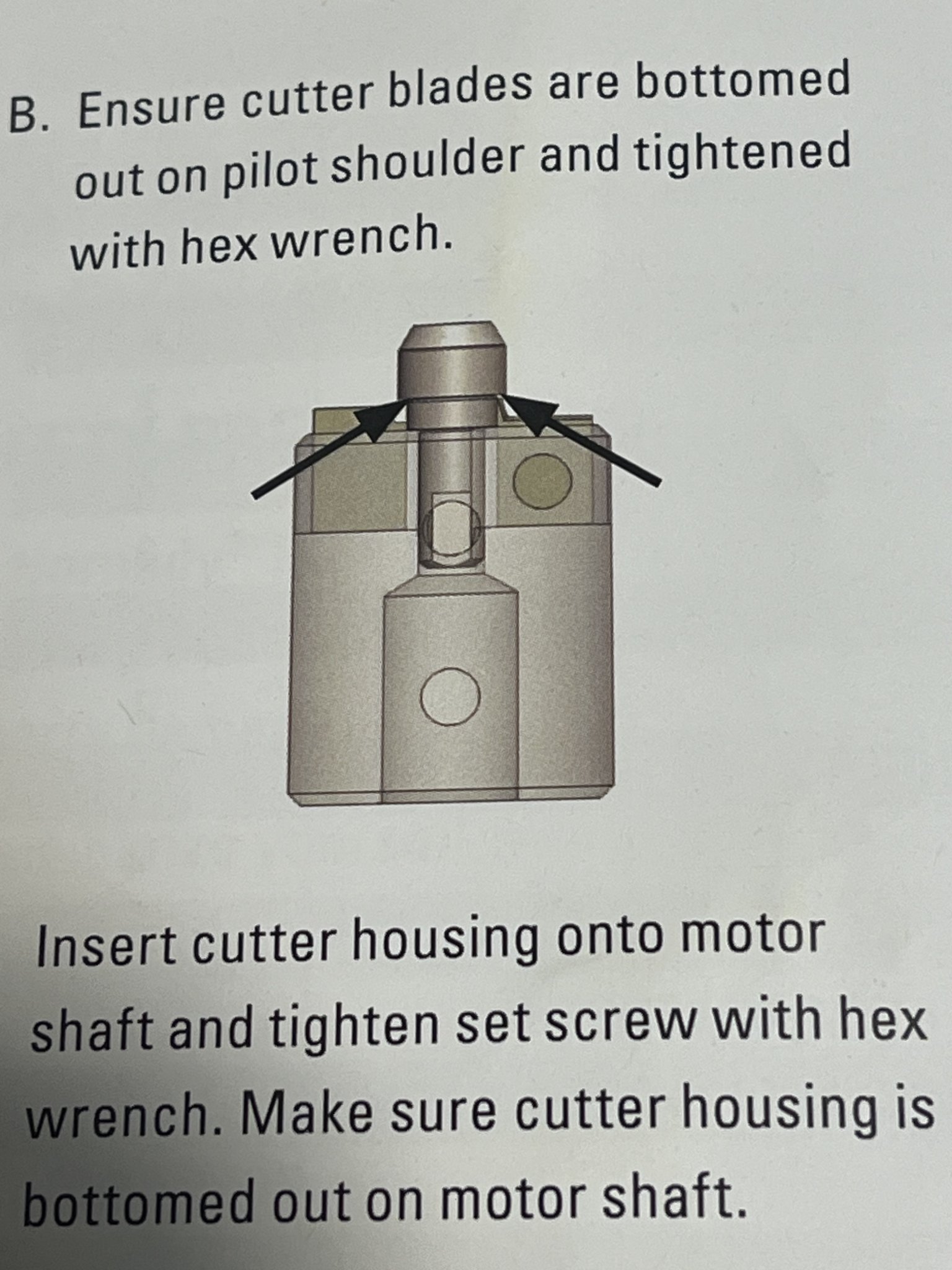

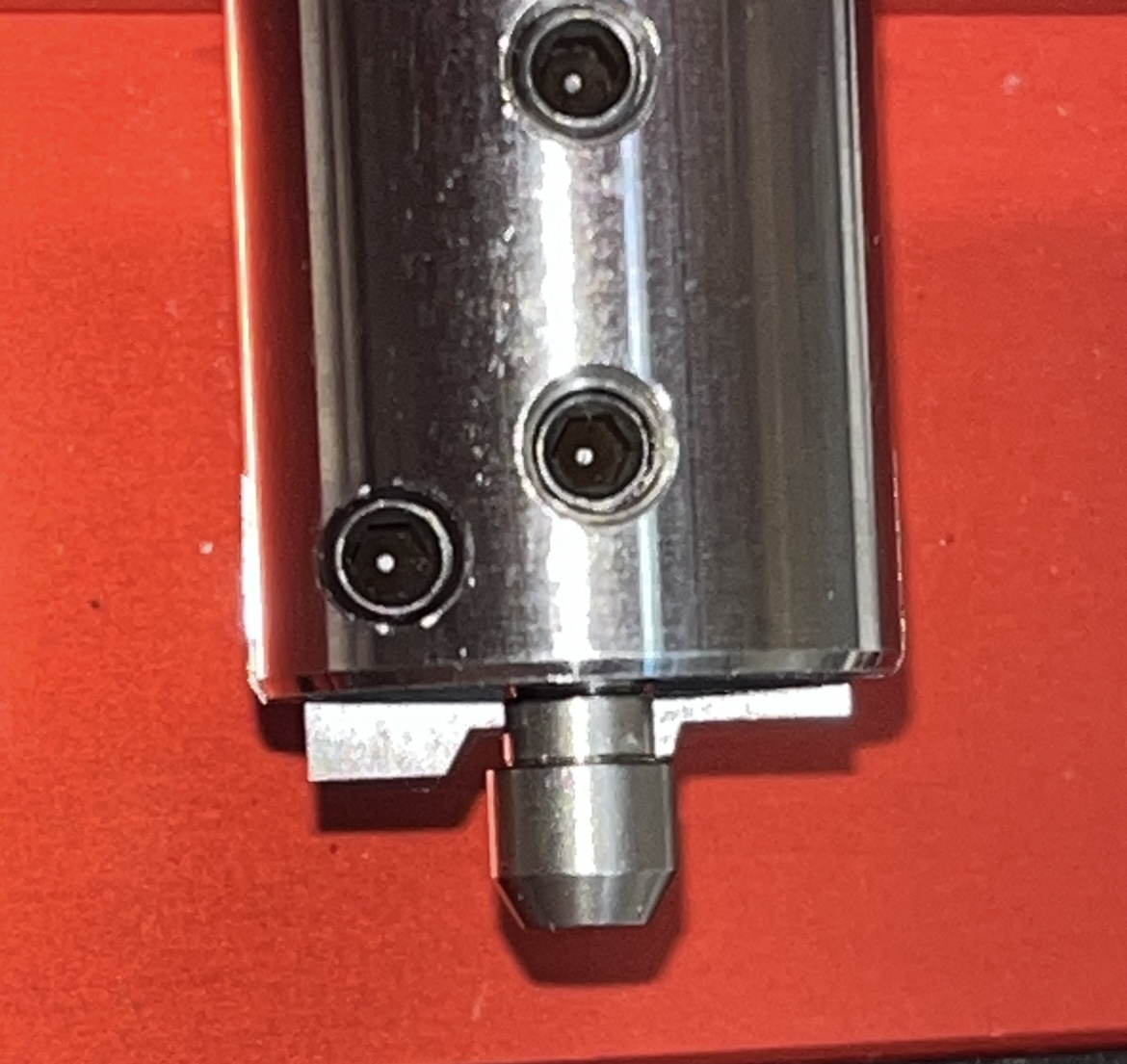

I also had the issue of blades not sitting up to pilot had to pull out the pilot a fraction of an inch to let cutter slip in under the pilot head.

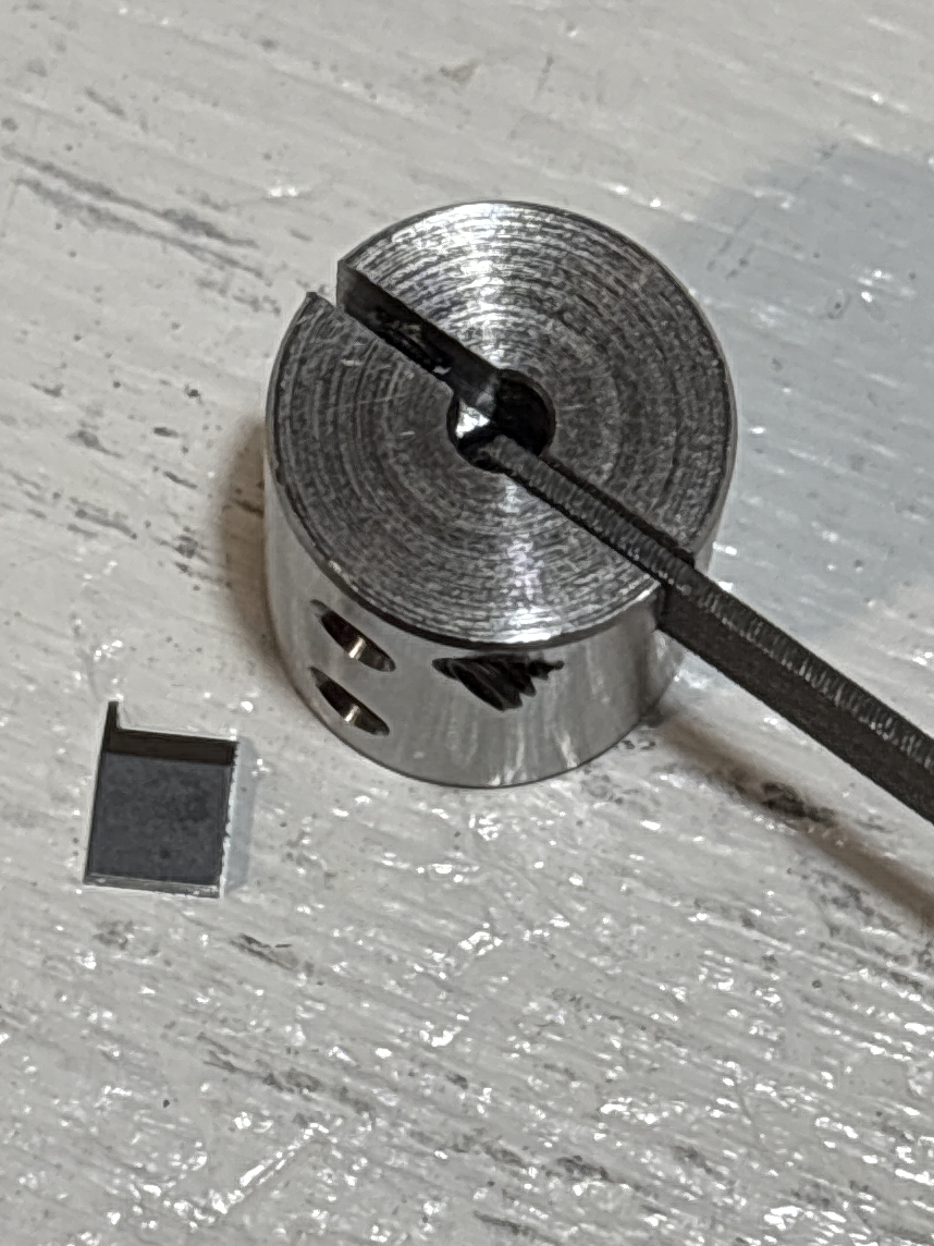

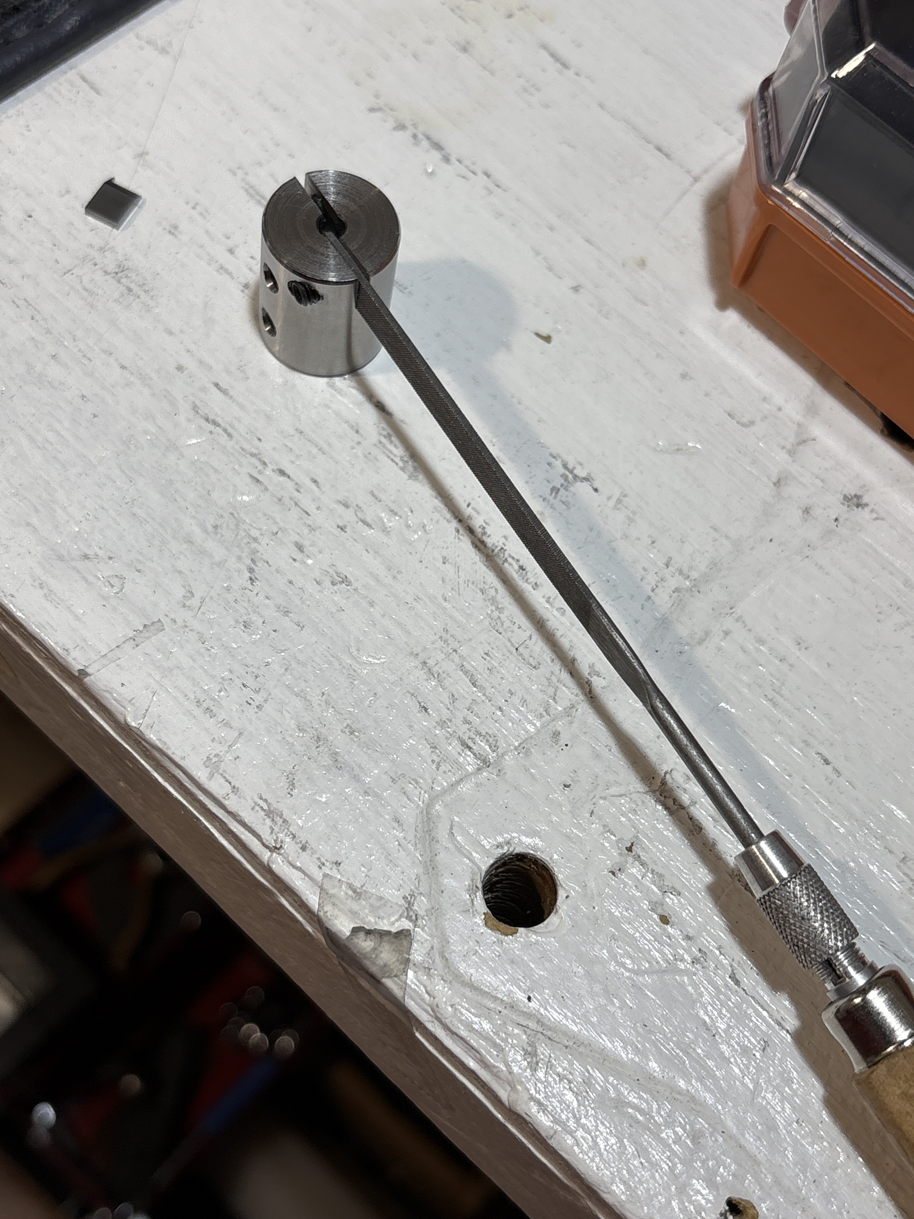

Hornady sent me a return label to send in my cutter housing and was ready to do so but I found a small flat file that fit perfectly in to the blade slots of the cutter housing and gently gave it a few passes then tried dropping the blade in. After the 3rd attempt the blades will sit correctly in the slot on both sides. Here’s a pic to correct that issue.

It took me a while to get the cutterheads setup to what I thought was acceptable. Pushing them all the way against the collet ended up deburring way more the outer case than I wanted. Significantly more than the Lyman tool.

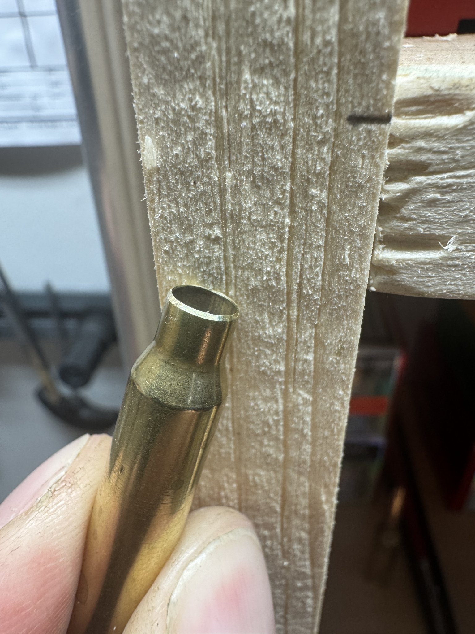

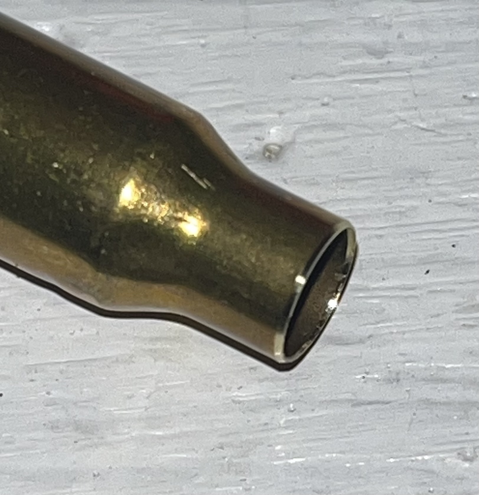

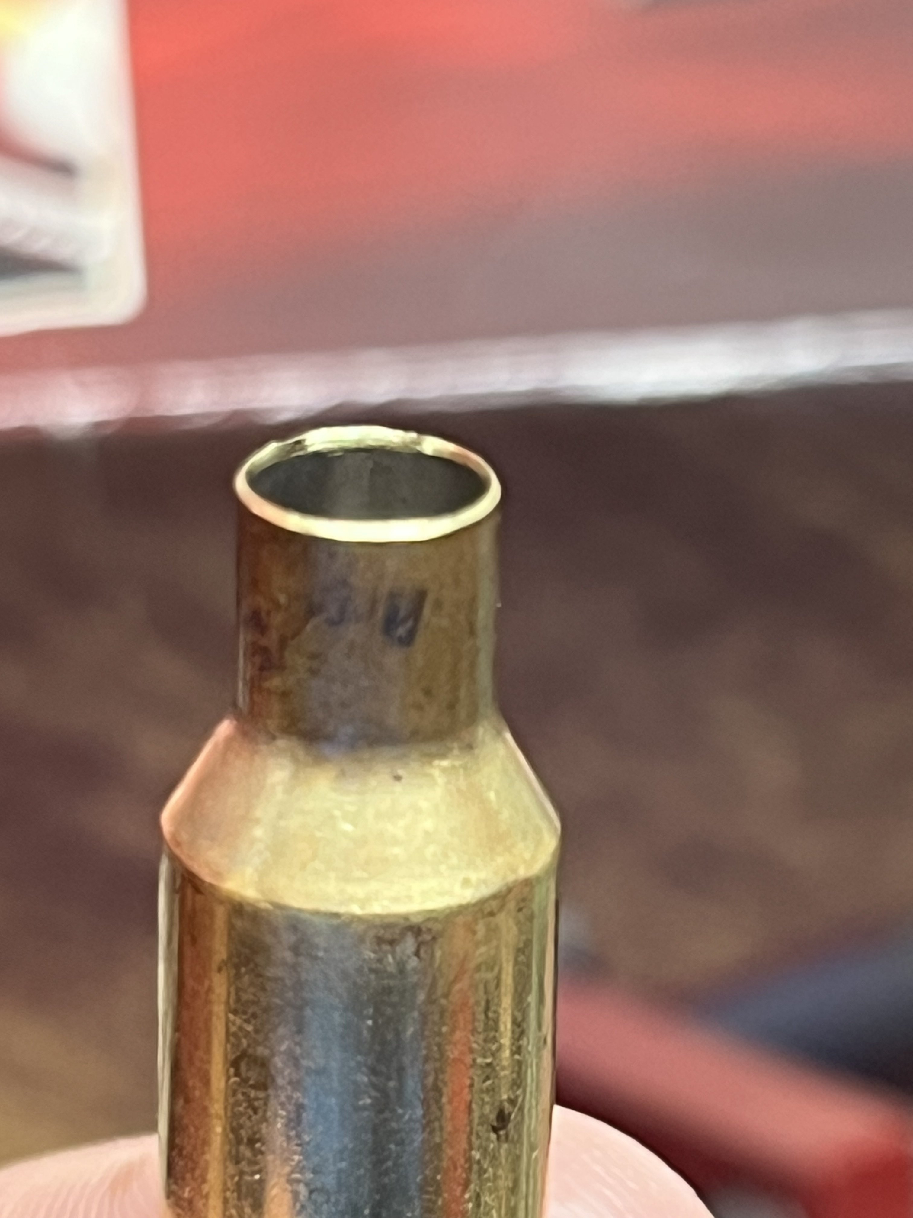

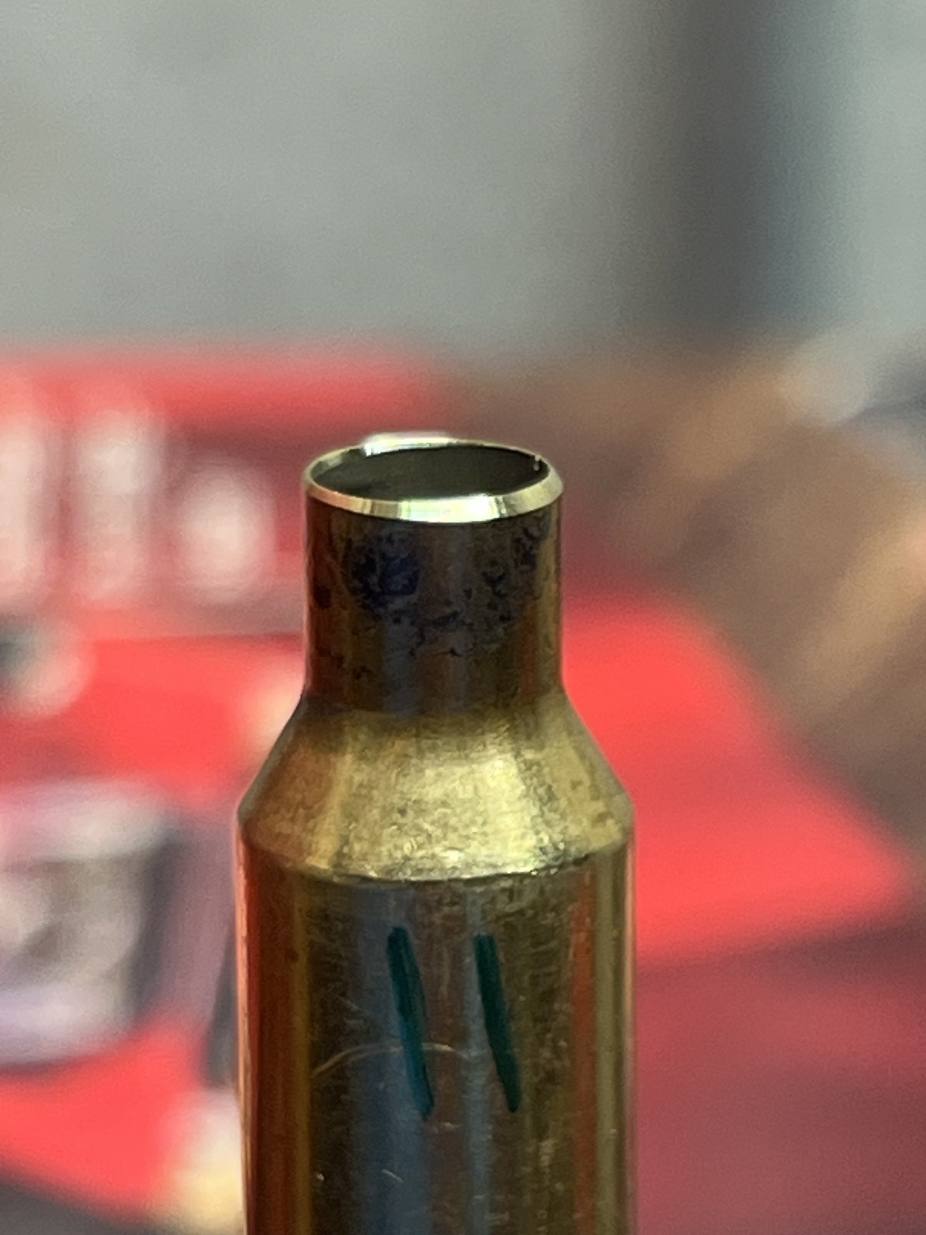

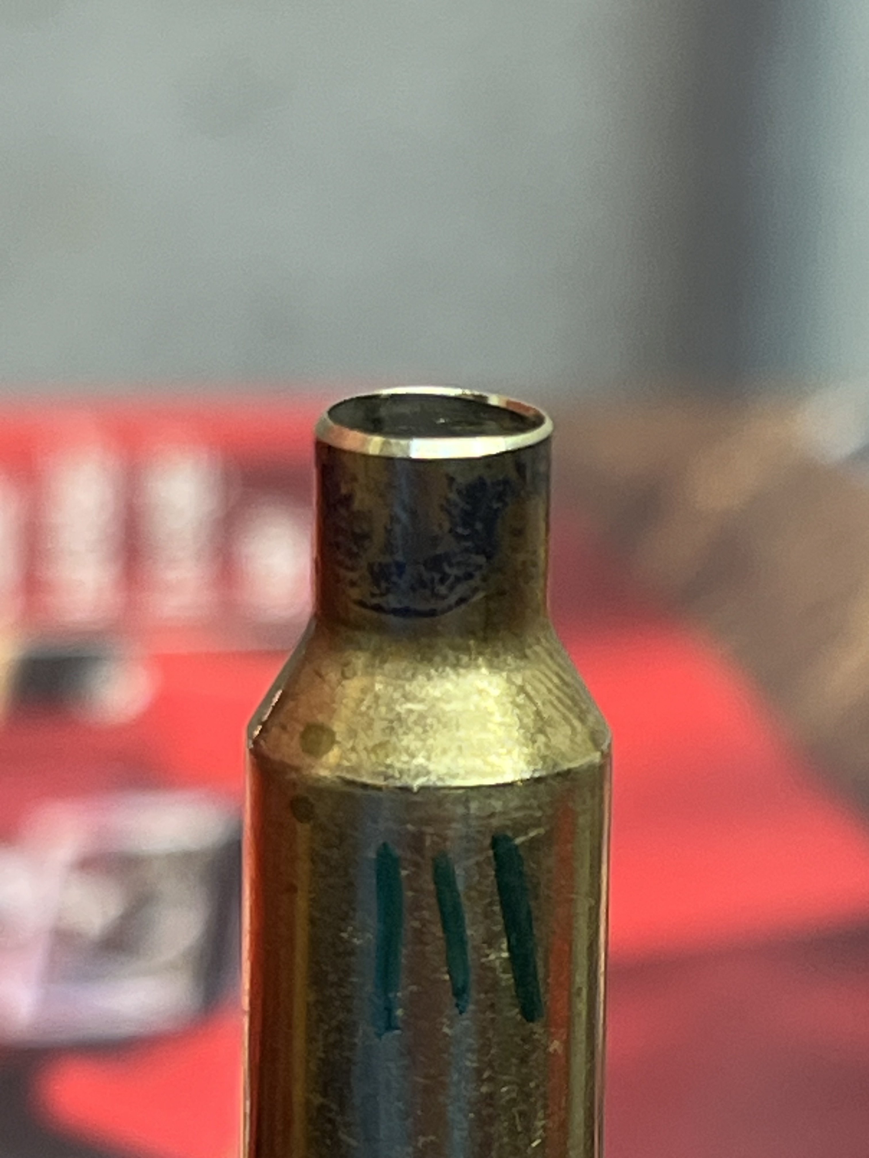

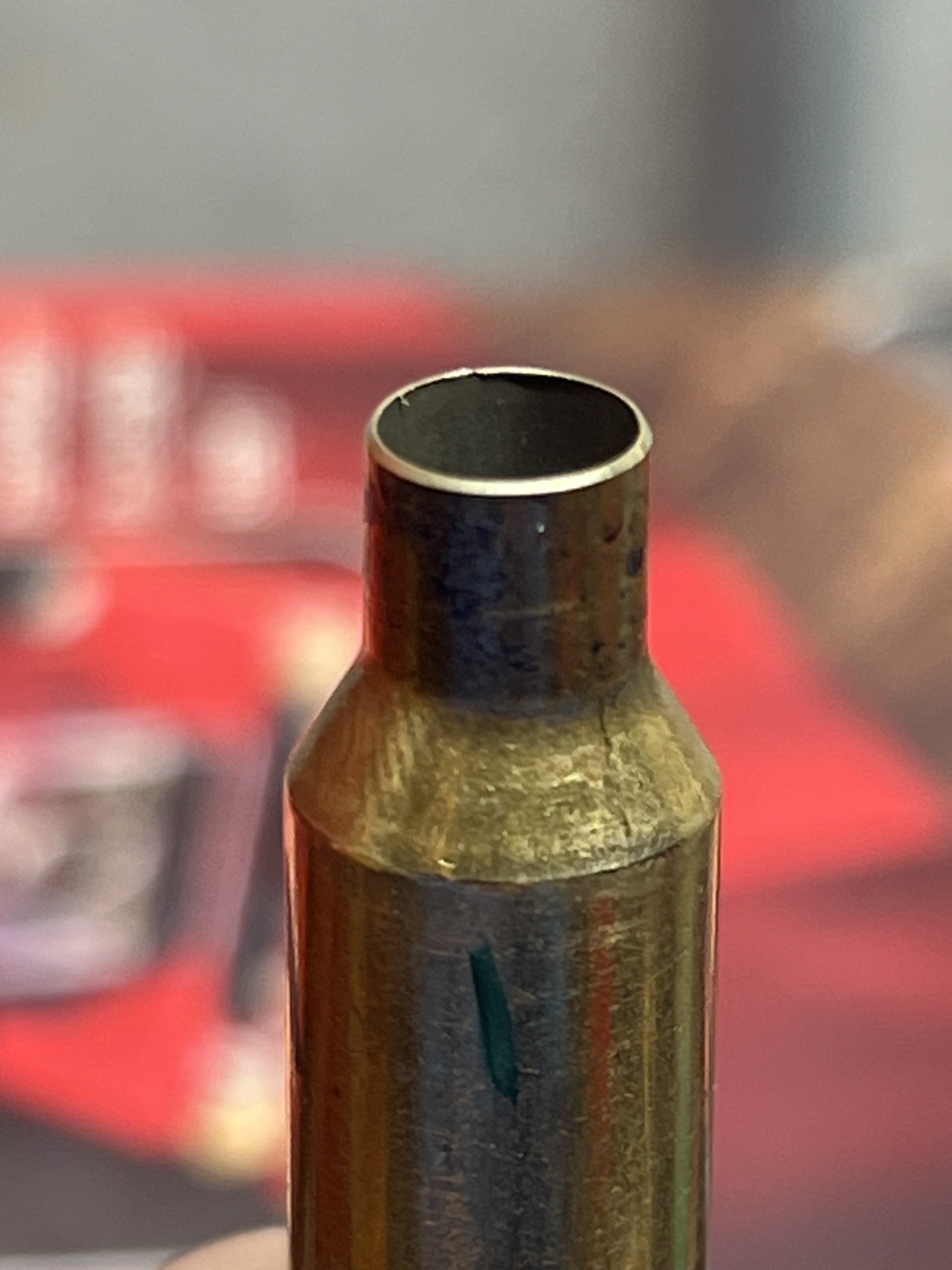

Here are some pictures to illustrate. The unmarked case is chamfered/deburred with the hand tool and looks great in person. The case with markings is a Hornady case that was run through the trimmer a single time while I was setting up the trimmer.
The image marked 1, you can see how the inside chamfer is basically non existent. Rotating to 2 & 3 you can see how the outside de burr isn’t consistent.

Here are some pictures to illustrate. The unmarked case is trimmed chamfered/deburred with the hand tool and looks great in person. The case with markings is a Hornady case that was run through the trimmer a single time while I was setting up the trimmer.
These looks like fired/ unsized cases. If that’s the case, there’s your problem.
I stand corrected here. I didn't realize using sized vs unsized cases would make a difference.
I'm still getting a little bit of deflection somewhere that's causing the inside chamfer to be slightly uneven on some cases, but I got significantly better results using Lapua cases that I had ready to load. Overall, I would say I am satisfied with the results and the chamfer/deburr look significantly better than the images above showed. Similar to what I'm getting with the Lyman hand tool.

The other thing that might improve things is to leave the collet loose until the neck is on the pilot. So hold the case in the collet, run it onto the pilot, tighten collet, then trim.

Another thing that can result in uneven chamfering or deburring would be the variation in neck wall thickness. Combine that with some other issues and. . . .???
