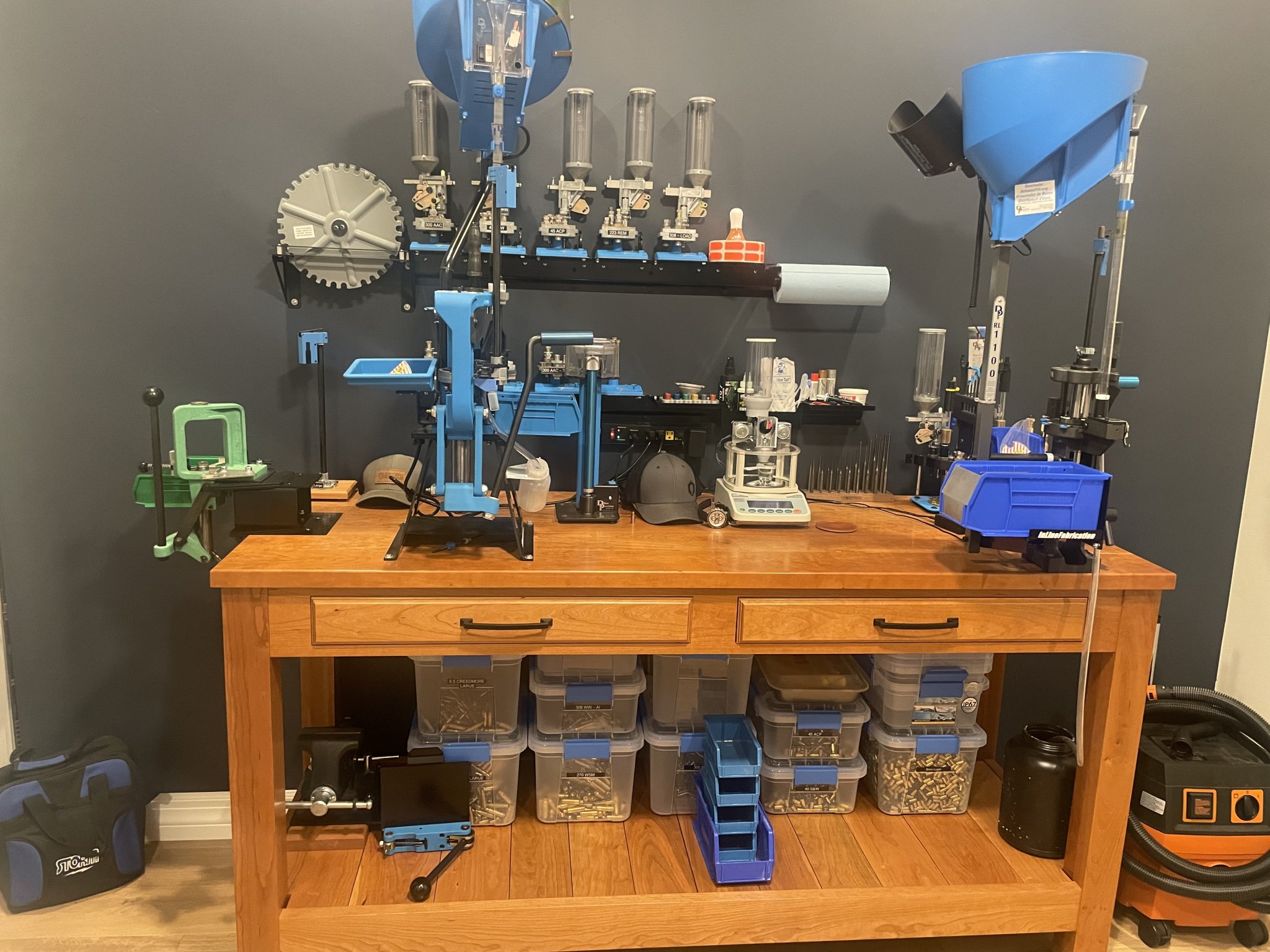

If you have the cash for automation, I’m a huge fan of Dillon as I have two automated 1050s with Ammobot’s and all the sensors

I have a 650 with case feeder and MBF and (2) 1050s with case feeders/MBF/Ammobot Autodrives..
Cranking out 10k in 5-6 hours of 9mm on an auto drive is easy.
I barely use my 650 anymore, as it doesn’t make a lot of sense, when you have to “WORK” to make 800-1000 rds/hr.
On a 1050/1100 auto drive, just watch it, keep it filled and enjoy (RF100 is required for primer filling)
If you have the cash for an auto drive, do it, you won’t regret it, and save the money on a 650/750 and just get a 550. Cheaper conversions and arguably better precision ammo
