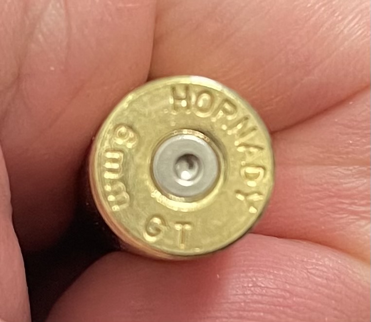

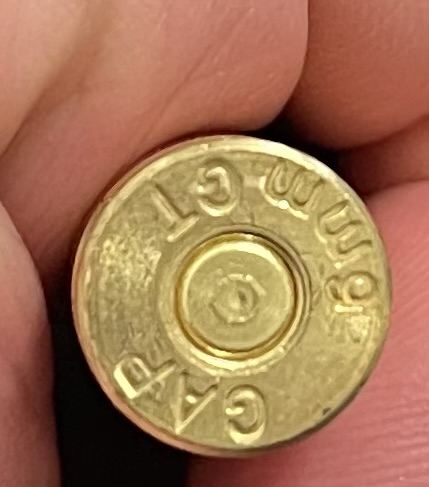

    Anyone know what BA after the Hornady UPC means? Assuming it’s GAP
    Had an interesting day shooting today.
    I’ve been breaking in my 6GT with factory H109 ammo.
    In the past was only getting about 2780fps from them.
    Was hoping the barrel would speed up quite a bit, but the rounds are stupid accurate.
    Fast forward to today. Grabbed a couple boxes from my stash and went shooting.
    Garmin immediately read 2960 for 20rnds
    Looked at the box and saw GA after the UPC#
    Compared old box to current box. Primers in the fast loads are gold/copper and barely have primer marks on them.
    Here’s some pics for reference.
    Any help to solve the mystery would help. Thanks Hide.

    You say no pressure signs and correct me if I’m wrong as my eyes may be playing tricks on me but is the GAP stuff, hold primers, not showing cratering and reformation around the firing pin or is my eyes deceiving me? That’s signs of pressure.
    You are correct. In 30+ yrs of shooting, I’ve never seen a primer have barely a mark on it.
    If that’s a sign of pressure, I wasn’t aware. I’m always learning.
    So if that is a sign of pressure, that means the GA marked boxes are loaded hot?

    Yes, I’d pull it just for Intel. 200fps jump in a relatively smallish cartridge like that, I’d be curious what the charge was even tho I think avg speeds for a 6GT is about 2800-3000fps. But to get a 200fps jump I’m sure the GAP stuff was loaded hotter. Hornady typically errrs on the side of caution from my experience.
