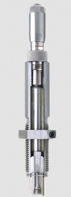

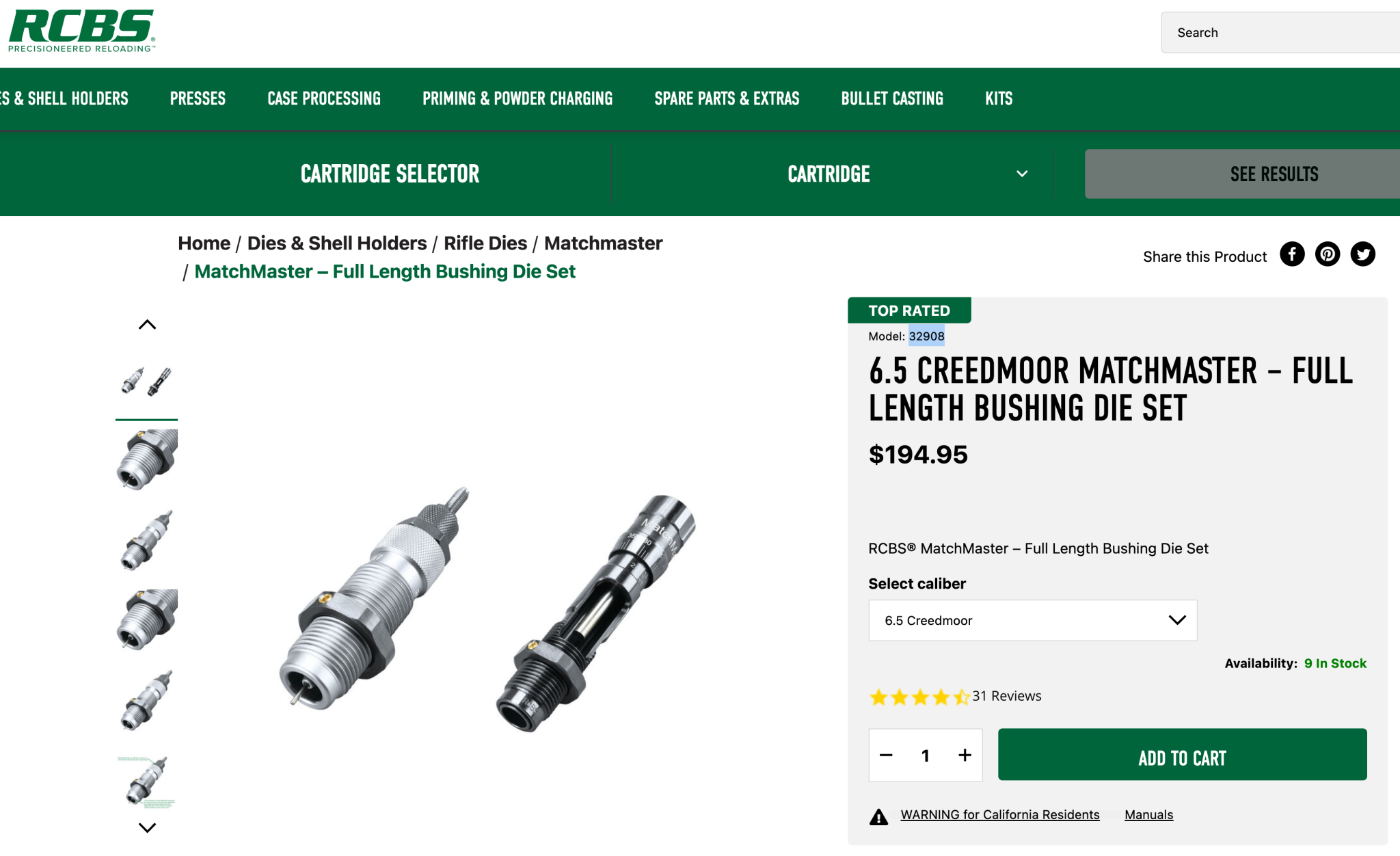

Does anyone have experience with either of these die sets (Hornady or RCBS), utilizing the micrometer bullet seating tool? I bought the Hornady set, though after opening it, I'm a little surprised that it doesn't look all that extravagant for the price. The RCBS feels like it has a bit better construction to it. I am considering returning it for the RCBS, but I initially hesitated on more RCBS products after we broke a couple RCBS dies for the .338 Lapua recently.
The Hornady ends up requiring the purchase of their full length die set (I think you can get either the Custom Grade or Match Grade), and then unscrewing the top of the bullet seating tool - and screwing on the new micrometer end. Either way, they seem to be about the same price in the end.
I just wondered if anyone has any impressions of each they could share.
Thanks!

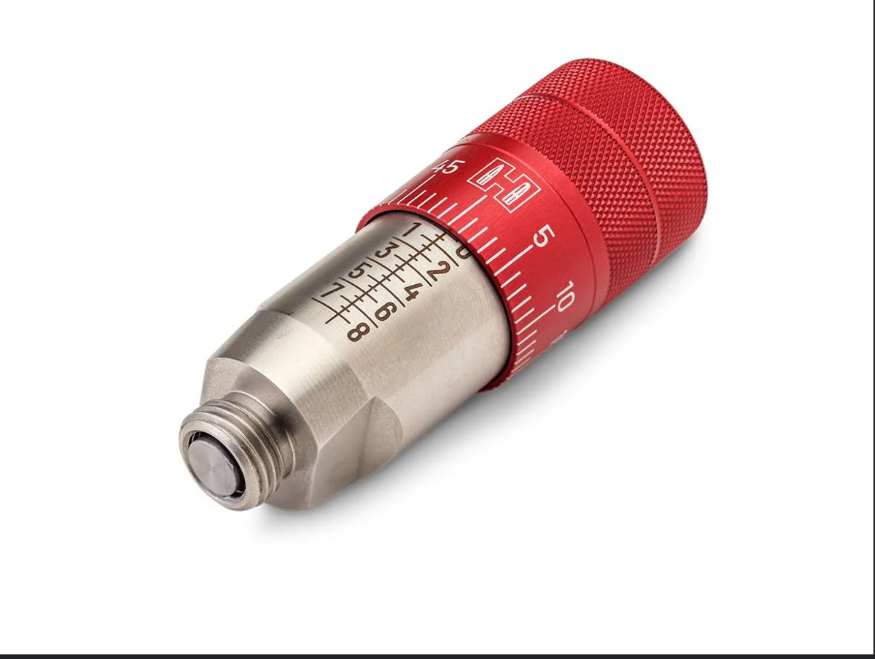

What Hornady set did you get? They sell one with a micrometer seater. The picture you posted is their new click adjustment seater addition.
I bought the basic one (Custom Grade) that doesn’t have that steel-colored micrometer tool included (that must be the Match Grade). The Custom Grade allows you to remove the head (no micrometer) and install this fancy red micrometer.
Yes that is the match grade set. If you wanted the micrometer you should have bought that but you can still replace it with either the one in the pic or the red click version you posted.
Yeah, I didn’t buy that one on purpose, because I could get the Custom Grade kit plus the fancy red-colored micrometer together, for the same price as that match set. But, having said that, the Match set has the adjustable neck bushings that I’d like to try too. I’m curious what the RCBS set is like. I’m wondering if the construction is better?
It’s not. I have had both of those sets and both load fine ammo but if you want a full length bushing die then return what you have and get one. You will also have to buy bushings with them. Measure a loaded pice of brass at the neck and subtract .002” and that should be the right bushing size but some like to try a little more neck tension so you can get one .003” smaller also.
I have three Hornady seater dies with that older micrometer on top. It does just fine for me, but my favorite micrometer seating dies are Forster, I like those better. I’ve never used the RCBS micrometer seater. As far as bushing dies go, I have Forster and Redding and both have worked well for me. After I bought my first Forster micrometer seater, I have not bought any more Hornadys. For what it’s worth, I do not like the Hornady resizing dies, the Forster and Redding dies turn out better ammo for me. The Hornady seaters with a micrometer are decent and not worth upgrading for my applications, but new stuff will be Forster or Redding for me.

Sell those and buy a Forster

The Matchmaster micrometer seating die is decent. I've got plenty of Forster dies and I think the RCBS is as good. I'd throw the Hornady dies in a lake.
Ok. Funny! I started to feel the same about RCBS, because we keep breaking them. Hornady seems to be overplaying a lot right now. Their load data is a bit ridiculous too. Tried a couple of their suggestions and started blowing primers and can’t eject cases. Moved to some Nosler data and much better performance.

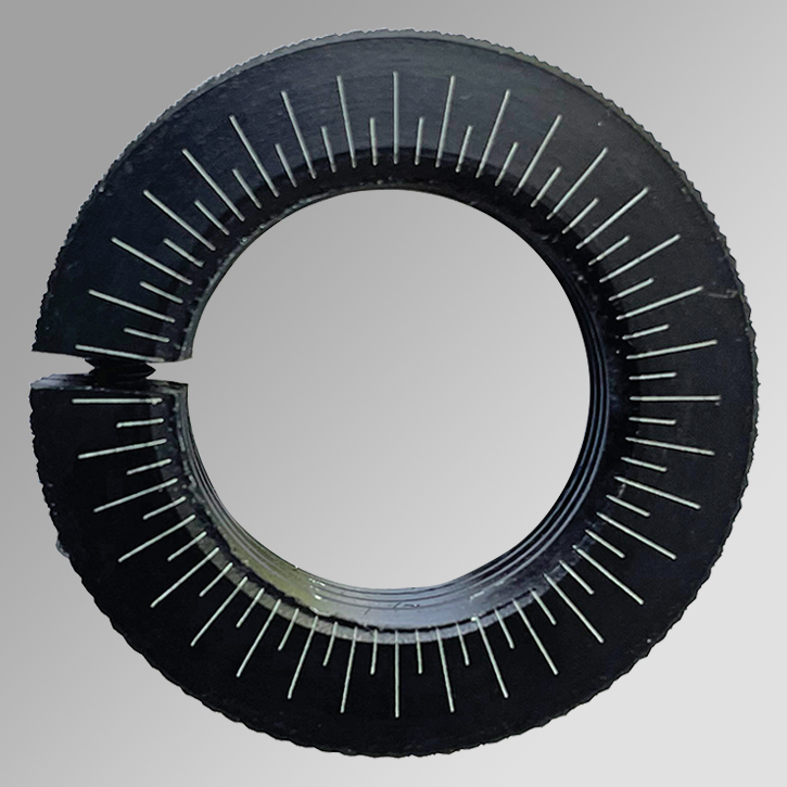

7/8-14 threaded dies move .0714" per full revolution (1/14 = .0714"). Every 5 degrees of turn in, or out, is roughly .001" of depth change.
