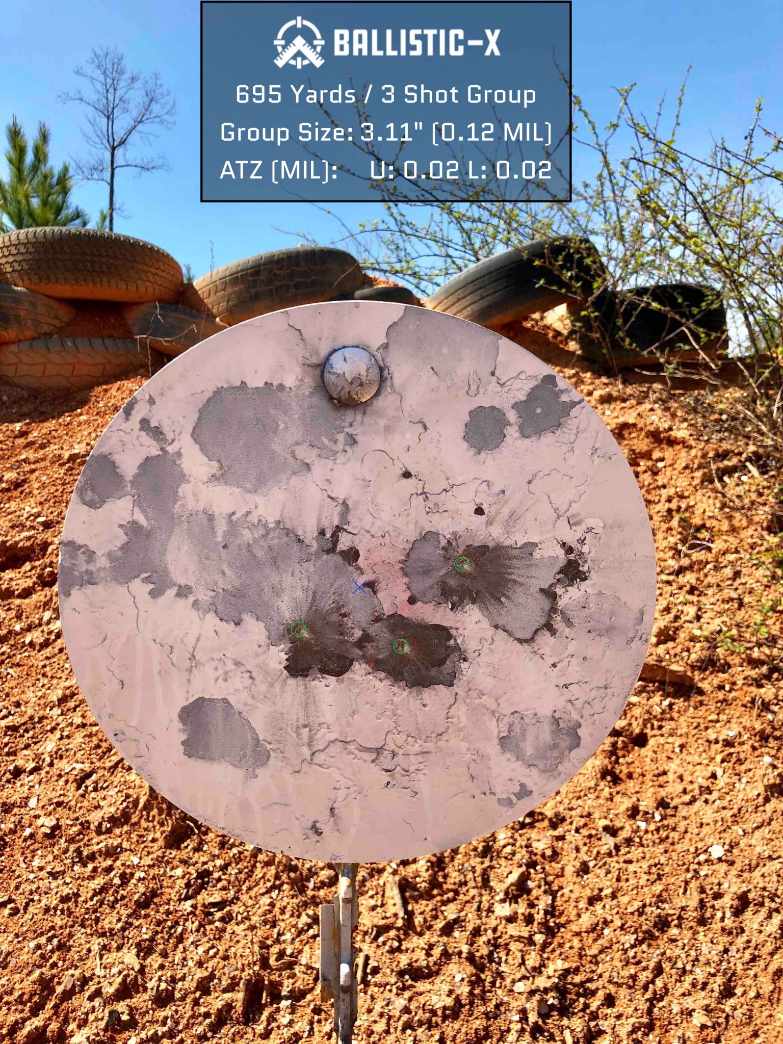

    I don't have an app to do horizontal and vertical deviation, so here is what I got with Ballistic-X
    Copper Creek 139gr Lapua Scenar
    12" plate and 3/3 from 695 yards. The bolt is 1"
    7047742

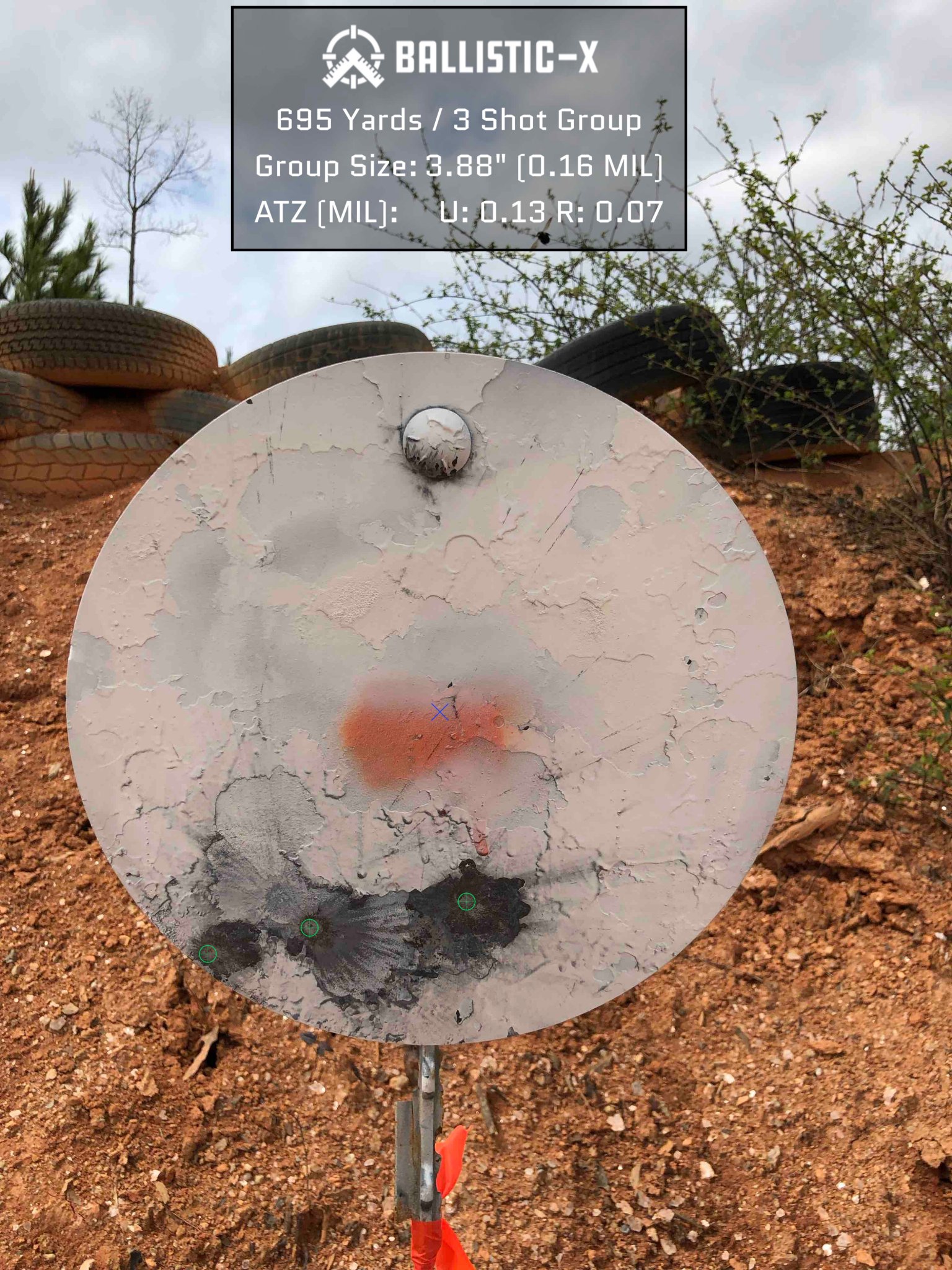

    Berger 140gr Hybrid Targets
    7047760

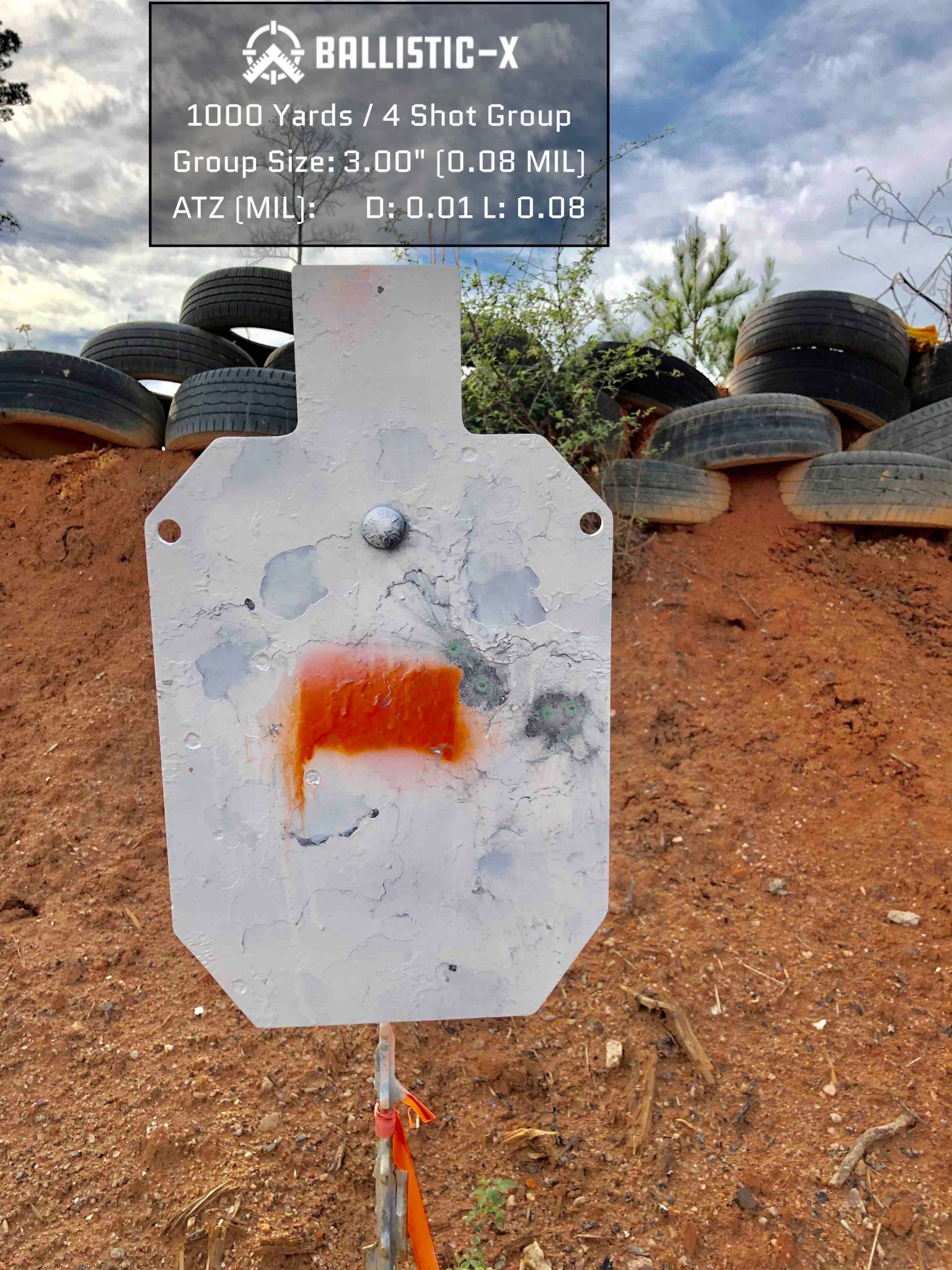

    66% IPSC and 4/5 from 1000 yards. Bolt is 1". First round was a miss off the right edge. Elevation was spot on.
    7047743
    blbennett1288, most excellent response; and I'm also guilty as charged, jumping to assumptions based upon facts not in evidence.
    Clearly your conclusions are based upon a lot more than I had assumed.
    I just always keep falling back into jumping directly to the chase, and basing my own assessments on actual, true evidence as shown on the real deal target. I find it just so much harder to argue with the target, itself.
    All dispersions are the direct product, in part, of flight time variance. Some of it is going to come out of the cartridge, and some of it is not, like the environment. The best we can do is our part, Ma Nature still gets Her say.
    For my own part, that's how I develop: to achieve results on target. I consider chrono exercises and some other techniques as at least partly sidetracks and detours that may or may not bear true witness to best performance. Clearly, there's room for discussion on this.
    I also go to some different extremes, mainly in how each load gets metered by weight; it's my best approach to reducing ammunition-related deviant performance.
