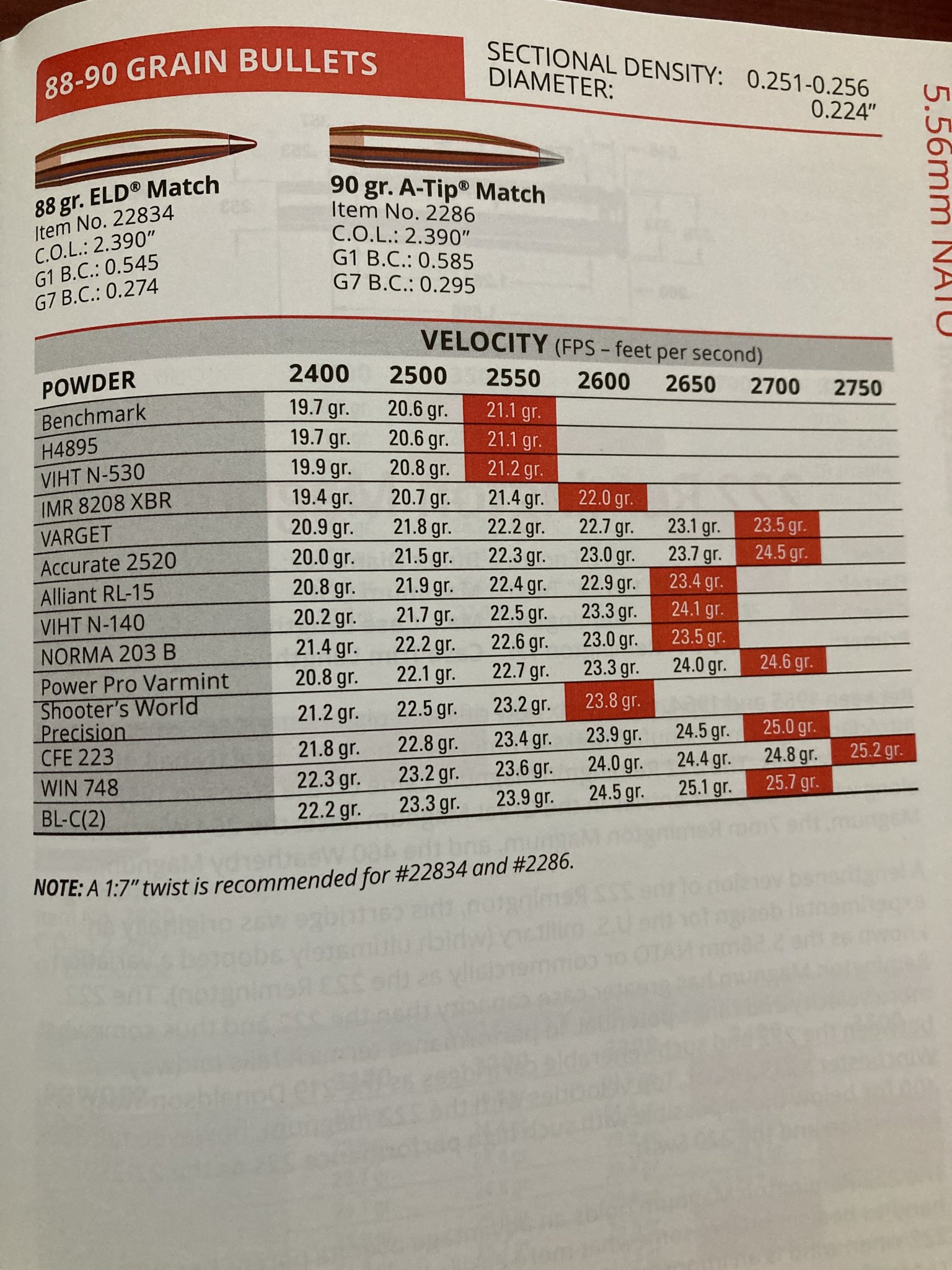

    Does someone have the latest Hornady manual? I have #10 but the heaviest bullet it lists for the 223 is their 80gr. I’m trying to load their 88eldm and getting so so success with Varget, so I want to see what other powders are listed in case I have some to try. A picture of the page would be great if anyone can provide it. Thanks, Steve
    I checked, they state they only post data for new bullets temporary until they are added to the latest published data. They were probably there before the 11th edition came out.
    80 largest listed in the 11 manual.
    5.56 is listed for 88
    H 4895 is what you want
