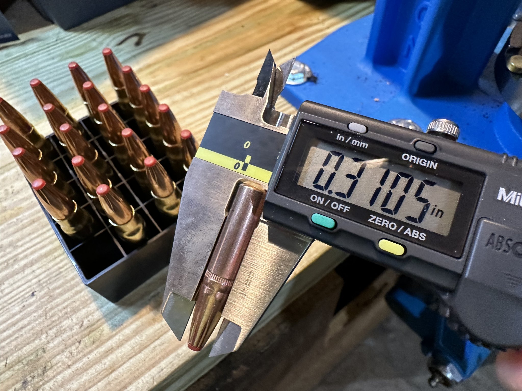

Doesn't 300 BLK use a .308 diameter bullet? If so be careful as these are probably .310 or .311 diameter. You can always run them through a bullet sizing die to get them down to .308 if need be. Please let us know how they sound suppressed. Just confirmed it will be Thursday when I'm able to test stability to 200 yards.
Reactions: 338dude
I’ll definitely mic them first. That’s a good point.
Reactions: 338dude
255 gr Sub-X 0.3105”
Gonna size some down to 0.3080” and some not for the .300 Blk trials. See how accuracy goes. Subsonic shouldn’t make much difference in pressures.

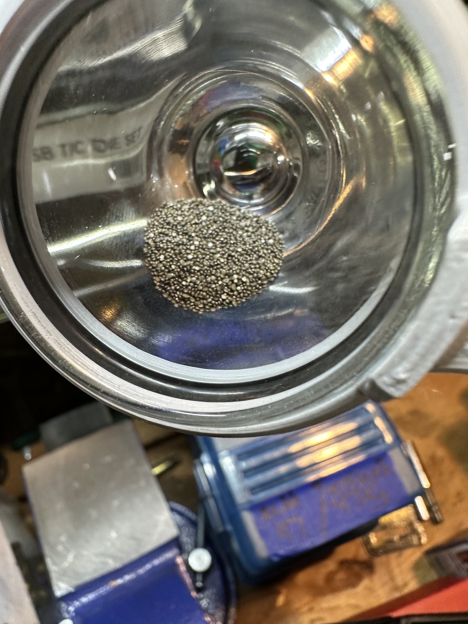

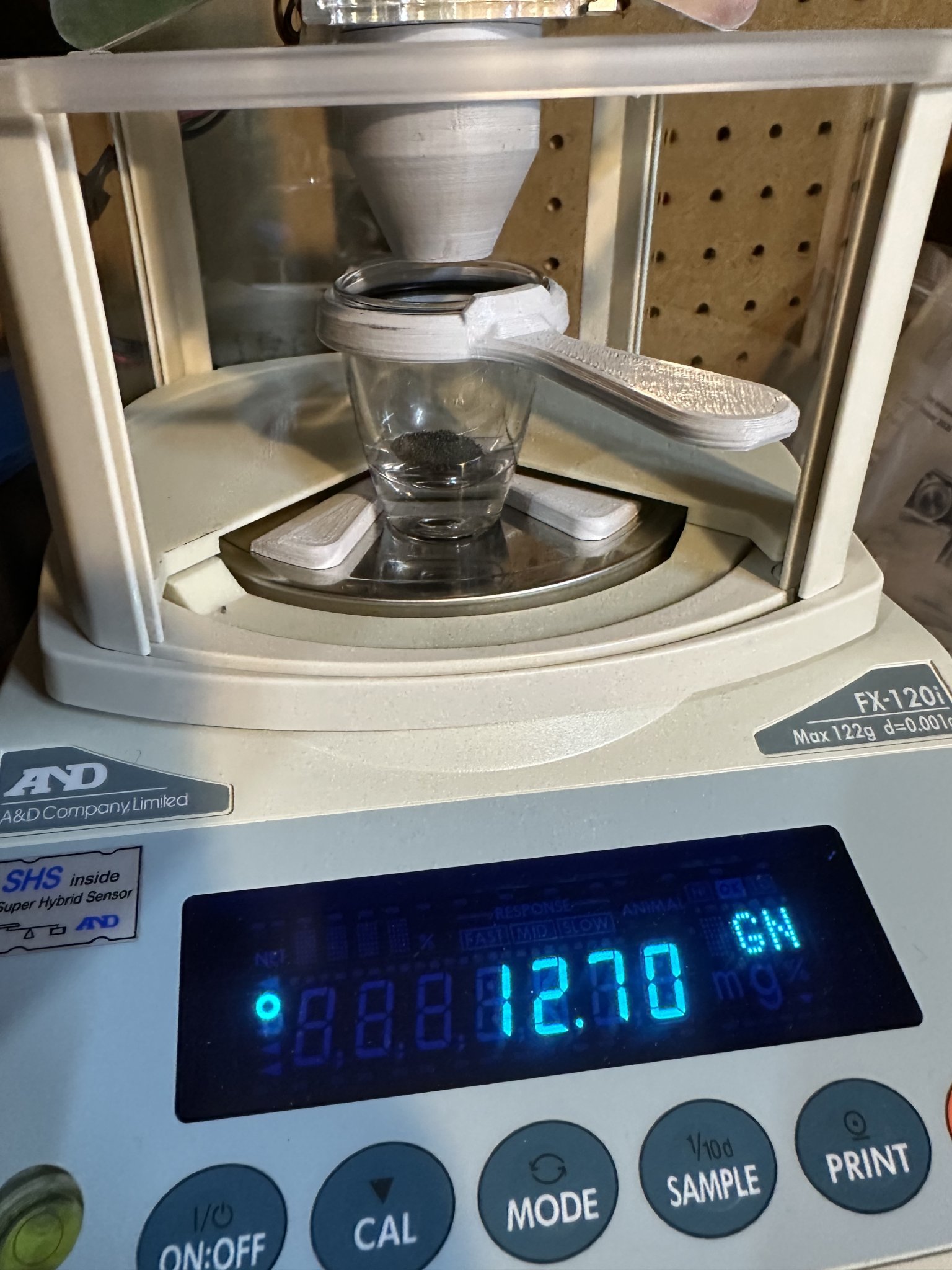

FWIW the loaded ammo is 12.7 gr of a ball powder.

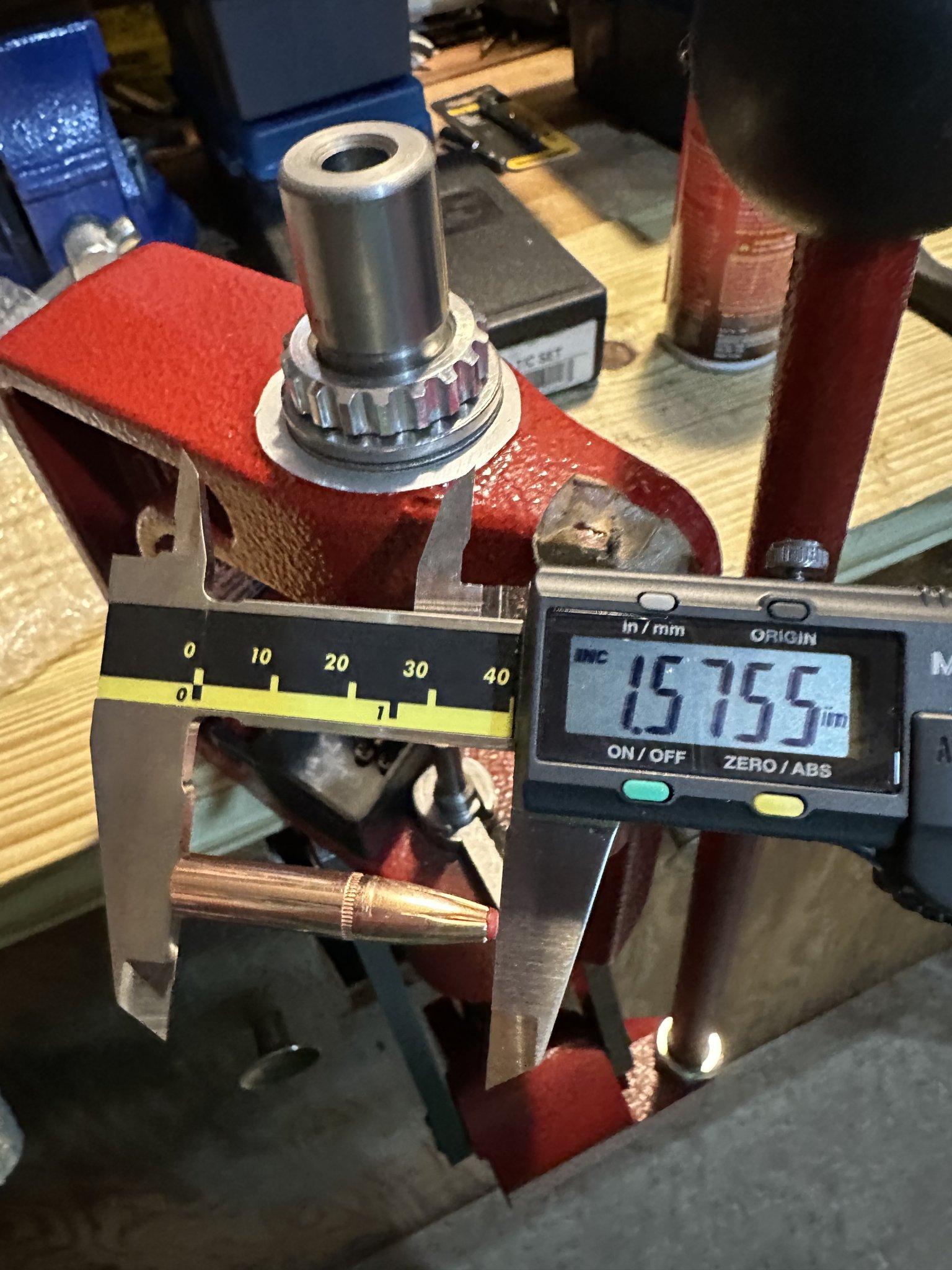

Bullet is 0.1.5755 long.
That bullet is so freaking long! It must come close to bottoming out no?
Actually, it may compress slightly but that possibly helps with consistency. Imagine the .308 WIN subsonic example. Too much empty space in the case and ignition can be inconsistent supposedly. I’ve only read about this but not tested it myself.
I did hold the bullet up to the case and that’s how I’m figuring none to slight compression possibly. Not very scientific 🤣

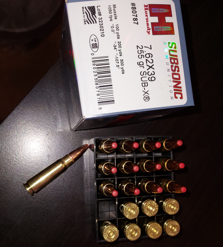

Follow Up on Hornady 255 gr Sub-X bullets in 300 Blk

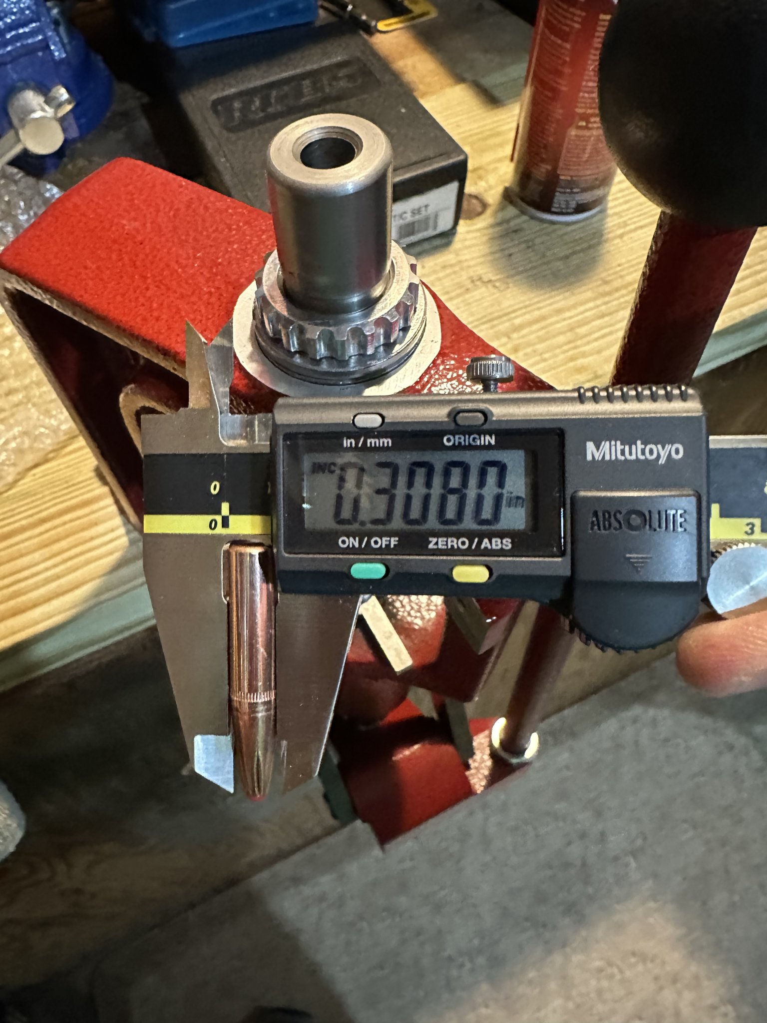

First, the original pulled bullet (from Hornady 255 gr Sub-X 7.62 x 39) at 0.3105 stretched the Starline once fired brass
and would not chamber completely with the exception of one round with 9.0 gr A1680 and recorded 828 fps.
Second, once the bullets were resized to 0.3080, using a Lee .308 bullet sizing die, they chambered fine until filled with 10.9 gr and up of A1680. The bullets are 1.575 long!

AutoTrickler V4 w/ Fx120i

Hornady 255 gr Sub-X Factory rounds
12.7 gr of an unknown ball powder that isn’t A1680
1044, 1172, 1151, 1132 fps

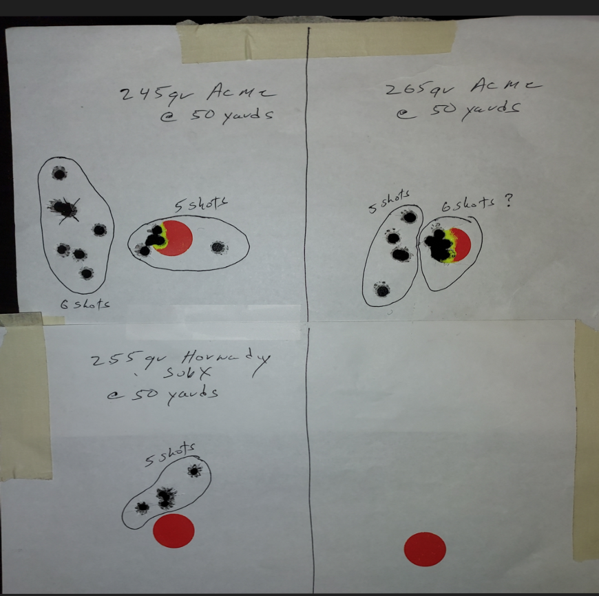

Update on my 7.62x39 subsonic journey. Its going great and has already exceeded my expectations! I've tested .308 220gr plated bullets and both the .310 245gr and 265gr Acme bullets. All three are stable and accurate out of my dedicated rifle. I've shot the 220's and 245's out to 438 yards. No problem hitting spots on rock faces and no signs of any instability. Shot the 265gr bullet out to 194 yards this past weekend and again accuracy was very good.

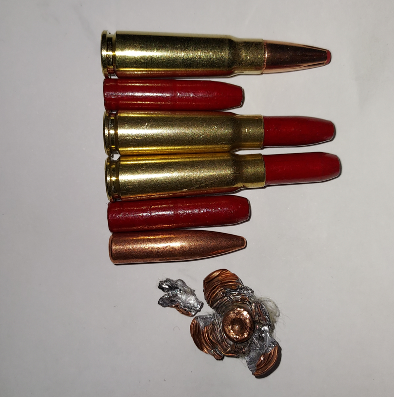

Here's a picture of the gang with a factory Hornady 255gr on the top. Did not have a loaded 220 on hand:
I took a shot a supported Kevlar vest just for the fun of it with the 220gr plated bullet from Everglades ammo. Impressive expansion. Final accuracy and chronio testing will be performed next time out, but here is my current 5 shot load data results:
220gr w/small rifle primers CCI #41 at 10.7gr of H110: Max 1087, Min 1006, Avg 1058, SD 35 COAL 2.200
245 Acme w/large rifle primers CCI 200 at 9.8gr of H110: Max 1091, Min 1040, Avg 1060, SD 19 COAL 2.207
265 Acme w/large rifle primers CCI 200 at 9.6gr of H110: Max 1100, Min 1053, Avg 1077, SD 16 COAL 2.248
I've observed that large rifle primers give me better SD's. Going to try some with large rile magnum primers to see if the SD tighten up some more.

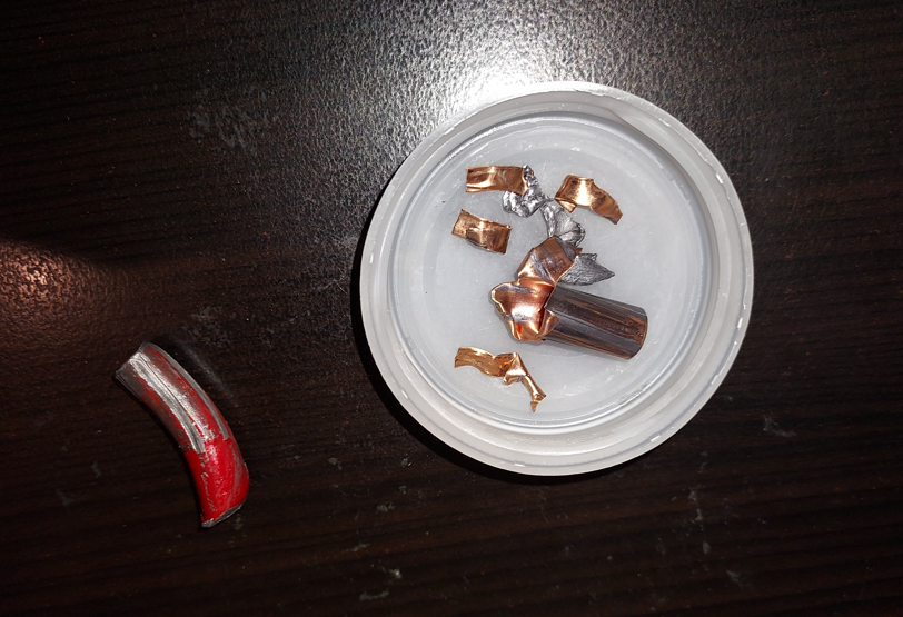

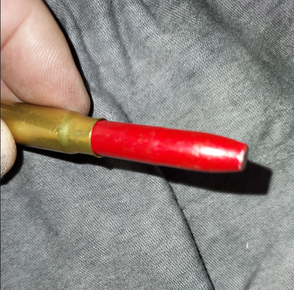

Did a quick and dirty penetration test into water jugs using a modified tipped Acme 265gr and the factory Hornady 255 Sub-X. Two completely different results. Acme went right through 4 jugs and stopped after hitting a soft kevlar vest backstop. The Hornady was explosive and disintegrated. Could not find the Hornady lead core but I think it slipped out of the side of the 4th jug.
Not sure I want explosive traits in a subsonic round. Will test again in a more formal way and include pics next time out.
Reactions: Kedzie

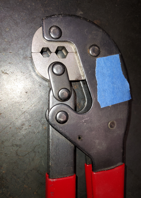

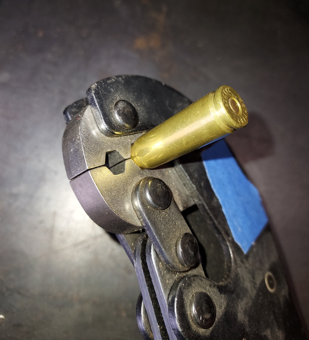

Spent some time this past weekend trying to find a crimping solution for shooting subsonic .308 bullets out of 7.62x39 cases. As previously indicated, my Faxon barrel has a .308 grove diameter so I can take advantage of this size projo. The big problem is getting any kind of crimp tension as the Lee collet crimp die expects a .311 diameter bullet. It does not work at all for .308 and barely for .310 projos. Dangerous IMHO especially for .308!
I was on the verge of trying to make some type of collet insert for the die to reduce the diameter but found another way. If you have or can source a 75 ohm coaxial crip tool, it works perfectly:
Its like it was custom made for this application. Just slide it in until it hits the shoulder, move back out a cunt hair and squeeze. The 4-point contact does not affect the roundness of the neck but i still run it through the collet crimp die as a precaution.
For loading up flat base Hi-Tec coated bullets I find it much easier to bell the top of the neck with a 9mm case bell die. Just barely is enough to ensure easy seating:
I'm sure there are better ways to address these issues, but zero cost here. Anyway, couple of Christmas loading hacks to consider for you cheap bastards out there.

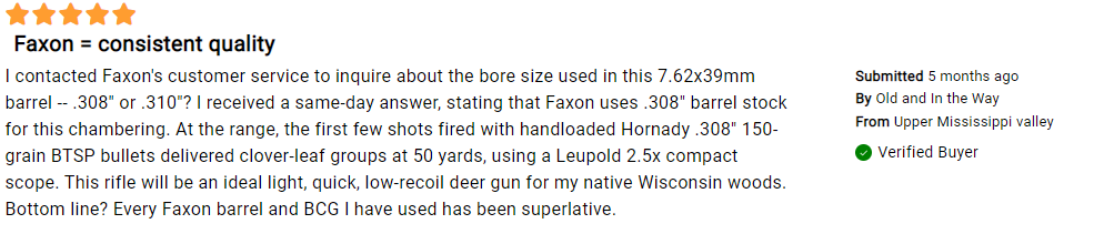

After reading this thread, I'm still not sure if it's ok to load .308 diameter bullets in a 7.62x39. Can anyone confirm that?
I'm researching making a 7.62x39 subsonic load for a friend, but the only .310 diameter bullets I'm seeing are 123s and I'd obviously prefer to load up 190+ grain bullets.
Its fine if your 7.62x39 barrel grove diameter is .308. Oddly not all gun and barrel manufacturers are clear on this. The Faxon barrel I'm currently using is one example. I believe the Ruger Mini 30 in 7.62x39 is another.
And be careful on the terminology when confirming. Don't use Bore size. There are two measurements - Grove and Land diameter. Its the grove diameter you need to confirm is .308.
Most all AK's are going to be a .310/.311 diameter bullet. Some of the 7.62x39 barrels for AR15's are setup for .308 diameter bullets, because the company already had .308 blanks for .300 BLK and .308 Win.

Pulled bullets, sized to .308 with Lee bullet sizer.

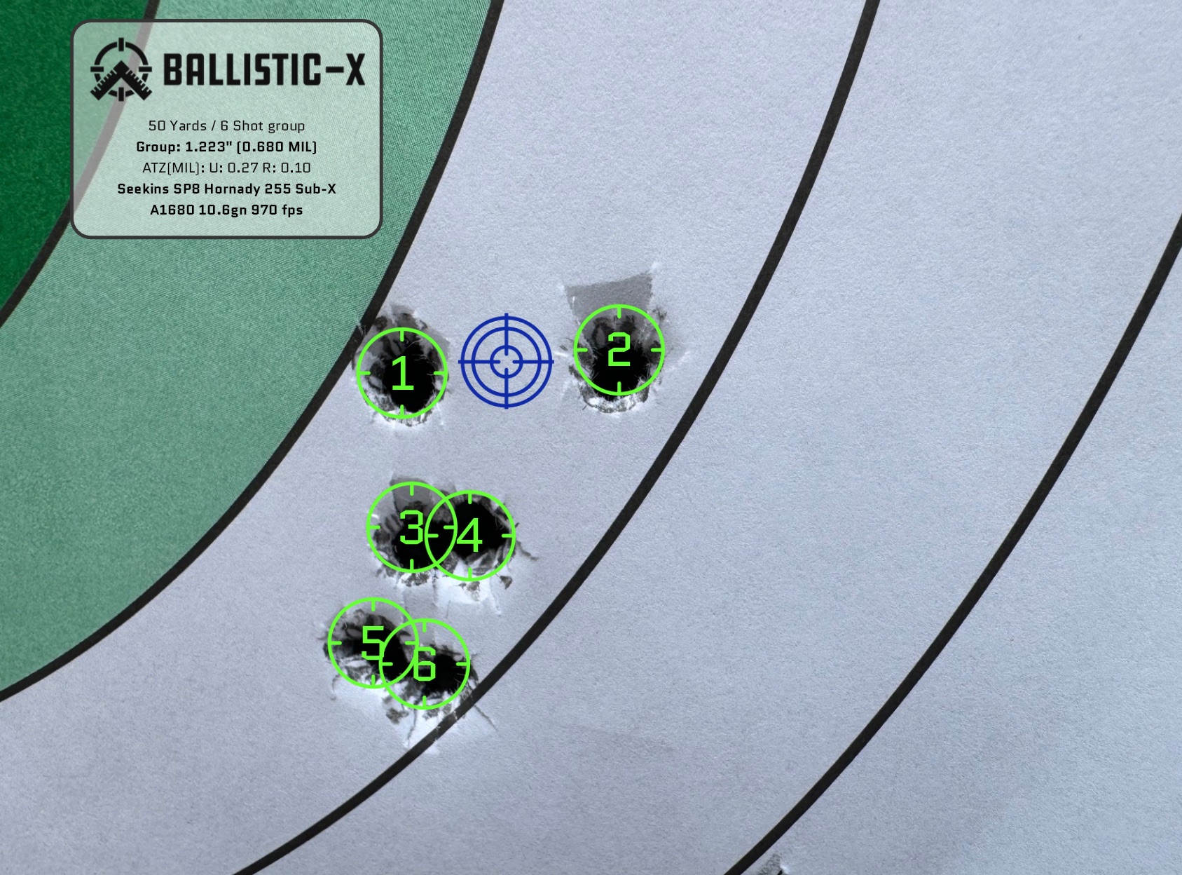

1/4/24
54F 39% 30.01in
255 Sub-X resized to 0.3080
A1680
GM205M
COL 1.3500 new starline brass
*BTO 1.625
COAL 2.18 approx
10.4gn 978, 969, 937, 963, 935, 952
937, 962, 973, 950 1.7” at 50y
10.6gn 999, 974, 948, 965, 958, 979 1.2” at 50y
Ejects but doesn’t cycle a new round even with AGB wide open.
Ballistic-X-Export-2024-01-03 14:28:46.212940.jpg
