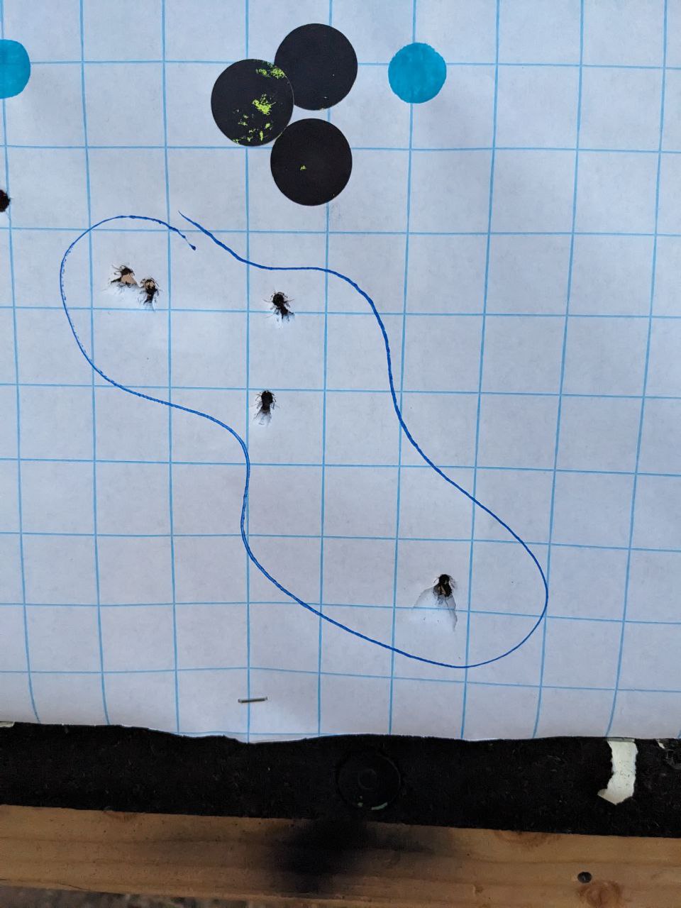

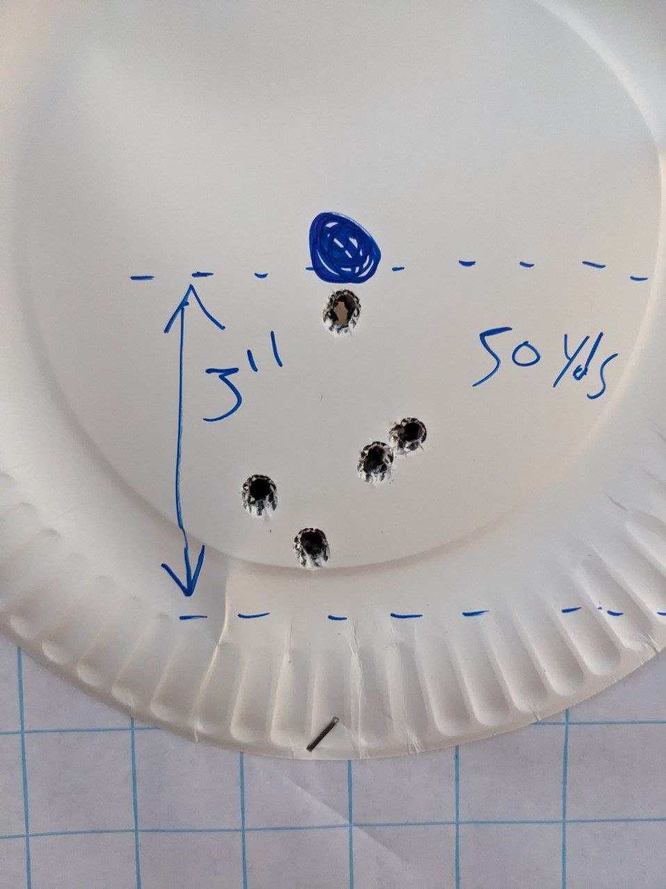

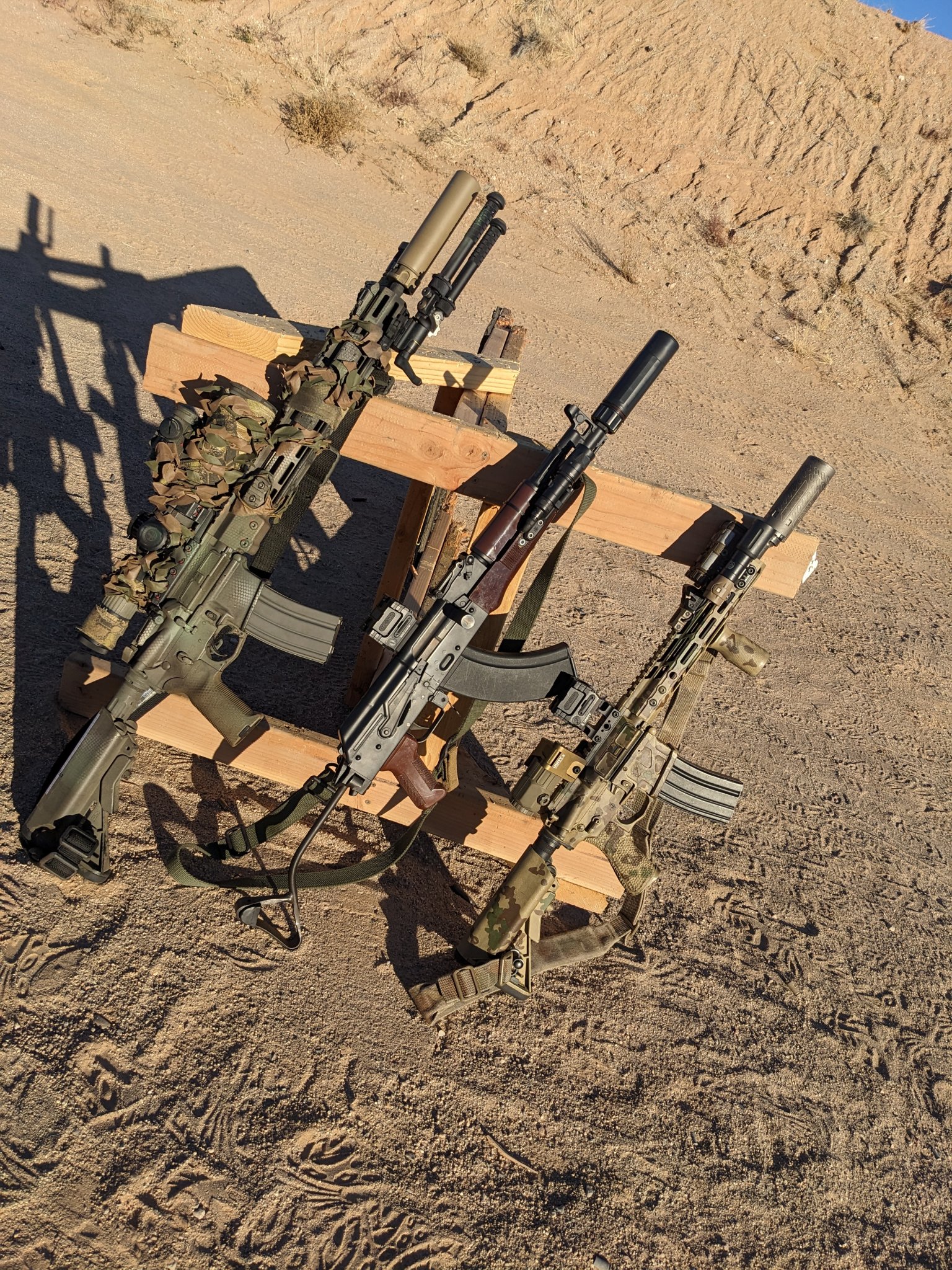

Reporting back, the Hornady SubX 255 grain 7.62x39 did not cycle in my SBR AKM 12.5" barrel East German inspired kit build, that was with a relatively low back pressure suppressor on, Sandman K.
Rounds appeared marginally stable. Some evidence of keyholing at 50yds and 100yds, pictures related, but no baffle strikes.
Reactions: db2000
