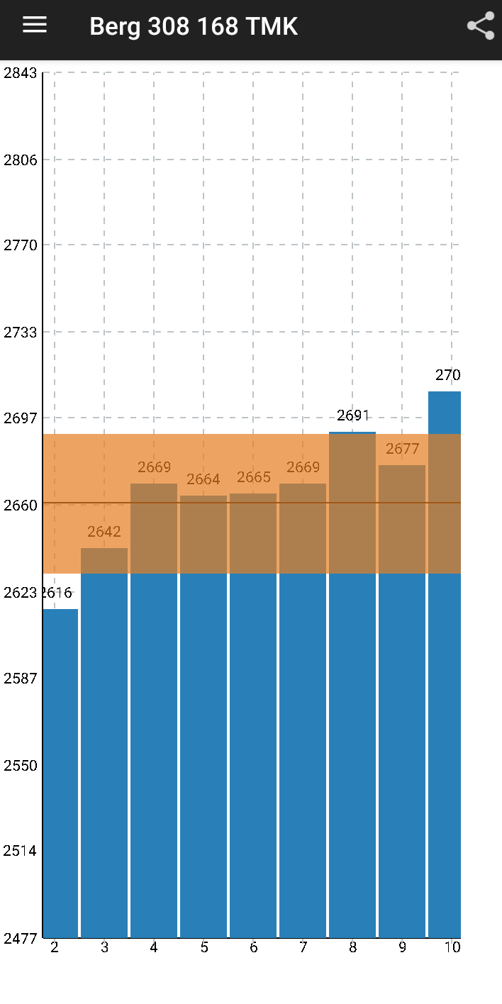

Don't know what kind of velocity you're chasing... But my wife's 20" .308 was in the 2660's with Lapua brass, BR2's, and 168 TMK's.
Powder was IMR 4064
#4 was 44.3 gr.
#5 was 44.5 gr.
#6 was 44.7 gr.
#7 was 44.9 gr.
Probably could have done more up the scale... #10 was 45.5 @2708. But I saw the node and started playing with seating depth.
