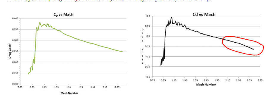

Remember the old Amax's that "melted" ? When I was in Va, shooting the 1000yd match with the 6.5cm, would always score mid 190's with them, never an issue. Was always 90+ in temp also.
The cm doesn't go fast enough to be a problem, it's with higher velocity cartridges that they melted from friction passing through the air.
I wonder why guys weren't seeing this issue with the Vmax because they had to be seeing some serious velocities out of the 22-250 and 220 Swift.
I've run the 87 Vmax out of my 244AI and they were moving at 3400 IIRC, sub MOA at 545 yards.
Reactions: BurtGummer
It’s not just the speed, it’s the distance, aka time of flight.
It takes time for the friction to cause the tips to build up heat enough to deform so it’s only at extended ranges it’s detectable. I say detectable because it was hornady using a radar and noticing that the bc value was fluctuating way out there.
Reactions: John Glidewell
