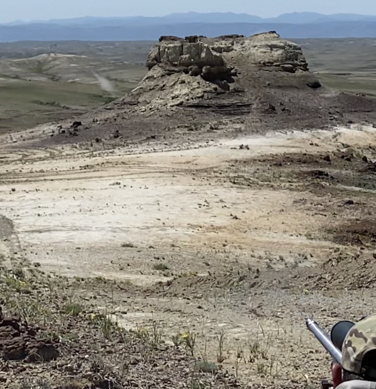

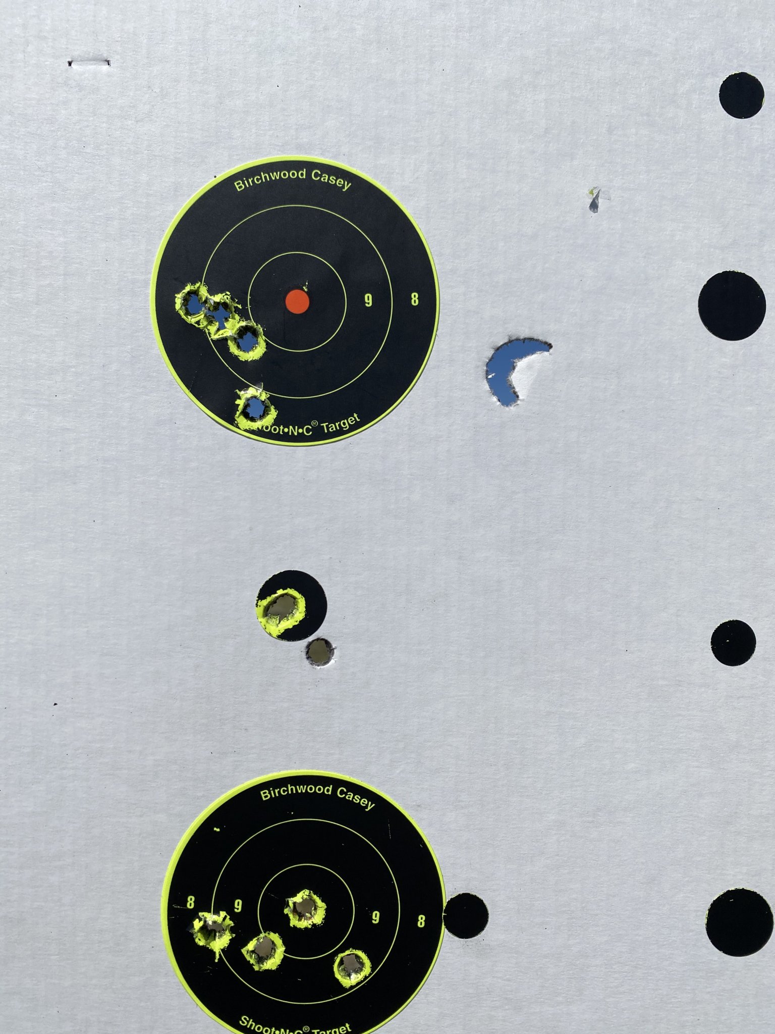

What did it look like down range when this happened?
Looked exactly like all the other pics/videos I’ve posted lol
I didn’t get any video of the ones yesterday because every stage is blind and you’re not allowed to watch the other competitors.
Here’s the ones blowing up at the NF ELR
As far as down range, here’s what it looks like at 100 yards if it actually makes it to the board. Wouldn’t group for shit then you get bananas In your target

Same here. I've had what I would describe as poor and unacceptable results overall with Hornady A-Tips and even some of the 75's I was shooting out of a .223.
What I've seen is that the A-Tips shoot exceptionally well out of a brand new barrel, but when the barrel develops some fire cracking (or general wear) in the throat or rifling, the A-Tips (specifically) will not fly predictably. I could name you some very high-ranking shooters in the PRS with the exact same experience, so this is not an isolated incident. I guess you don't get a 6mm 110 grain bullet with a .310 BC unless it's pushing the razor's edge of aerodynamic performance. The tradeoff seems to be predictability of the bullet over the life of the barrel.
I've tested everything with regard to cleaning, seating depth/load adjustment that we can think of, but the only 100% cure for them seems to be a new barrel. Otherwise, they "work", but not at the accuracy level you'd expect from a highly-touted product.
Once I exhaust my supply of them, I won't be buying them again.
