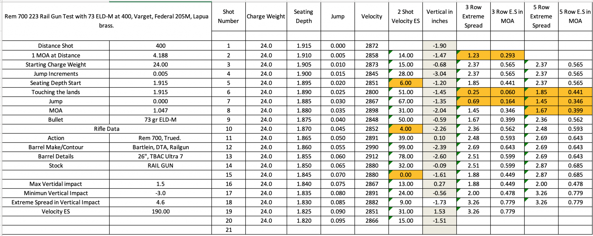

We did some limited bullet jump testing with this bullet. I asked some people at Hornady a few years ago if they could recommend a 22 cal bullet/ammo that was typically a "slam dunk" with every rifle they shot. They recommended the 73 Gr ELD-M. It won't burn the house down in the BC department, but it is pretty stable and tolerant to changes.
Here is our standard 20 consecutive shot bullet jump ladder test we did going from .000" jump to .095" jump in .005" increments.
You can see that at 400 yards, 0.000" to .010" jump was .293" MOA of vertical for 3 consecutive shots. .020" to .035" was much better with .06 MOA and .164 MOA of vertical for 3 consecutive shots. I like to look at 5 consecutive shots however. As you can see the .015" to .045" jump was very consistent and offered .346 MOA to .441 MOA of vertical for 5 consecutive shots at 400 yards.
This test was "Text Book" in the regards that the 73 gr ELD-M bullet has its jump node all bunched together despite high spreads in velocity.
So anyone loading the 73 ELD-M, I would recommend starting all of your charge weight testing with .030" jump.
Mark.
