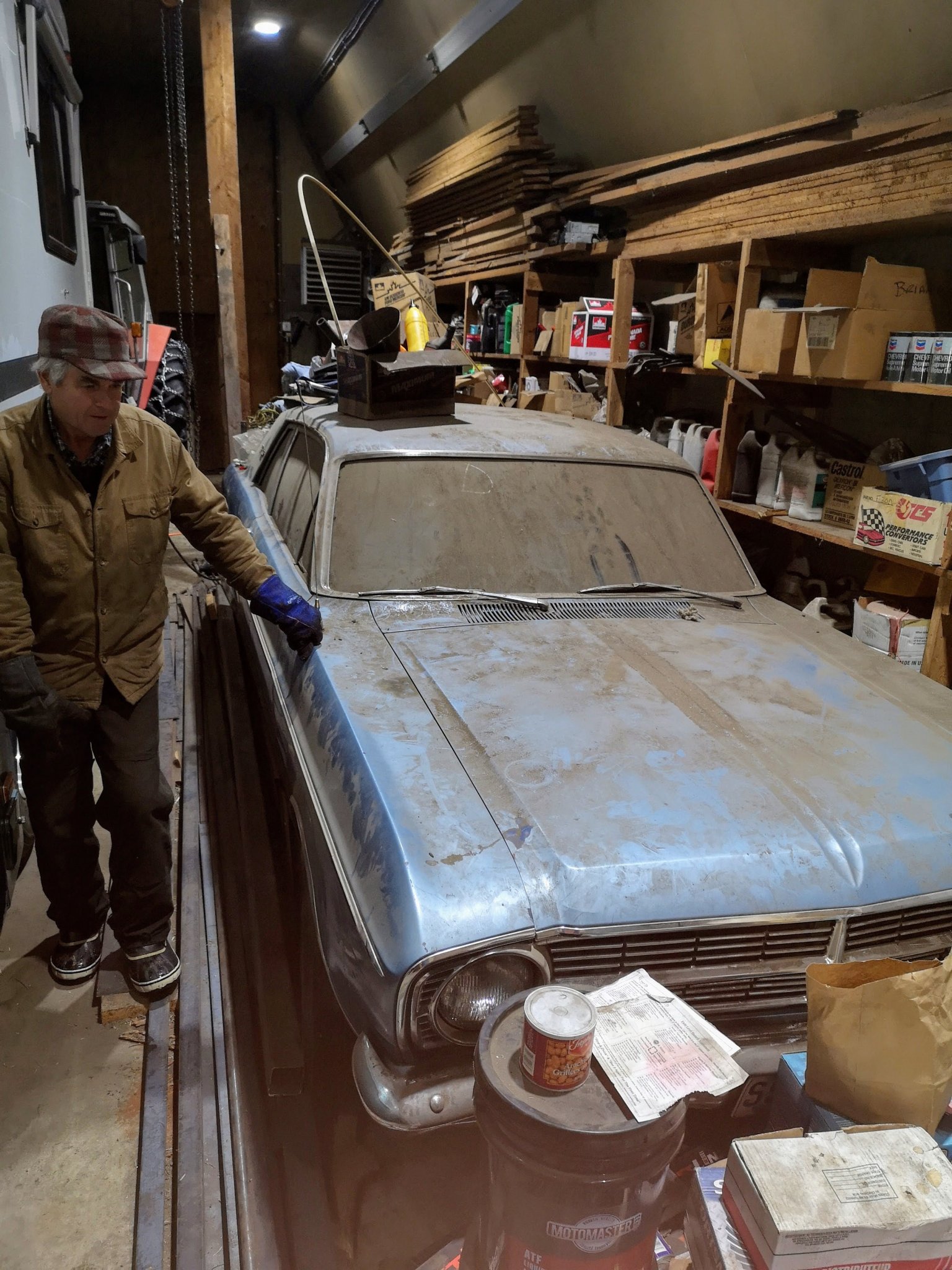

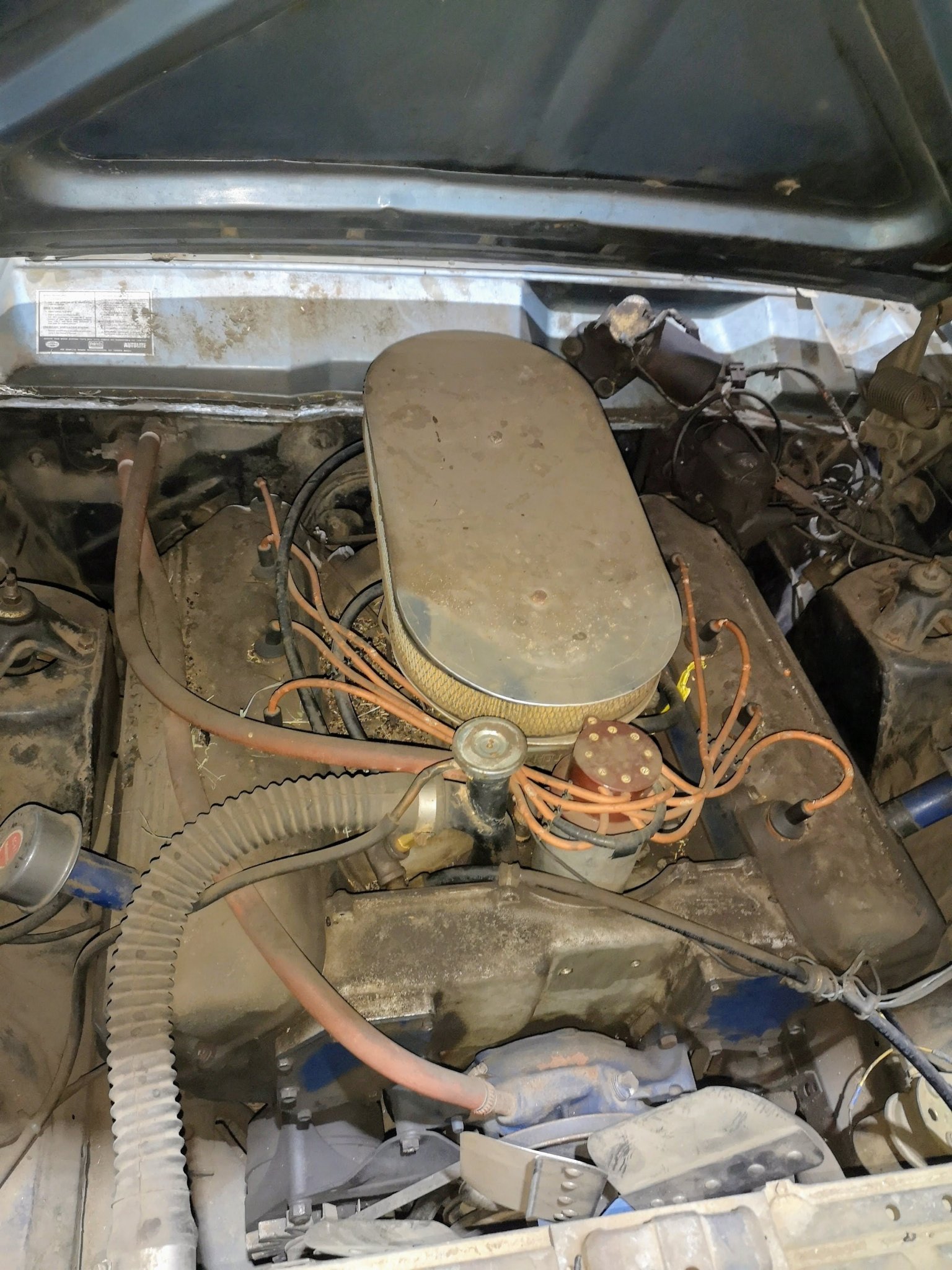

This one's a bit of a time capsule. My dad's 67 Falcon that he bought off the proverbial little old lady that only drove it on Sundays, back in the 70's. He also bought a 427 SOHC from a drag racer, then crammed that in under the stock hood. Ran a top loader with a Hurst shifter, homemade cage, and 33x16.5 slicks with a spool and 5.67 gears, and was able to run the quarter at right around 130mph and 11 flat. He also drove it on the street, minus the slicks. On the slicks and a good track, he says it would carry the front all through first gear. He's got another hood stashed away with a big bulge in it, along with a mechanical fuel injection setup that he never ran. Nothing quite like an old school big block that'll spin past 7500 rpm and make somewhere around 750-800hp. It hasn't been driven for close to 40 years now, but before anyone asks, it's not for sale. Every few months someone finds out hes got it through the grapevine, and gets hold of him to ask. He told me.once it's in his will, so either me or my brother will get to play with it eventually, unless he's planning to be buried in it.

Very cool, hopefully it sees the street or strip again.

like most of us i see he has a pile of wood on top of the shelves...boards are prob from when Ike was president :ROFLMAO:
"you never know when youll need them"

“Dad, my brother and I want to get your car running and recommissioned so you can enjoy it again… that ok with you?”
I mean… why wait?

I just got light-headed

It would be worth seeing your dad's reaction to just seeing the car outside in the sunlight after a quick wash.

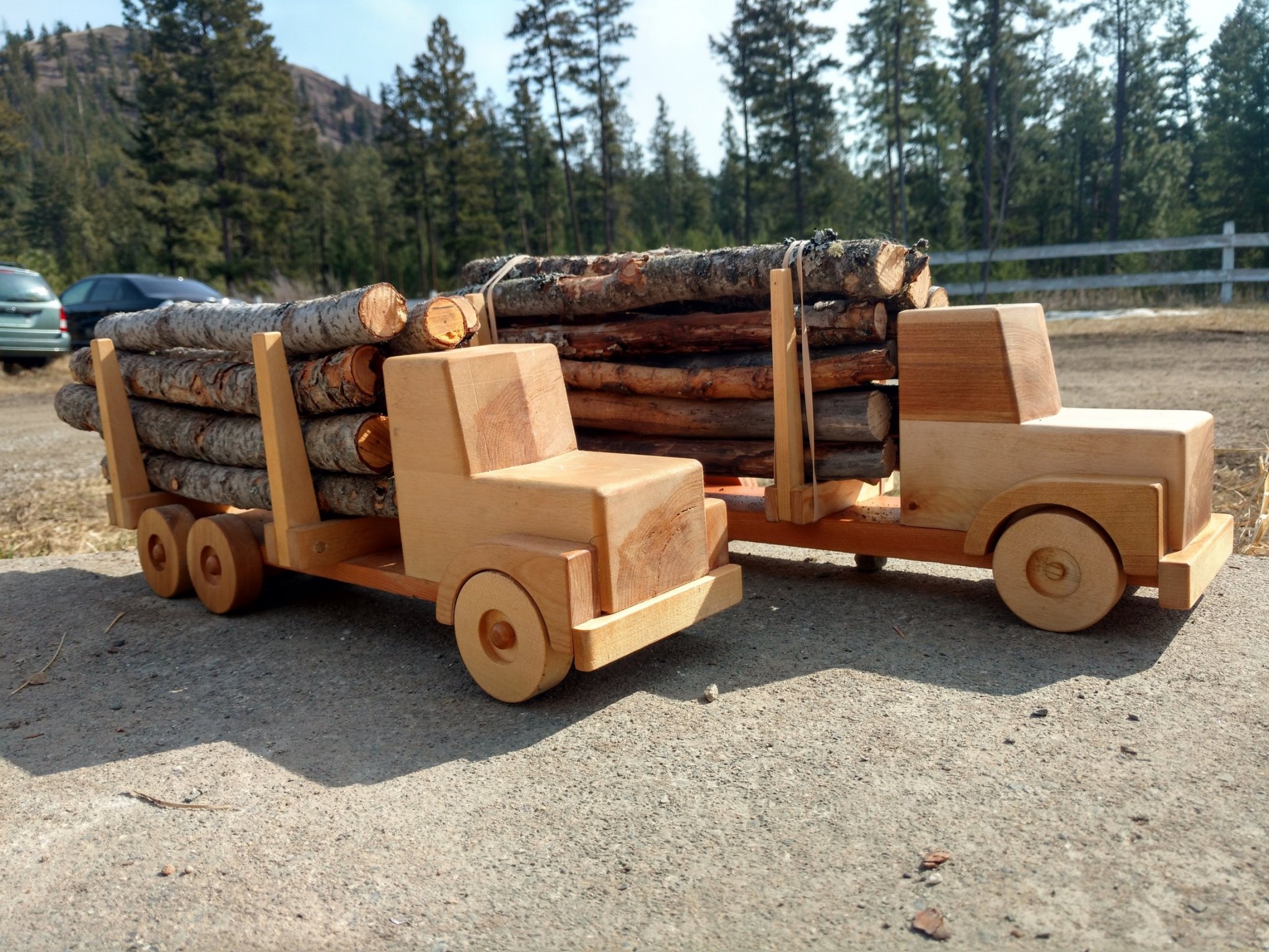

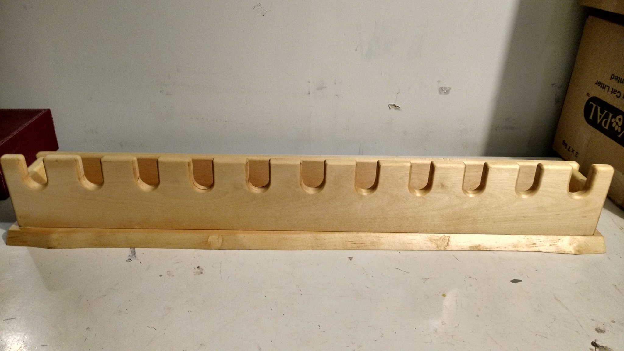

I have lumber that my grandpa cut and planed probably 40 years ago, and I still use bits of it every now and then. Especially when I'm making wooden toys for the kids or something, it's almost like he's still here helping me out. It's his shop and I inherited most of his tools too, so it's pretty cool being able to use wood he cut too. I've got a couple nice pieces of 3/4" live edge birch that I'm saving for some shelves, but I still don't know quite what I want to make with them. Here's a handgun rack I built with some short scrap pieces.
And a couple toy trucks about 2' long made of scrap birch and fir. The logs are just sticks cut from a dead tree out back.

Those trucks are great!
I just did the same for a gun rack inside a piece of furniture. I actually used some of “the pile” that I had t touched in years.
All of the rifles I have are just too fat for the regular spacing so I clicked around looking for a gun cabinet but didn’t find what I liked.
Friend told me look on Facebook marketplace. Long story short I picked up a dining room china cabinet.
Glass doors, mirrored back, light etc. like most dining room furniture it looked like it had never been touched but for cleaning.
Added benefit, glass shelves so I put some optics, scope mounts etc up top so they aren’t trying to fall off the regular shit show rack in my basement.
Was laughing as I was pulling pieces down because I was actually using some of it.

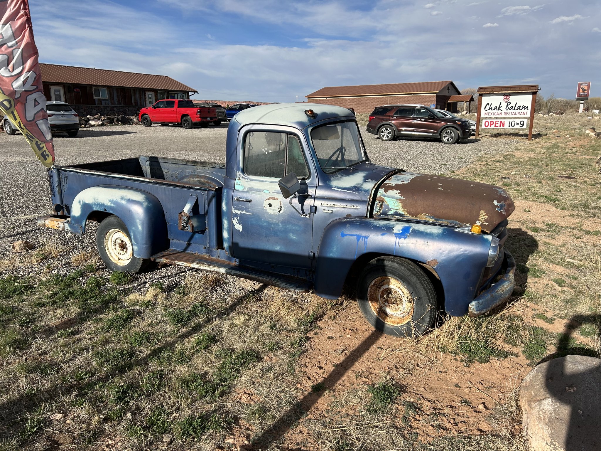

Vacation in Utah after daughter‘s Archery Nationals (#12 10th grade, #19 overall) and came across this gem at a Mexican restaurant in west Torrey.
I asked if they had any plans for it or would entertain selling it.
No plans, won’t sell it, like it just where it is.

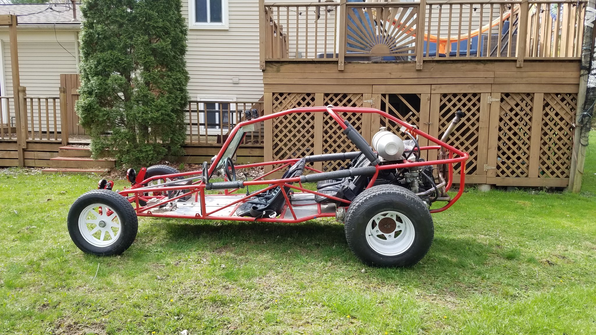

Not that this has a lot of HP or TQ, but its my new toy. Its probably about 70HP, but it only weighs 1100 LB's. Its a lot faster than I though it would be, lol. I have wanted one for a very long time, my Dad had VW's through my whole youth and got into more traditional (not AC VW's) classic hot rods when I was about 12. We had everything from sand rails, beetles, a Ghia, a type 181 (Thing), a Manx glass body, a type 3, and probably more that I am forgetting about. I still remember sanctioned racing from when I was young, Dad was President of the Detroit Buggy Club.
Plan is to work on this with my 14yo son, let him do most of the wrenching. I think it is a good and simple car to teach intro to vehicle maintenance and modifications on. We will work on getting it street legal, and spend time up at the Silver Lake Dunes, and the many trails we have here in Michigan.
VW 1835 with dual Kadrons, Swing Axle, and front kingpin beam from a pre'65 beetle in what I think is a 4 seat Appletree frame (could be a Whitehill though).

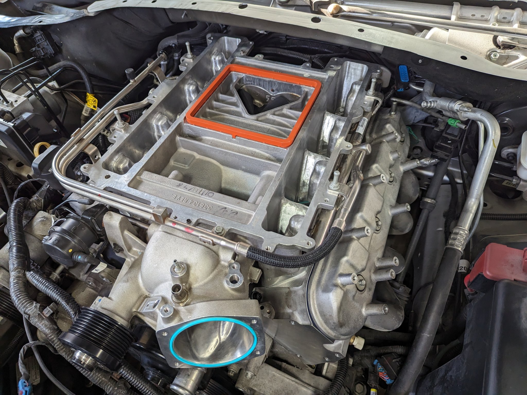

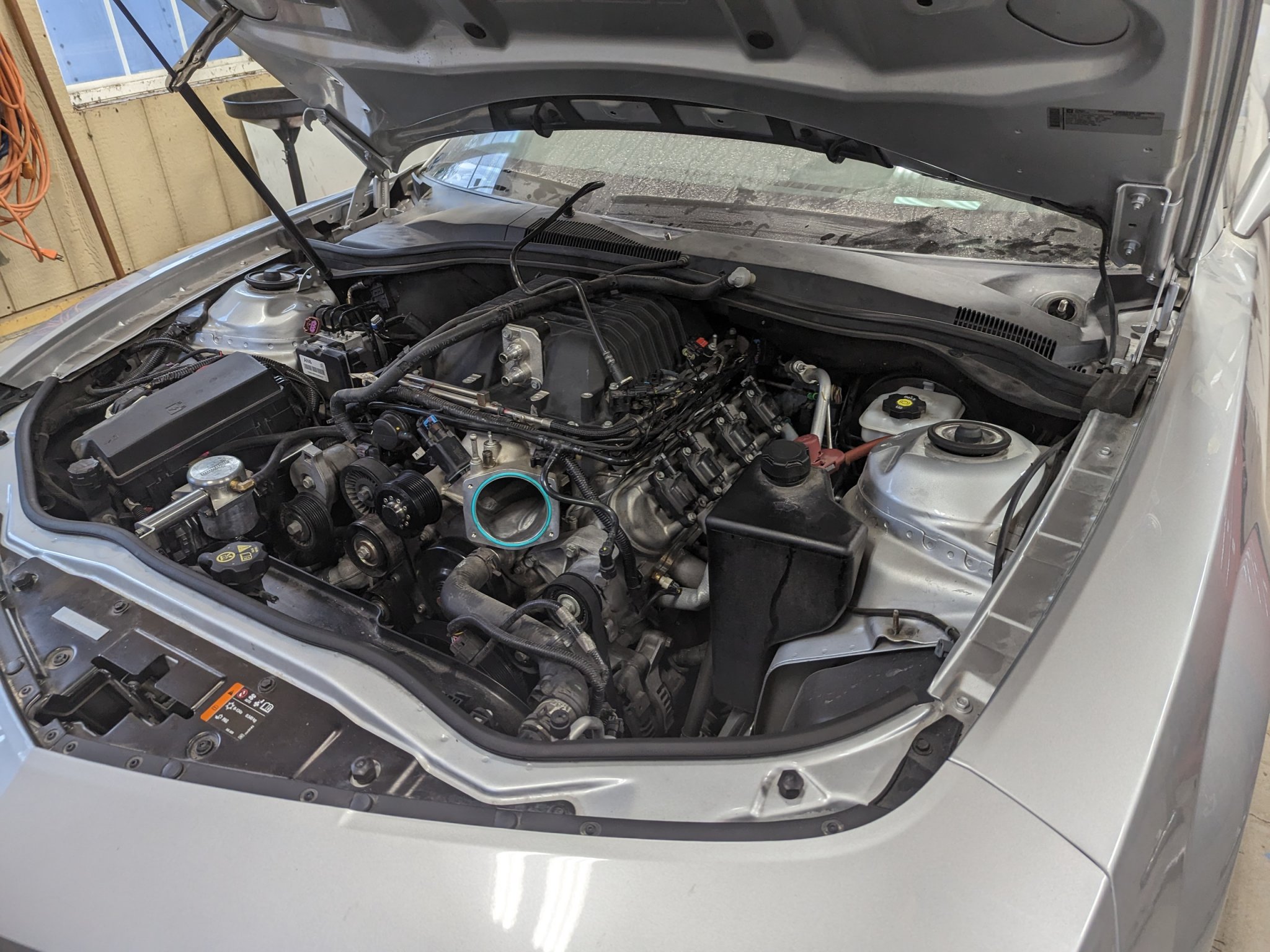

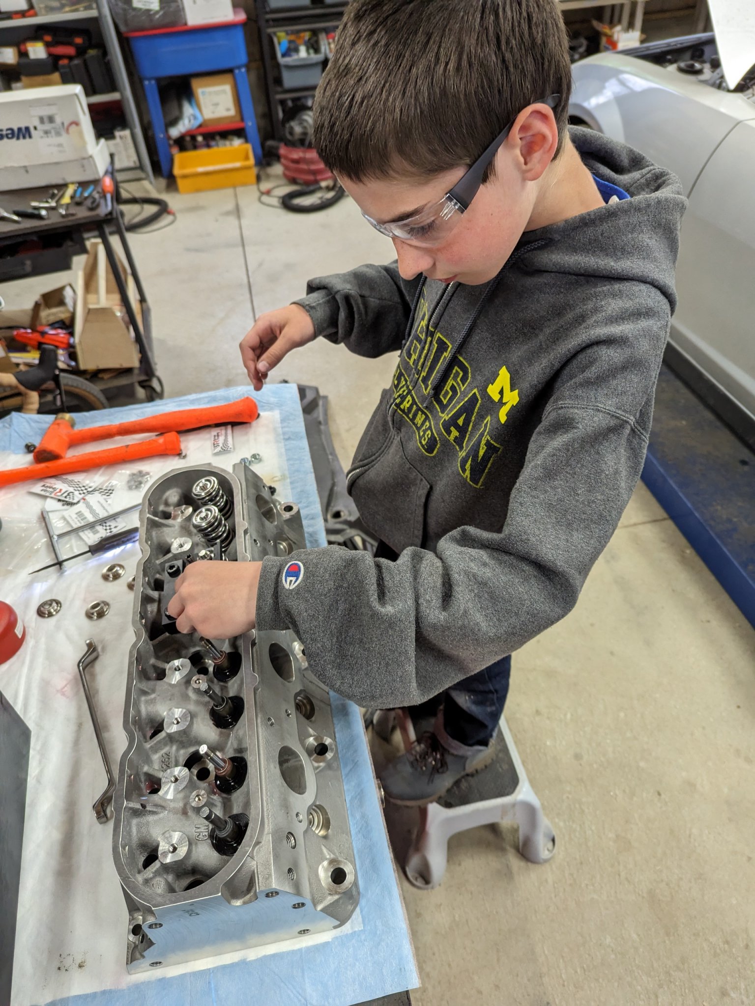

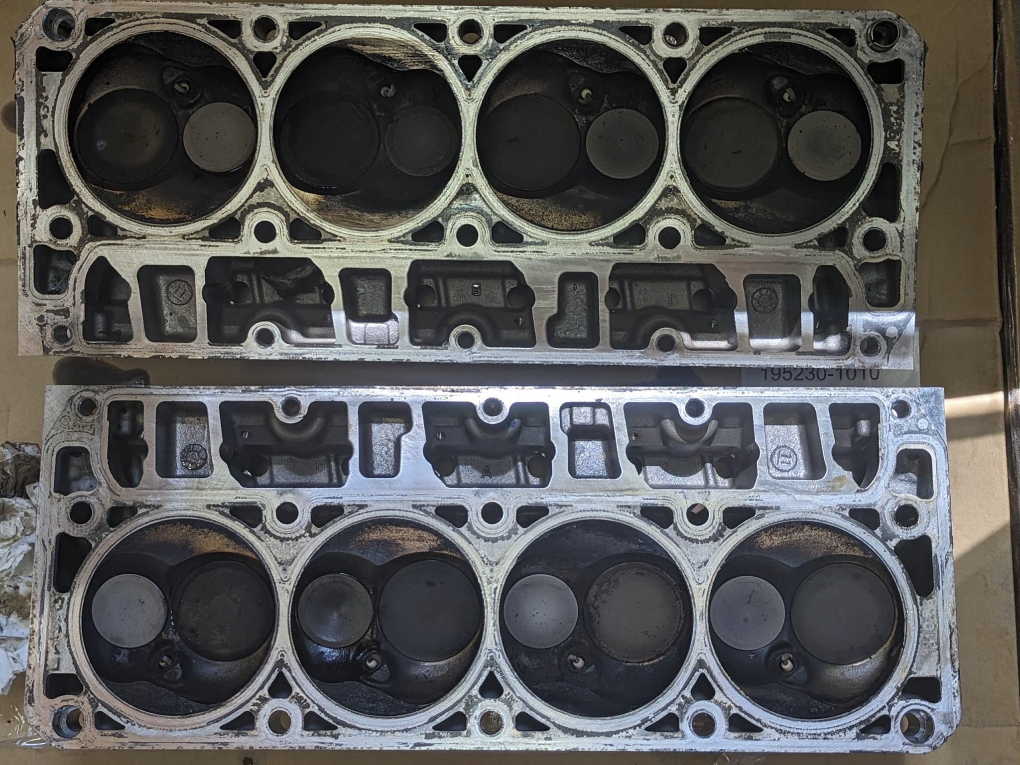

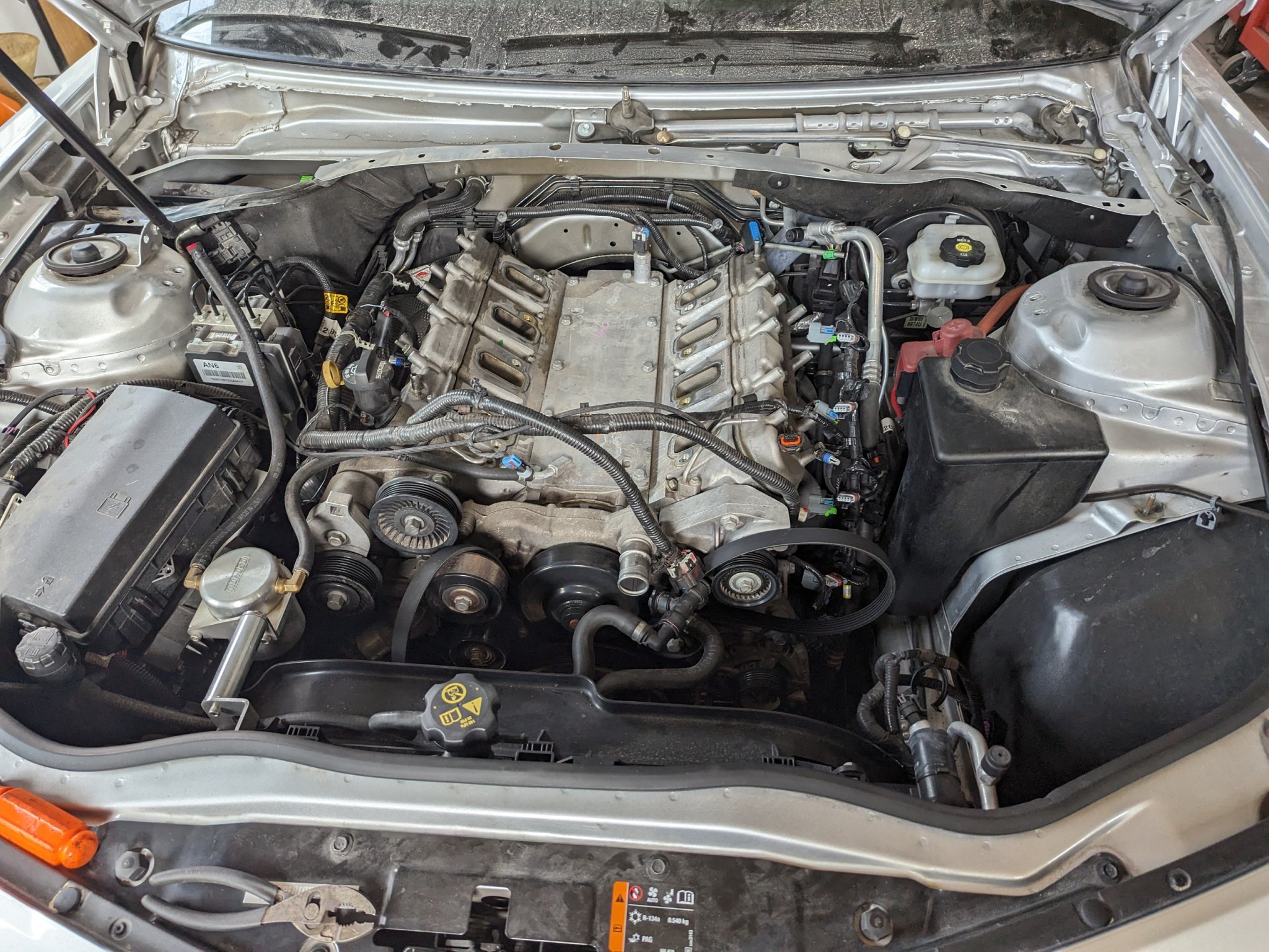

Had to pull the blower off my ZL1 due to a squeaky bearing, and decided that its tendency to burn a lot of oil might mean it's finally time to install a set of new CNC'd LS9 heads that have been sitting on the shelf for a few years. First, my lead tech had to assemble the heads with better valvesprings to accommodate the bigger cam that was installed a while ago:

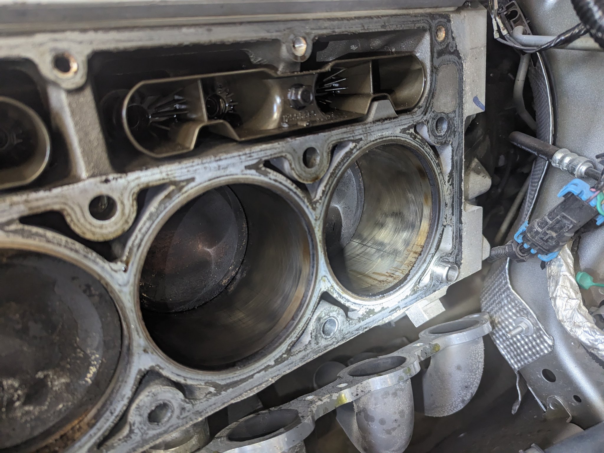

Meanwhile, I got the old blower and heads off to find signs of oil consumption in a few holes and less-than-pristine bores:
These engines are known for valve guide wear when operated well in excess of the factory redline for long periods, which is exactly what I do at the track. Expected and understood.
The bores we'll address with a fresh short block at a later date. Got a spare LSA block that will get dropped off at the machine shop for some forged pistons, stronger rods, and a 4" crank.

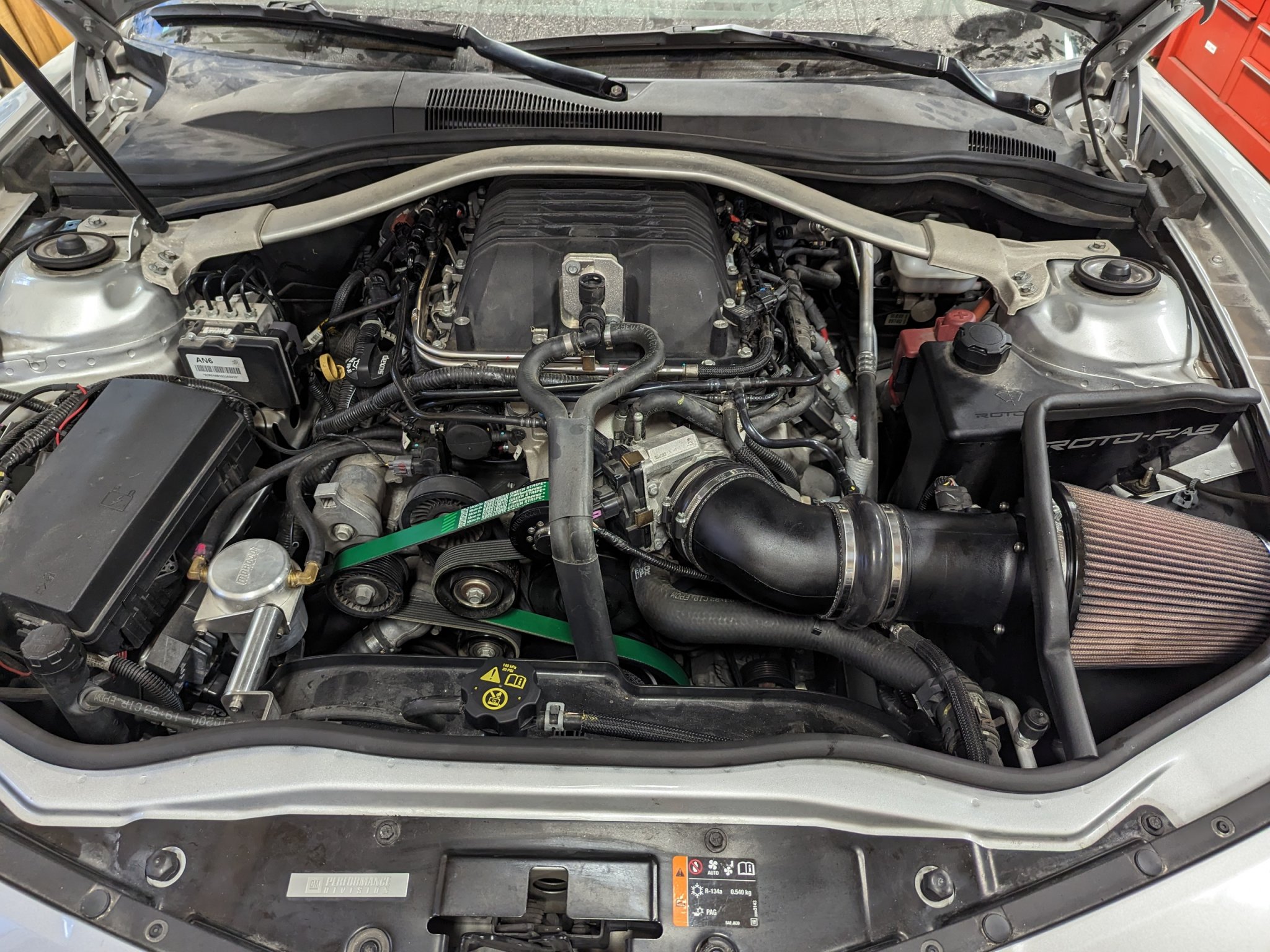

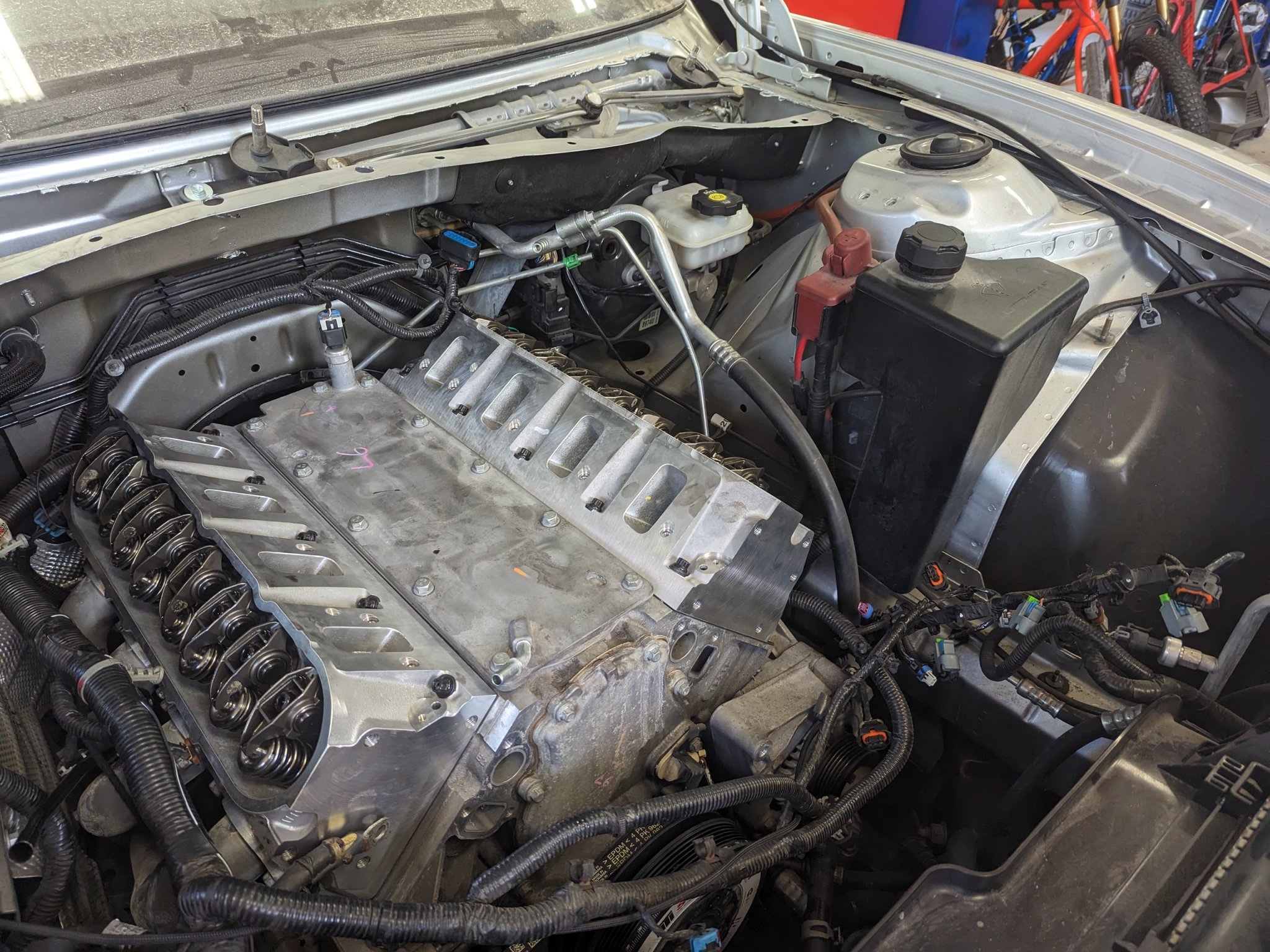

Meanwhile, we've got a rebuilt ported blower and the new heads installed:
It needs a few more little parts installed and fresh fluids. Hoping to hear it fire off tonight, and then we'll start the tuning process. That gets done twice since it's set up for flex fuel.

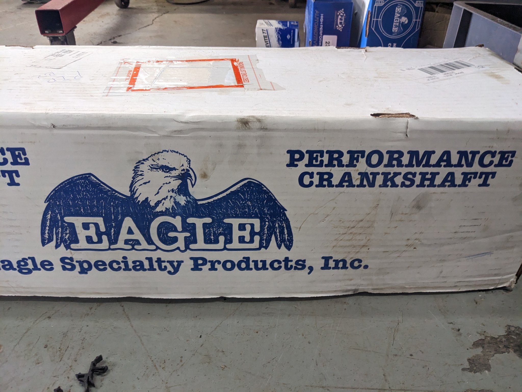

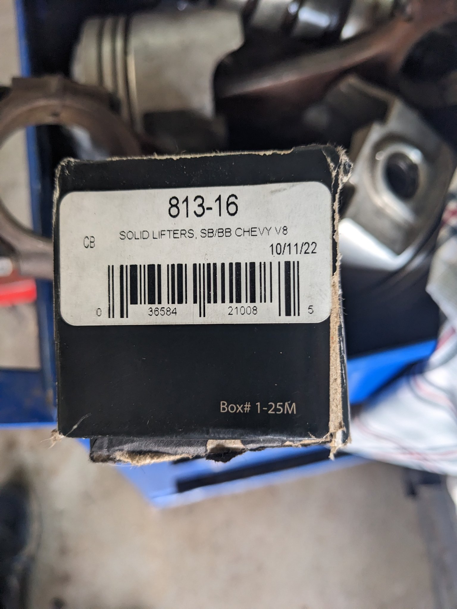

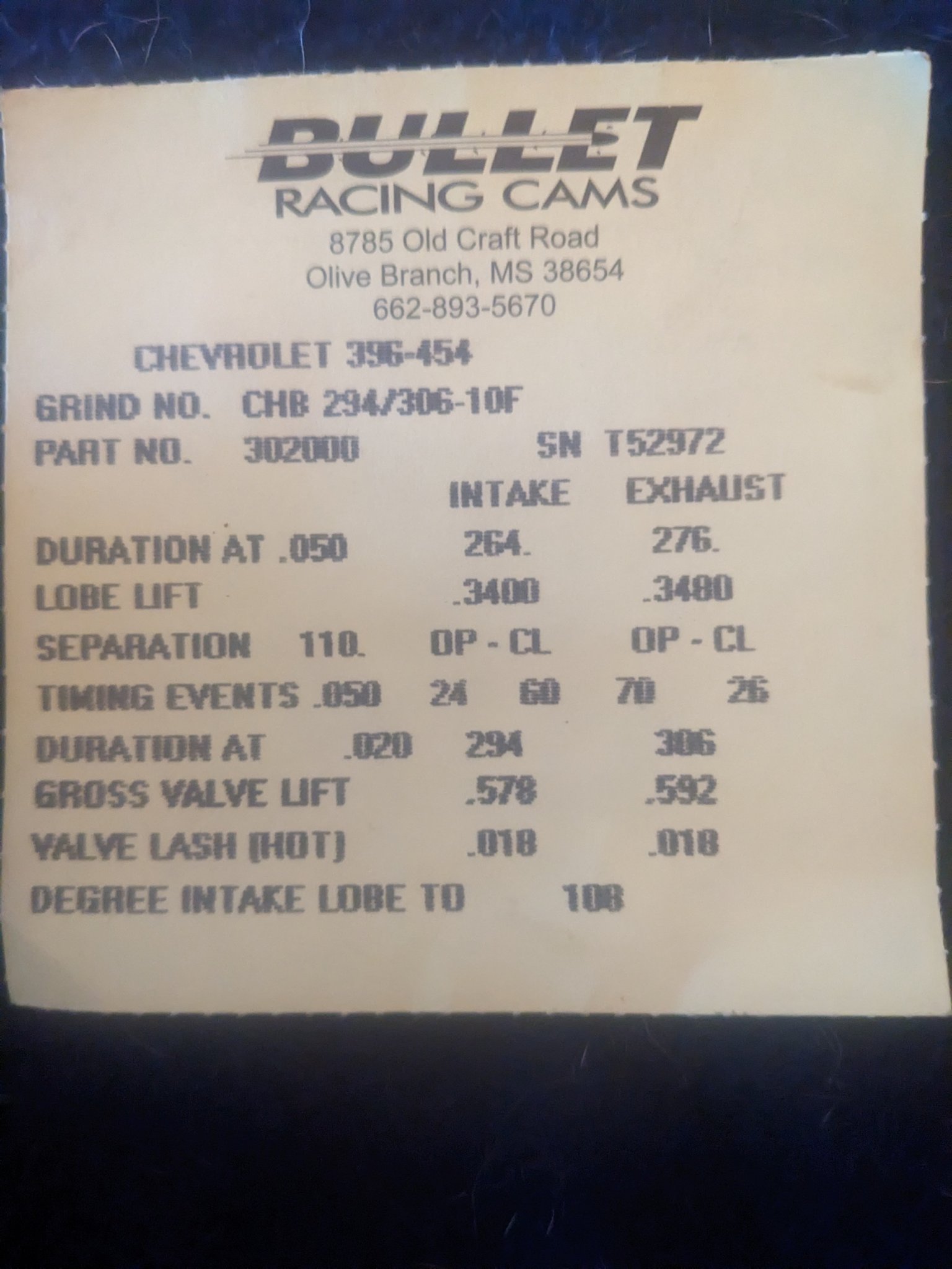

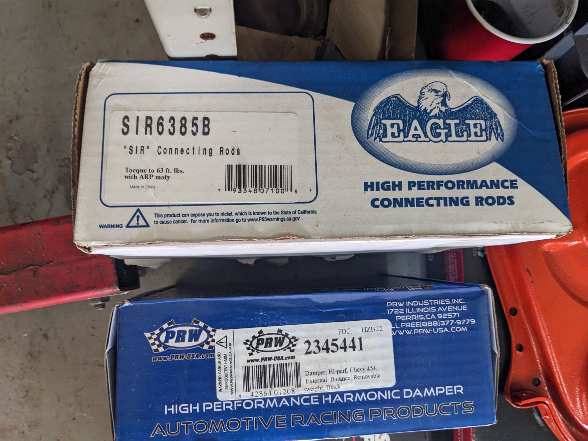

The parts for my 502 keep stacking up.
The heads are waiting for me to find the time to port and polish and I need some time to do some relief work on the cylinders for the rod clearance.
I'm hoping to get around 600 hp or better. That ought to get a Monte Carlo down the road.
I think you can easily get 600hp in a 500 inch big Chevy, but why not a roller cam?
For that duration, you could get more lift.
Or, if you want to stay around .600” lift, you could do it with less duration and still have the power via steeper ramps (more duration at max lift) etc. And better road manners….
I have done a bunch of different motors. This one was just a " wonder what this combo will do?" The great thing about having a hobby. If you don't like it. Change it. If you ain't working on it. It's time for something else.

Lit 'er off for a few seconds this morning AND IT'S WAY LOUDER THAN I REMEMBER. It was at this point I realized that the header intermediate pipe clamps weren't installed :cautious:
The next step will be the multi-day process of filling and bleeding the intercooler loop. It's probably time to get a proper reservoir because this game of tricking in a few ounces into that stupid T-fitting is no fun.
I also found that the coolant overflow bottle developed a crack. Spent a few minutes trying to figure out what hose clamp got overlooked before realizing the source.
