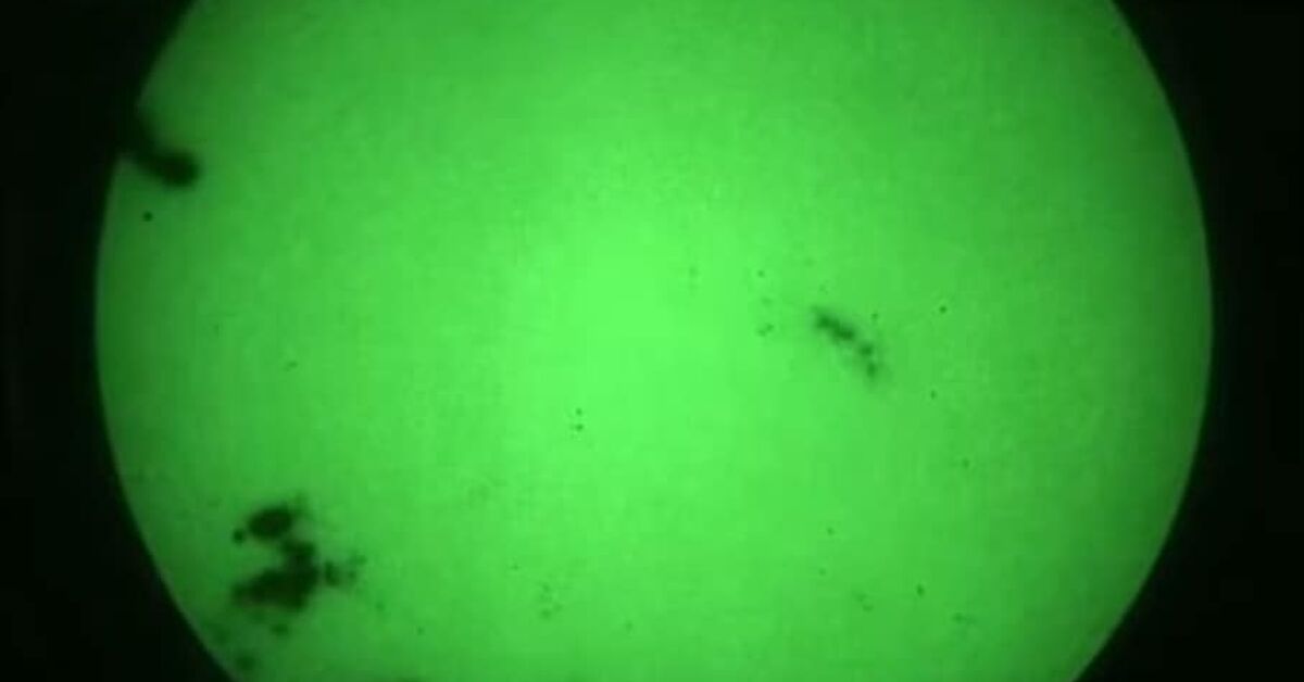

Source: N-Vision
Price Paid: 3300
NOD Model: PVS-14
Tube Model: L3 Filmless, Zone 3 Blem
Halo: 0.8
EBI: 0.9
SN: 32.1
Resolution: 64
FOM: 2054
Purchased Dec 2020. Time to door 1.5 weeks.
Photo in very dark cold storage room. Find the zone 3 blem... it took me awhile when I got the tube lol....
For anyone learning NV specs I suggest checking out Nocturnality's Instagram. They do a good job of talking about specs and then showing comparison examples so you can compare real world spec and tech differences.
