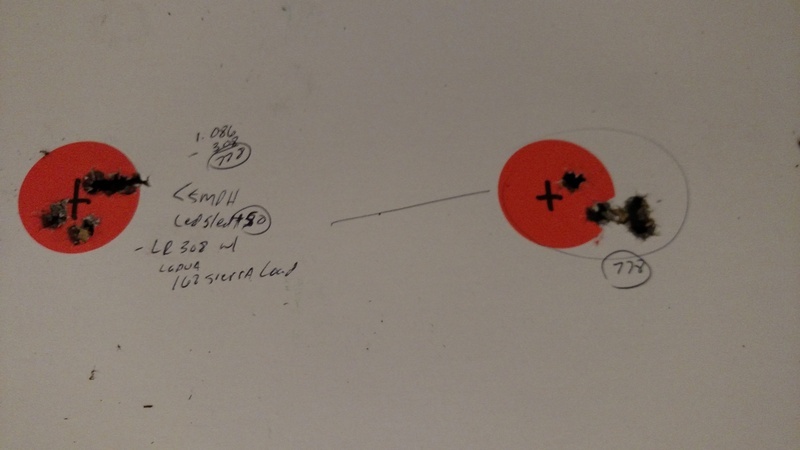

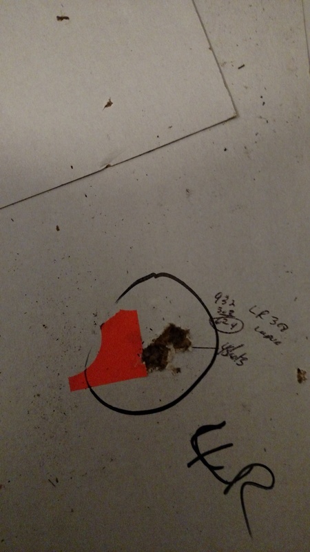

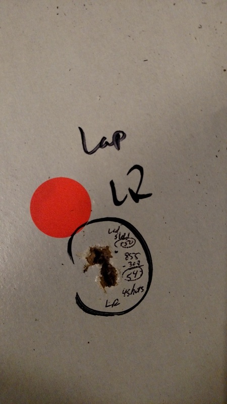

    The single targets are 4 shots each at 100 yds with my stock dpms lr308 24". These were shot all on he same day at 100 yds. These were my only attempts at groups as I was shooting many guns that day. Only upgrade was a spring kit and home done trigger job. I spent a great deal of time fine tuning a load for it but it is a solid .75 moa gun. In the double target, the one on the right was a single hole but my fifth shot was to the left a half inch. I simply choked. Say what u will about dpms but I am happy with mine. Plan to upgrade trigger in the future. This load is Varget with 168 Sierra match bullet.

    3/4 MOA (consistently, as in every time) is pretty excellent for a gas gun shooting factory ammo.
    Most people posting about their quarter-minute gas guns online can't actually do it consistently.
