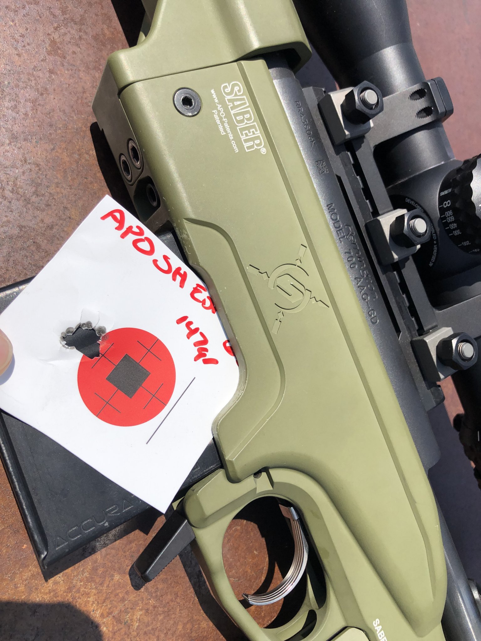

    i used Hornady eld - m ammo out of my Sako trg. Consistently shot .25-.5” groups at 100. With that being said, my hand loads far outperform the factory ammo.

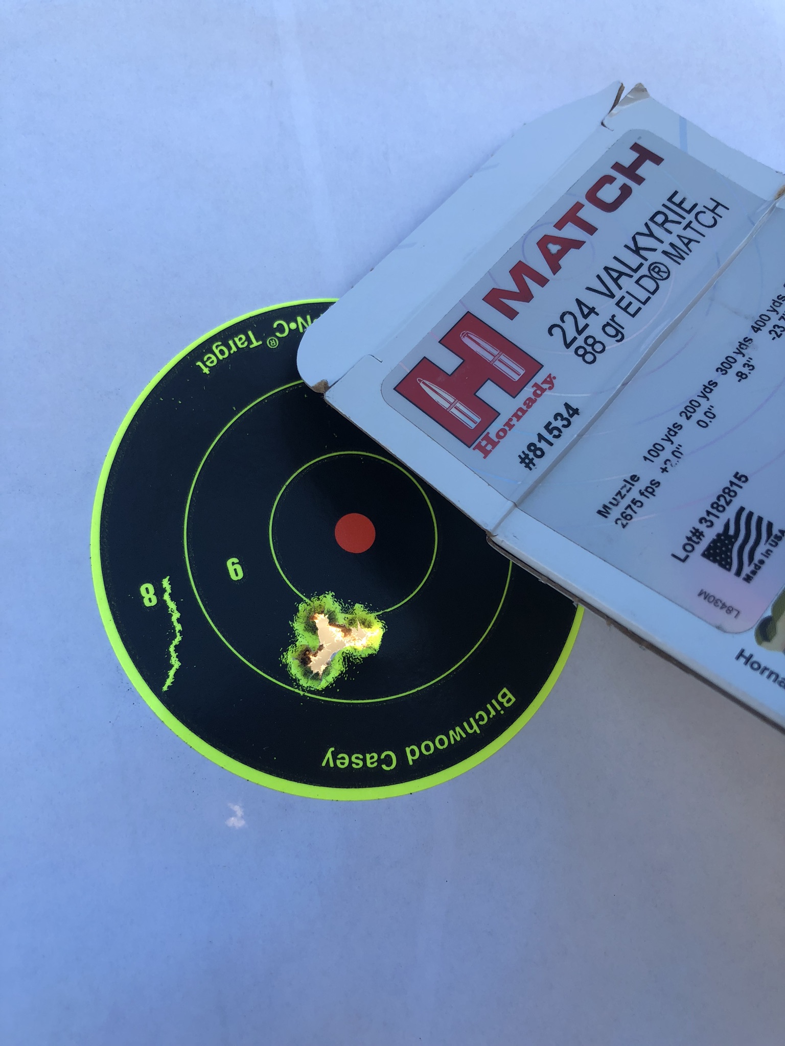

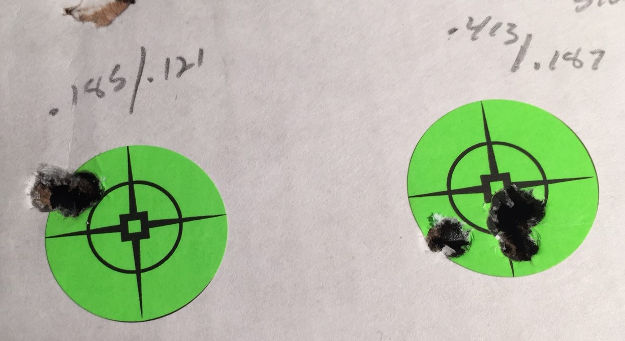

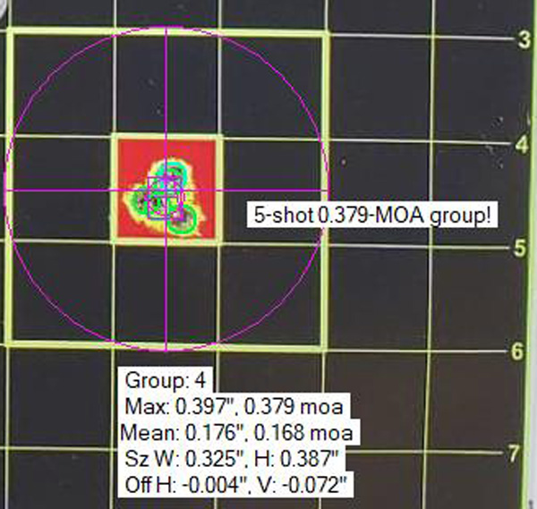

    These two were done with Black Hills 77gr Match (blue box) with my SRS A1, SAC 223 conversion:
    Reactions: MysizeisMAGNUM

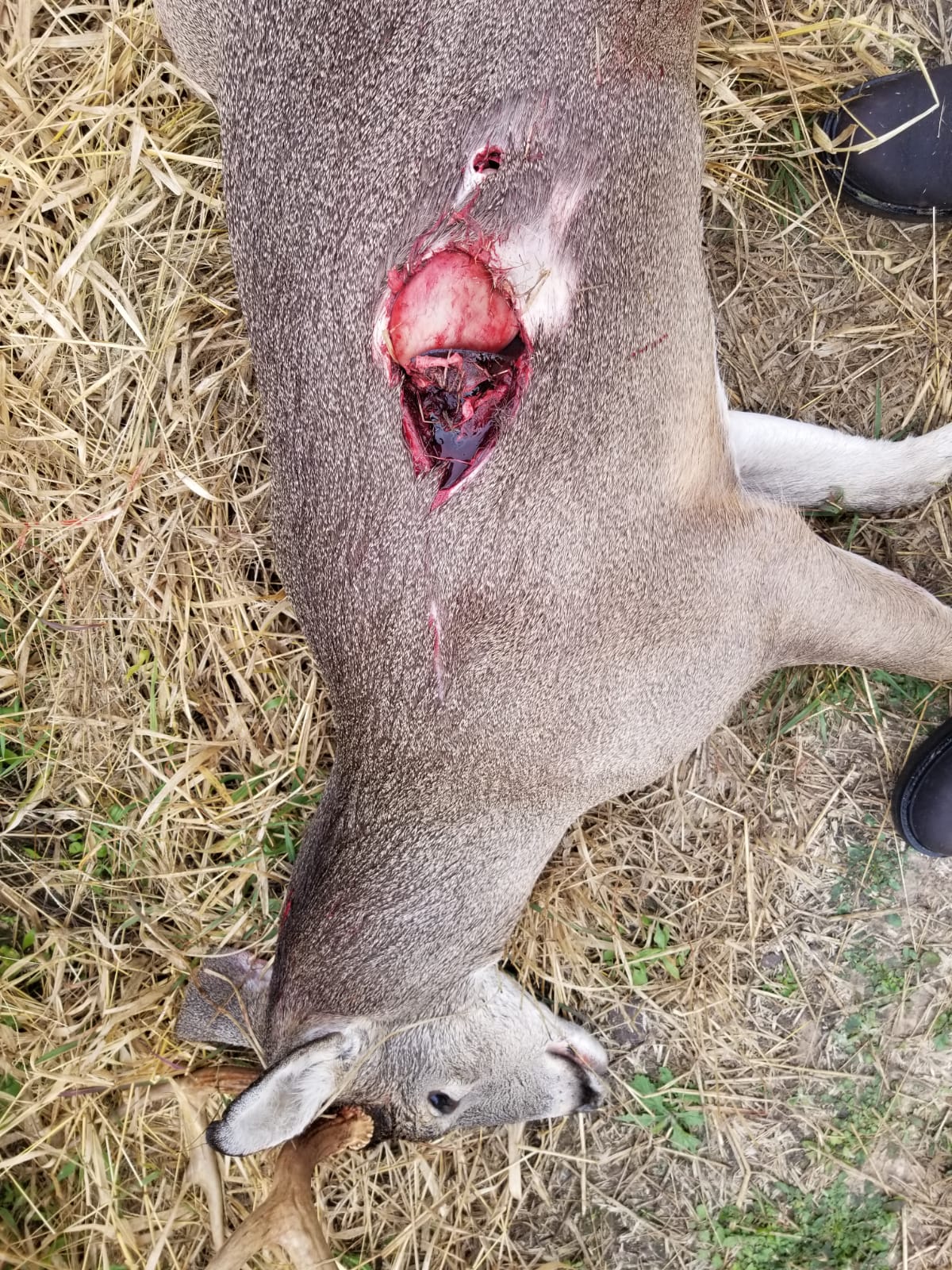

    I've seen really nasty results on deer which I would like to avoid. That was my main concern. Penciling through, pancaking, and blowing up like hell are some of them. I brought back the match bullet kills thread just so I can see what others have used with success. Little by little I'm seeing people have success with prime and Berger. Those two are options I am very likely to explore very soon.
    The attached is .27 cal 145 grain ELDX bullet kill, something I did not like!
    It's designed as a hunting bullet and therefore I must assume it's supposed to stay intact for the most part and retain itself. I did not kill that deer and I have no way of knowing where it was shot. I agree the shooter did a poor job of knowing where his impact was at because he could not tell me for sure.

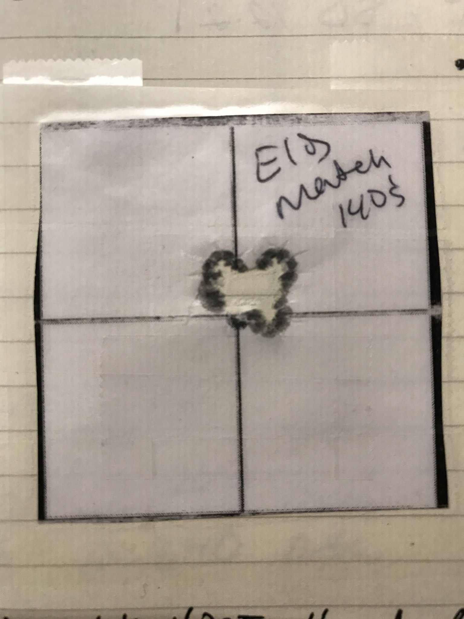

    ELD-X and ELD-M 143 and 147 grains 6.5 Creedmoor both shot under .5". Can I shoot better than 1/2"? probably not... do I want too? probably not? will my rifle shoot better than .5"? yes, I am sure of it. I don't myself personally buying reloading equipment just to get 1/4' groups personally while this is fun I like to devote my time to other venues as well.

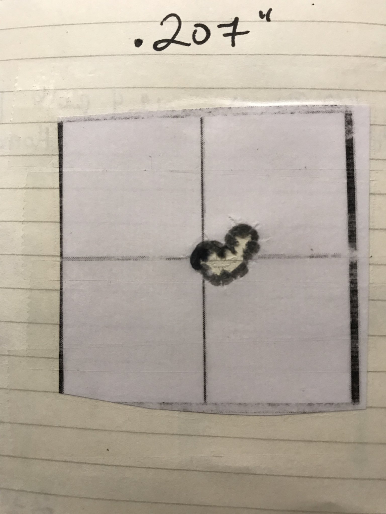

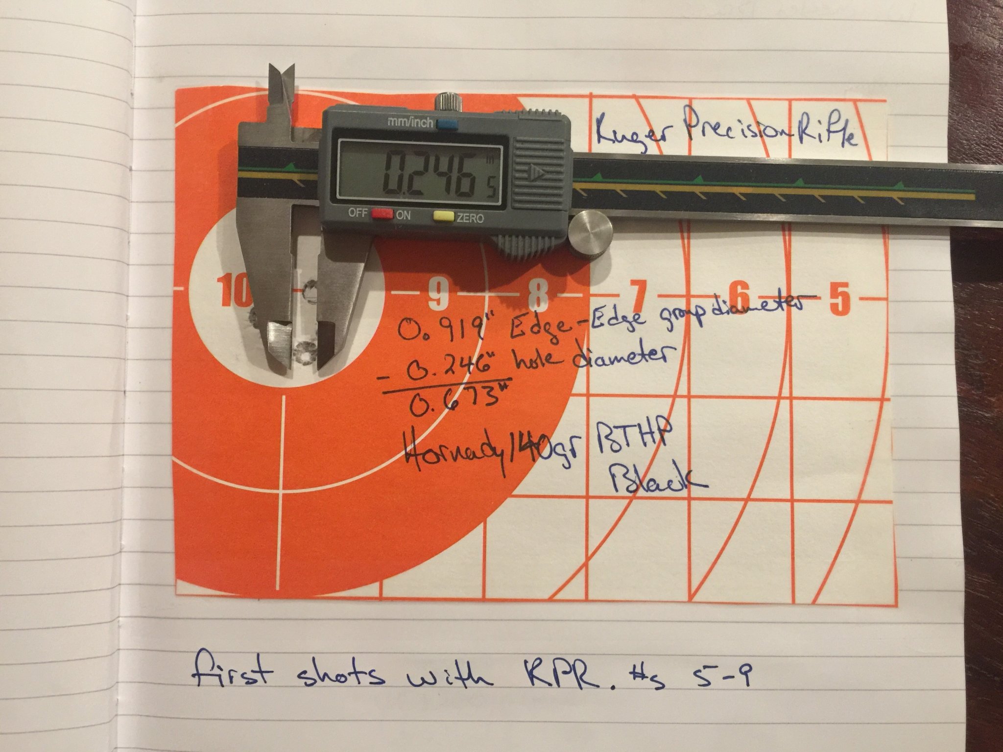

    These are the first 9 shots out of my 6.5 creedmoor Ruger precision rifle, with Hornady black 143 bthp. 5 shots to find the center of the target, then 4 more for a 5 shot group. Hornady match shoots better, and my hand loads are a bit better still. You can be very successful with factory ammunition.

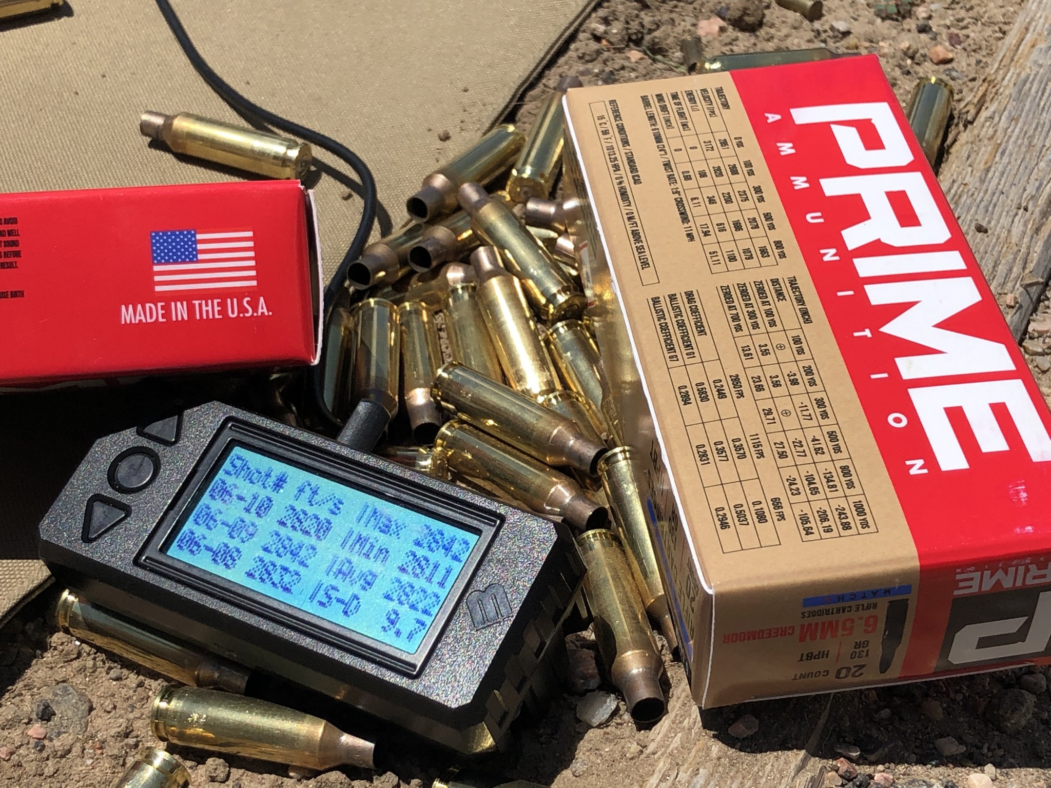

    On a somewhat related question, how often can we expect factory ammo to deliver consistent single/near-single digit SD’s?

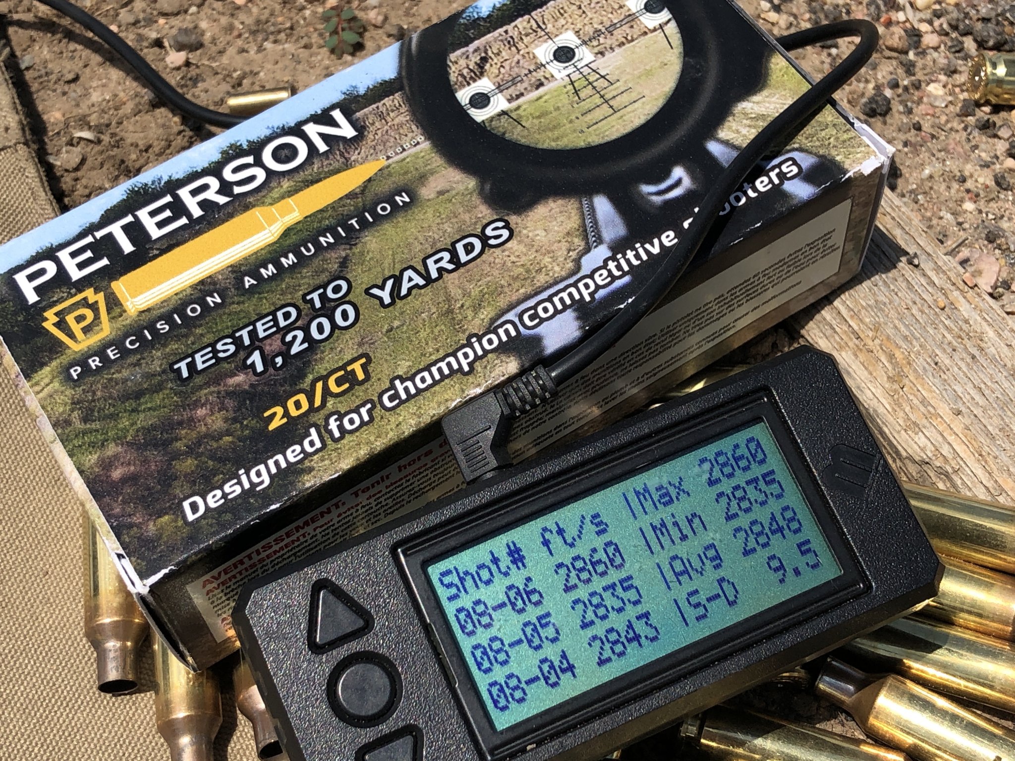

    I’ve shot my 224 Valkyrie a bunch and I have chrono’d it a number of times in various conditions and I’ve seen SD’s fluctuate. For example, on rare occasions factory 88 ELD will produce a 5 shot single digit SD string. Mostly SD will be 12-24. There doesn’t seem to be a temperature where the ammo has better numbers.
    Also, Federal 78 TSX from 20” barrel was 2835 with an SD of 21.

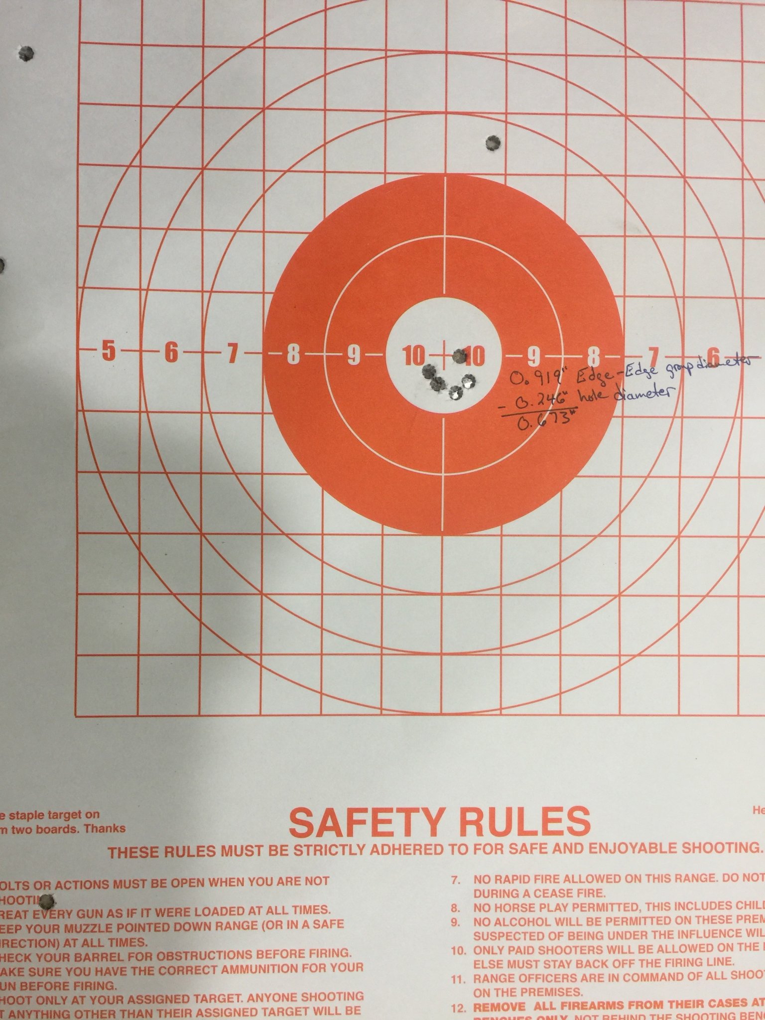

    These are the first 9 shots out of my 6.5 creedmoor Ruger precision rifle, with Hornady black 143 bthp. 5 shots to find the center of the target, then 4 more for a 5 shot group. Hornady match shoots better, and my hand loads are a bit better still. You can be very successful with factory ammunition.View attachment 7192088

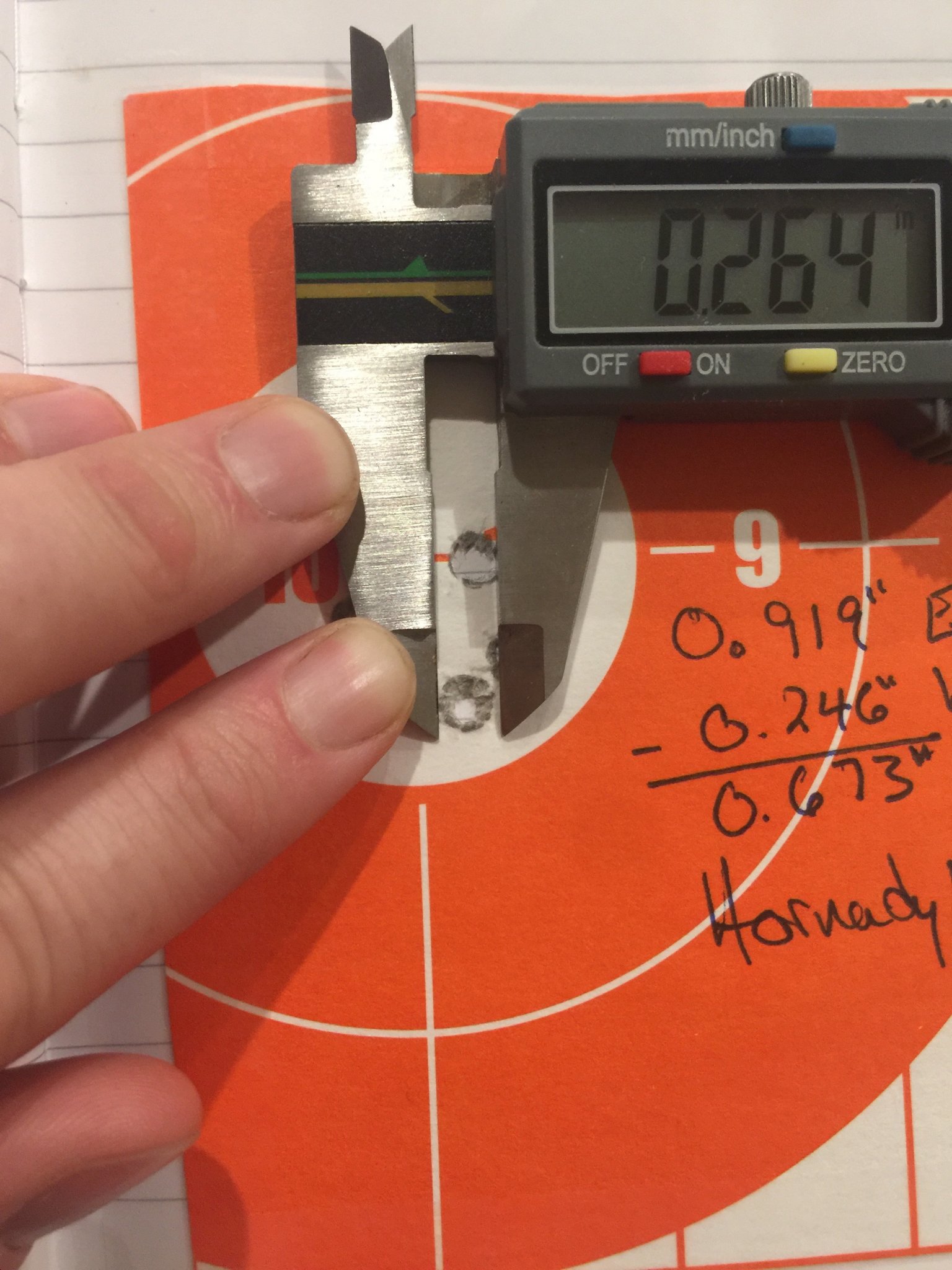

    Math. It's .264 not .246
    I've used ELDM and ELDX 6.5 factory loads to 900 on steel and 450 on animals. They shoot very similar (not enough to matter) at any given range. I don't have the time to chase these loads and I use them primarily for hunting and steel, so factory stuff that shoots is good enough for me. I use Berger hybrids (Fedearal factory) in my .308s and Tikka 300WM. They flat out shoot. Threads like this makes me wonder how many good rifles I've sold over the years because I couldn't get less than 1" groups out of them with factory ammo.
    Observations. They're not difficult. The hole cut by a bullet in a paper target is smaller than the bullet diameter. This is not super secret squirrel stuff. In this case, the hole diameter is 0.246 inch.
    So you're bullet shrunk while in flight. Got it. Unless you used inside mics on that hole, whatever.....
    I didn't get a very good angle on this picture. Hopefully you can see it better on the next.
    I hope it is clear that there is an obvious gap between the mark left by the bullet and the edge of the caliper.
    According to my reloading log...
    0.177 caliber bullets leave a ~0.170" mark
    0.224 caliber bullets leave a ~0.217" mark
    0.264 caliber bullets leave a ~0.246" mark
    0.277 caliber bullets leave a ~0.267" mark
    0.284 caliber bullets leave a ~0.277" mark
    0.308 caliber bullets leave a ~0.285" mark
    I use the ~ because there is a few thou on either end of the numbers listed above. Yes, I measure all of the marks, not just one or a few.

    "A 22 caliber bullet will print between 0.215" and 0.219."
    Them 22 caliber bullets must be shrinking too. Or, bullets make sub-caliber marks on paper. This is not secret knowledge. The paper used probably has some amount of effect on the size of the mark, and the paper used for "official targets" is specified in the rule book as well. Maybe the marks left by bullets on the paper used for YOUR targets are full caliber, but I doubt it. I challenge you to challenge your assumptions and put a caliper on the actual marks, instead of assuming. But, whatever, democrats are afraid of facts and actual observables. ;)
    ^^^^^ OK....
    So, that's a difference of 0.018-inches, which comes to a 0.0172-MOA disparity at 100 yards.
    I say... "close enough." :)
    “Close enough” in a thread titled “How accurate is accurate?” That’s irony. But yeah, 18 thou is the difference between glazing past a post and stopping to make a snarky- though ultimately uninformed- comment.
    Looks dead to me and just some rib meat loss. I don’t know how much more you’d want. If you want more bullet retention use a bonded bullet, but know it will be at the expense of BC. It’s the price you pay when you add terminal ballistics into the equation.

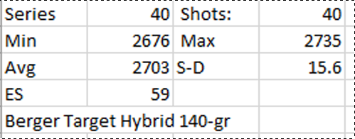

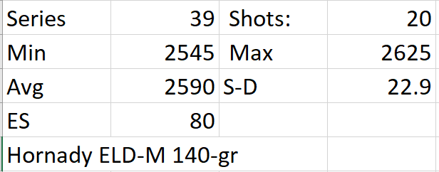

    Here is my chrono data (MagnetoSpeed V3) for the Berger Target Hybrid 140 factory ammo. Mind you, this is through the original RPR barrel at about 3,000 rounds through it at this point (back in September). Also... I chrono'ed 40 shots.
    Same day, right before the Bergers, I chrono'ed 20 shots with the factory Hornady ELD-M 140-gr:
    Reactions: stello1001
    My last post brought a question to mind.... When you guys chrono your ammo, whether it be factory or custom-loaded, how many shots do you consider proper (or minimum) to give you a valid SD and ES? Sort of like groups... the "standard" is a 5-shot group. "Three shot groups mean nothing!" ;)
    How many shots in a chrono'ed series are considered to give "valid," usable, or "believable" SD and ES numbers?

    I forget exactly but it's something like 35-40 samples to get a confidence interval high enough to have statistically relevant info....
    That said, I have switched to 10-shot groups for both Chrono and group size info to give useful info for realistic hit probability. I'll often shoot 10 for a good zero angle (4dof) then Chrono the whole day on a lab radar (30-100 shots).
    It's important, even with "temp stable" powders to monitor MV vs. temp because it will change day to day.
