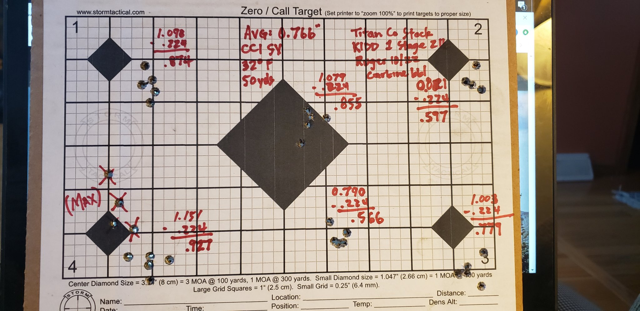

Good afternoon,
This was shot yesterday with a 10/22 carbine barrel and receiver in a Titan Co stock and Kidd single stage 2# trigger at 50 yards with CCI SV. I'm sure the Green Mountain barrel will do much better. I am building this for when my kiddo gets old enough and the original mag release where you had to dig into the stock and try and release the mag I felt was an accident waiting to happen. The Kidd trigger group fixed that with a better mag release. I plan on ordering a Kidd Ultralight weight barrel soon too.

Wow that’s not bad at all! I thought a factory barrel would be somewhere around 1.5 moa at best. Good shooting!

Thanks for the compliment! Average for the 6 groups was .766" at 50 yards so it is around 1.5 MOA. Temp was 32F with switching light gusts, very tricky to catch the right wind. The lower left group the wind got me twice, once in both directions. The lower right group's two fliers were me rushing shots to get the right wind break and slapped the trigger. The upper right group looks like 4 holes but I SWEAR there's a fifth one there. The back of the backer board one of the exit holes is just a bit bigger than the rest, so... maybe that's it. I'm still ordering the Kidd barrel just because, and it will be threaded.

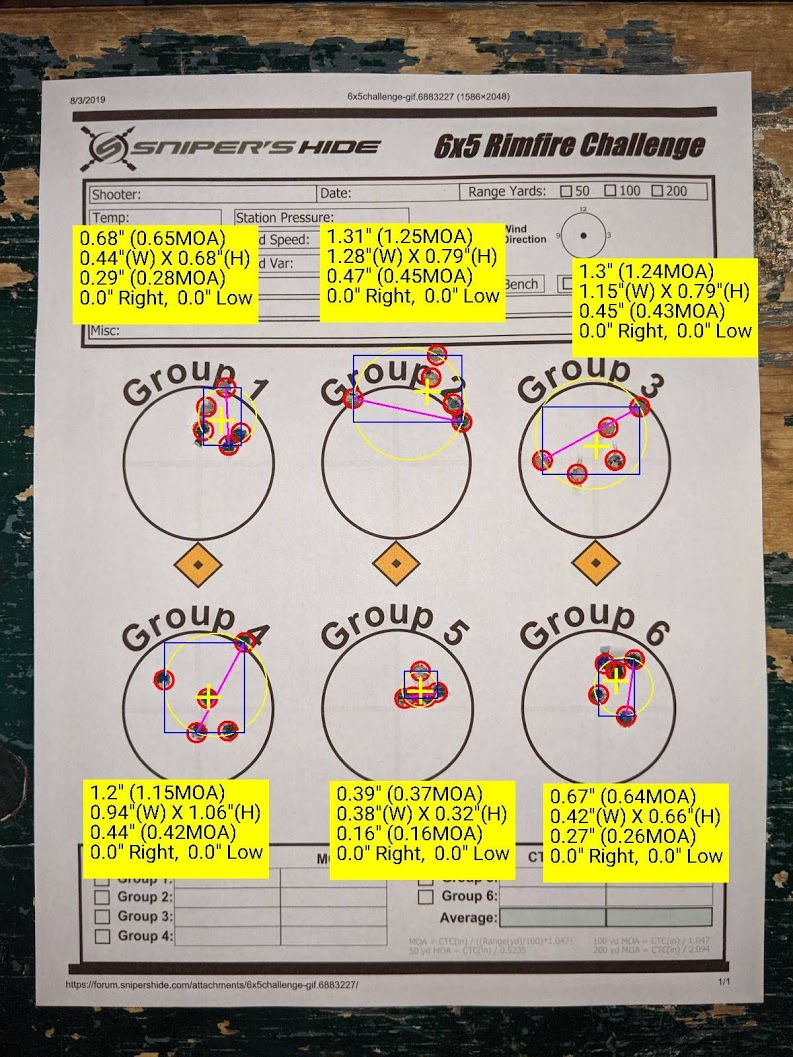

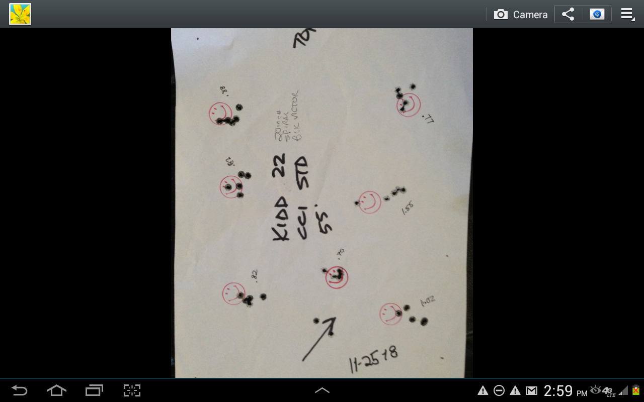

100 yards cci standard velocity kidd 20 inch victor stock, brimstone trigger s+b pm 2 5x25.Shoots much better with lapua center x will post pics when I get home the new case should be there when I get home.

That’s still impressive for factory barrel! Thanks!

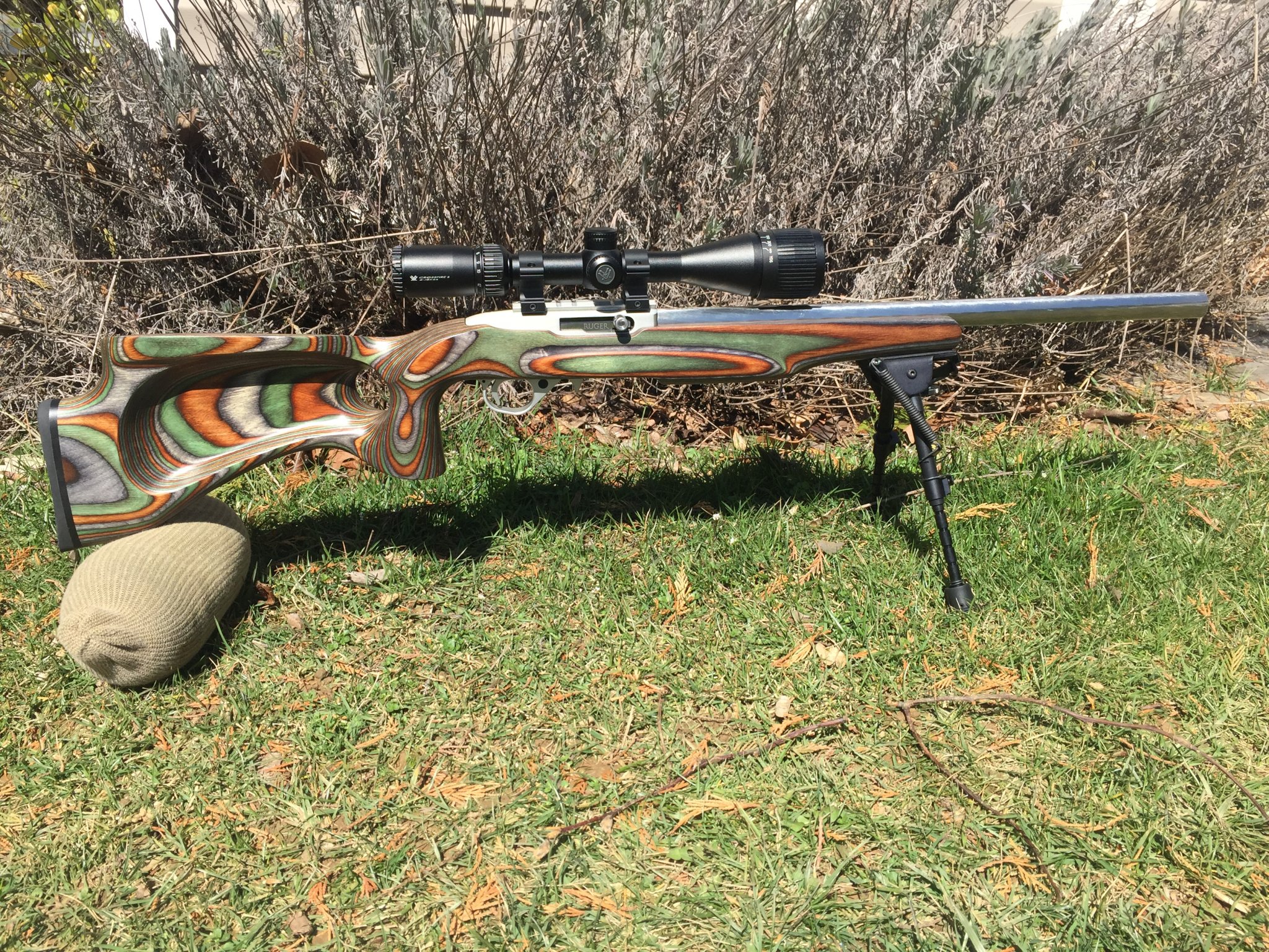

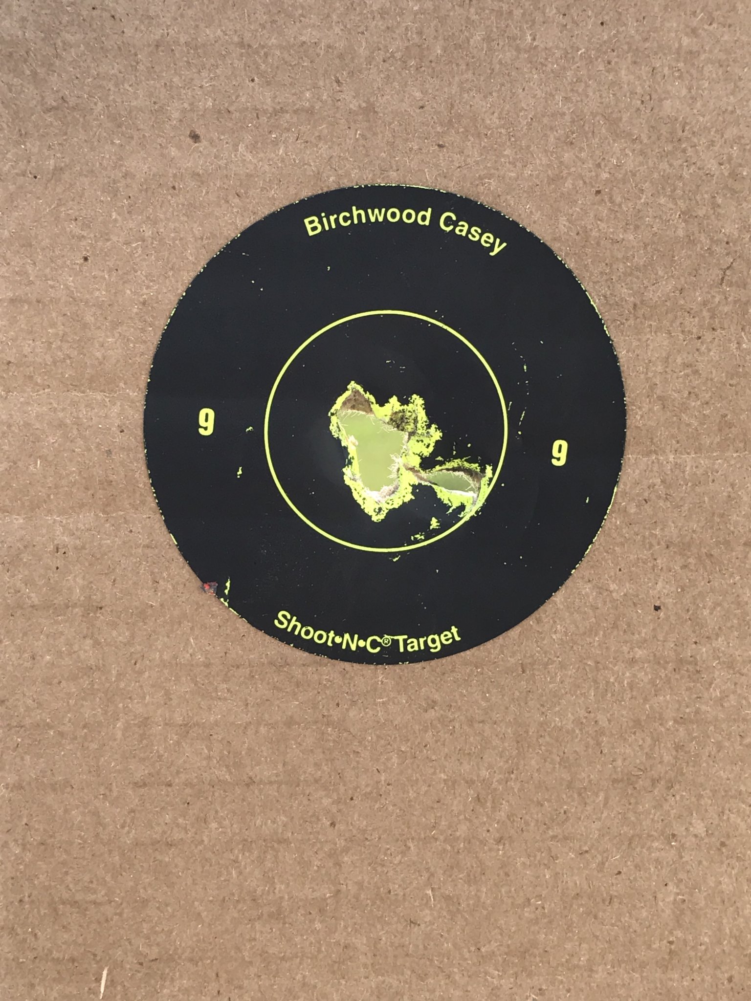

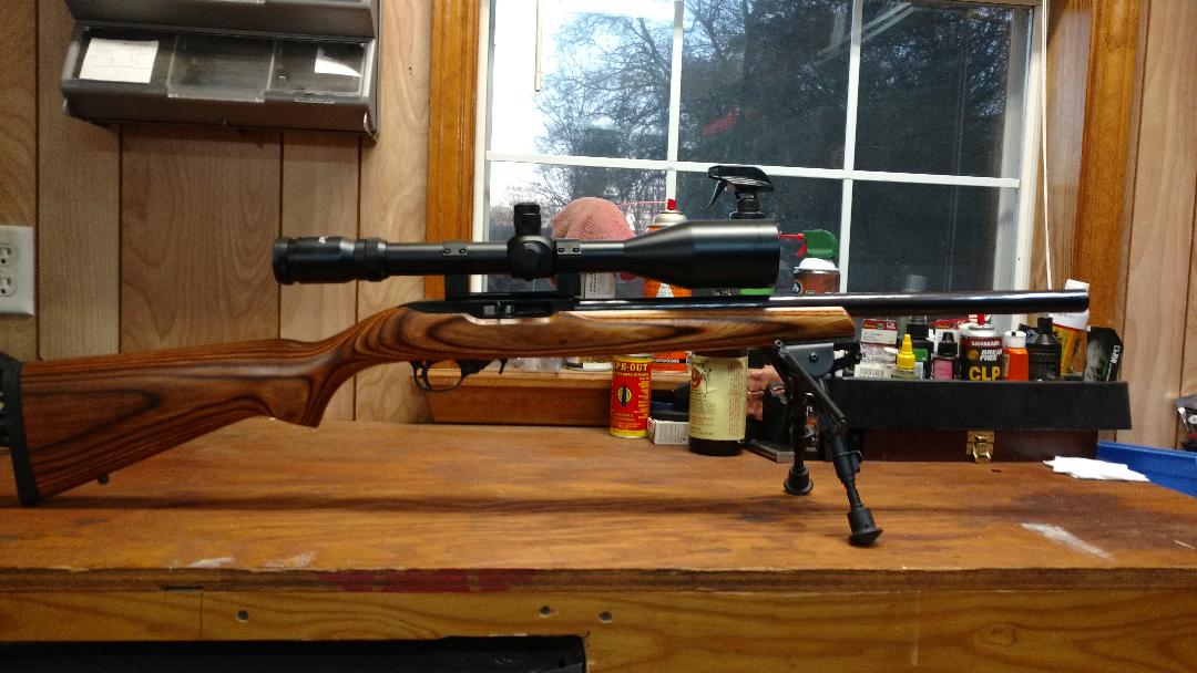

I picked up a Ruger 10-22 maybe 15 years ago. Used gun from a fellow in south Texas. It has a stock heavy profile barrel and a nice stock. Had a cheap Tasco scope on it and got it for a little less then $400. I know it seemed high but I thought it was in real nice shape. Turned out to be a tack driver with Wolf match target. I shot these groups about three weeks ago researching ammo.
I probably just lucked into a good rifle but I am a believer in the little 10-22.
PS groups are shot at 50yrds

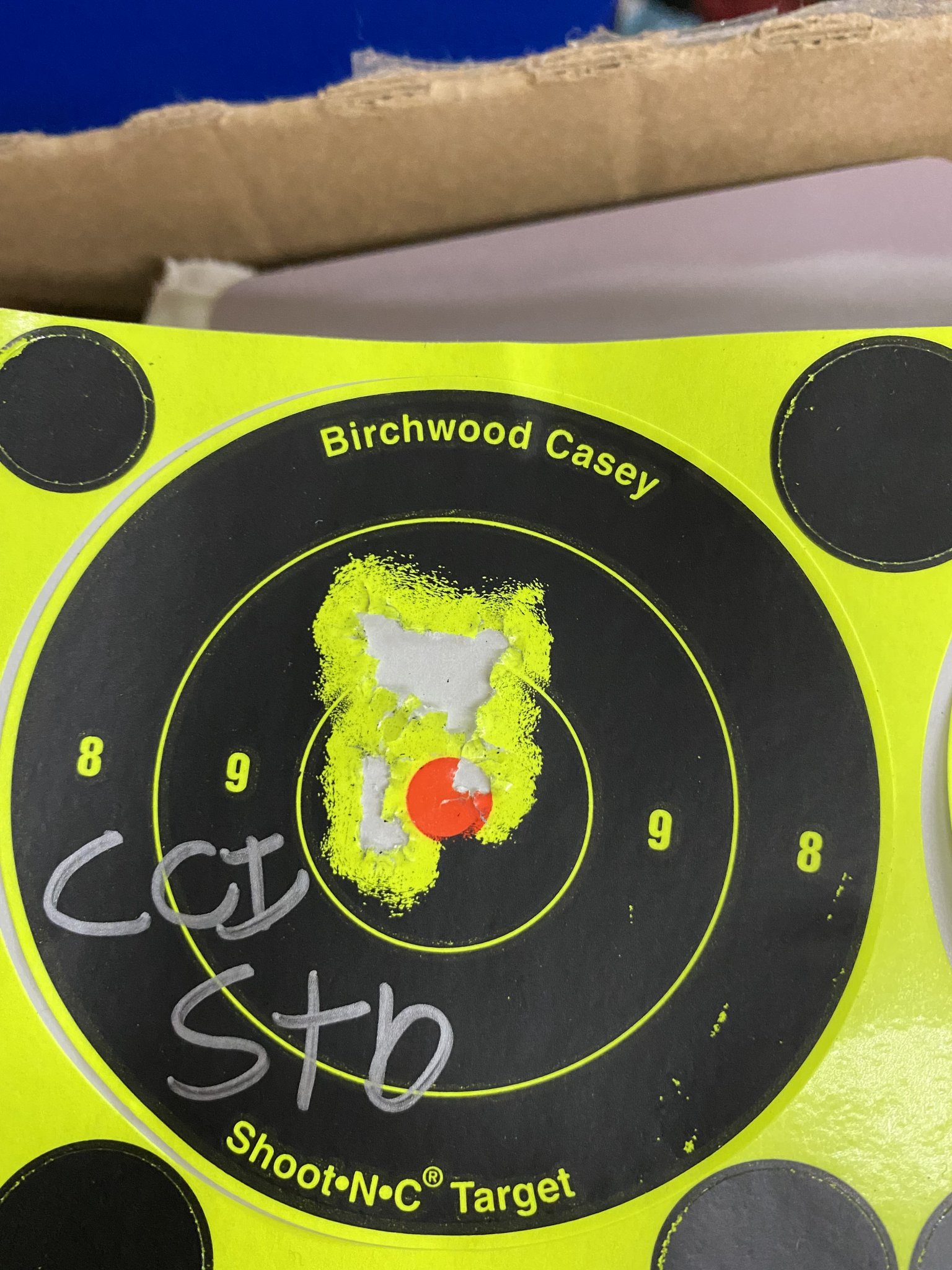

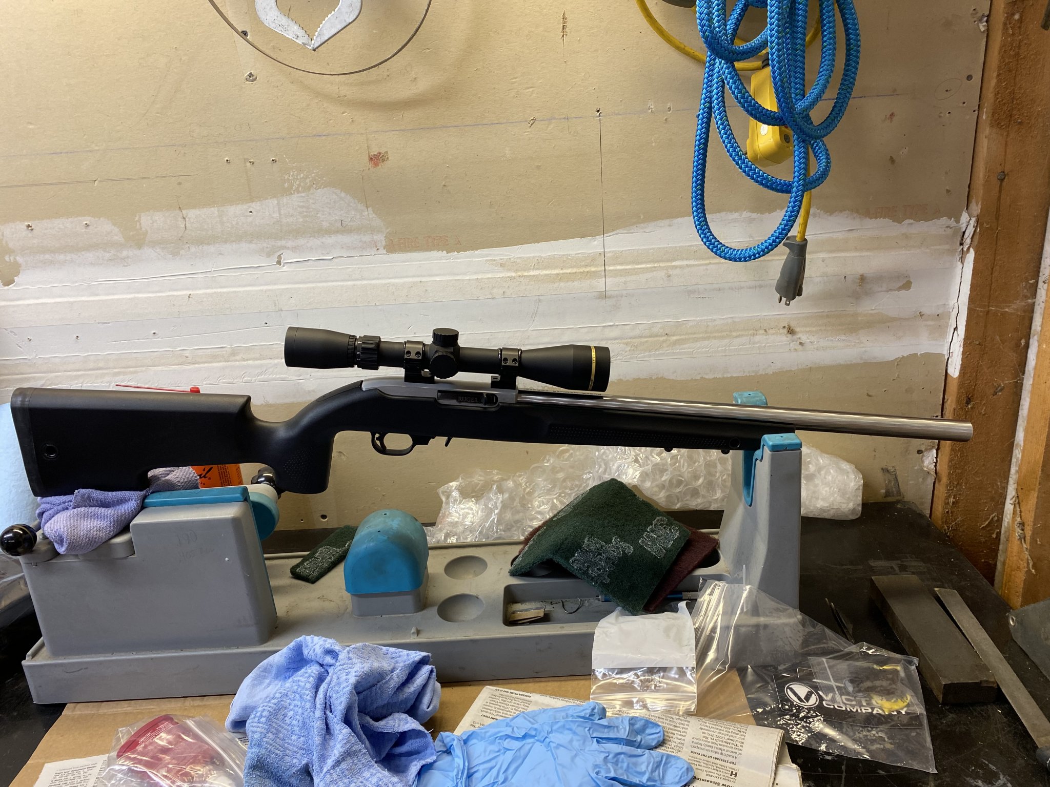

Out of the box at 100 yards. This was done back last August when I first got it. It shoots better now, and I can consistently hold it under an inch at 100 yards.
Brownells receiver, Kidd innovations trigger, Fj fedderson barrel. Magpul shit stock. Knockoff atlas bipod. Cci suppressor ammo, bushnell engage scope

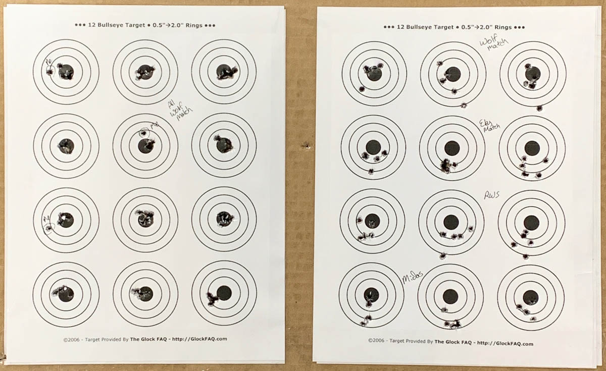

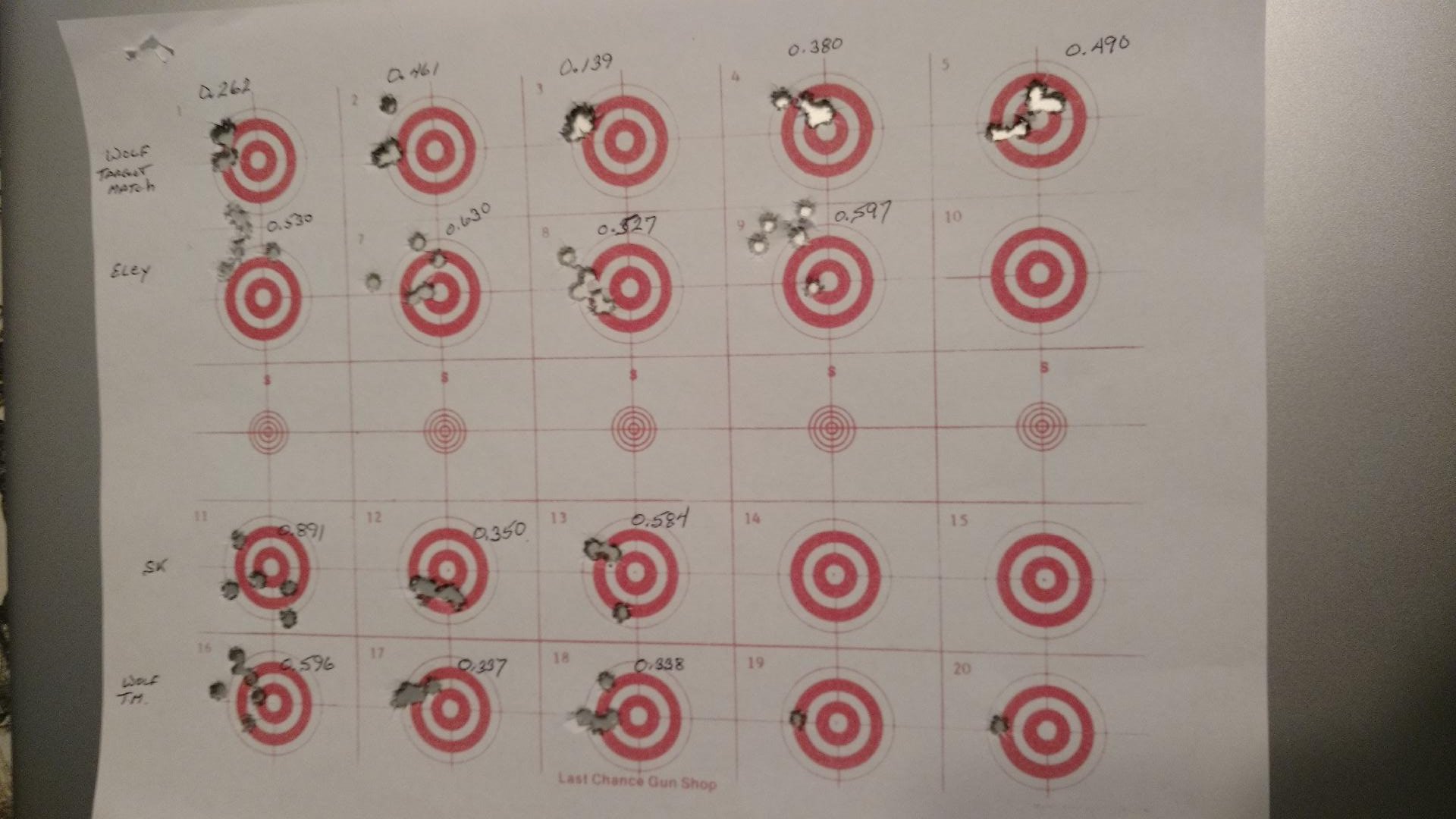

I have an old volquartsen Deluxe that shoots pretty well, I typically just shoot it with wolf match as I don't gain much with higher dollar stuff out of it, at least not enough to shoot the higher $ stuff much.
Here's some recent 5 round groups at 50 with wolf match on the left target, not throwing the first hand charged round into the dirt as some do with 10/22's. There was a couple bad shots on my part and also some left/right breeze, I was not bearing down too hard watching the wind, just trying to shoot and A -vs- B with the gun that shot the very disappointing right target (JP barrel/bolt kit).
One thing I've found is that the ammo that shoots the best groups at 50, might not at 100.

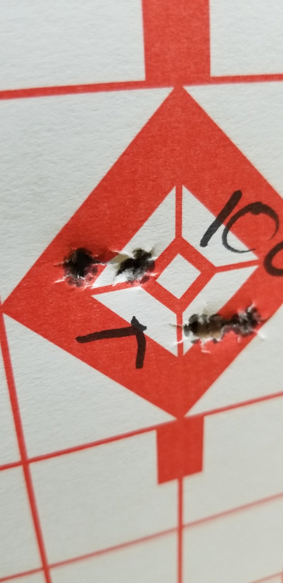

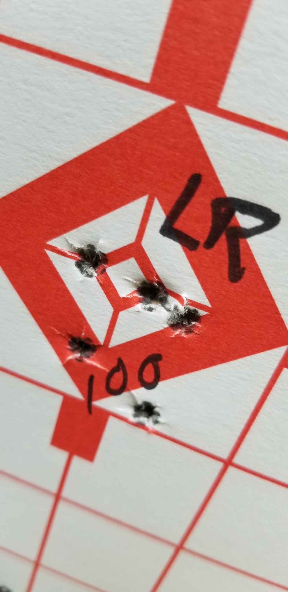

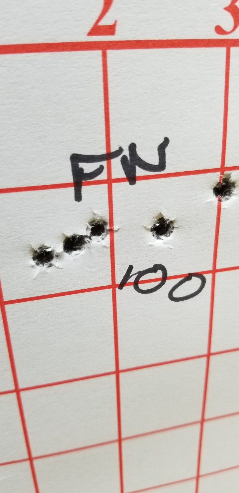

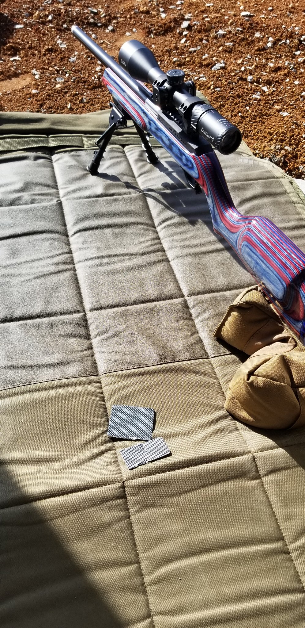

My 10/22 shoots just as good or better than my Tikka but for some reason I don't shoot it very often.
20" Shilen barrel
Power Custom Match bolt
Kidd charging spring and handle
Brownells receiver
Volquartsen trigger group
Tony Mele Avenger stock
Cabela's covenant 4 scope
Here are few 100 yard 5 shot groups with Center X, SK flatnose match and long range match.

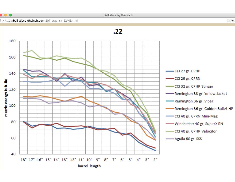

Has anyone seen any improvement on barrel length past 16 inches on these 10/22 rifles, or is the 22lr just slowing down at that point like people say
Per Vudoo, they noticed no significant difference between velocity and accuracy from a 16 to a 20 inch barrel. They said it is more a matter of preference.
I don't see why it would be any different for a 10/22.
I have a 20" KIDD and an 18" GM. On my target faces, I could not tell one from the other.
.22 lr uses all it's energy long before 16" and you'll begin to lose speed with longer barrels. There also seems to be no accuracy improvements beyond 20". The .22 is also very slow, relatively, and the dwell time in longer barrels may affect accuracy negatively from user input while the bullet is still in the barrel.

Here ya go.

I had a 10-22 sitting around. Kidd trigger and barrel put it in a Boyd’s Pro varmit. Had CPC do the bolt. Cost added up quick shoots lights out but was close to a full Kidd build Look for a used 10-22 basket case. Have Randy at CPC to make the guts right (trigger headspace and bolt) put a Federson barrel on it and cut the stock to fit him. Make it a project you guys can do together. Till you buy a Brownells receiver pay shipping and transfer still have to get all the parts price will put you very close to a full custom. The factory bolt is about the same price as a Kidd bolt.
I second the CPC tune, Randy makes 10/22’s shoot bugholes for cheap too. https://www.ct-precision.com/ Mine is a bone stock target model with just a full tuneup and it has impressed a lot of people. The action is so smooth now my 6yr old can run the bolt. Eley Target and Force 5 shots at 50yrds. No cherry picking I just shot group after group. 10shots at 50yrds CCI standard. The KRG Bravo has a really short length of pull. I like the Victor Titan I bought it’s very ridged.

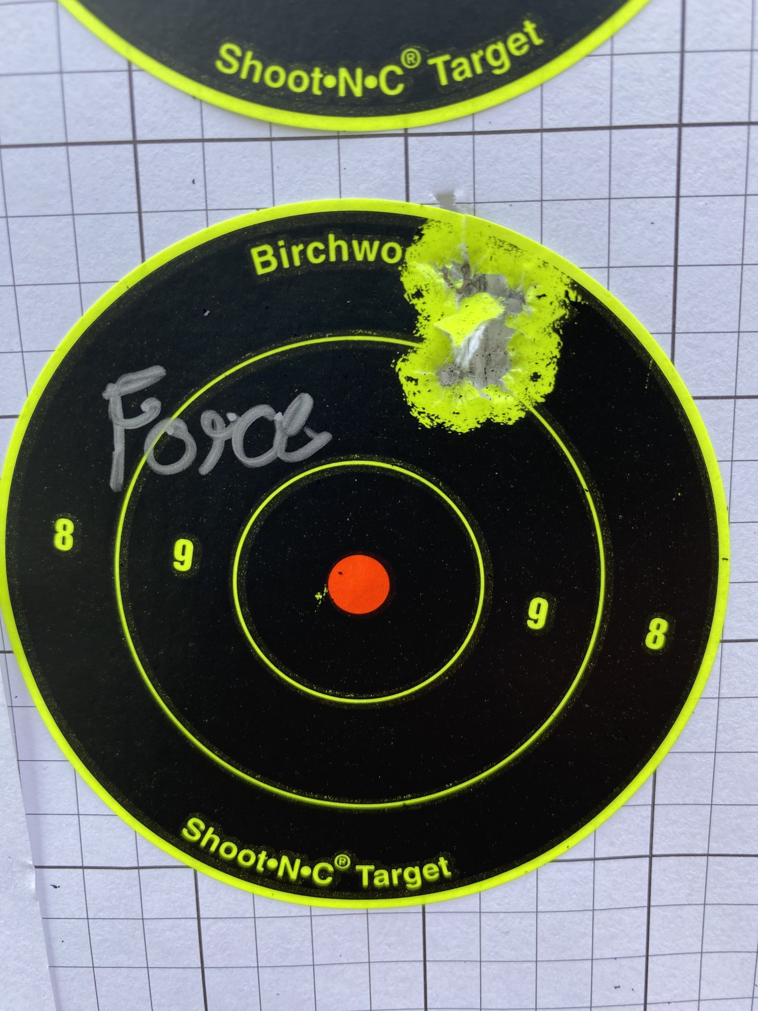

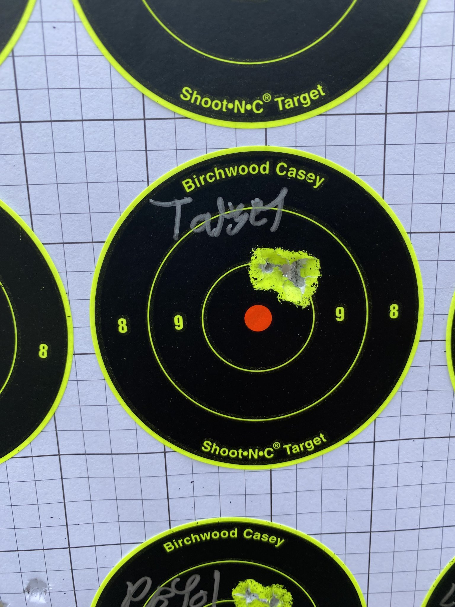

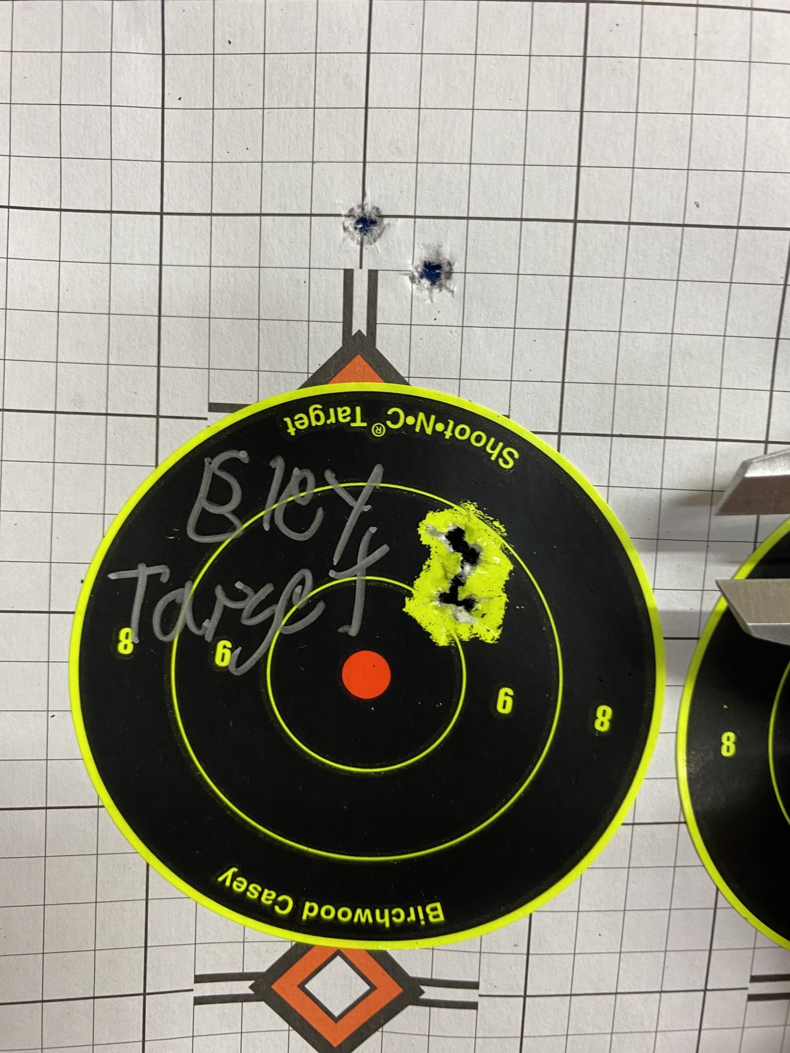

I have a full KIDD rifle and two with Voquortsen barrels. All three are 1/2" guns with various match ammo. On any given day one will out shoot the other two. I haven't shot any with bulk or HV ammo to amount to any measurable results.
My Volquartsen “sniper” conversion will shoot MOA with SK high velocity match, and Eley Force at 100 yards. Others I’ve tried, not so much

Randy at CPC told me those factory Ruger light varmint barrels turn out very accurate. I love mine it’s a sleeper, definitely get the full Monty the trigger is outstanding.
That's not an LVT barrel, that's a "Target" barrel. The LVT barrels are tapered, Target barrels are .920 straight...you can also pick them out of a crowd with the exterior "spiral".
My 10/22 Target* for comparison:
*Ruger factory "Target" barrel, receiver and bolt.
