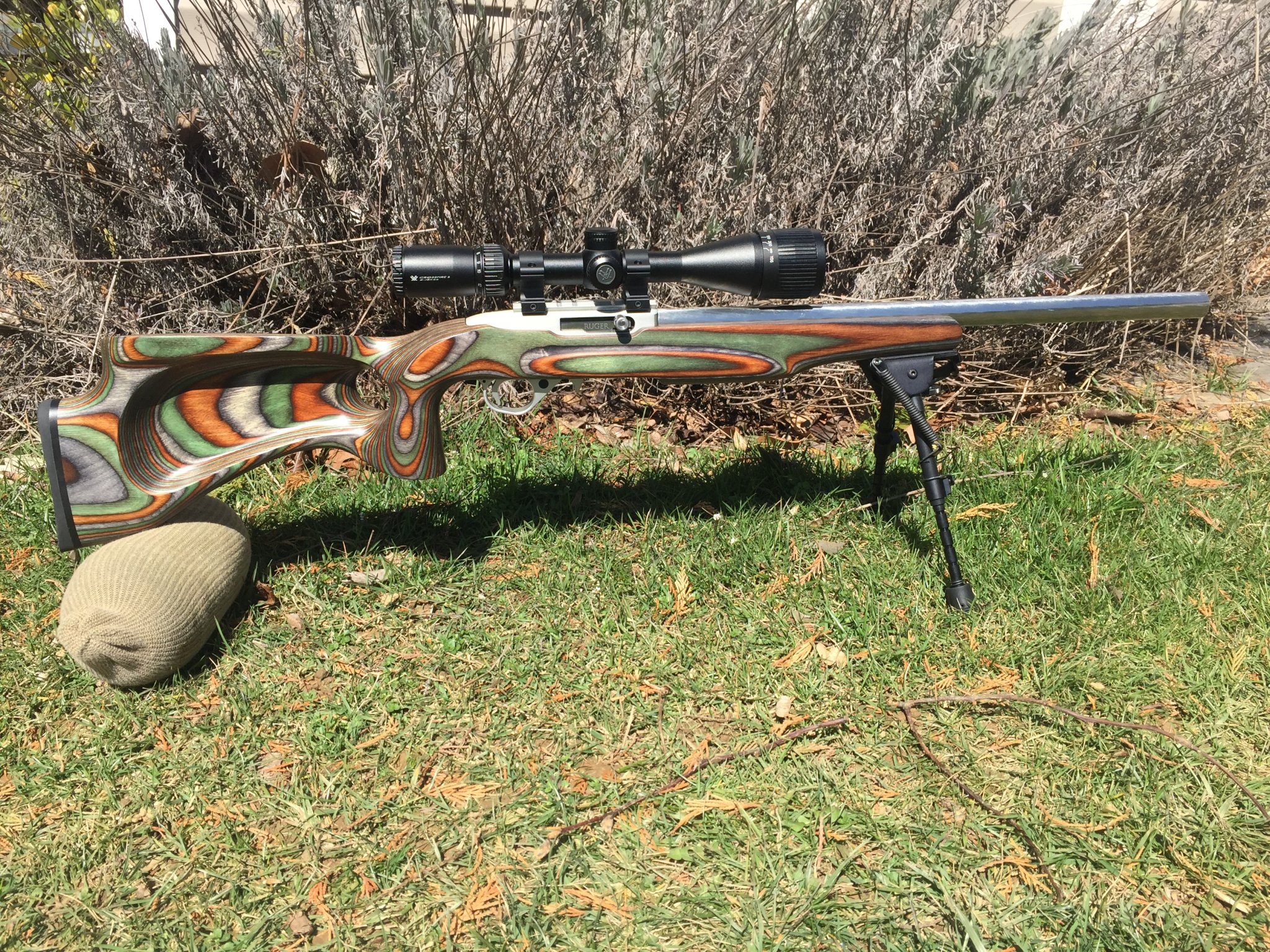

That's not an LVT barrel, that's a "Target" barrel. The LVT barrels are tapered, Target barrels are .920 straight...you can also pick them out of a crowd with the exterior "spiral".
My 10/22 Target* for comparison:
*Ruger factory "Target" barrel, receiver and bolt.
You’re right I bought my target model as a close out from Cdnn. I was referring to it being a completely factory rifle, the phrasing was confusing. I’m impressed with how good the the newer Ruger barrels are with a tighter chamber. Shows you looked at the picture closely 😉. Nice rifle what do you get for groups? That’s an excellent candidate for Randy at CPC’s magic.

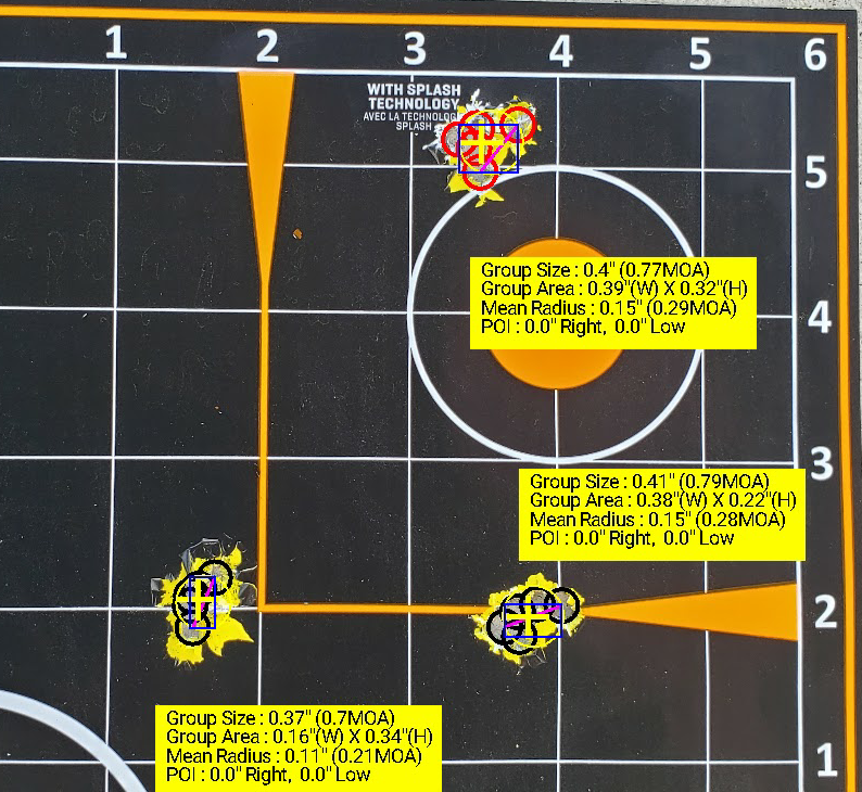

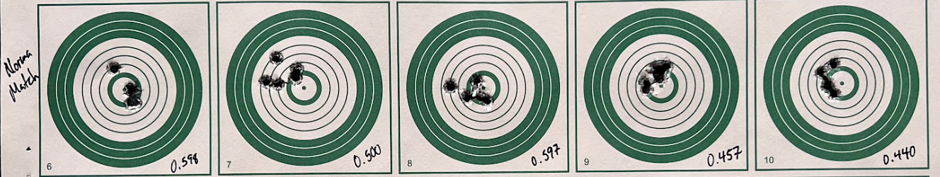

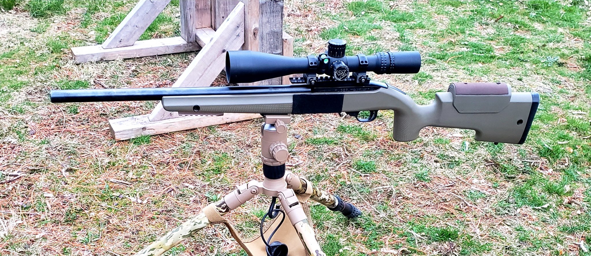

I think you'll be way better off than buying a factory 10/22. I built mine with Kidd Parts, Kidd 20" Bull Barrel, and a BX Trigger in a Faxon Receiver (100% do NOT recommend the Faxon receiver). I haven't done any long range shooting with it, but I'm very happy with the performance and feel of it. Can definitely shoot sub MOA at 50 yards and manages around MOA with a lot of different ammo types.
Most recent ammo test with Norma Match, but it's done well with several types I've tried. I've also still been playing with action screw torque. Also, there is plenty of user error in some of the groups.
Ammo BrandAmmo SeriesLot #Test Date50 Yard
Average (in)
Best
Group
ELEYTeam1023-0304408/19/230.4580.300
NormaMatch-2211/19/230.5180.440
ELEYTenex1023-0407608/19/230.5270.350
SKStandard Plus2252309/23/230.5280.425
FiocchiRange Dynamics08/19/230.5580.370
SKStandard Plus1153408/19/230.5700.400
SKRifle Match1234209/23/230.5920.376
SKSemi-Auto Rifle1111308/19/230.6250.390
CCIGreen Tag08/19/230.6280.460
ELEYMatch1022-0615608/19/230.6450.400
SKHV Match1177208/19/230.6480.480
ELEYSA BR1223-0603508/19/230.6500.400
FiocchiRange Dynamics09/23/230.7420.669
