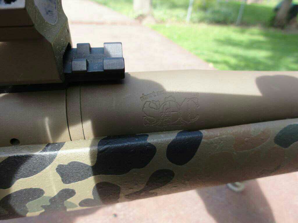

I am wondering how the small shops mark their barrels. I have seen etching before but that is not what I am looking for. I saw a logo on a barrel on a SAC gun that has a pretty deep relief to it and that is what I want. I am building a custom gun for myself and just want to do something a little different and make it personal. Any help is appreciated.

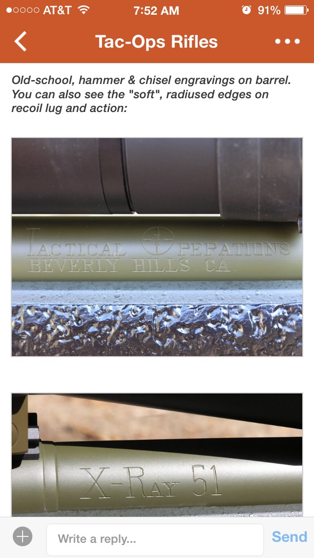

This is sorta what I am looking for. I want something that will show through after I cerakote it black or od.
Sent from my SM-N900V using Tapatalk
