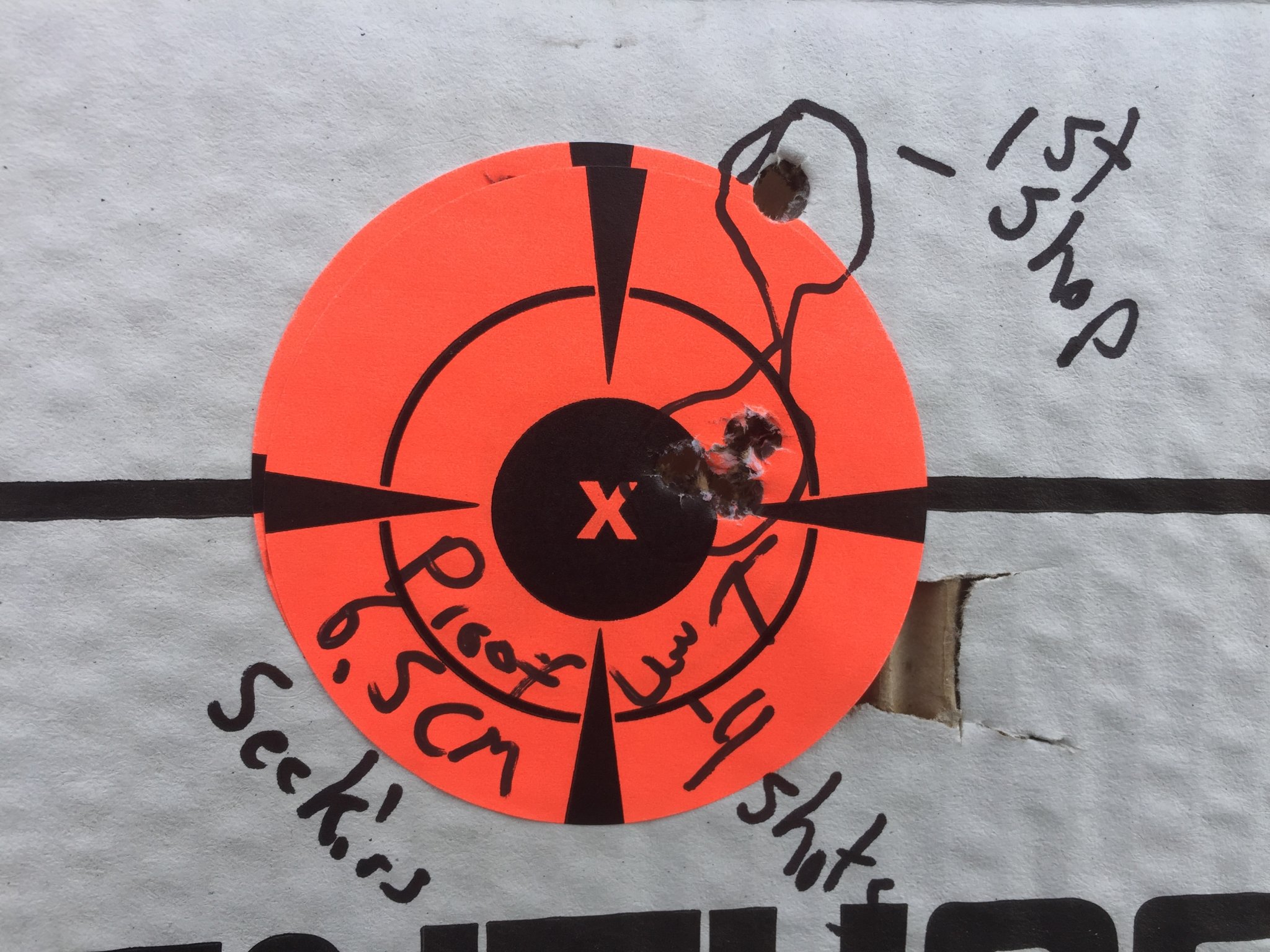

I just got a 24-inch Proof Research steel barrel with +2 gas system. I'm using the JP LMOS bcg and a JP SCS. Popped it on yesterday and went to the range, this was my first 5 shot group out of the gun. No load development either - 41.5gr H4350 / 140 ELD yielded an average velocity 2,740 fps with an SD of 14. I'm pretty happy with that for day one range trip. May have been a tad hot for a gas gun because there a few cycling issues, but I'll address that next trip.
