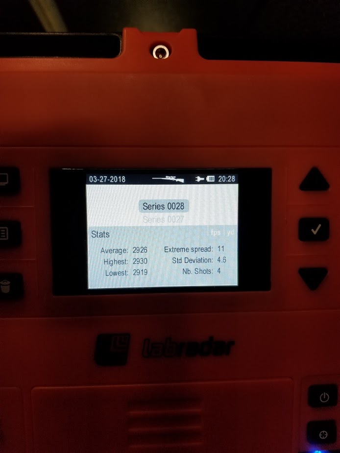

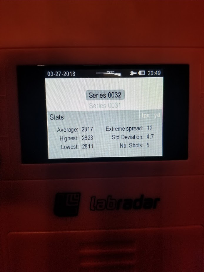

Ok, I chalked my shitty ES up to my even shittier Chronograph that I had for years. I picked up a Magnetospeed V3 a while back and to be honest, never used it that much. I attached it to my rifle just the other day and sent some rounds across it. I was amazed. My ES was something like mid 30s. This is the load I use for matches and for practice. It groups very well and I regularly shoot out to between 1000-1080 yards and make first round hits if I make a good wind call. I have been reloading for accuracy for 8 years. Lapua 6.5X47, Lapua brass, CCI BR4 primers, 40.2 grains of H4350, all brass full length sized, trimmed, annealed, powder weighed per RCBS Chargemaster, etc. the whole damn nine yards.
Question is, how in the holy hell are you guys getting single digit ES numbers????? I would have figured my ES would have been tight?
Steve
I've tried different approaches to getting consistent neck tension, like using a mandrel. That seemed to help. I am careful to get a consistent charge mass, concentric ammo, etc. The little things add up.
Consistent neck tension, Prometheus thrown powder charges, consistent BTO measurements, properly sizing cases and bumping shoulders.. this be my method to the madness. I don't bother to anneal, though I'm sure it would provide yet another improvement.
Reactions: bjay
Going from a chargemaster to an auto throw is what I think finally got me beneath an sd of 12.
And I know that the common line of thought is that lube doesnt effect anything but around the same time I began intentionally lubing inside my necks so I have half contribute that to the improvement as well though I havent directly compared to the earlier methods I was doing.
Ive never seen single digit ES. Commonly get single digit SD. Best ES I’ve achieved is 17. If I understand it correctly to have a single digit ES you’d have to have an SD of 1 or 2.
The A&D FX120i is what did it for me. It is the single best piece of reloading equipment I own. The setup was $1,000 but it drops charges to .02 grains in about 8 seconds.

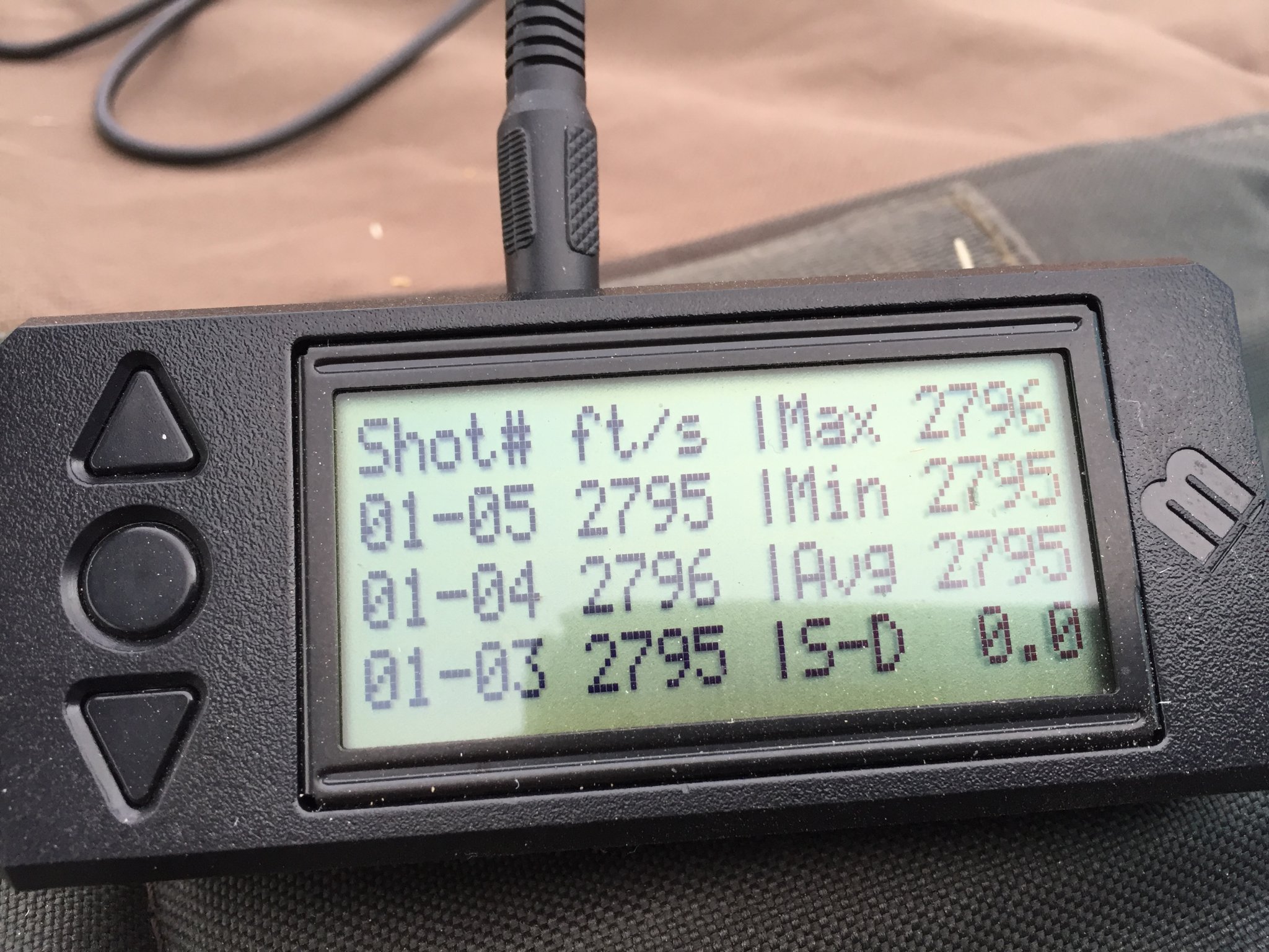

In my F/Open rifle I got tired of playing with seating depth and neck tension so I just used minimal neck tension and seated the bullets into the lands. Made things a lot more consistent with fewer outliers.
Reactions: Bender

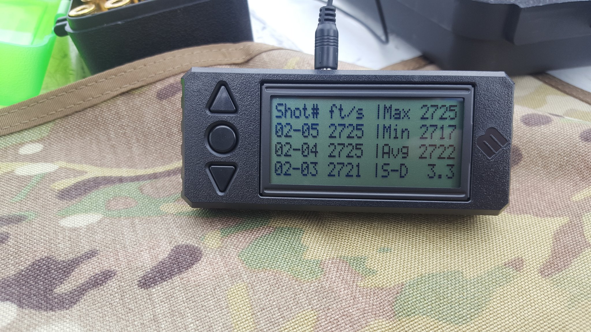

Careful brass preparation and a good powder measure (I'm using a Prometheus) or a good scale and patience with a powder trickler.
For brass prep I just keep everything as consistent as possible. I slightly oversize the neck with a bushing, then use an expander ball to give a consistent 2 thousandths of neck tension regardless of brass thickness (because I'm doing the final sizing from the inside the thickness doesn't matter). Case lube is removed immediately after sizing to try and prevent it from getting on the powder or bullets (or allowing small brass shavings from the next operations to stick to the case). After sizing I trim to length and chamfer/deburr the neck inside and out. Then seat the primer, I use BR4's but haven't noticed much difference between them and the CCI 450's.

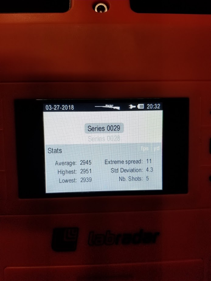

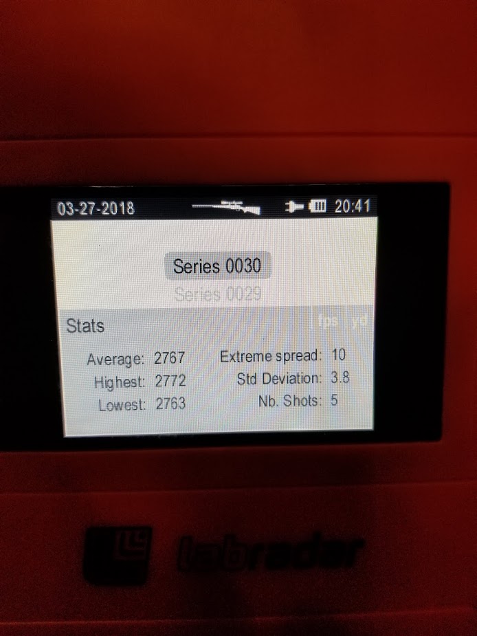

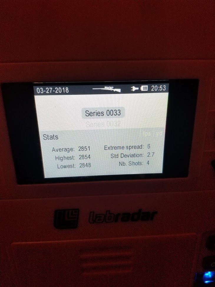

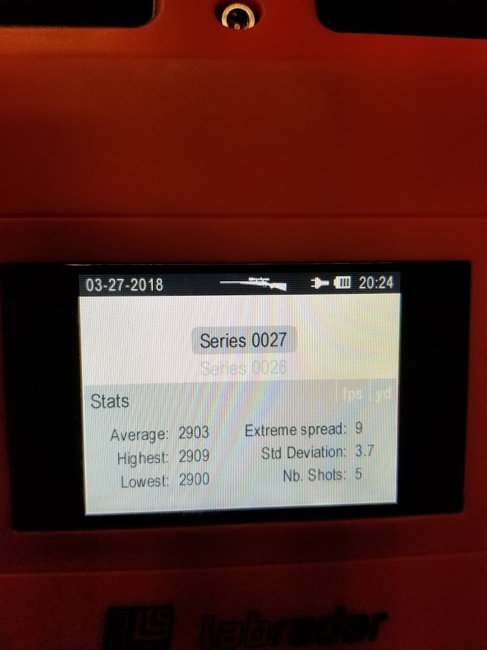

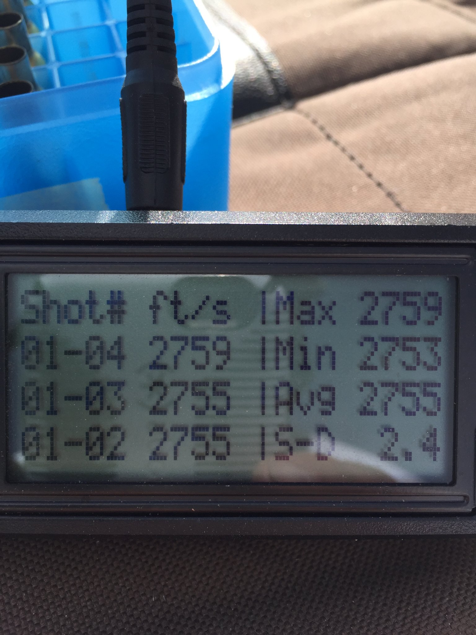

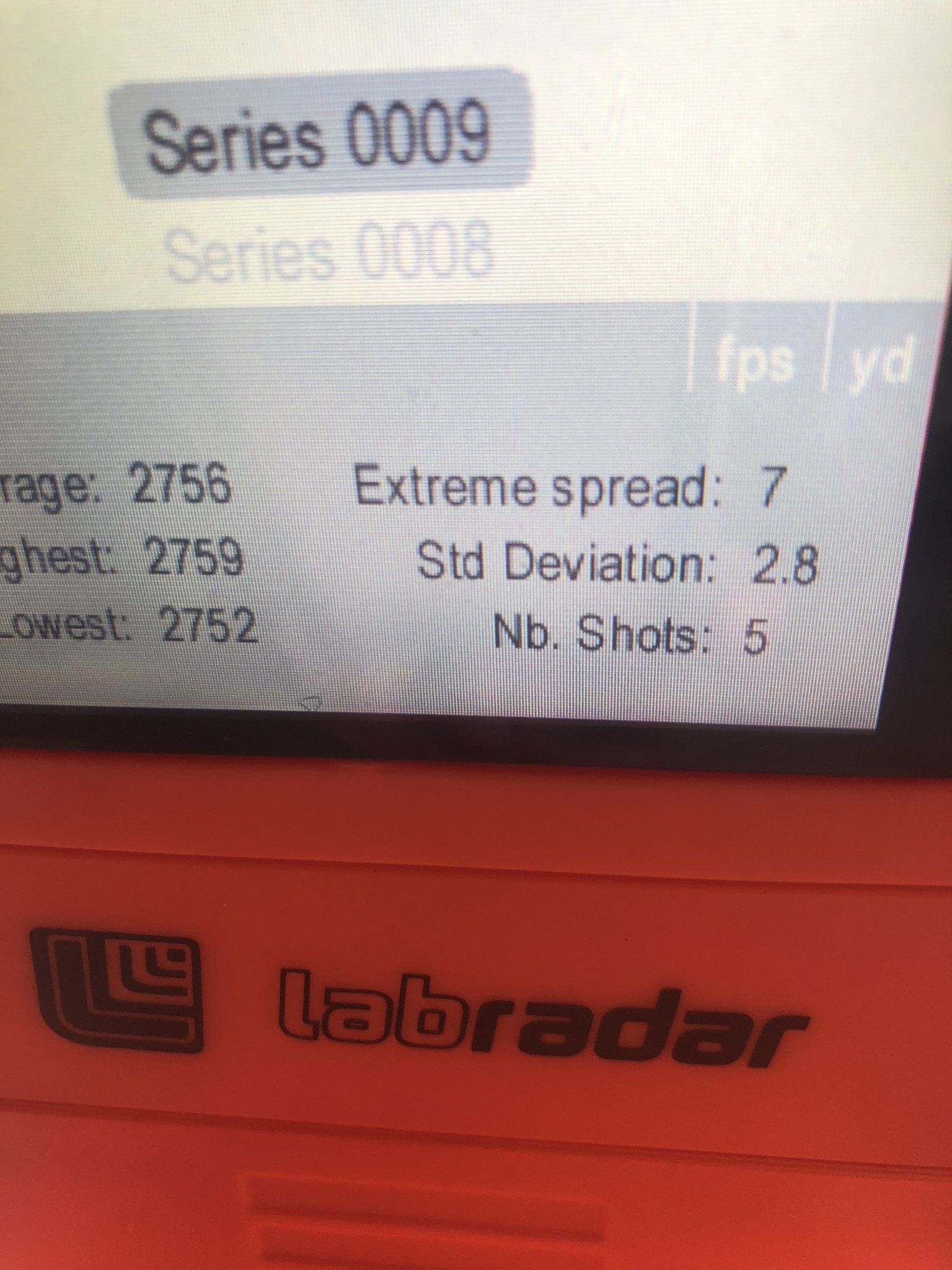

Below are a couple photos from my load development on Saturday. I shoot 5 round groups for load development, so I'm not sure how much these are worth to you (and 2 of them had the LabRadar only pick up 4 of the 5), but they show that the process does at least give good results.
These loads were a mixture of Berger 140 Hybrids and 150 SMK's in 6.5 Creedmoor using RL-16, Lapua brass, CCI BR4's, and shot out of a Christensen TFM.
Best 5 shot ES was 9, with an SD of 3.7 (far left pic).
Best 4 shot ES was 6, with an SD of 2.7 (second from left pic).
The rest of the loads averaged an ES of around 10-15 and a SD of 4-6
.20180428_092929.jpg20180428_095911.jpg20180428_094632.jpg20180428_093332.jpg20180428_093743.jpg20180428_095505.jpg
