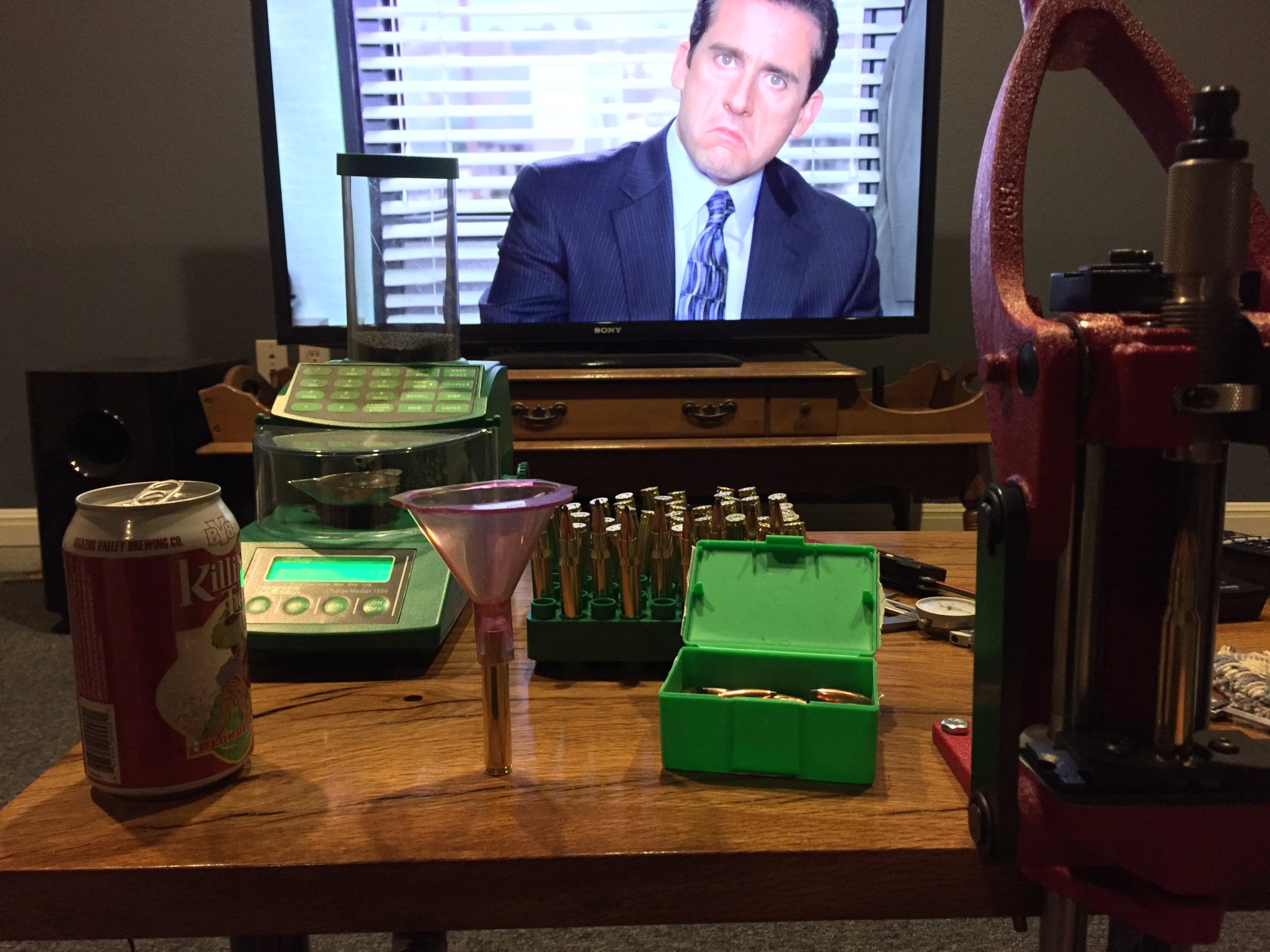

I use mine on the same one, my coffee table. And I seat while powder is throwing. If you’re jerking the handle exactly when the scales finishing them you’ll have issues. Finish up fast so it’s still running and able to stabilize for a few seconds or wait until it’s done and you’ll end up fine.
That could be skewed by my table being solid and heavy. I assume all reloading tables are though. My bullets also seat nicely. If it’s tough and causing your press resistance that you are forced to overcome I think you need to work on your brass prep more as well as a more solid bench.
I do this as well. Except for the coffee table. How the hell do you reload on a coffee table?
It’s a 1 1/4” slab of solid oak off the ranch with a base made of 1” pipe. It’s stout. It will, of course, teeter if i put my body weight on it but for seating, it doesn’t wiggle unless I make it do so. Mount my press on it with wing nuts, take it off when I’m done. I don’t notice the four 3/8” holes. I set all my crap on the counter against the wall when it’s not in use and keep the space clear. Something about cleanliness and god
What kind of press is that?
