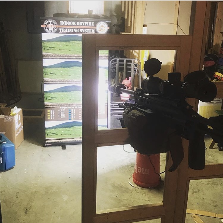

Shooting local 1 day club matches is some of the best practice you can get. Aside from that I have a barricade in my basement and dry fire on it several time per week.

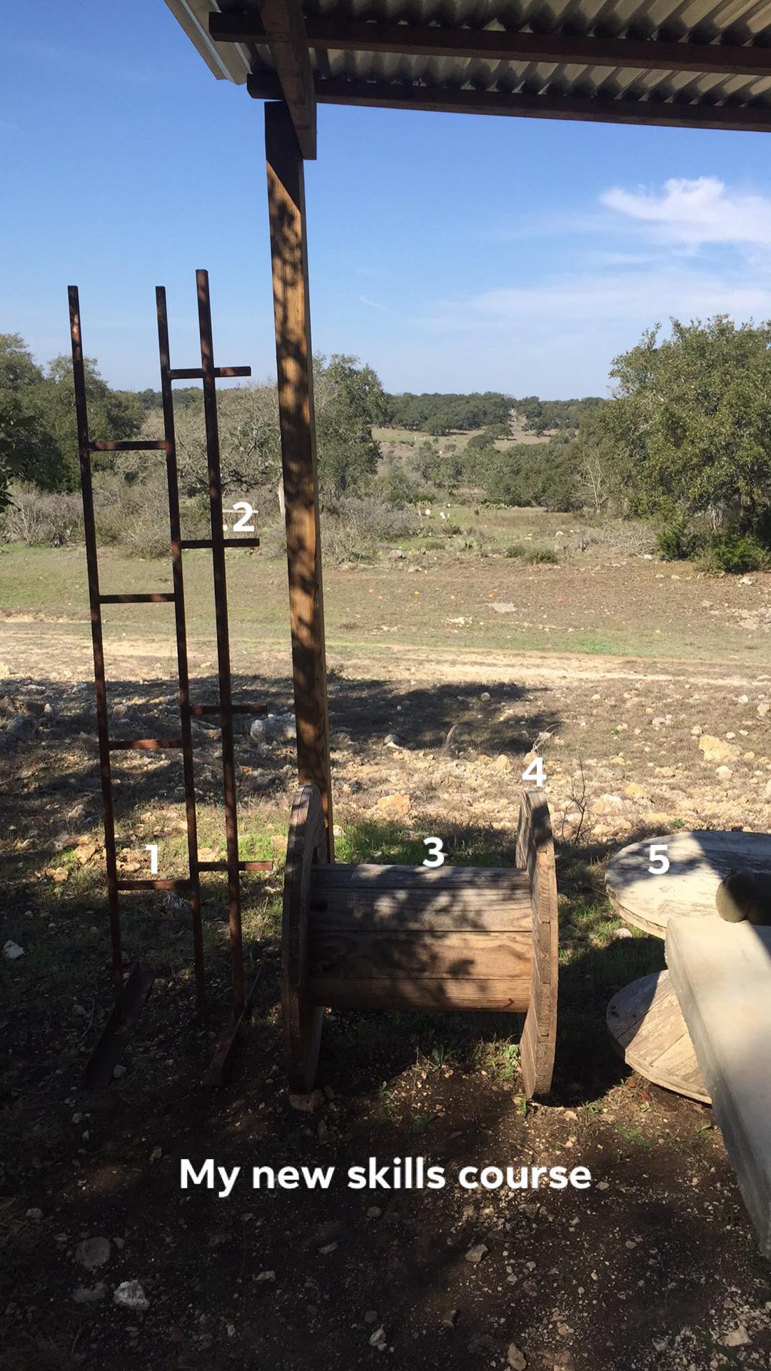

I make up a little course and practice. Sometimes I time it, sometimes I take my sweet ass time analyzing where and what Im doing and how this little changes increases or decreases the rifles stability.
Like on position 3, sometimes I will press my firing arm elbow into the reel for added stability, some times I purposefully float it to challenge myself. Just depends on what I feel I need to work on at the time.
But mixing up the positions: pretty low on my hands and knees for position 1, standing tall slightly higher than perfect on position 2, position 3 is high enough that I can sit on my foot, position 4 requires me to be kneeling, 5 is a kneeling platform that rotates a bit so you cant just blindly push into it.
Just mix it up and challenge yourself.

I do a lot of dry firing in the living room, there's a stop sign at ~400 yards that I practice with, as well as white rocks that contrast a hill also around ~400 yards that I use as targets.
Dry fire prone, dry fire off of a tripod, dry fire off of couches and step ladder, dry fire kneeling and standing, etc. I also have a PCP airgun that I use for practice - tripod shooting practice, and I should work some more barricade practice in with it as well. I got some little steel targets set up in the backyard for the PCP, I will incorporate some barricade shooting with it. I want to find some smaller targets as well as a ultra mini KYL rack for it.

2) Dryfire practice in my game room with a DFAT lense and target sheet with 0.5-2moa targets. I will usually grab a chair or my half sized PRS barricade

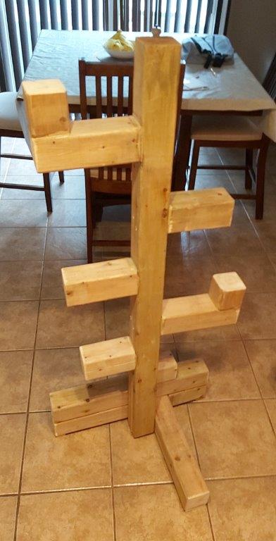

Can you post a picture of said practice cactus?
Here it is Krob95... This was the most space efficient design I could think of.
All the joints are glued with construction adhesive and it has a 3 point leg so it doesn't rock.
Ooh, that's super nice. And your right, much more space efficient than a prs barricade. Thanks for sharing!

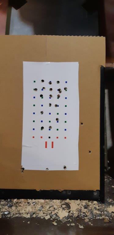

To keep it interesting shooting at close range, I use these targets but I dont aim directly at the dot I'm trying to hit.
Instead, I always aim at the black dot at the center of the bottom row between the vertical bars, but I dial up and over to hit the other dots. This way I'm dialing the scope between position changes just like in a match.
On this target at 10 yards, the dots are 5 MOA apart, but you can print them to MIL or whatever scale you want.
I have a sign maker buddy who prints them for me on adhesive vinyl. He also prints larger ones for 22 LR practice at longer distances.
I also use 10 squares per inch graph paper, and color in specific dots anywhere to simulate a specific stage.
The limitation with graph paper is fixed increments depending on the size of squares.
I've considered printing pictures and marking dots all over it to replicate the back drop of a PRS range, like we can download from http://www.dstprecision.net/index.html
Adding graph lines to the picture would help calculating the offsets.

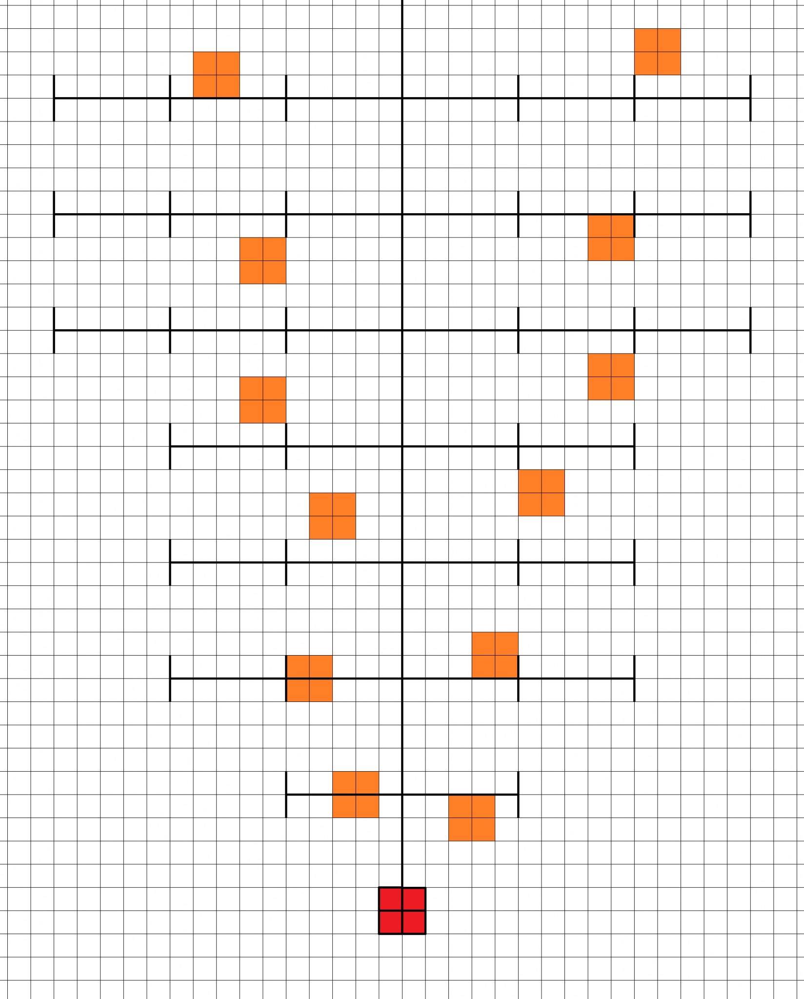

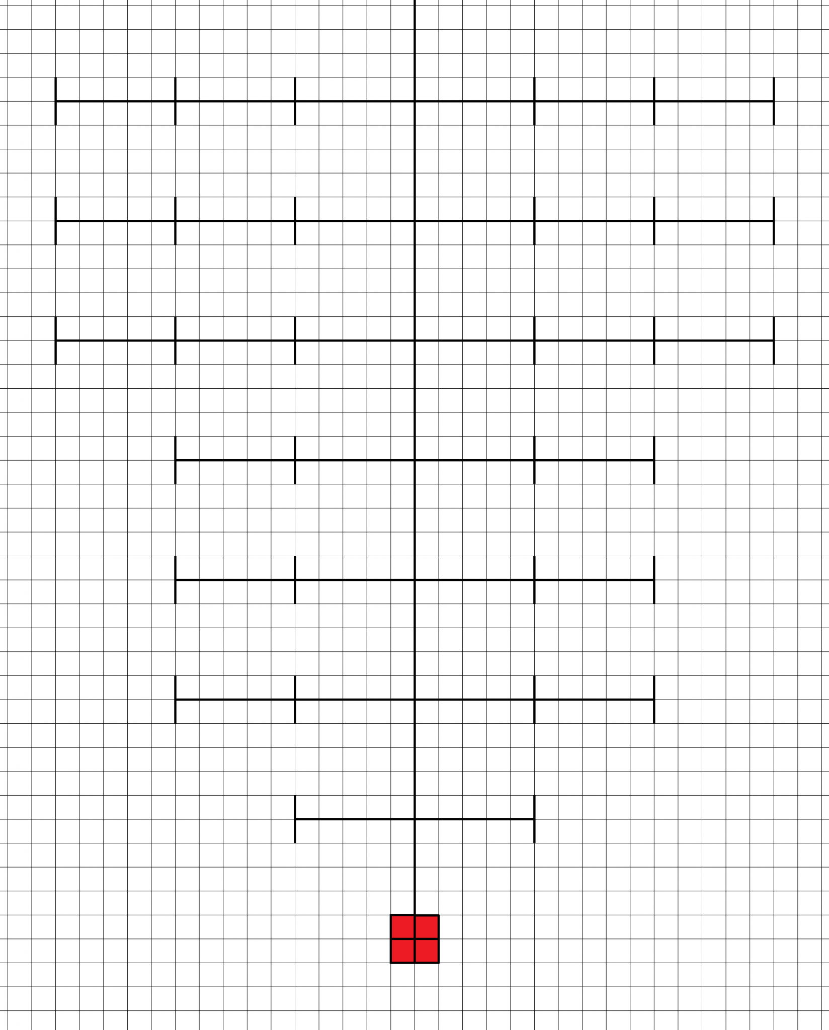

Here's a couple targets I made that you guys can download and print for yourself if you like.
These are kind of an inverted Christmas tree kind of deal where you should aim for the red square at the bottom but dial up to hit other places on the target.
Its a great way to practice at close range with an air rifle or 22 while working your scope dialing skills.
You can use a highlighter to color in any squares that you want to hit, maybe to replicate specific stages of a competition. Or use MS Paint to edit the PNG File and just color any cells you want.
Print to whatever scale fits your needs to match MOA or MILs or the distance you want to practice at.
Reactions: Krob95

Also, if you’re indoors, look at getting something like the DFAR or indoor dry firing system that lasts you use your scope at like 10Ft. I have one on my basement and have a few props like a barricade and cattle gate that I practice on. Just building good positions and working fundamentals.
