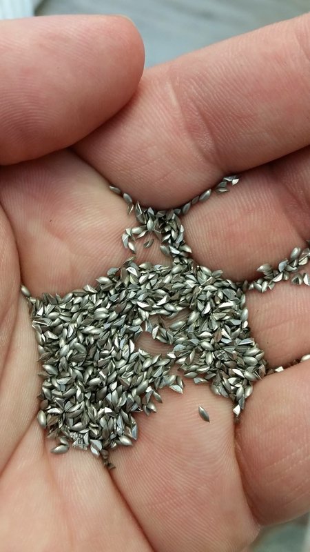

I've done all I can to avoid this, but it still happens. This one made it past my priming stage and I caught it just as I was dumping powder in.
I toss the ones that get stuck in the neck of my Lapua 260 brass after sizing. I always double check cases before priming but when I sift out the pins I may have 3 cases out of 500 that have a pin in them when I'm priming. Best thing to do in your case is shake each one as you get ready to prime.
Just going to have to deal with that issue. I use a dentel pick to get corn media out of the flash hole and primer pockets when it happens .
I haven't had a pin get stuck like your sample, but when I get two pins stuck in the flash hole, I discard that piece of brass because I am assuming the flash hole will be too large and inconsistent with the other brass......
I know the cases come out looking beautiful with SS pins, but the risk factor seems too high for me. And I have enough steps already to load precision ammo, no way I'm adding another. Sticking with tumbling using lizard bedding procured from local PetCo.

I have had issues with 6.5mm cases getting pins suck sideways in the neck. It's frustrating but not the end of the world. To run a batch thru the SS media is a 2 hour ordeal start to finish. I never had dry media get brass looking as good/clean and it took much longer to get there. Maybe I wasn't doing it right. Whatever floats your boat.... I SS clean every firing and I guess neck tension is consistent enough...
After tumbling, I dump most of the water out of the container, then fill it back up with warm water until the soapy bubbles are mostly all gone. From that point out, I grab 5-10 cases at a time, point them all the same way and shake them mouth-down over the water until I don't hear anymore pins sloshing. Check the necks for pins stuck sideways, and put them in a strainer. When the whole batch is in the strainer, dump them into a cooking pan with paper towels in the bottom, cook it at 250 for 30 minutes, and it's done. Never had a problem with pins staying in the case (I line them up in the loading tray and look over the batch from the top). If you want to talk about kicks to the nuts, there's people spending $600 to seat primers to the .001".
The only time I've ever experienced issues with pins being left in cases was shooting another person's rifle, with their brass/loads, from their setup where all they did was roll it through the spinny tumbler grate thing after tumbling. I shot 5 rounds and quit after the 2nd one had hot pins falling out of ejected cases. If you expect that to get every pin out of your cases you're high. If you dry the brass before you check for pins, you're begging for soap residue to make them stick to the inner wall. They slide right out when wet with a little shake. It takes 5-10 minutes to check 100-200 cases as you pull them out of the water. It's literally no worse than shaking cob/walnut media out of them. No black residue on my hands, no dust clouds, no black dust on everything in the garage...
In all the years I've used stainless media, I have yet to get a pin stuck, but I also don't use "pins" per se. My media came from Southern Shine Tumblers on Facebook. The media is more like chips than pins. I am completely serious when I say I've NEVER had a pin get stuck in any case, and we're talking several thousand reloads.

Thanks for the input. I have switched to rice and do not look back at stainless. It seems to clean quicker than corncob media as well.
As far as the CPS, I did not even know it existed. I tend to load in small batches so I don't have the issues with hand priming that some others have, but can certainly see it's usefulness. It is not a product for me at the moment but don't understand how it's a "kick in the nuts". No one is forcing me to buy it.

Look, the bullshit aside, there are two factors which we would objectively be looking at. 1) Performance directly related to the types of tumbling media; SD, ES, precision, accuracy, and 2) Performance delta vs. input required to perform the process (wet vs. dry).
1) Milo is probably onto the idea that I agree with the most. Minus some plastic deformation in the neck, the operation of seating a bullet is mostly elastic-- the hoop stress of the press fit is what holds the bullet in place via friction. The force required to seat the bullet is mostly the same as the force required to remove the bullet from the neck (minus the plastic deformation beyond the elastic limit of the brass). So one would think that consistent seating force is the name of the game to work towards a performance increase (ES/SD from 'neck tension').
Are you going to tell me that dry lube in the form of burnt gunpowder is the ONLY way to ensure a consistent coefficient of friction between the bullet and casing? Think about it for a minute. Beyond that, are you really going to tell me that dry tumbling with rice is the ONLY way to ensure that a consistent coefficient of friction is achieved? Is 3/4-1 MOA really the limit of accuracy possible with wet tumbling SS media? I don't think so because I'm shooting sub 1/2 with single digit SD's...
As an aside for thought, what is the difference in 2lb of seating force in the face of 60ksi chamber pressure? I don't know; I don't think anyone does.
2) Both types of tumbling have their ups and downs. Dry tumbling is something I have done with several media types, including rice (although not the magic brand listed). I SS tumble now and don't consider going back dry. Both processes require picking media out of the cases, both processes take at least 1-2 hours start to finish, both processes require an added cleaner to the mix... What's the difference? One you have to wipe your cases down, the other they're bone dry and clean. So the work input is pretty similar-- one is not "Hell on earth" compared to the other... So if it's worth it or not is dependent on the performance gains, which have not had any objective data provided in this discussion that I've seen. I'm still shooting sub-1/2 MOA so I'm a little befuddled to see where the ground-breaking change comes in. Certainly doesn't warrant telling anyone they're stupid because they haven't reached the same conclusion that you have. Funny what you learn about the type of people who make claims like that....
I'm never too proud to prove myself wrong. This morning I loaded up 10 rounds without tumbling them at all, preserving the "as fired" distribution of soot or whatever that is supposed to aid in consistency. I FL bushing sized them just like I always do, wiped off the lube, trimmed, debured, and VLD chamfered them, just like I always do. Because I wasn't tumbling them, I cleaned the primer pockets by hand. Primed, them, was extra cautious on weighing charges ensuring the scale went back to 0 every time and seated the same bullets at the same depth that I always do.
In short, I loaded them exactly the same as normal, the only difference being they weren't tumbled beforehand. I then shot them, bipod and bag prone at 365 yards over a magnetospeed.
6.5 4s, 140 ELD-M 0.025" jump
Hornady Brass
60.6gr H1000, CCI 250 primer
28" Proof Research 1:8 barrel on an ARC M5 action
March 3-24x52 if that matters...
Dirty necks:
3145fps Avg
10fps SD
37fps ES
10 rounds out of my normal loads, SS media:
3142fps Avg
8fps SD
27fps ES
Accuracy had a slight nod to the dirty necks, but we're talking about the difference between 1.6" of vertical and 1.8" of vertical at 365yd, both 10-shot groups with a magnetospeed hanging off the end of the can, 92 degrees and me sweating my balls off. Windage was more, but I was holding center with 3-7mph variable winds, not offsetting for it at all so it's a bit of a waterline, 3-4" wide.
In other words, it's pretty much a wash. The sample size isn't really big enough to conclusively say one way is any better than the other. I mean if a guy really cared, you could do 50-100 rounds each way and document them all to look for the small trend deviation. Nonetheless, I'm not seeing any massive accuracy or ES/SD performance loss specifically from wet tumbling-- just as I never have in the past. Wet tumbled ES/SD numbers are pretty much identical to what I've seen in the past on this magnetospeed and a LabRadar unit. 3141-3147fps avg with SD in the 6-8fps range.
