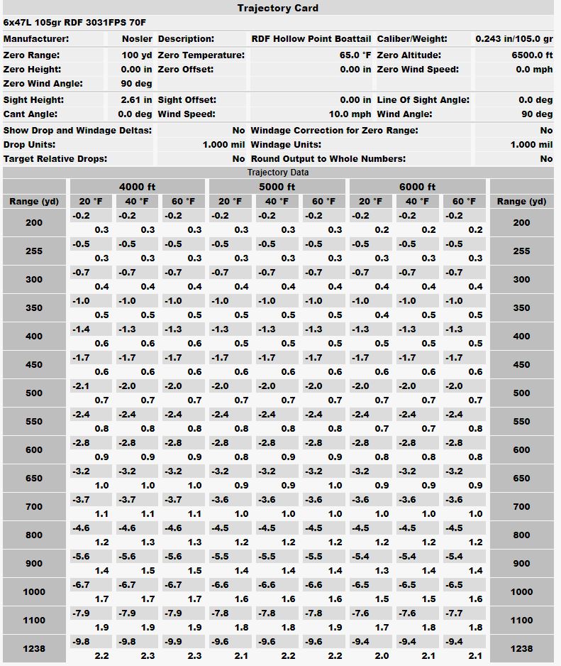

I noticed something interesting tonight that I can't figure out, setting up a new trajectory card for JBM and noticed that at a lower temperature it was calling for less windage which doesn't make sense to me. When the temp drops air becomes denser so I imagined that the wind would have a greater effect on the bullet, JBM is showing me the opposite around 1000yds but is most obvious on my 1238 yard solution. It's showing at 20F and 4000ft Density Altitude windage is 2.2 mils, at 40 and 60F it's 2.3. Switching from Mils to inches shows it's about 2.2" difference between 20F and 60F, so this is likely just an academic thing and not really going to cause me to miss a shot but i'm curious to know what the physics is behind this.

1170 Yards - 260 REM - 140g Hornady ELD @ 2740 FPS - RH Twist - 1-10"
Spin Drift Only - MRAD
-3200 DA = 0.34L
2400 DA = 0.32L
With 10 MPH Full Value - MRAD
-3200 DA = 3.3L
2400 DA = 2.62L
Not a shocking conclusion really, at least to me (unless I am doubtfully missing something). Spin drift more affected by denser air. More windage hold required with denser air.
I think it has to be something to do with the drag curve they have for that bullet. Like you said, not a miss on a target most likely but interesting data. I had to enable double-digit turret solutions in FFS to be able to see the difference for the spin drift even.
