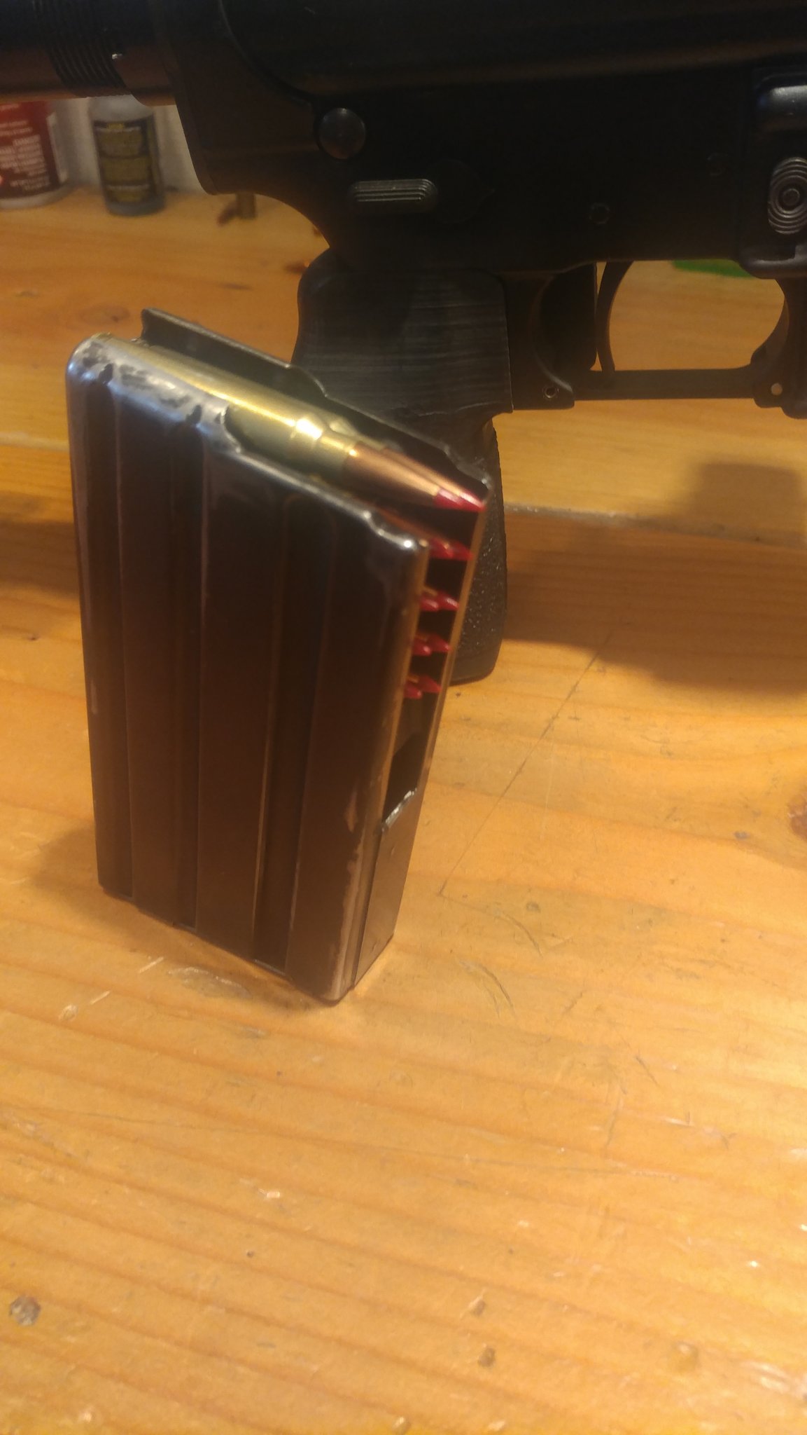

I was shooting 75ELD's at 2.41" out of a mag, but the barrel is on the way out and the ELD's won't shoot anymore. There is a huge difference past 500 yds using something sleek like the ELD's vs. the more mag friendly SMK's and such.

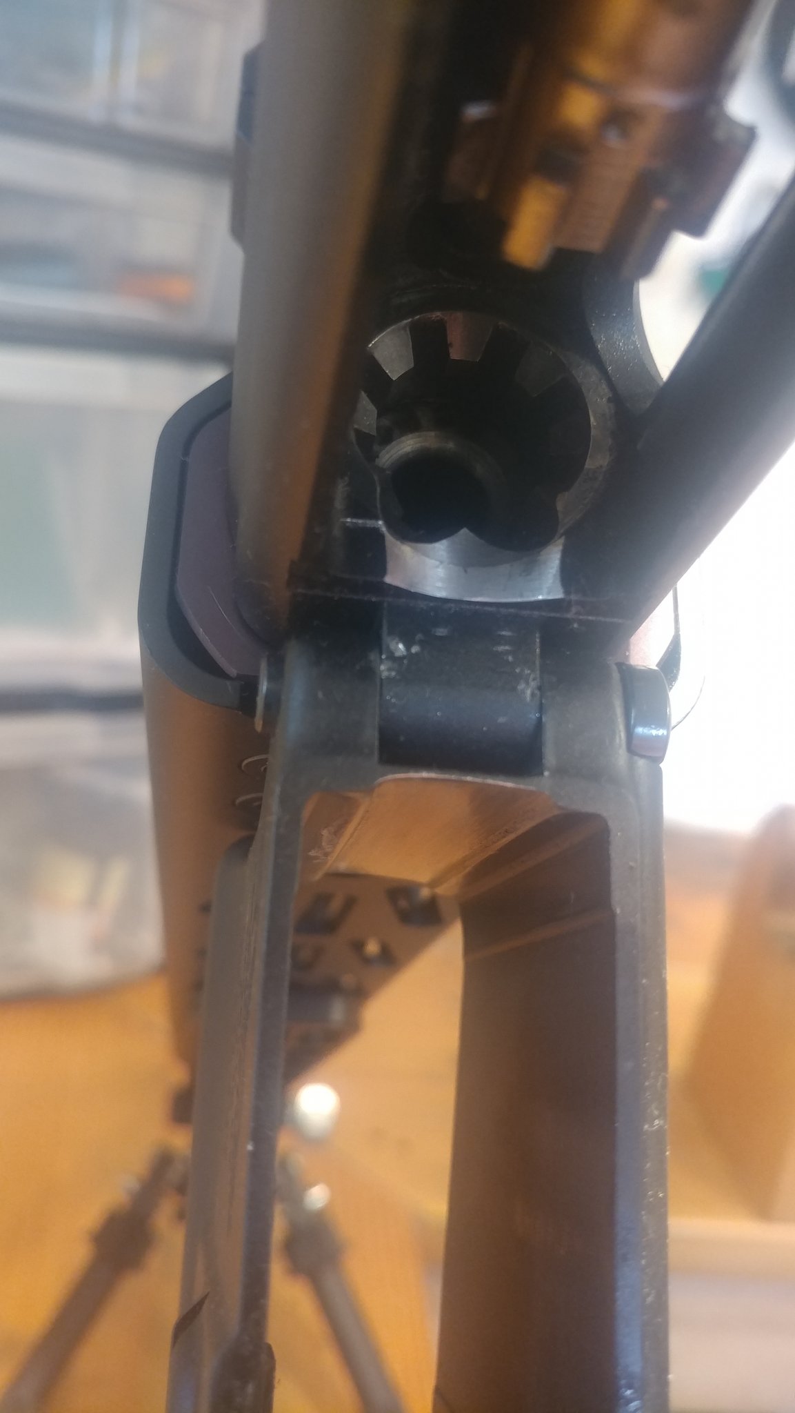

I'm guessing that's with the front cut out of a mag? What kind, ASC? Pmag? Or did you also have to remove material from the magwell in the receiver?
Yes to all of the above.
Get them 75's going about 2900fps and suddenly 223 is in a different league.
Yeah that is true for sure, 75 ELD is a whole nother level. What did you have to do to your receiver, got a writeup with pics? I may have seen it if it's been a while, I've seen a couple, but it's always interesting to see how people do these.
I have some pics on here somewhere, can't find them right now though. I'll try to take some more this week and post them here.

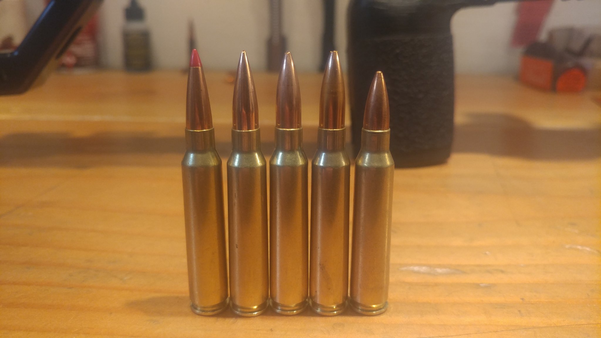

Got some quick pics. It really is pretty self explanatory, I think the lower and upper/barrel extension relief was done mostly with files and some fine sandpaper if I remember correctly. The mag was just a thin cut off wheel in an angle grinder.
L to R: 75 ELD, 70 RDF, 77 SMK and 77 CC all loaded around 2.41" next to the standard 55gr 2.24".

Thanks for the pics. Looks like the same idea I've seen from others, except your work looks better. (y) I need to get around to doing this one of these days; I've made my own barrels, side charge handles, machining on recievers, etc, but still haven't done this yet. I'm saving your pics for reference.
That last picture really shows the difference in ogive length for that 75 ELD!
Have you noticed any feed issues with shorter (standard length) 5.56 ammo?
Reactions: TonyTheTiger
No feeding issues at all, but I use uncut mags on the occasion I shoot shorter ammo. I was very surprised when I first started cutting things, I assumed I'd be chasing gremlins to get things working but that hasn't been the case.
