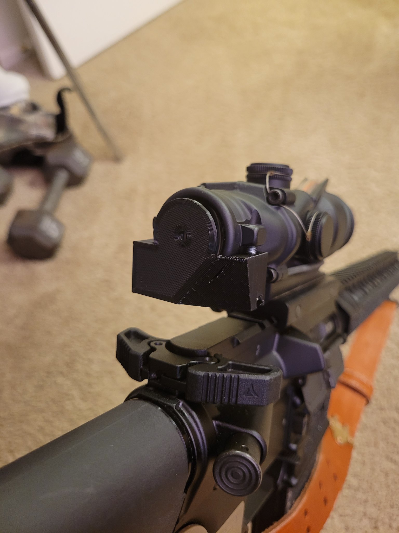

Not very well without cheats, personally.
Tried making a rear pinhole limiter, which worked very well but sucked as it was too ghetto.
These work well enough for their purpose, but are not “pinhole enough” for my scopes.
