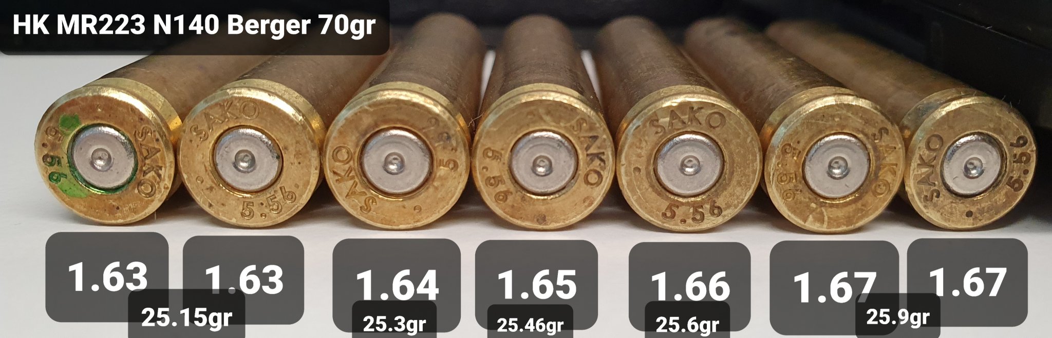

Here is my recent charge test, 24gr sounds quite mild for 77.
Please note that the brass had already the marks, this is why the one 1.67 case is smooth and other not. Only primes were flattened.
Temp was around -4C / 25F
It was raining snow when I shot these so small amounts of water was introduced to the rounds,

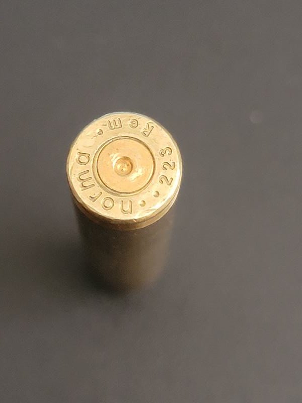

This is a flat primer-
It's too bad that I had to turn that load down but it is ball powder on a 40 degree day, and I was worried what would happen on a 80-90 degree day.
The group doubled in size when I dropped down a half grain but hopefully it will come back when the weather warms up.
If the primer edge still has a radius, it is not as flat as it could be. I've seen military fired rounds that had no radius. That's Hot.

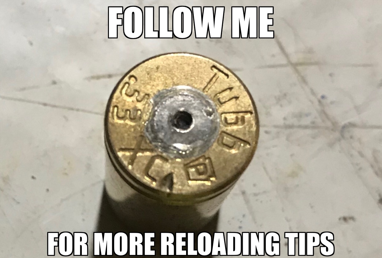

And, no those primers are not flat. I was pushing for speed with my .300 WM and running 210grn Bergers to 2975 FPs with a 22" barrel. My brass didn't like it.
